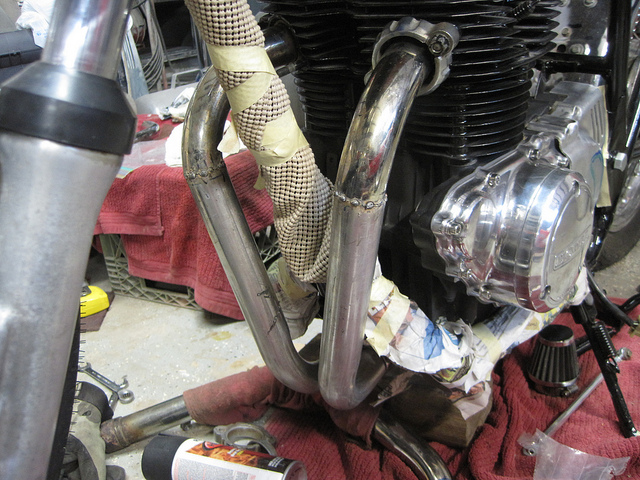

Finally an update, today I worked on my exhaust and got the headers done and a step closer to completion. I also been thinking about my sproket cover and how to chop it. I made the outline of it about a month ago and just now putting it up. the half cresent would be brass netting with cut out polished aluminum outline of it. and I want to chop of a little bit off the side. I think it will flow better, and a little extra weight off.

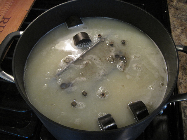

Soo, today I bought 3 quarts of lemon juice wckhich one more would have been to much, good thing I'm cheap. But I saw a thread of Sonreir doing this and the results looked pretty good, so I gave it a shot and it works really good. It takes away the shine but it will be back when I start riding it. The carbs look super clean, I boiled them for 20 mins-35 mins. I can't wait for my carb rebuild kit to come in the mail so I can polish the float bowls and pit them back together. I also polish one of my forks a couple days back.

Looks like it worked out pretty well. I was happy with the results on my lemon juice test, despite the EXTREMELY weird smell.
Nice, man. I did this on my carbs as well and it worked out awesome. Sonreir, you're right. The smell is fucking bizzare. I did mine outside on the BBQ side burner and even that was whacky.
