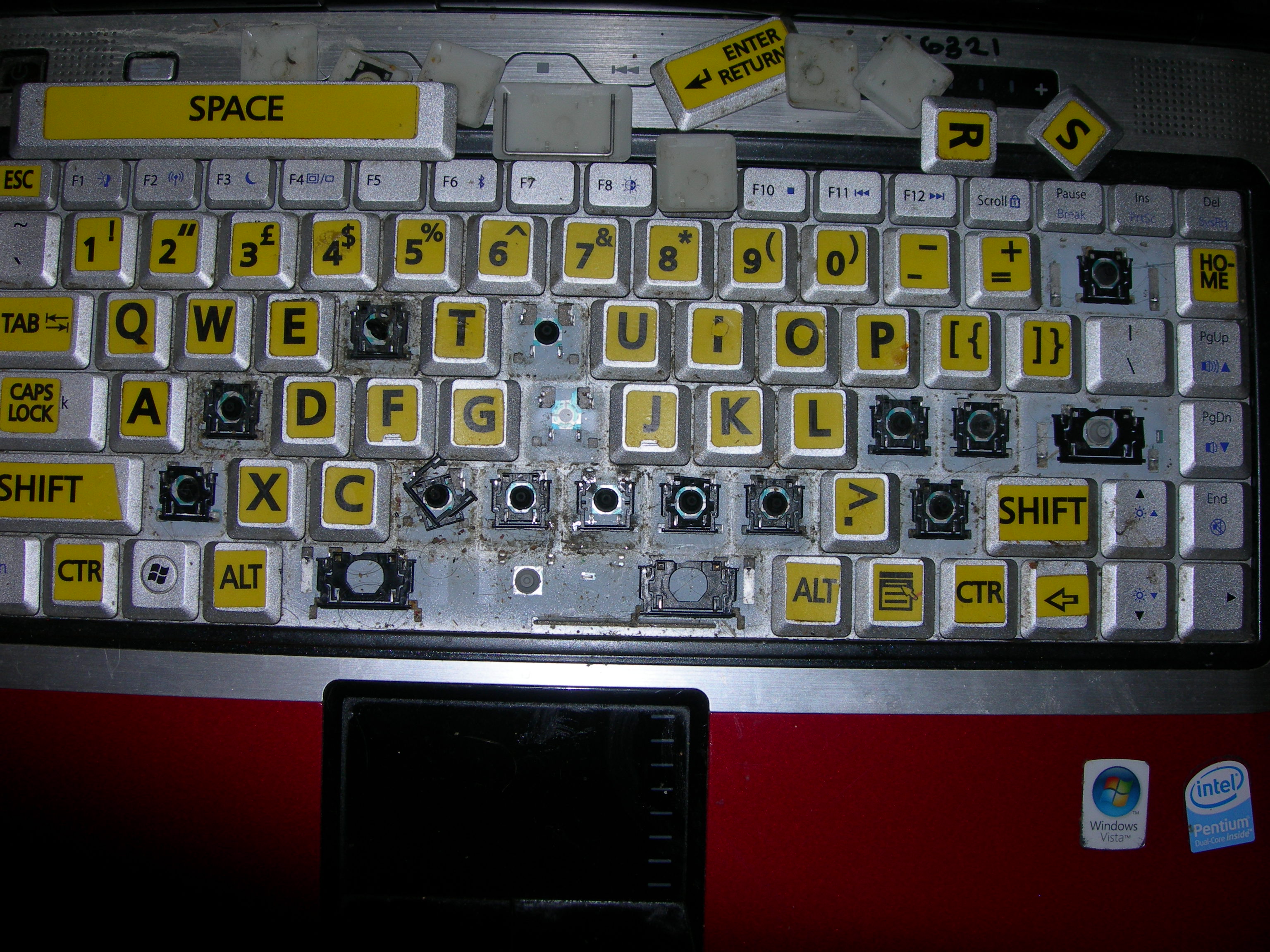

Jaxon decided I really didn't need a keyboard on laptop (only computer I have working at present) Got a USB keyboard on it at present, afraid to fit a 'new' one in case he does same thing with it. New 500Gb hard drive I bought was faulty, replaced but not much use when it screwed up SATA port on mobo :( Taking what little time I have to work on stuff to fix things instead of fix other people's things and get a little cash ;D Down to 2 sts of carbs to do and still have cylinder head to finish. Jaxon also hid the new bronze valve guides I made, he loves being in garage and 'me help' ??? :o 8)
