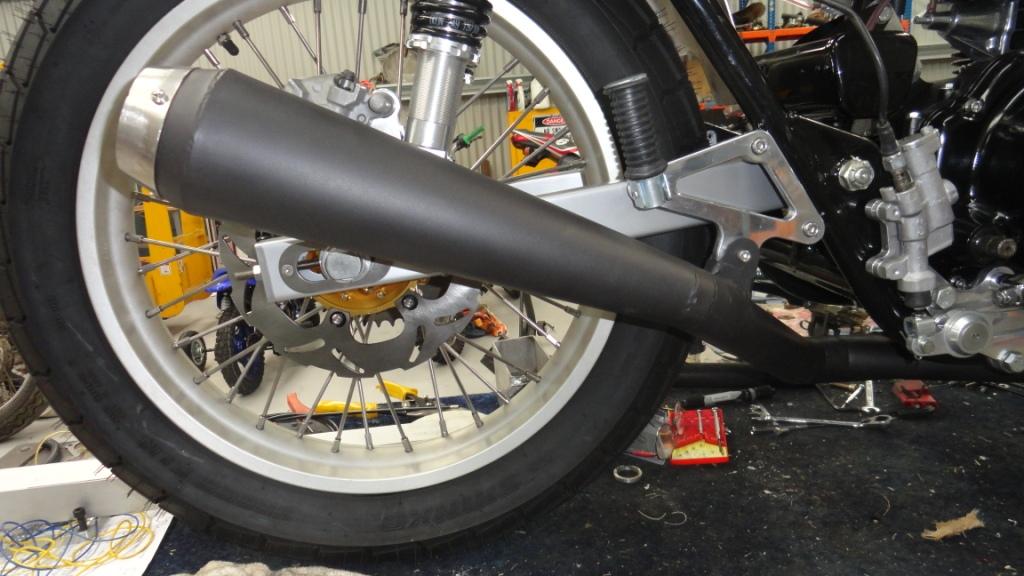

I got the exhaust bracket made up and installed and then painted the pipes in "pot belly black", which comes up pretty good. I also made and installed the end cap which holds the baffle in place. It just needs sanding and then polishing and it will be good to go.

Thanks pj, it hasn't got the correct bolt in it yet as the pipes aren't done up tight at the front and need to come back a couple of mms further.
