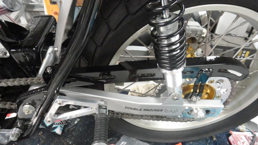

Got my powder coater out yesterday and gave the chain guard a shot of mirror black but unfortunately the hi frequency switch kept failing (which I didn't realise until the end) and I ended up putting on a lot more powder than I had originally planned, which gave it an orange peel effect. I will wait until the bike is on the ground to see how it looks but I think I will end up redoing it. I got a new switch from Jaycar that cost all of $3, so I'll fit that up so I can do the battery box and inner rear guard.

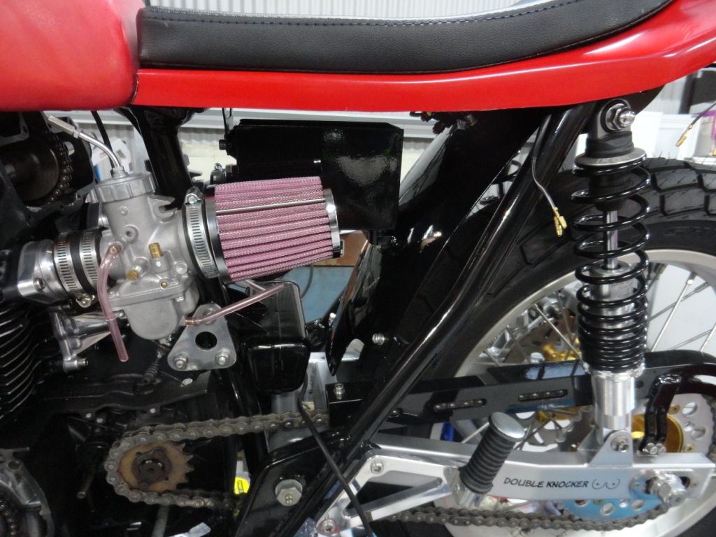

I mounted up the rear brake hose clamps, which I got from a YZ250, and then got out the powdercoater again and did the battery box and inner rear guard. It works a lot better now with the new switch in place, although it didn't cover the chinese wheel marks on the tyre side of the guard haha. I also did the gear lever and kick start lever which both came out quite good too. Finally, I made up the exhaust baffle, but I don't think it will baffle too much. The next thing is to fit the alternator cover and countershaft cover after I have shortened the clutch cable.
