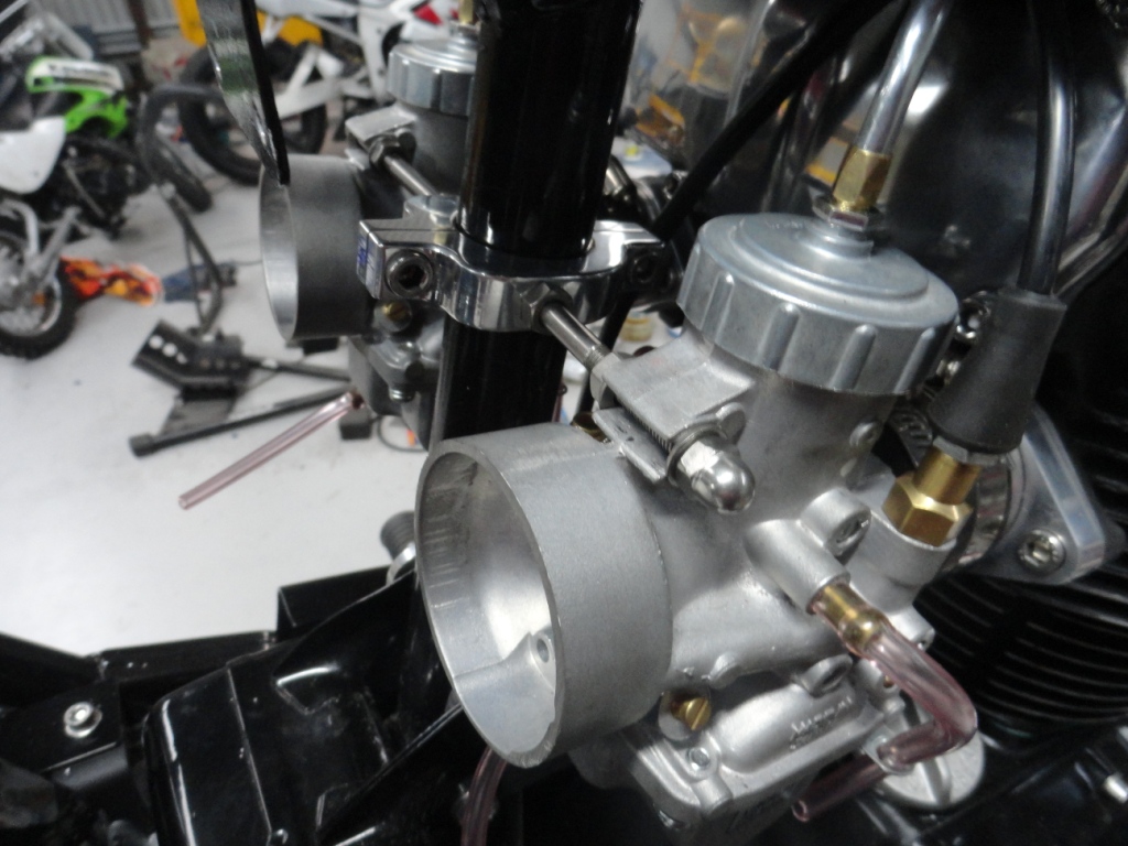

I wasn't too happy with the carbies and air filters hanging off the rubber manifolds so I made up a small adapter which clamps onto the frame. This has a couple of studs threaded into it that go through the clamping slots on each carbie. I think it will work OK but if the vibration through the frame makes the carbies vibrate and froths the fuel then I will fit up some small rubber vibration dampers to each one which should fix that problem.

That is a really nice bracket. Just a thought, the frame tends to resonate at certain revs and just generally transmits vibration. It might shake the carbs up. On our old TZs there was a similar long bolts across the two carbs and it was suspended by a rubber strap from the frame tubes above. A long battery strap would work. Or move that clamp up the tubes say 50mm and modify it to hold one end of a strap.
Thanks Phillip, I have ordered some little damper blocks to minimise the transmitted vibration, unfortunately I have to go away again next week, but only for the week, so I can fit them up when I get home. Good luck on the BOTM mate, I've voted already.

Yes PJ, they were around $8 Australian delivered for the four, pretty good value. I just got home from the airport and they were sitting there waiting, so I'll fit them up tomorrow and see how they look.
And here they are (straight from China no doubt) and all fitted up. They seem to work well and, as Teazer says, should stop the carbs from getting any resonant vibration that will cause frothing.

It looks more 'professional' with the dampers fitted. I would use them because of that even if they were not needed ;D
