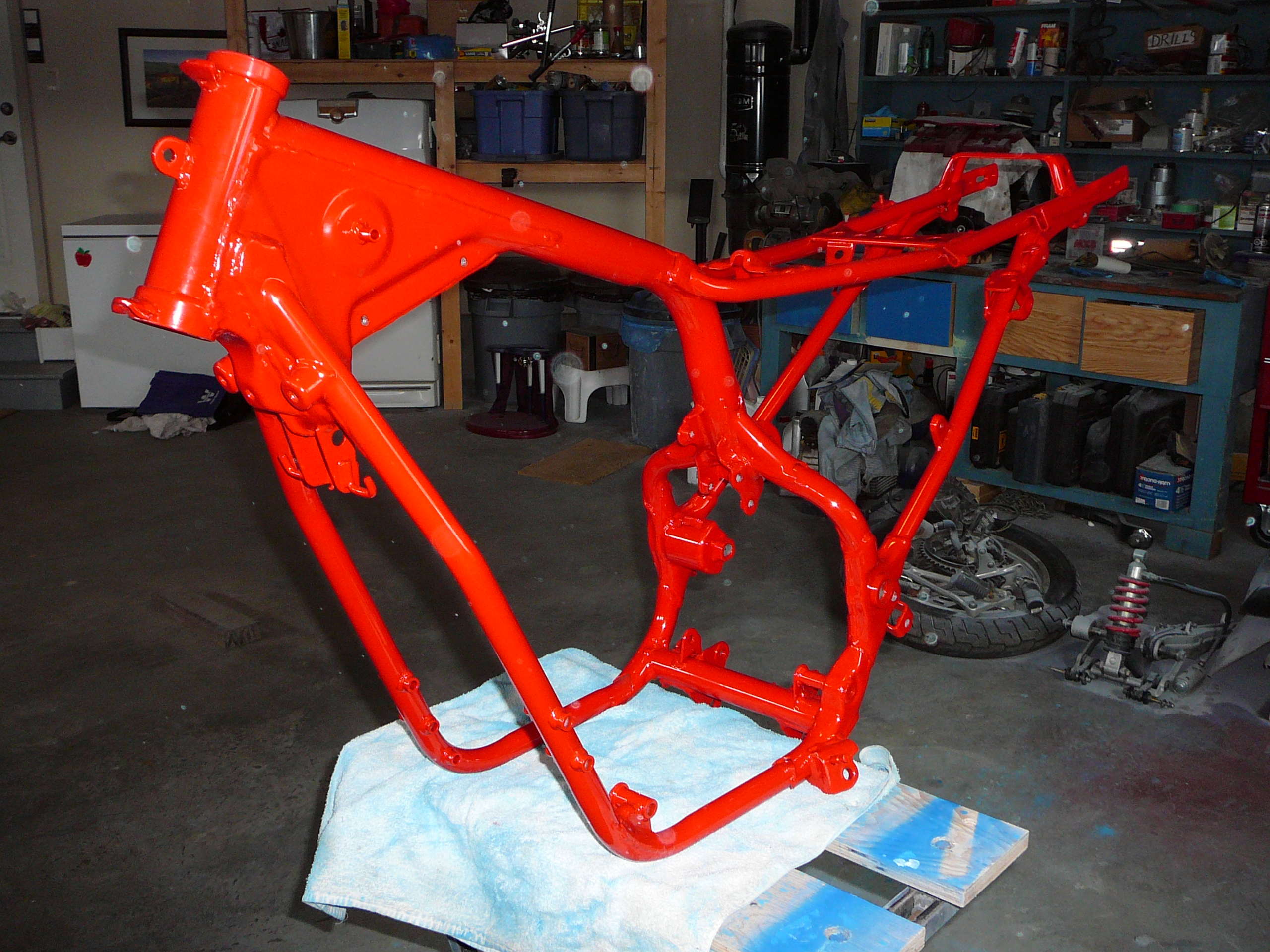

you will be happy with converting to the F2 shock if you are 180lbs+. Relocate the top pivot to keep the stock height. The F2 does have a stiffer spring rate but if you set it at the softest you will still have the ideal sag. You will find that it will be much better composed.
If you do this mod along with progressive springs in the front you will be even happier. The progressive springs for a CX650 are a direct fit. Run spacers with 0 air.
Could not find a good pic of the mod but you can see the F2 shock in the background and the relocated pivot on the frame. I still run the stock airbox without interference.
