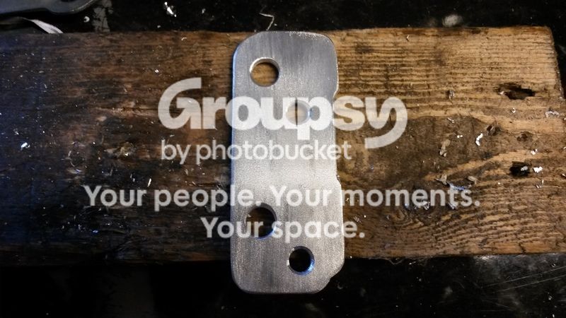

Going back a long while now, I ordered a generic rear brake master cylinder which is nearly correct for the Honda mounts, but the orientation of the pedal lever put the main shaft out of alignment, I knew this and had always planned a cheeky offset mount. Got to make it today out of the 3mm alloy I had bought a few weeks back.
Here's the problem...
So, out came the hacksaw, drill and bench belt sander to produce this masterpiece.....
The little notches are to clear the MC body, came out OK I think.

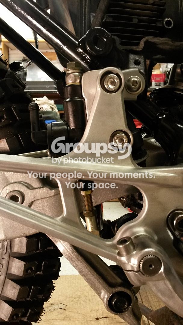

Here it is in place, nudged against the MC body....
This shot shows the shaft alignment is now straight, pleased with that.
