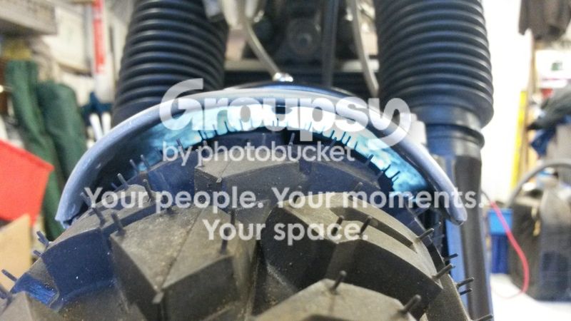

Well, from a few bits of metal I've managed to knock this guard mount out. Cut, weld, grind, fit, re-fit to the power of 10 and it's together at last.
I very pleased with the way it looks, I just hope there's enough real world clearance haha! What do you think?
I like the overall view from 3 mtrs, think I got it right ;)
Oh, I gave the tank a quick compounding and it came up a treat me thinks :-)

Righto....the front guard was too low, Lord knows how it happened, but I've removed it once again (10th time I reckon) and...ahem adjusted the rear hoop to sit higher, this has the effect of raising the guard away from the tyre. I had to redrill the rear hole and pay more attention to the slight slack in the mounting, nipping up the bolts with it in the up position.
There's defo clearance now, the rear of the guard sticks out slightly but, ho hum, that's what you get for using used parts. I still like the snub nose and overall style so I'm pleased and moving on to other jobs.

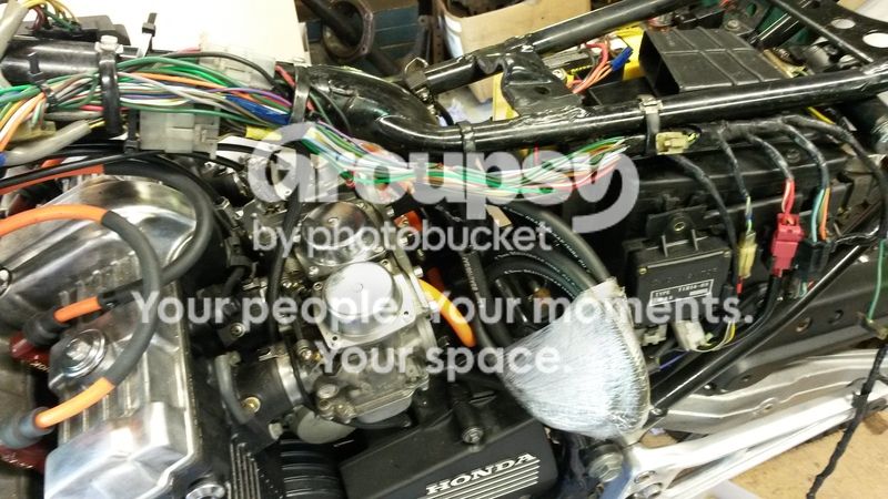

I'm still here......not quite zero progress since my last missive, but I have been extremely busy or too knackered to venture into the garage.
A job I've been holding back on was sorting the 'lectrics, not my favourite discipline. Anyhoo...t'was my son's birthday recently and by way of celebration I had him over for some scran and to help his old man out on the CBX.
I had a great day working alongside my son and thoroughly recommend it to all who have sons (or daughters), spending time just getting on with jobs is lovely.
Despite me and my dicking about, he duly delivered and I am very pleased to announce I now have fully working lights, indicators, horn, starter motor and an array of idiots lights (when I get them mounted), very pleased indeed, thank you matthewdavies.
I have a video short showing the indicators blinking.....we then went on to make everything work. (Will post it up when I can)
And, in other news, I ran a wet test on the carbs by syringing fuel into the main feed, they overflowed as they should and no visible leaks so far.

Sorting out the loom was time consuming and fiddly, but I got it as good as I can for now. Tank is a squeeze to fit, but I think a bit of fettling will see it right. Had a good day working my way through my job list...seems strange to be fitting parts for the last time.....I hope?
Wiring is now a bit tidier,
Mounted the rear brake reservoir to the battery brace using the brace bolt, just had to cut down the rubber pipe 30mm. Motobatt appears to be working correctly. Had to splice in a new main 30amp fuse as the original had decomposed or I can't find the fuse bit?
