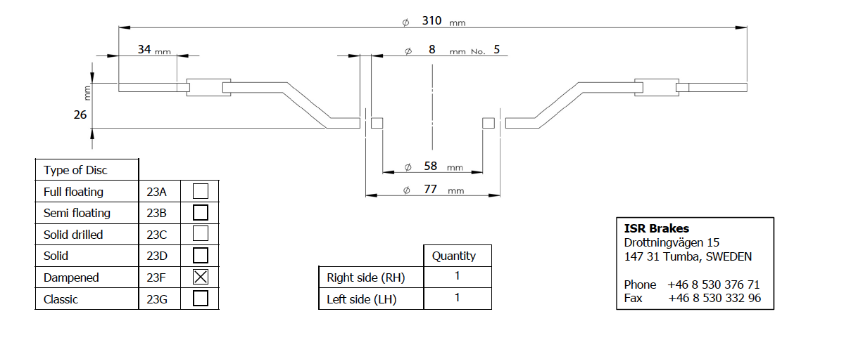

Finally your going to need custom rotors with 5 bolt pattern and offset and size of GSXR calipers. I'll attach my order form if you need to order them made.

Another plug is ISR Sweden. They made my custom rotors. They are even harder to speak to, you'll have to rely on email to make the order, and their eMail is almost non-responsivze once your order is made. Also, you have to wire them money converted to SEK. I think mine came to like 4000:-SEC which is like $450. If your going to order, here is their form to download the form below to send em: http://isrbrakes.se/products/brakediscs/custom/ I emailed it to them, but they ask that ya mail or fax it, haha yeah right. Finally attached are the measurements I sent in my order form. IMPORTANT: I entered 26mm for the offset because I measured the caliper offset was 21mm and added 5mm for width. But when I mounted the rotors, they rubbed the inner pads a little, and needed to shim the rotor mounts to center them perfectly. You could offset this by ordering the offset to 22mm or 23mm which would make the height 27mm or 28mm, and this might align better, but I think the option to shim is a luxury and if you went too offset you won't have the option. I ended up adding about 2mm in washers. But its your call. Once the axle is bushed and spaced and you get the wheel and rotors on, wheel spins good, then tighten everything up.

erock85 said:
Here's what I would do:
It appears the rotor center spacing is 132mm. The hub is 70mm on Comstar, from rotor mounting surface to rotor mounting surface. Your rotor spacer has to be 28.5mm on each side to correctly space the rotors in the center of the calipers. Next get some Hayabusa rotors, specs on those are PCD: 91mm; (5)10mm mounting holes; OD: 320mm; ID: 69mm; Thickness: 5mm
Clock the rotor spacing to the Comstar hub spacing on your 28.5mm spacer ;D EDIT: you'll want to countersink the mounting holes from spacer to hub
Then you will need 5mm caliper spacers, cheap to buy or I have a drawing to get them made. I had mine made.
eRock, question on your measurements here for the rotor spacers... since my hub mounting surface to mounting surface is 80mm instead of the 70mm you have, would my spacers need to be 5mm less on each side (23.5mm?)
