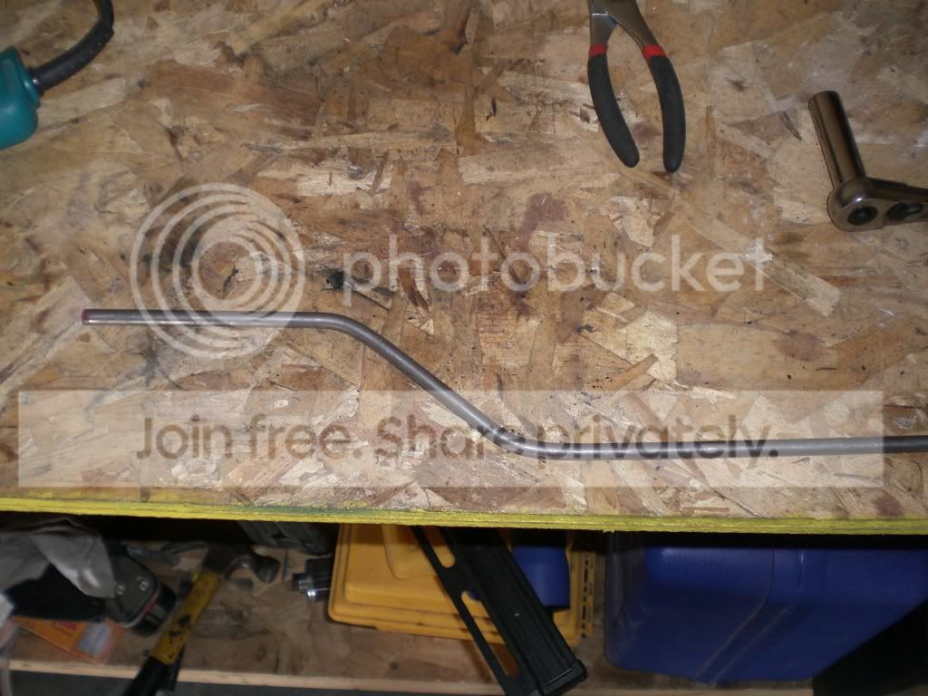

Allright a few pics of the rearsets. I think I've got the brake side hooked up. It works by spinning the wheel and stopping it. I'll have to wait to see how it performs while actually riding. My only concern is when I press the pedal the linkage rod moves up a little before it goes forward to pull the brake. I also picked up an HID headlight kit for $15 shipped on ebay! Not sure if the charging system can handle it or not, but I'll give it a shot. If not I'll change out one of the lights on the ruckus for it.
Shifter side
Brake side
The rod I bent for the brake linkage, I forgot to take a pic after I cut it to length and then threaded it.
All hooked up!
Re: CThor's 1972 CB450
I still need to drill out holes for both of the front holes on the mounting plates. I'll have to get to that tomorrow. As far as the shifter side instead of ordering a $20 piece that connects to the shifter shaft, I'm going to cut the old one off the original shifter. The original shifter was all bent up anyway. I should be able to cut it off and leave an inch or so of the lever. Then drill a hole in that and connect the rod to it. If that makes any sense at all.. ha ha
I forgot to say that on the brake side I drilled out the hole in the small piece that holds the rod to the brake drum lever. I also drilled out and retapped the brake adjuster nut to fit the bigger rod.

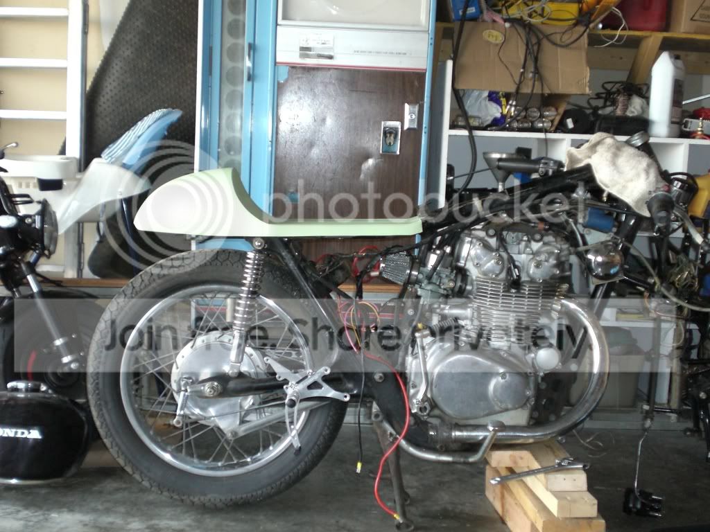

I don't have the tank on, but I took a pic of the seat sitting on there after I cut 3 inches off the front of it. It was just a little too long to me the way it was before.

hey
i see a ruckus in the back
kind of remindes me of my bike and the wifes ruckus
