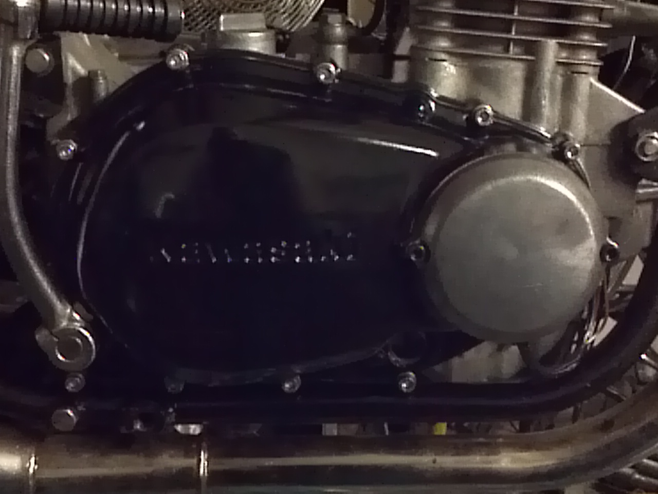

I had a leaking clutch cover gasket, so I decided to do a little painting.
Here are some pics.

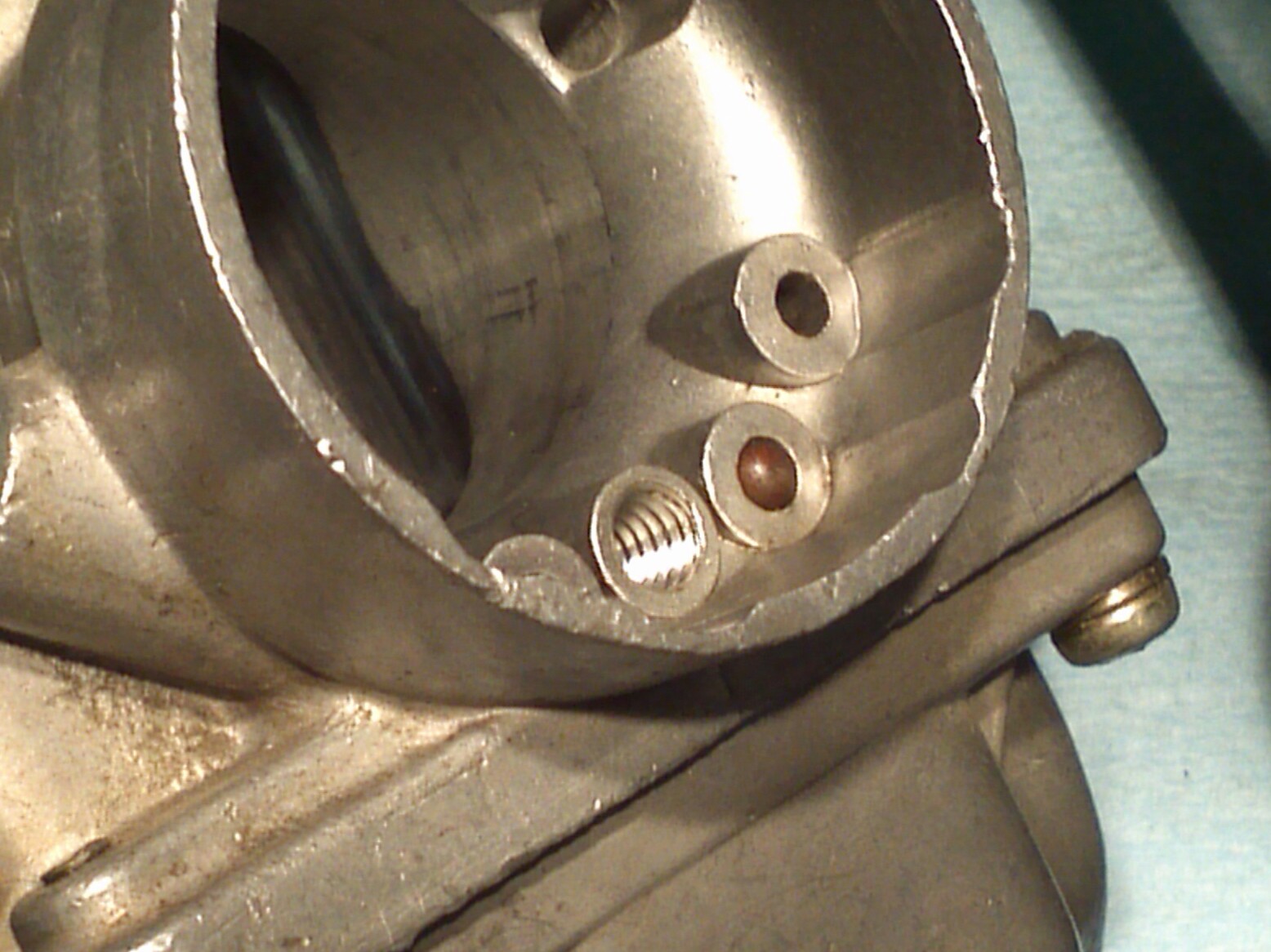

On Dr. Jekyll I'm temporarily running a pair of vm28s from a Yamaha.
The air bleed going to the needle jet is to large.
If you look at a 4 stroke carb there is a brass insert with a small hole like this one.
I used a pilot jet from a bs34 Mikuni for a restrictor.
Drilling a .8 mm or .032/32nd in. hole to start with.
Next I tapped the air bleed with a no. 12nc (24 threads/in.) machine screw tap.
Threads are not a prefect match but real close.
For now jetting is 15 pilot and 100 mains.
So if you are fowling plugs,maybe to much air is getting thru that little hole and forcing extra fuel out.

Next time just tap the mouth for standard Mikuni air jets which come in different sizes :-)
Just using what I have on hand.
Maybe you could post your own thread on the subject.

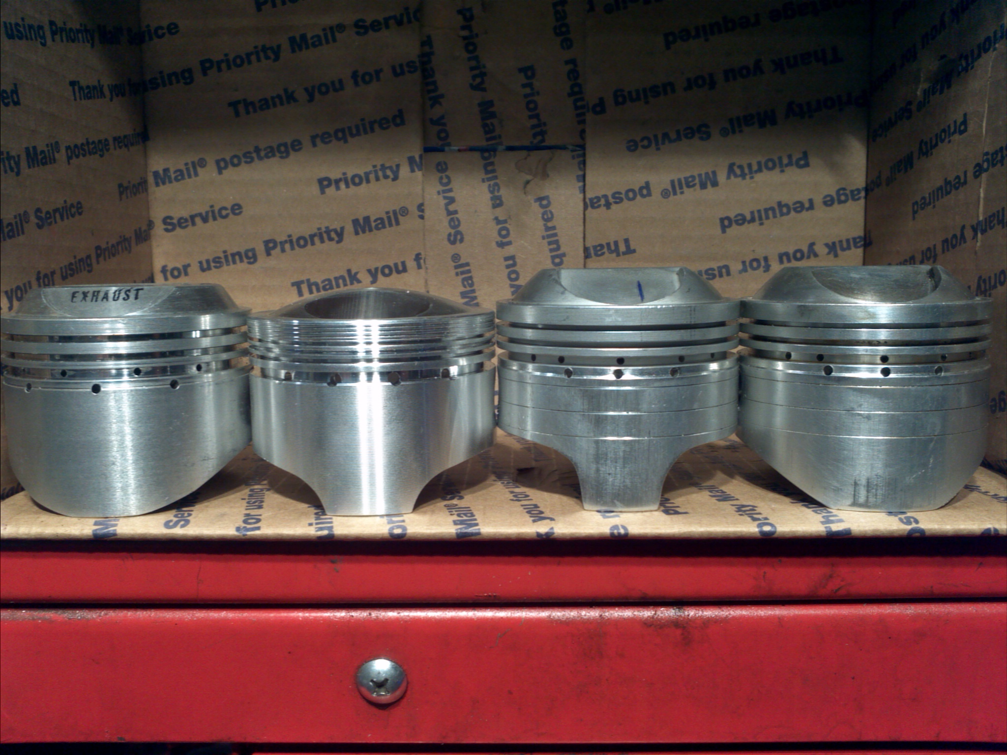

From left to right;
1) Old Wiseco big bore KZ400 piston,listed at 10/1,12 cc dome,11.5/1 for my application, 67.5 mm (440 bore ) 223 grams
2) Wiseco KZ750/4,5.2 CC dome,8.3/1 with the stock 440 combustion chamber,9.3 for me,69 mm,239 grams
3) Old JE(?) piston for a KZ750/4, modified/lightened skirt, 68 mm, taller dome than piston no. 1, but deeper valve reliefs, maybe 1 CC more dome volume than no. 1, my calculations come up with 11.7/1, 238 grams
4). Unmodified version of no.3, 252 grams
I'll be using a head that is milled .035 in. and no base gasket.
I decided to go with the old high domes with the modified skirt.

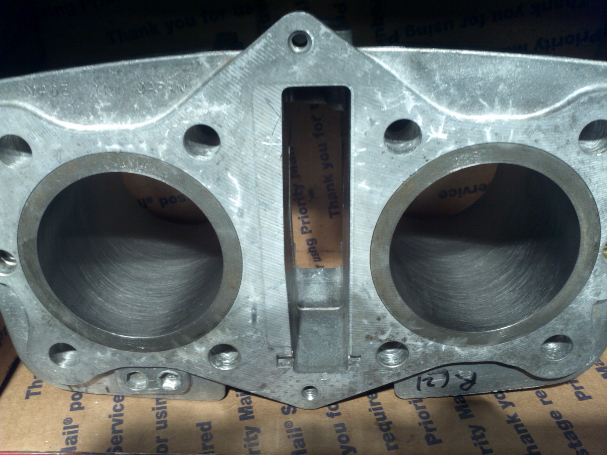

Freshly bored and honed cylinders.

We have to do that mod on almost all GT750s with stock BS40 carbs because they surge. Suzuki used to sell special air jets which of course were available from Mikuni for a whole lot less. I have a reference to that carb at http://pinkpossum.com/GT750/carb/BS40carbs.htm
BTW, nice collection of pistons.
I knew the Holley tuners used removable air jets.
Didn't know about Mikuni's.
I think I need to take a harder look at the Sudco catalog.
Do you know what size thread is required?
Hmm. I forgot to include that in the blog. I'll go and measure one.
edit: I just checked and it's a 4mm x0.7mm tap which is available from any decent hardware store - mine was from our local ACE. Air jets are used extensively in larger VM carbs. Typically two strokes are 2.0mm or no jet and 4 strokes are much smaller. On the Suzuki GT750 we add a replaceable air jet to the pilot air system to trim slow riding stumbles.

Thanks for the reply,the info will be put to good use.
