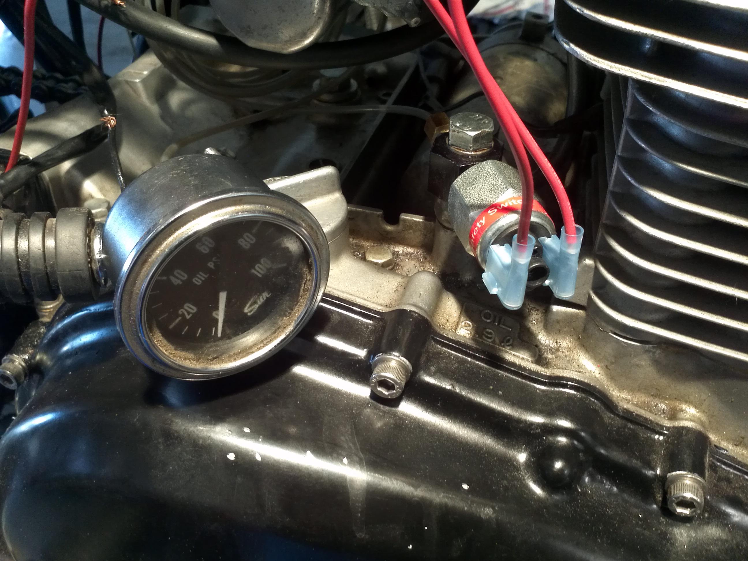

Today I modified a bolt from the hardware store and a fitting that came with the
adjustable pressure switch.
As you can see it also has an oil pressure gauge along with the switch that will be
used to control one of the signals for the fuel injection.
All to replace the stock bolt and one wire pressure switch for the idiot light on the dash.
In the bottom pic are the counterweights with the end cut off of one to slow down the
advance rate.

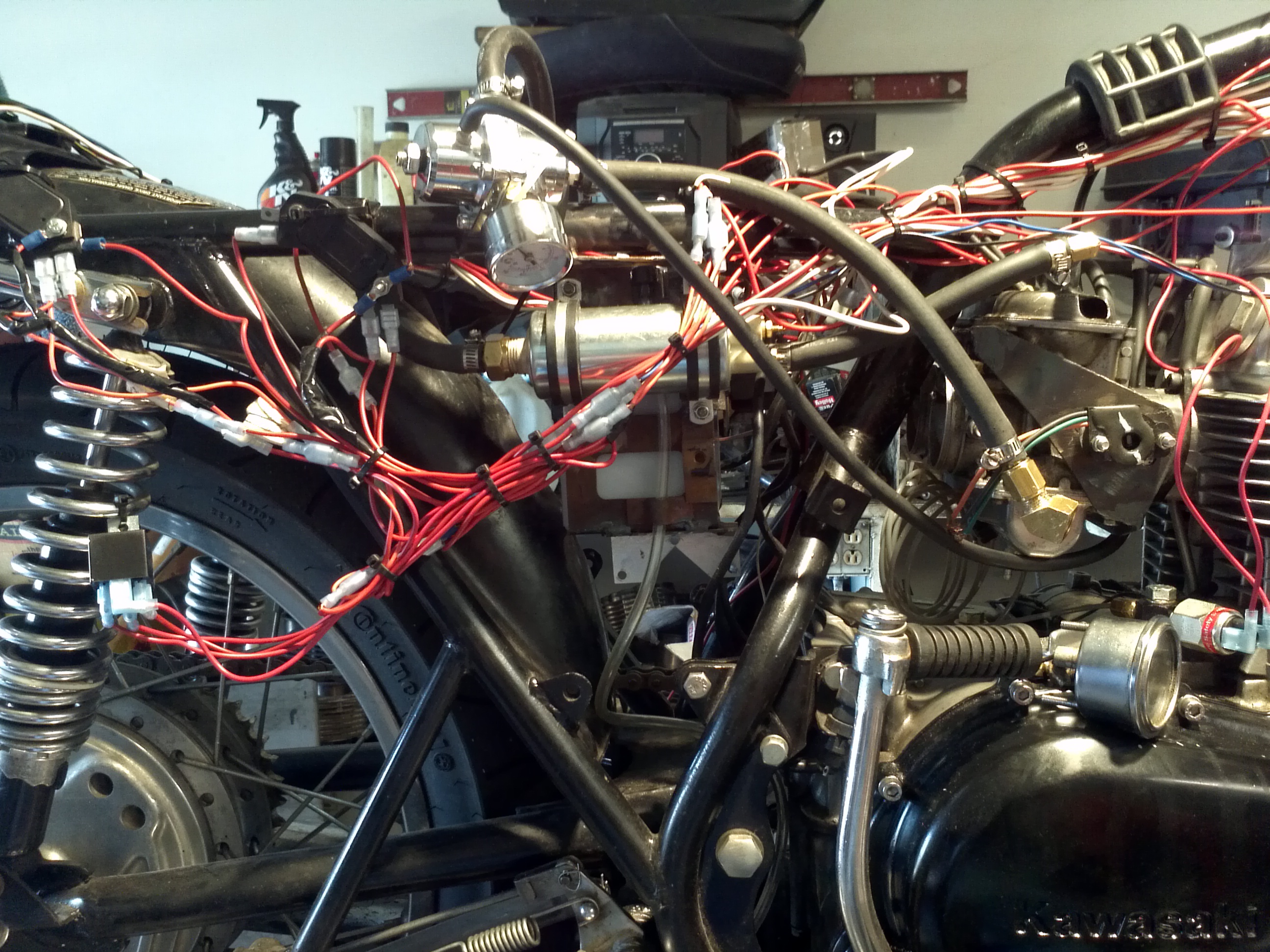

Got everything assembled except for installing the tank and pulse width modulator.
As you can see both hei modules and the relay switch.
The relay turns one of the modules on and off.
It it activated by the adjustable pressure switch.
The path of the fuel starts on the left side of the tank at a barrel valve.
From there it goes thru a filter, then to the pump, the fuel rail/throttle bodies,regulator,
and back to the tank on the right side.
If this all works and can be adjusted to make the bike rideable I will permanently mount
The components and clean up the wiring and plumping.
