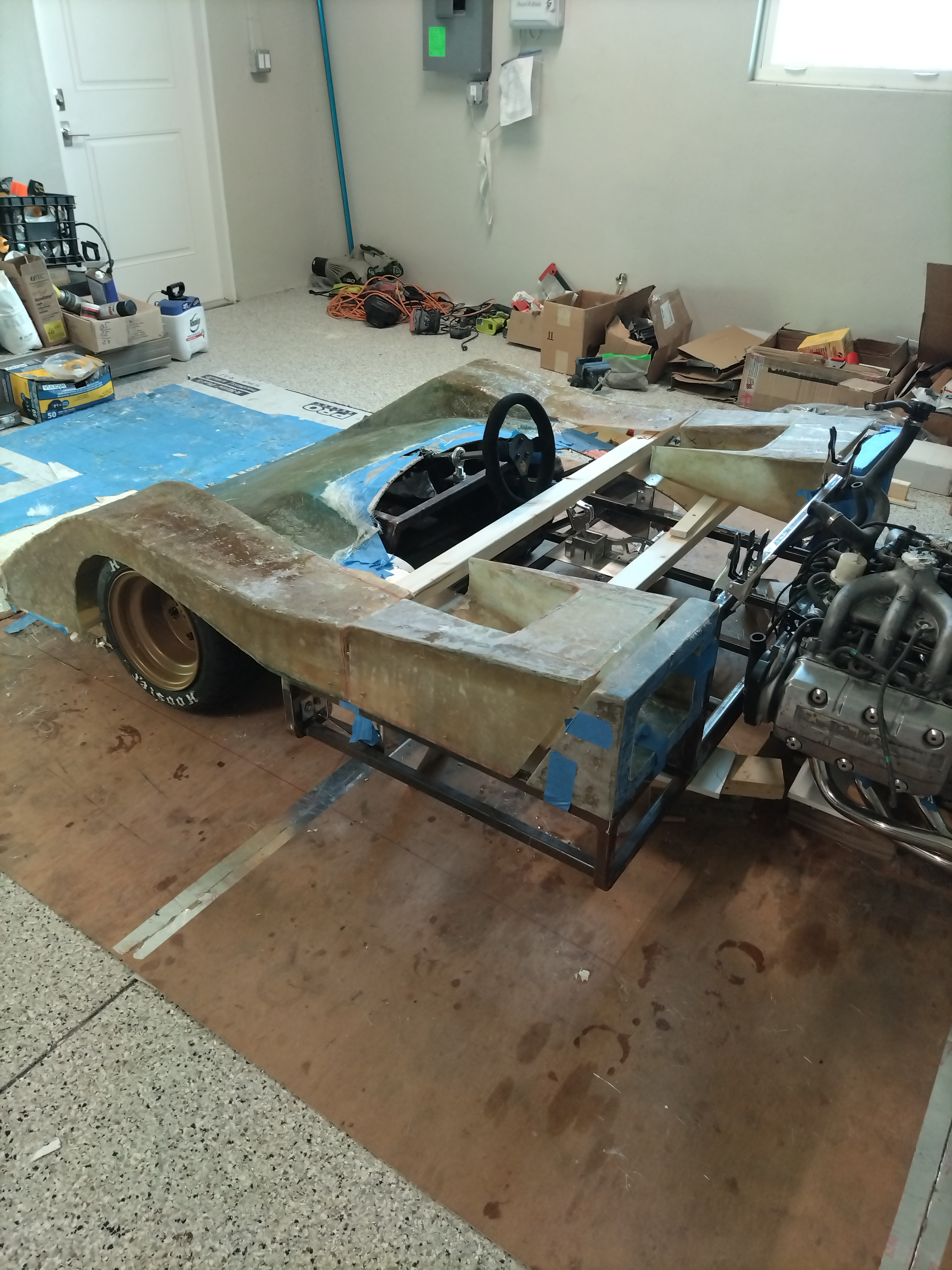

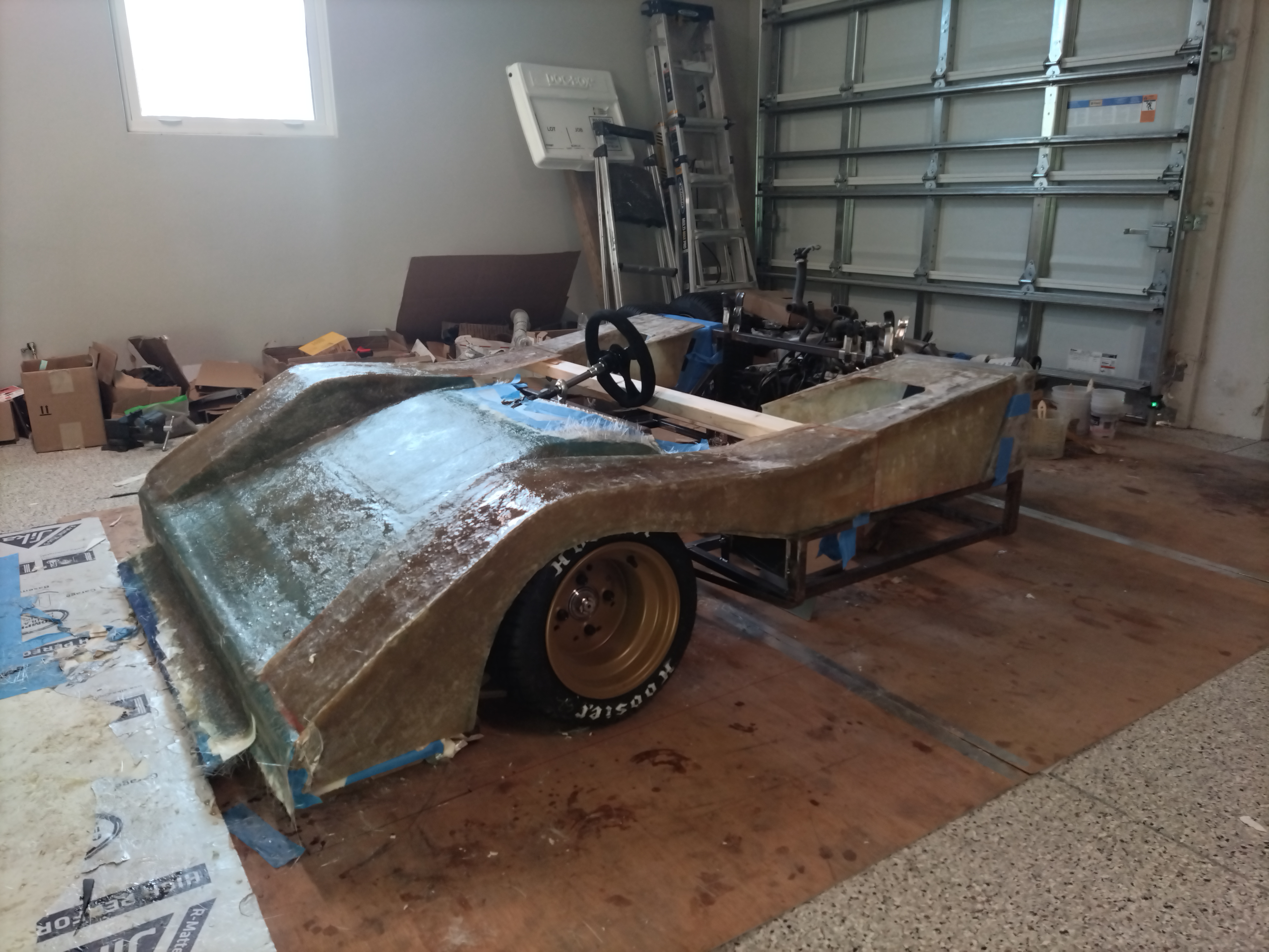

That's what I'm going with then! Making progress!!!

Thank you, drive shaft should be done in the next few days (machinist was dragging his feet!) so then I can finish the rear subframe.

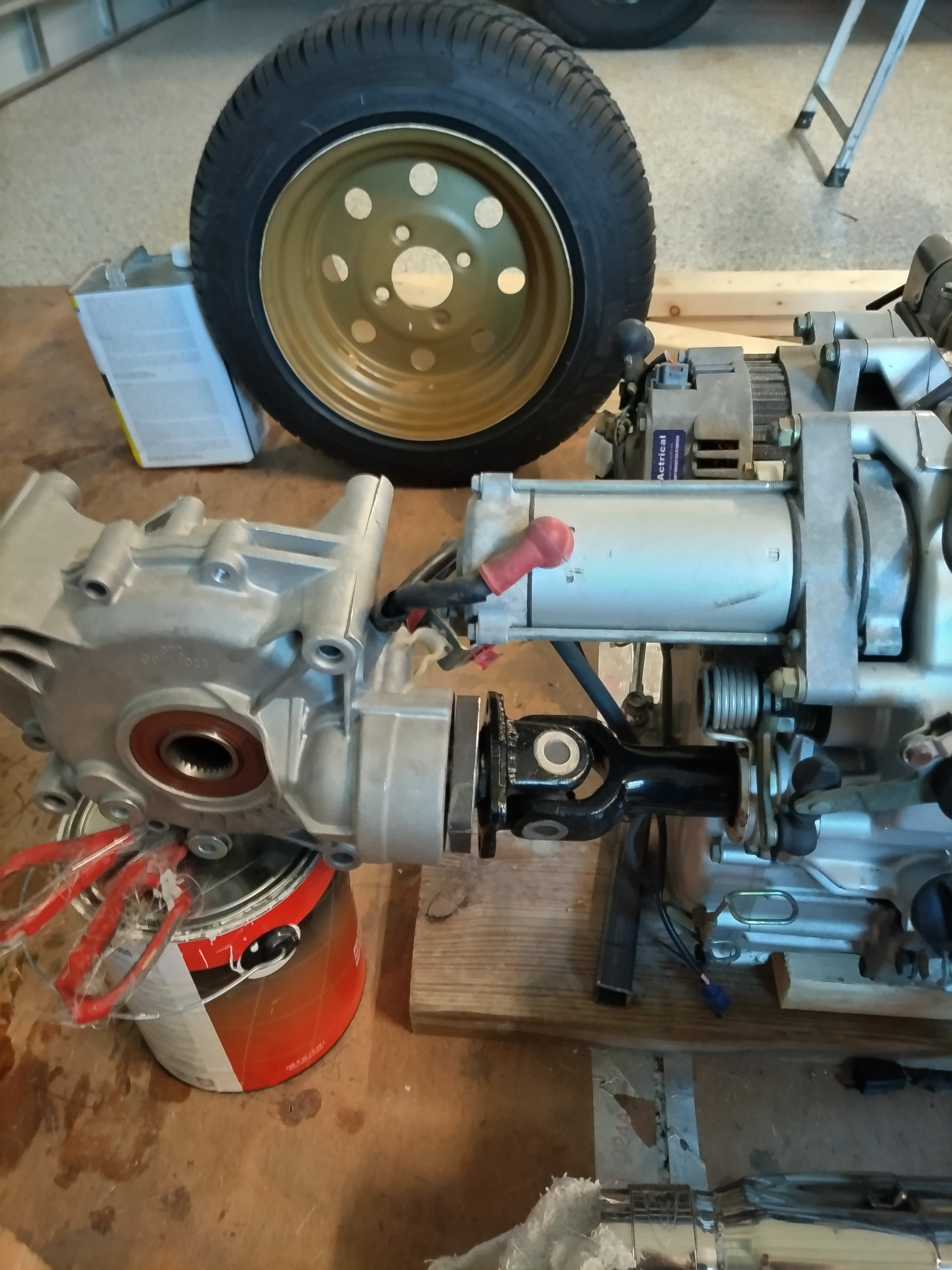

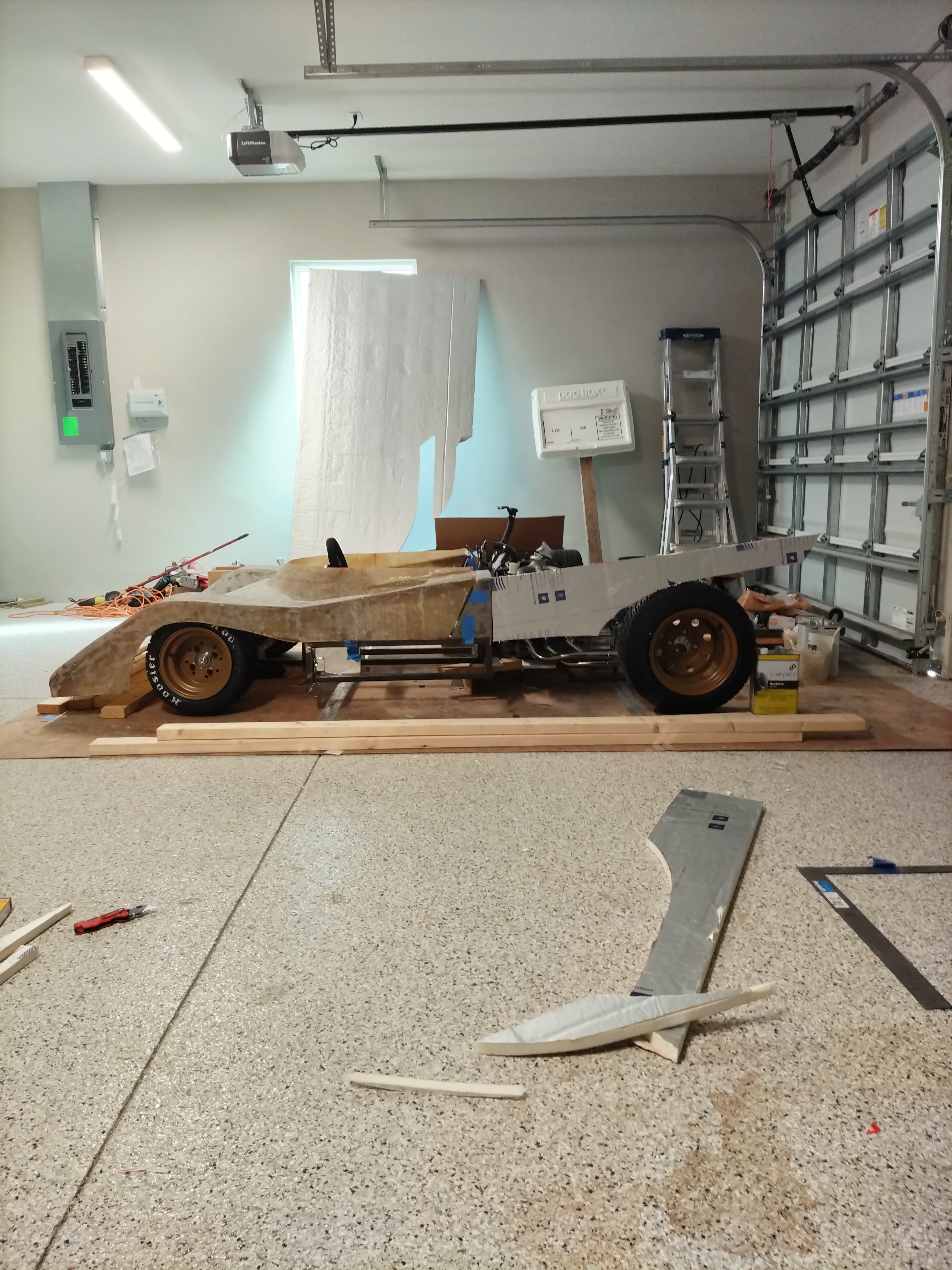

Drive shaft is done. It is a bit longer than I would like. Debated make a shorter solid shaft but I like the fudge factor a u joint gives me. I still may make one anyway. Here is the mock up and generally where the wheelbase will fall.
Polaris sportsman xp1000. Picked it because it's hp and torque are very similar to the goldwing.

I really debated using a Valkyrie motor but it doesn't have reverse and hp and torque are essentially the same although the Valkyrie revs higher. Looked in to swapping to Valkyrie carbs but not really viable. Here is a mock up scaled rear section and a pic with me to show the size of it.
I wasn't sure about the numbers between the Valkyrie and the Wing, and it seems pretty obvious that you've done lots and lots of research but I figured I'd better throw it out there just in case. If memory serves it seems like the Valk had different cams to get the different rev profile. I also remember reading that Honda managed to get it though DOT inspections w/ straight through exhaust pipes, maybe there's a difference there as well. Didn't mean to throw a wrench into the works... carry on.

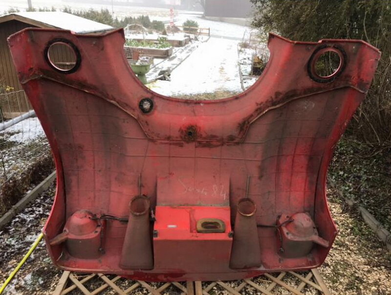

Yes there are a number of differences between the two, I like the higher redline of the Valkyrie it just all came down to reverse. Not huge progress but a Ferrari forum member had some pics of the back side of the front clip so I finished the headlight buckets and center inlet all that's left is the brake cooling ducts.

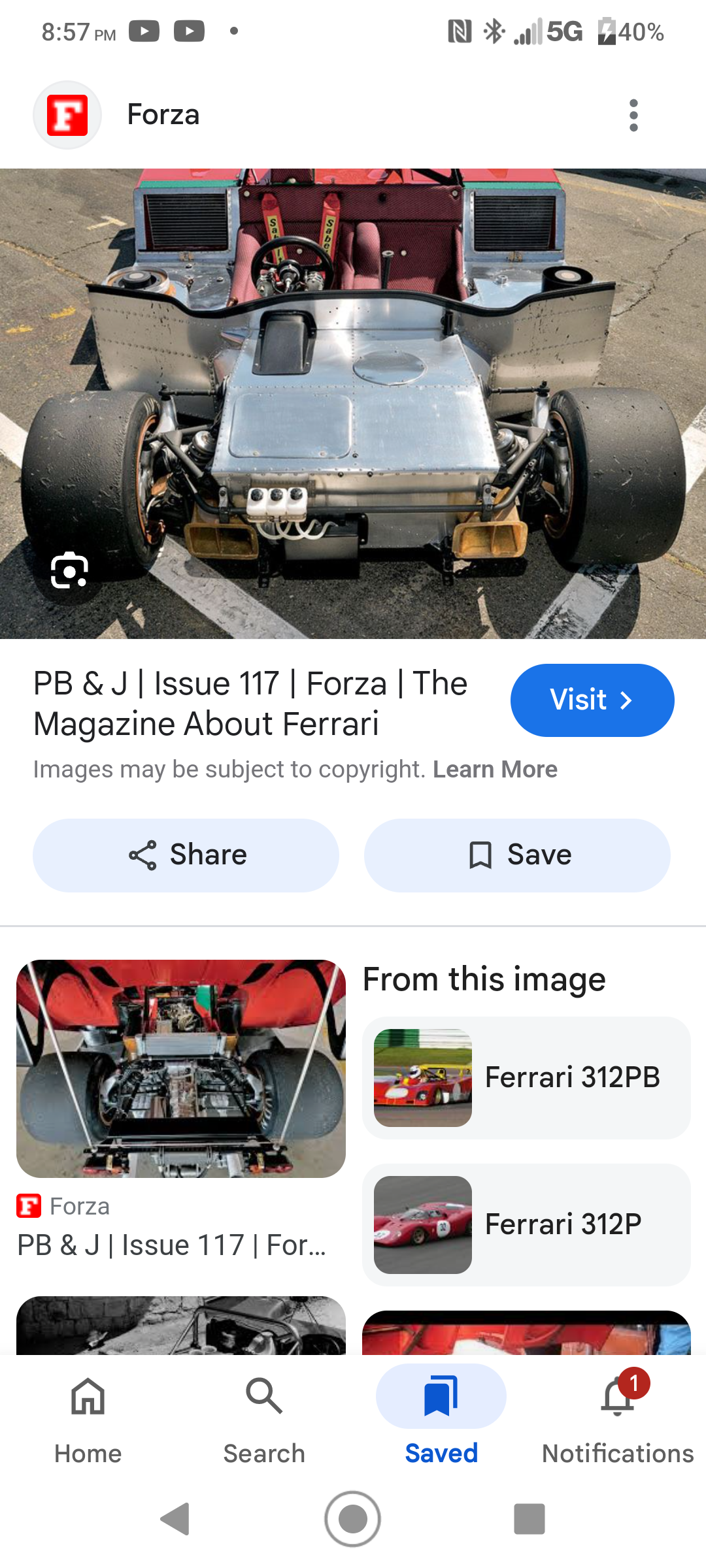

I designed it from scratch. I used images on the real deal and models on line to scale out the size and made tweeks so it could be possible to fit in. I debated actually building an aluminum monocoque like the original but desided against it for obvious reasons. I am going to rap in aluminum there are two main variants and not sure which way I am going to go. First pic is earlier versions second pic is later.
