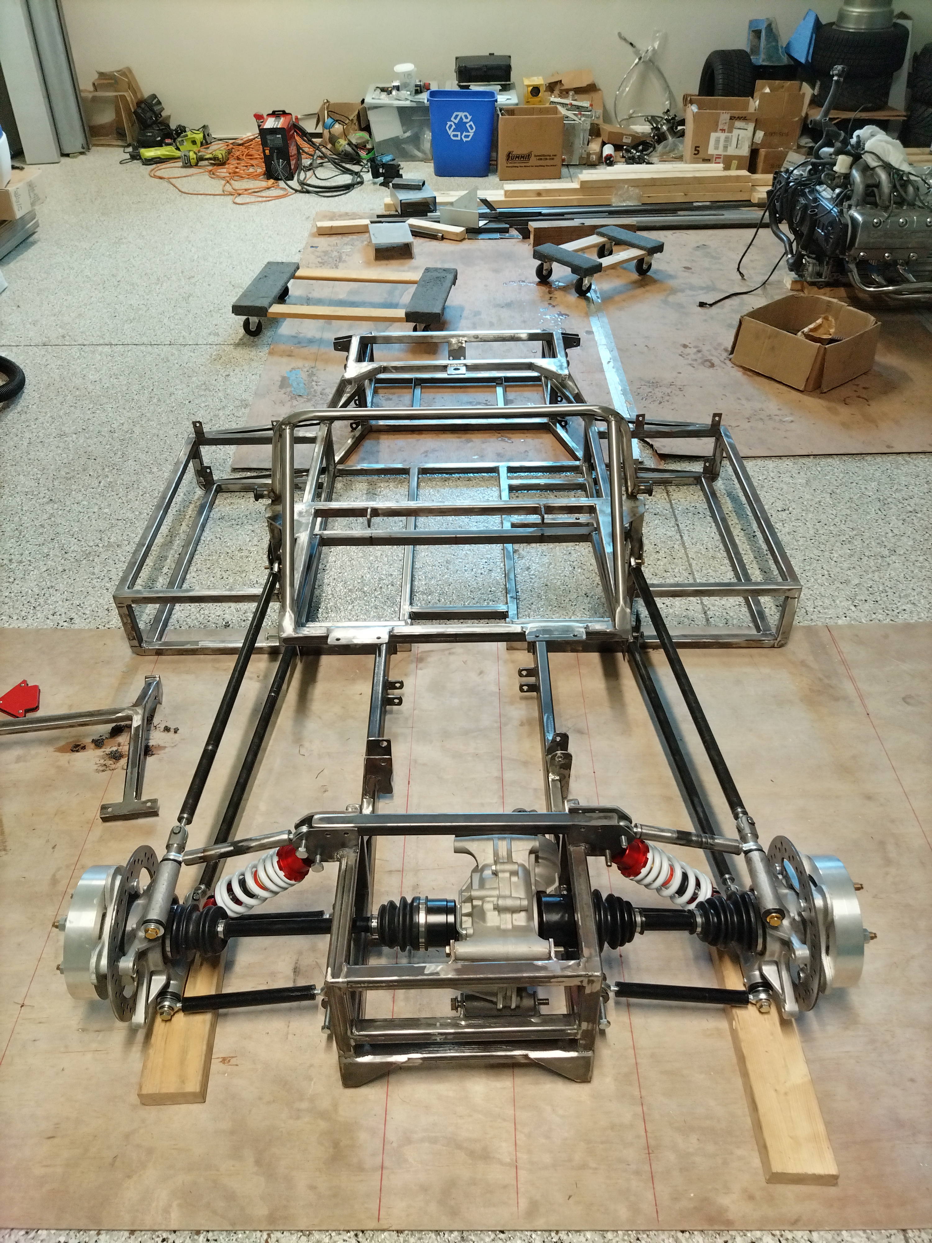

Thank you! I didn't realize the st1300 has gear driven cam! It will bring back memories of my 1987 vfr700! Rear suspension mostly done, need to make the 4 long links to run from top and bottom of knuckles to the main frame

Subframe looks great! Very clean work. Maybe I'm missing something, and I'm no engineer, but with all the joints being heim style, what keeps the rear wheels moving forward and back? I'm assuming some kind of leading or trailing arm that isn't in the subframe yet?
Got it! I love the v4 sound! Yes there are four, 2 from each knuckle (hub) this is a model but clear pic

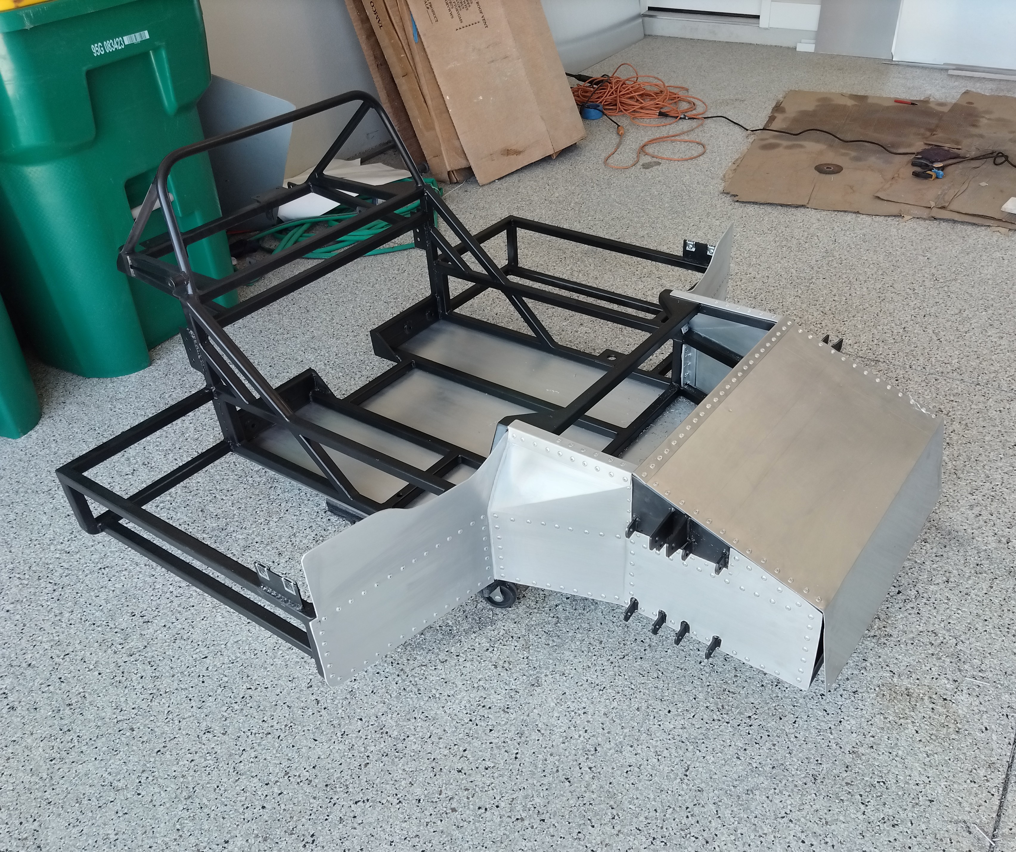

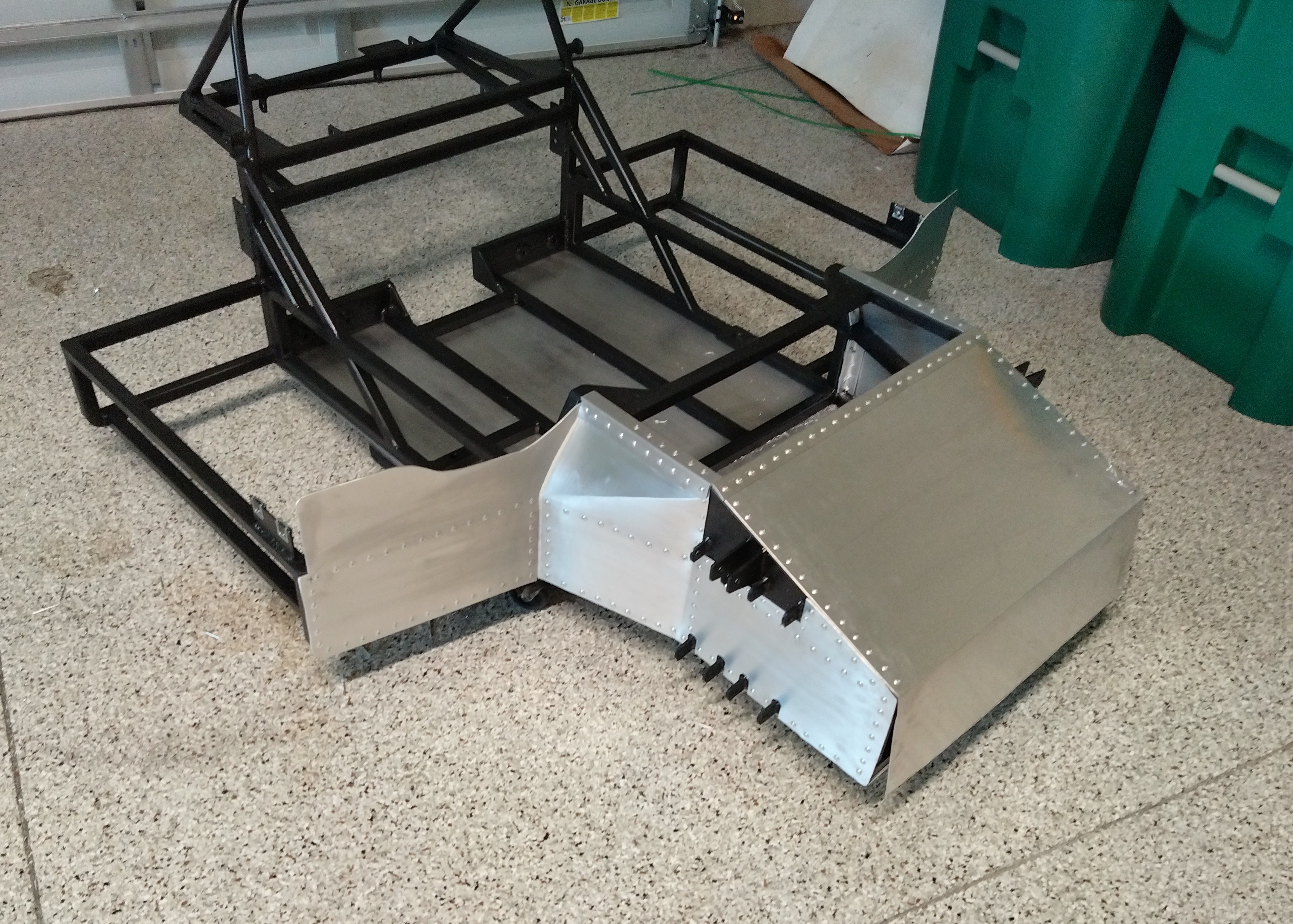

Started aluminum! It's a real pain to work with but I'm figuring it out!

Nice work as always! Have you ever used clecos? A simple kit like this may work wonders with your aluminum fitup. I'm not well versed in them, but have used them enough to know how handy they are.
https://a.co/d/7yOMqZC
