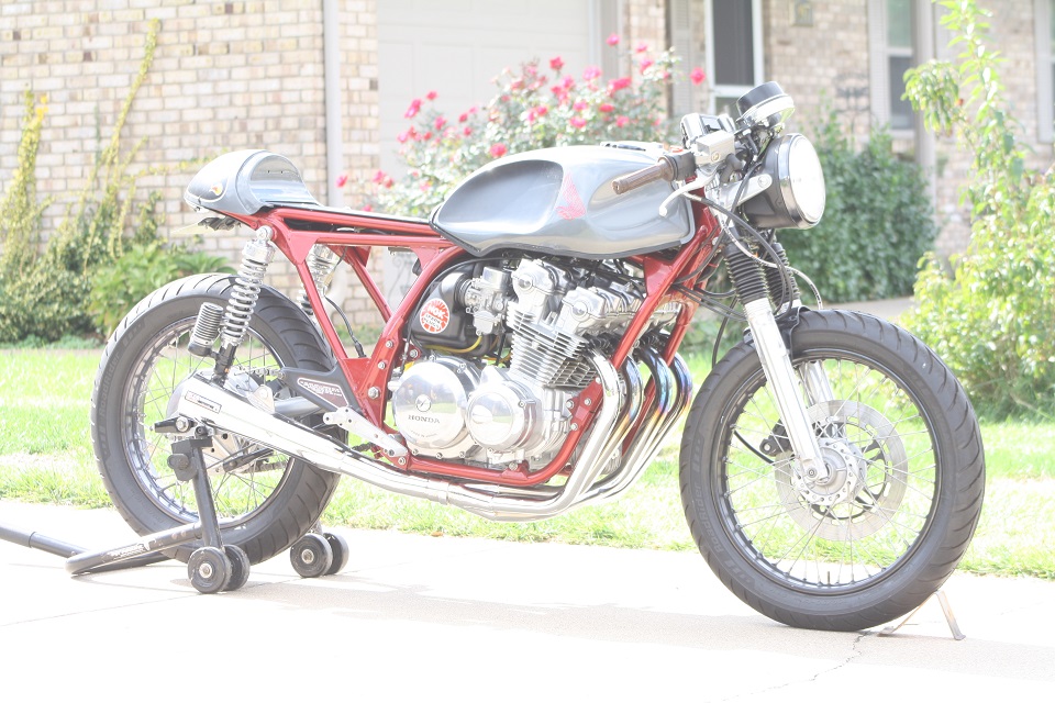

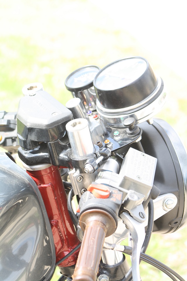

What a bitch that was! Got everything buttoned up and the DOHC roared to life! Now to upholster some kind of seat and polish up the aluminum that got all dull and nasty during the repair process. I did get to ride it around the hood. All the H-D foos be starin' Ha!
All that is left is upholstery and tweaking of the carbs. I apologize for the overexposed pics.

Biker reject,
Glad you're finally (almost) finished! Your awesome bike has been a big inspiration and its looking great as ever!
I've already stolen your taillight idea but it makes me ponder tank dents as well..... hahhaha
As you can see, I did have to reposition my rear sets. They are now very close to the stock location! The difference between the two locations is very noticeable. It's now quite comfortable even without the seat pad and handling feels very light/responsive.
I'm really diggin what you've done man, very nice!!
Can I ask (if I've missed it), what is the technical name for the color of Grey on your tank? Totally dig it!
Thanks! Since this took me so long to complete, I was able to change this and that until the bike was just right. My vision was to build a nice solid cafe style bike without too many one of a kind parts or so called bling, good proportions and stance, and still have it be a head turner. I think I got pretty close.
ya done real good it looks great you kept the airbox and have the footpegs located correctly you didn't go crazy silly with fat tires gotta love most everything about this bike
however you have really upset the balance of the bike,the way the rear is raised and the front is dropped
a steering damper and/or extreme caution should be used especially on off throttle coming down from speed ,speed wobbles, look for them in your future and they aint any fun, in fact they can kill you
i can't imagine how nervous feeling it is at speed
there is really zero reason to have the thing messed up like that 'cept it looks cool in pitchurs
