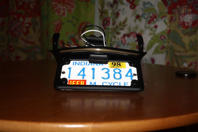

Final iteration of the undertail. Radienz integrated tail light, license plate bracket ($3 from a Yamaha at mc salvage yard), and license plate light on ($4.95 Pep Boys). Ready to button it up!

Watch the license plate when hitting bumps man, unless you have some nice firm firm shocks you may be disappointed when you hear a loud bang going over a high speed bump and realize your tire ate your license plate. It happened to me and thats why I switched it up and got a much firmer shock. Fantastic build by the way!
Where did you get those lights? I have been trying to build some but I am terrible at it. I've seen the FLEDA system, but it costs $500. Where did you find yours?
Found it: http://www.chromeglow.com/catalog.asp?prodid=605465
lol much firmer shocks are a bone-headed way to correct a license plate mount design fail
