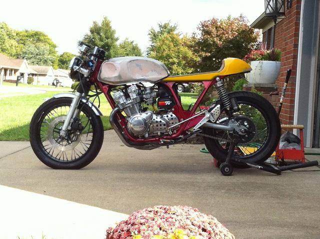

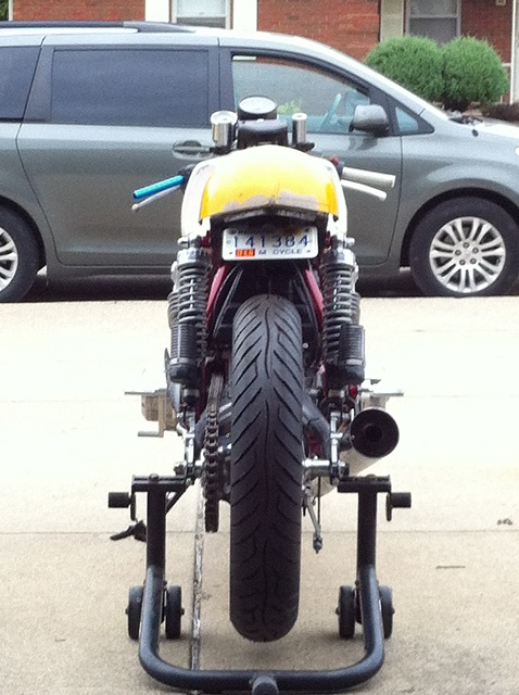

Little progress to date. Plate mount done. Pesky seat fitment just about there.
I tried playing around with your seat as practice. Hope you don't mind.
Pretty sure I made it look worse though.

The forks on the '79 are freakishly long, added to that, a 19" front wheel. The stance was a big issue with me from the start. Dropping it through the triple and raising the rear ride height was the only way I could see around it. If I were to do it again (and I probably will since I have done it twice on two other projects), I would do a front end swap to modern USD forks.
I am counting on this set up to work. The forks are shortened 2" and beefed up with Progressive springs. The bike hasn't been road tested yet, so this is how she sits with 5" of travel. I don't think I sacrificed shit. And yes, looks are a huge but not the only consideration! What's your ride look like? :-D
