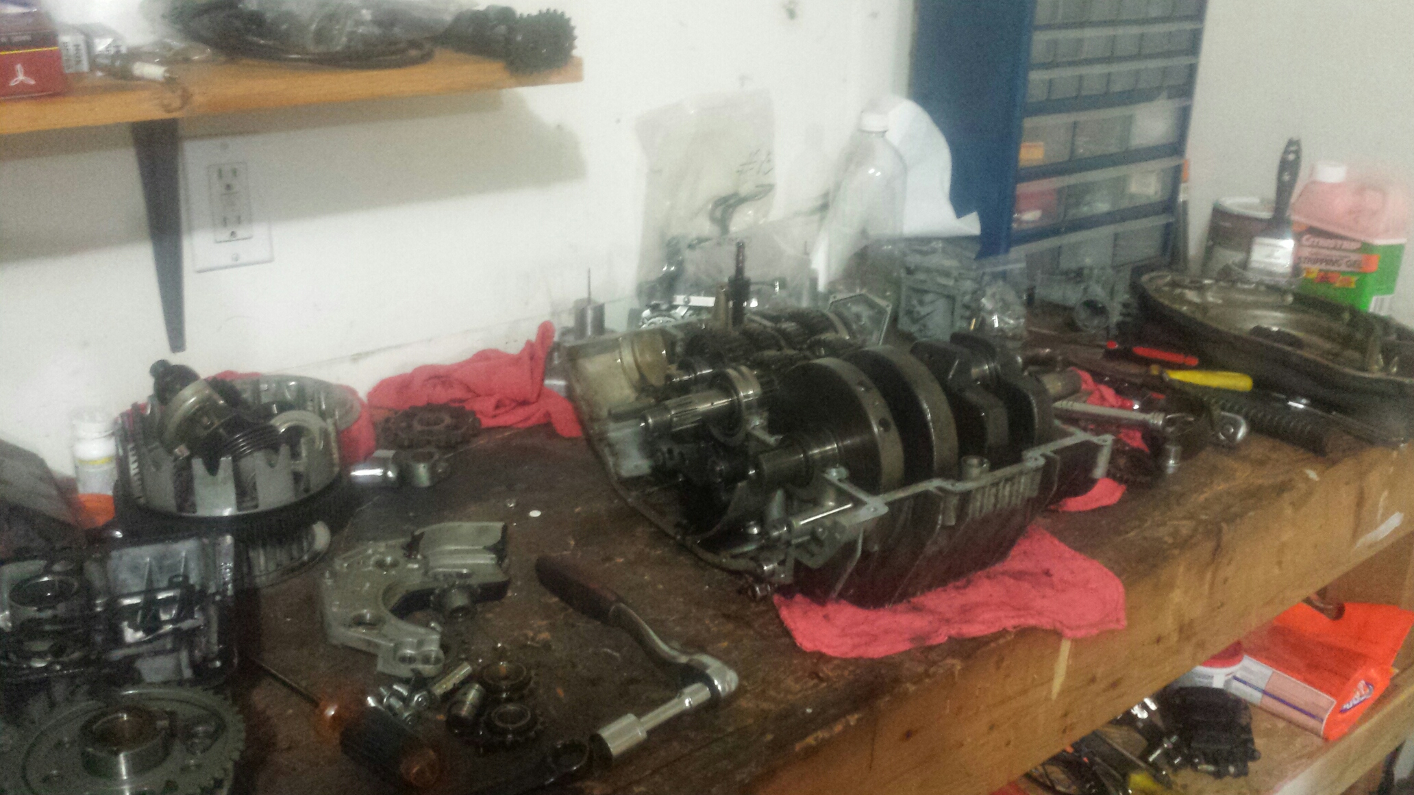

I done did it now..
This is the spare engine that I needed some parts from. Specifically the 1 piece head. Between yesterday and today, this happened:
