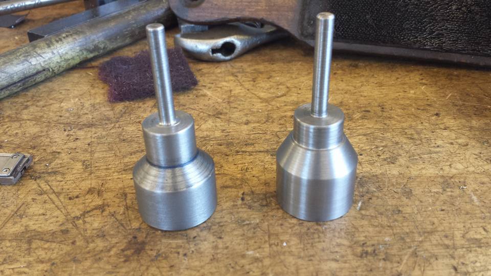

As promised, here's my blanks. Turned them on one of our lathes at the shop. 30 and 45 degree for the intake side. This weekend I'll be getting the intake seats taken care of. Next week I'll make the exhaust blanks and then get those taken care of as well.

very nice custom tools Ian.
