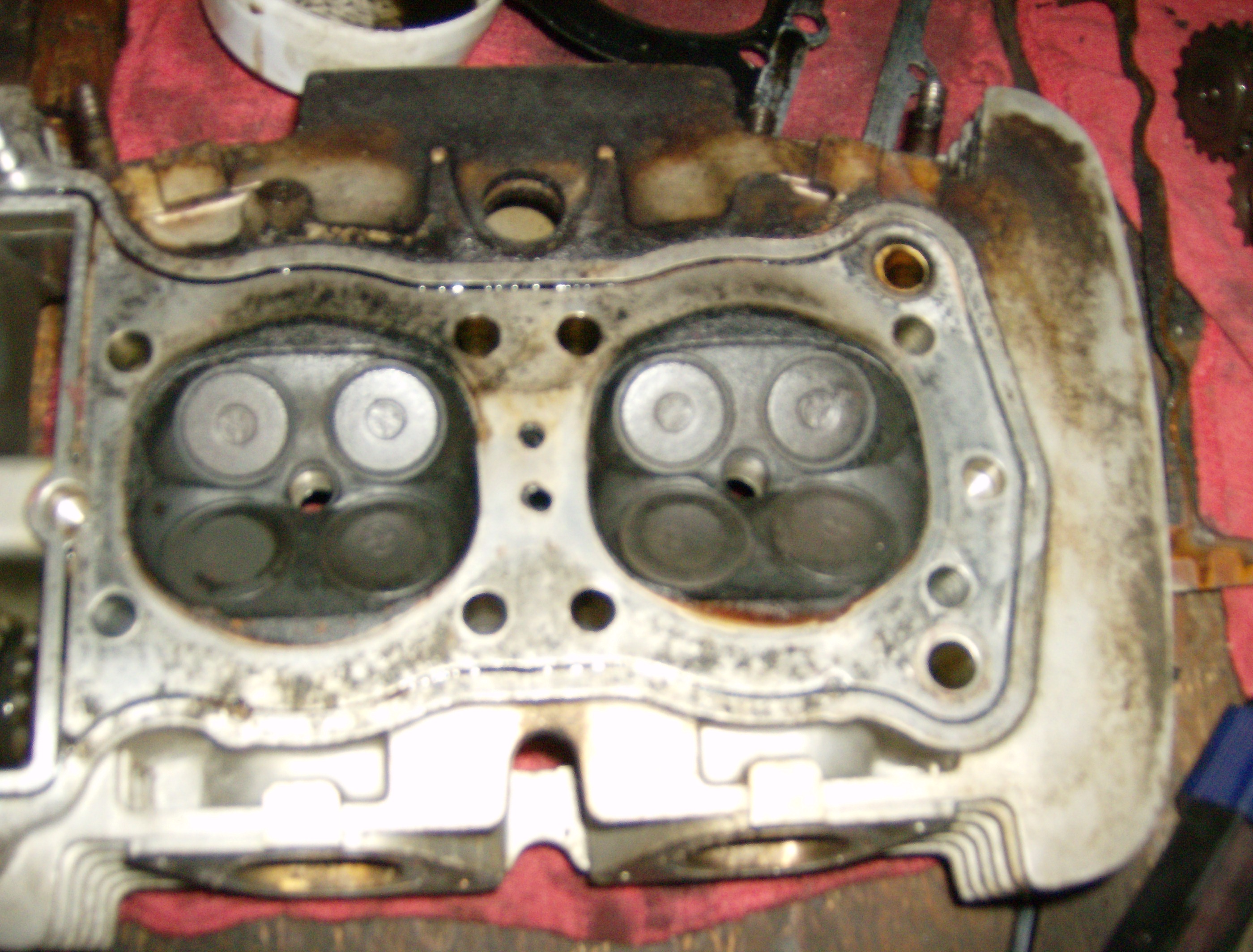

The head itself is in ok shape. Needs some serious cleaning, lots of carbon and surface corrosion from sitting. Valve cutters are WAY too much, so I'll be making some angled grinding tools at work on the lathe. I need to source a later model cam chain tensioner (adjustable) and I'll have to scrounge an exhaust valve from my 2 piece head to replace the one I broke when taking the 1 piece head apart (same part). Other than that, it takes an updated head gasket and I'll need to use the valve cover from the spare engine as well. Everything else is the same. It's a fairly common swap due to the cracking issue on the 2 piece, so the parts are somewhat readily available.

So I got some time in the garage last night and today. Started tearing into the "good" engine. Got down to getting the pistons out and oil pump, cylinders and up are also off. I'll let the pics speak, I'm tired,
Also, one of the main reasons for tearing this apart was the belief that pretty much all of the early model engines, with 2 piece heads, have cracks in them from overheating... Mine didn't... It was actually cleaner than the 1 piece I'm putting in it's place :/
P.S. I found after pulling the valve cover that someone had done some "repairs" at some point, and replaced one of the valve spring adjustment screw with a machine screw... yes, you read that right; a machine screw... Ugh.

as far as I can see from the pics it looks good except for the 'valve adj. machine screw'. You won't have to worry about the valve stem wearing on that one ::)
Honestly the inside is in great shape, other than it's a 2 piece head, and the intake cam lobe being trash. The crankshaft is getting swapped out to the heavier one (designed to reduce vibration even more than the balancer). The cam adjuster from the original engine is going into the 1 piece head, and the starter and balancer chain tensioners are being swapped in from the spare, as they have much more life left in them, and they're non-adjustable, so I'll take what I can get there. Now I'm just waiting on a clutch holding/removal tool and then I can finish cracking her open. Still waiting on Copper Gaskets to get back with me about a new set of case and head gaskets too.
