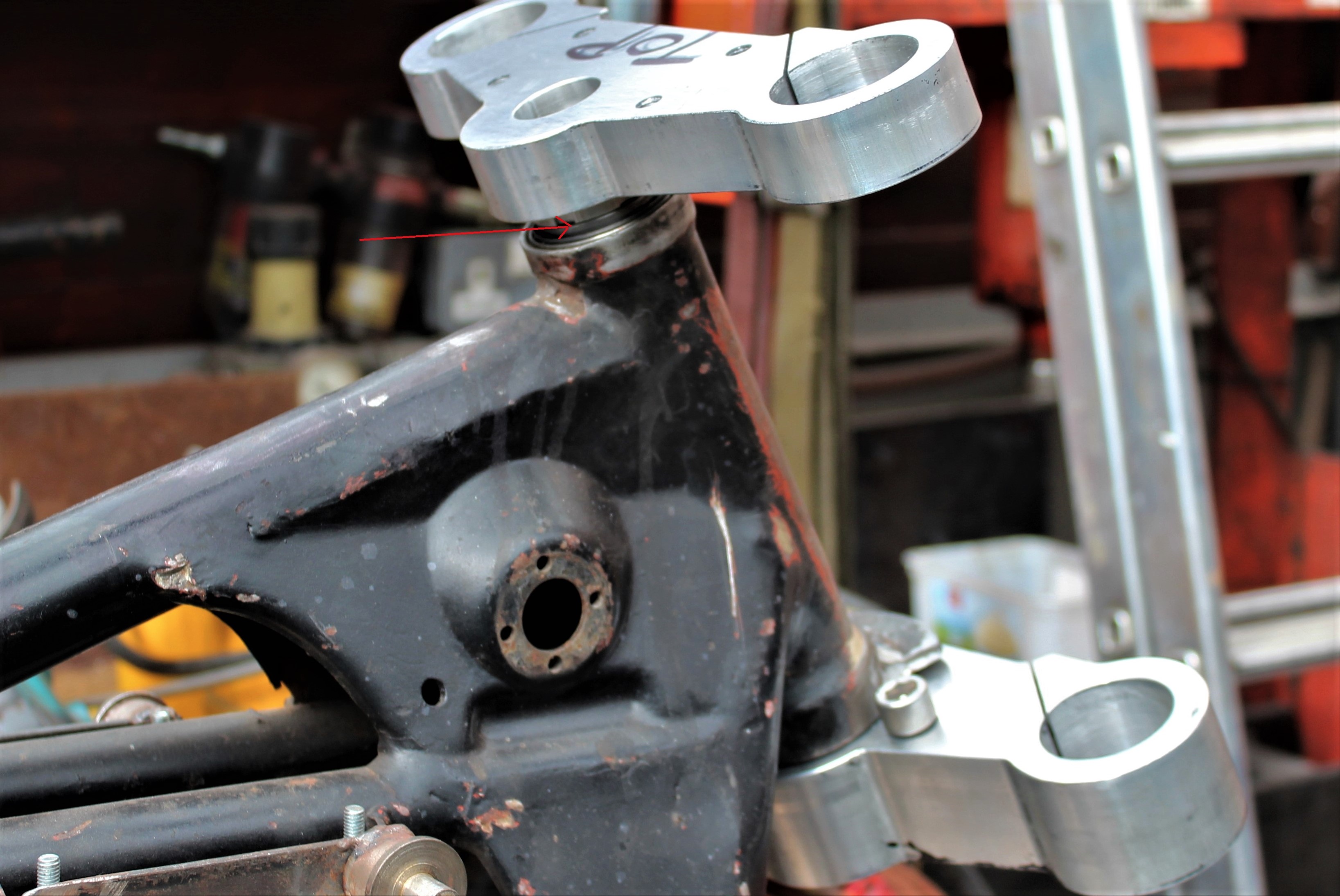

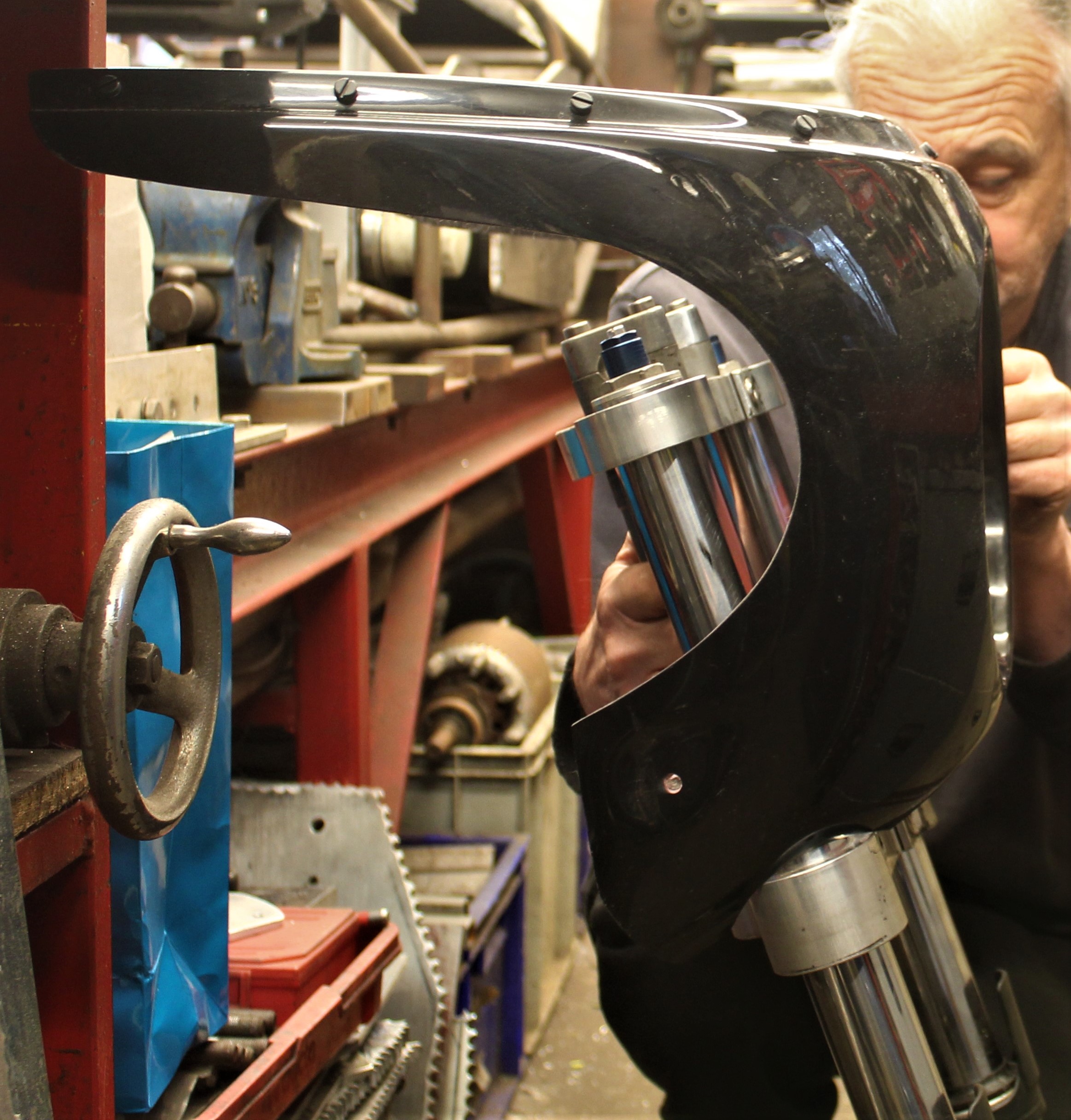

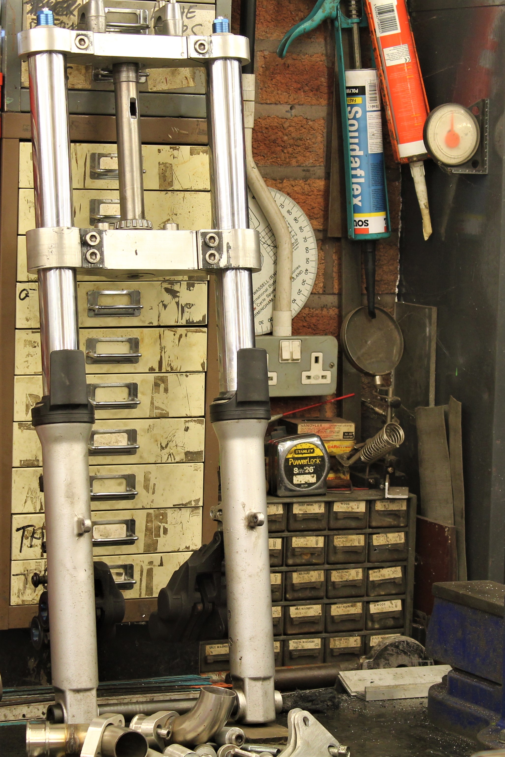

Test fitted the new billet yokes to take the wider 43mm forks in the pic below, after which I decided to machine the underside top yoke so it sits over the adjuster nuts, as it'll look better and give an extra 10mm or so of ground clearance, at the expense of making adjustment trickier.

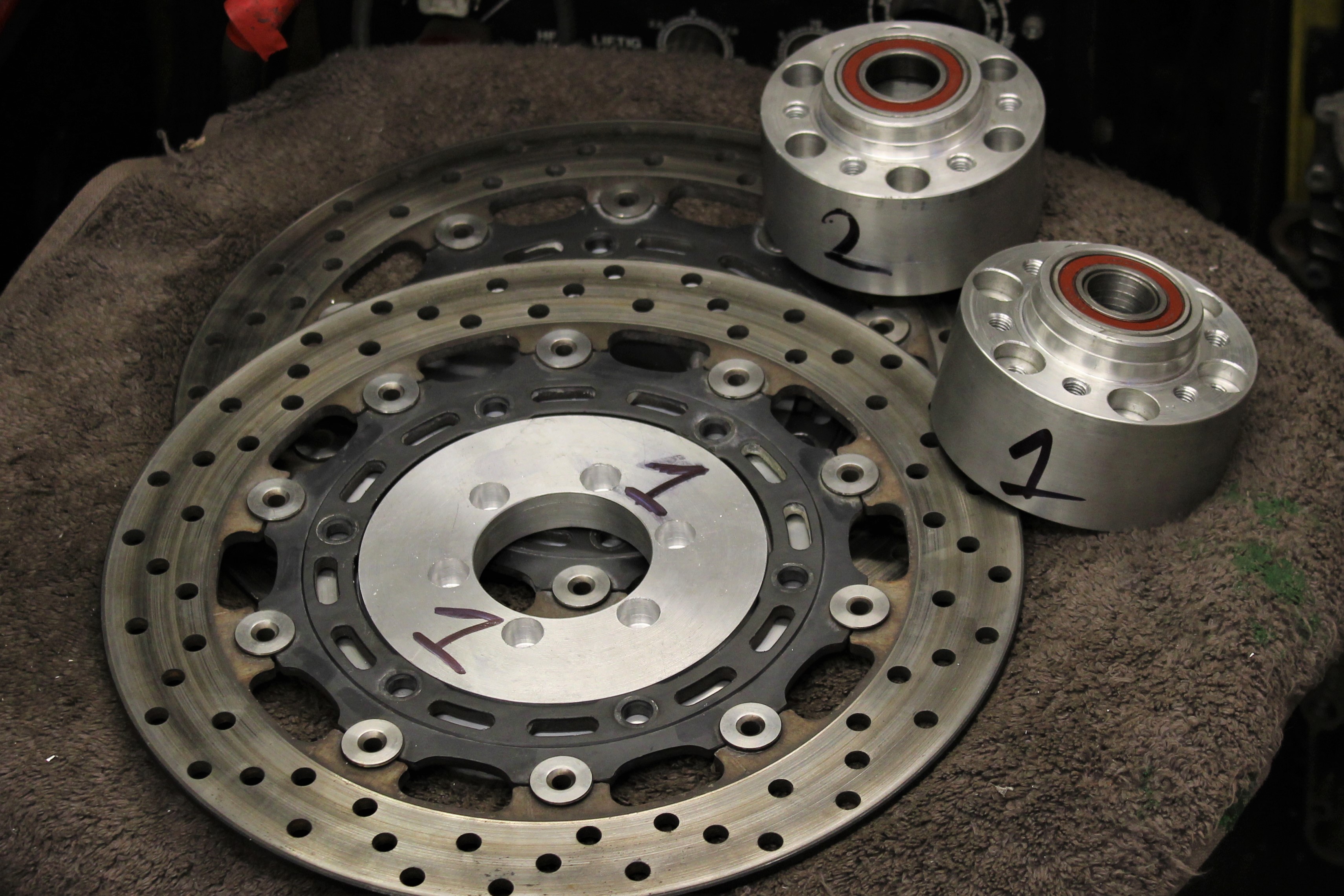

The top yoke has been modded to drop it over the adjuster nuts, while work has started on making the adaptor plates to mount the R6 discs to my old billet front wheel. The R6 forks are now ready to go on the bike, though I will be painting the fork lowers black. With the bike being at my mates workshop, it might be awhile before I can go and check up on progress, since we ae in lockdown again.

The front end is now almost complete, just need to pretty up the disc adaptor plates by machining them to match the discs, and paint the fork lowers black, and maybe also paint the spokes too..

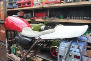

Meanwhile, we made a start on making a fibreglass seat base. It looks very rough at the moment, but a few more layers and plenty of sanding should see it ready for upholstery. Still need to work out the best way of mounting it to the frame, but got a couple of ideas.

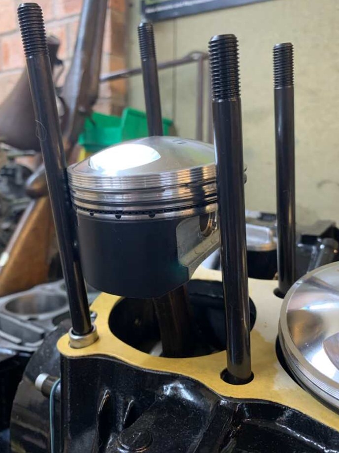

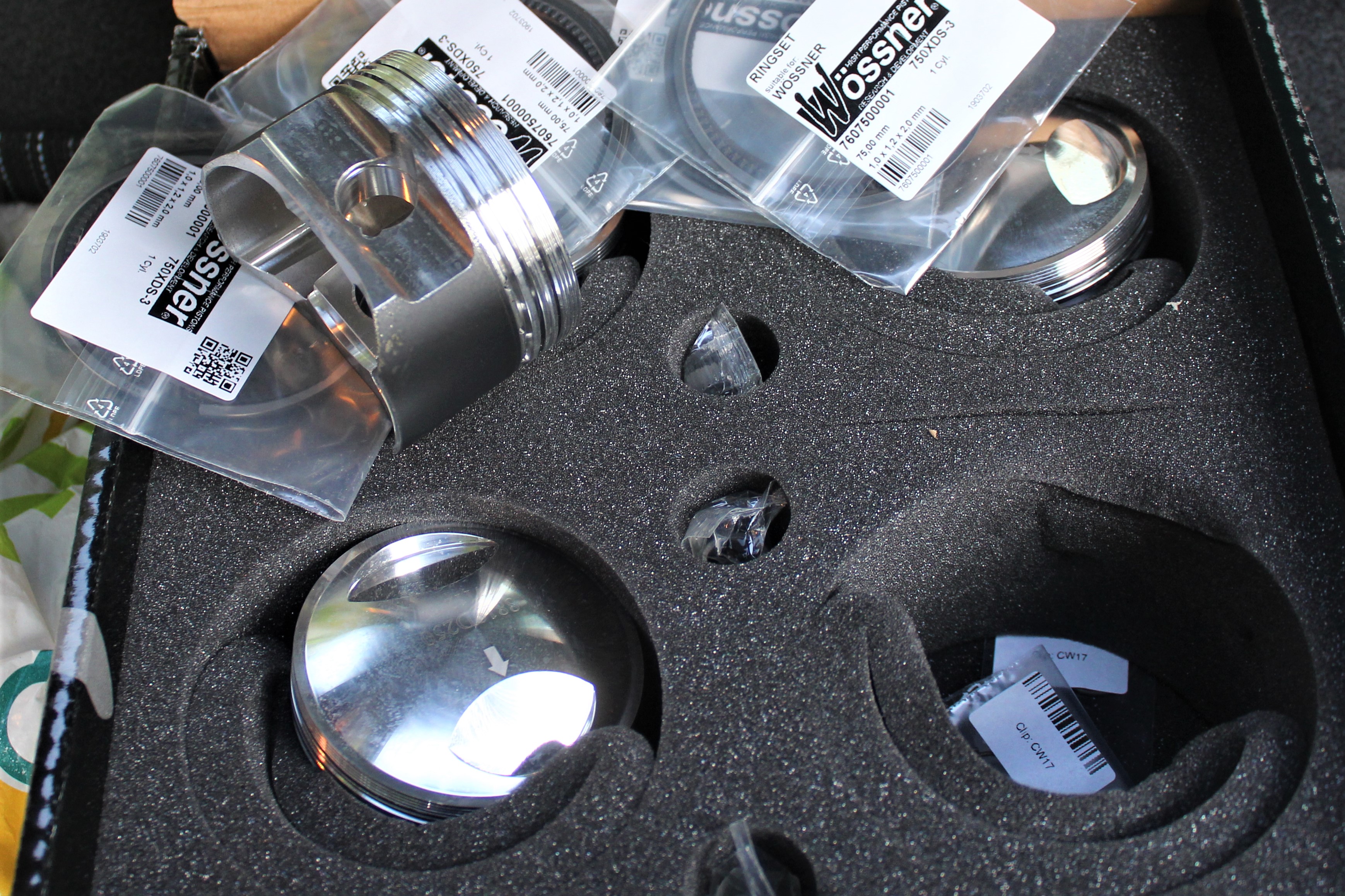

The 1170 piston kit arrived this week, so the block has gone back to the machine shop to be bored out to 75mm to fit the new pistons..

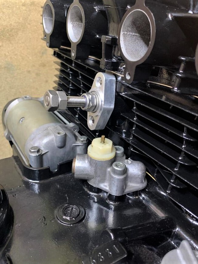

Found a good set of cams, so the engine is now almost done. Also fitted a homemade manual camchain adjuster, as the original auto ones tend to stick and allow the camchain to be too slack. Next is to source a set of manifolds to suite the RS34 flatslides, then they can be test fitted.

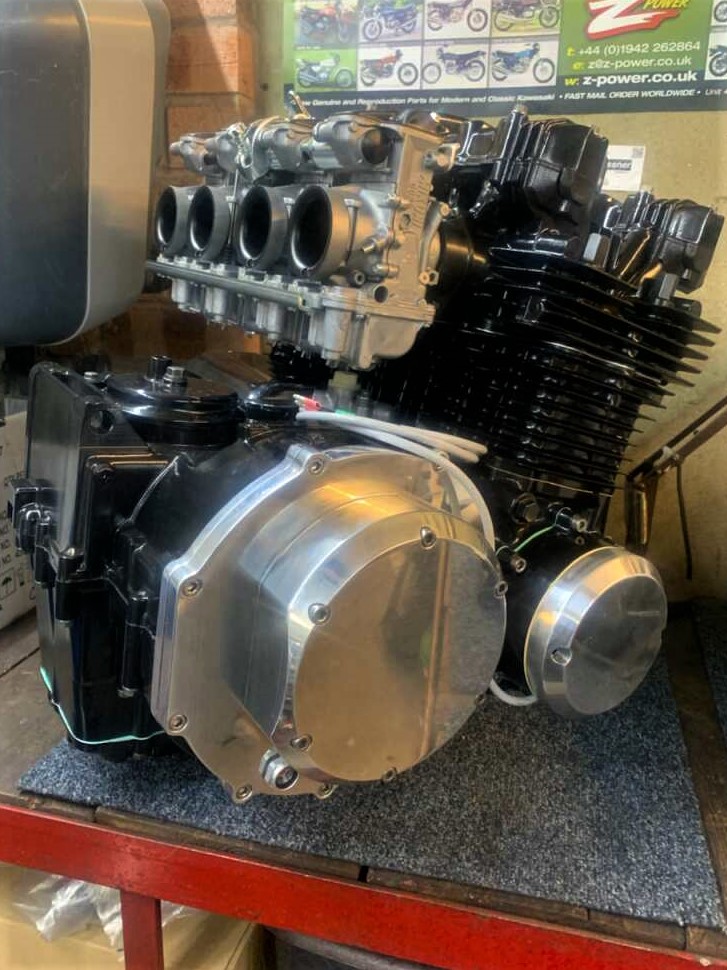

The 1170 engine is finally back together, just need new manifolds to test fit the RS flatslide carbs.. but no pics yet.

The fibreglass seat base proved to be tricky to get right, in the end we cut away the most uneven section and used an aluminium plate glassed into the underside, to both support the threaded mounting studs and give a smoother, straighter edge to the seat base. Its now gone off to a local upholsterer, who said it'll be done in about 4 weeks. He specialises in camper vans, and he's never been busier than the last year.

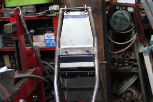

The frame is having a stainless splash guard and undertray made at the moment, and once that's done, just need to tidy up some of the welds, before it can finally go for powder coating.
The engine is finished, the one off outrigger wont be fitted until the engine is back in the frame, as need to check the chain alignment.

The frame has been cleaned up ready for powder coating, and an undertray and splash guard have been made from stainless plate. In the pic below they still have engineers blue on them, while the neater fasteners will be used in the final build.
