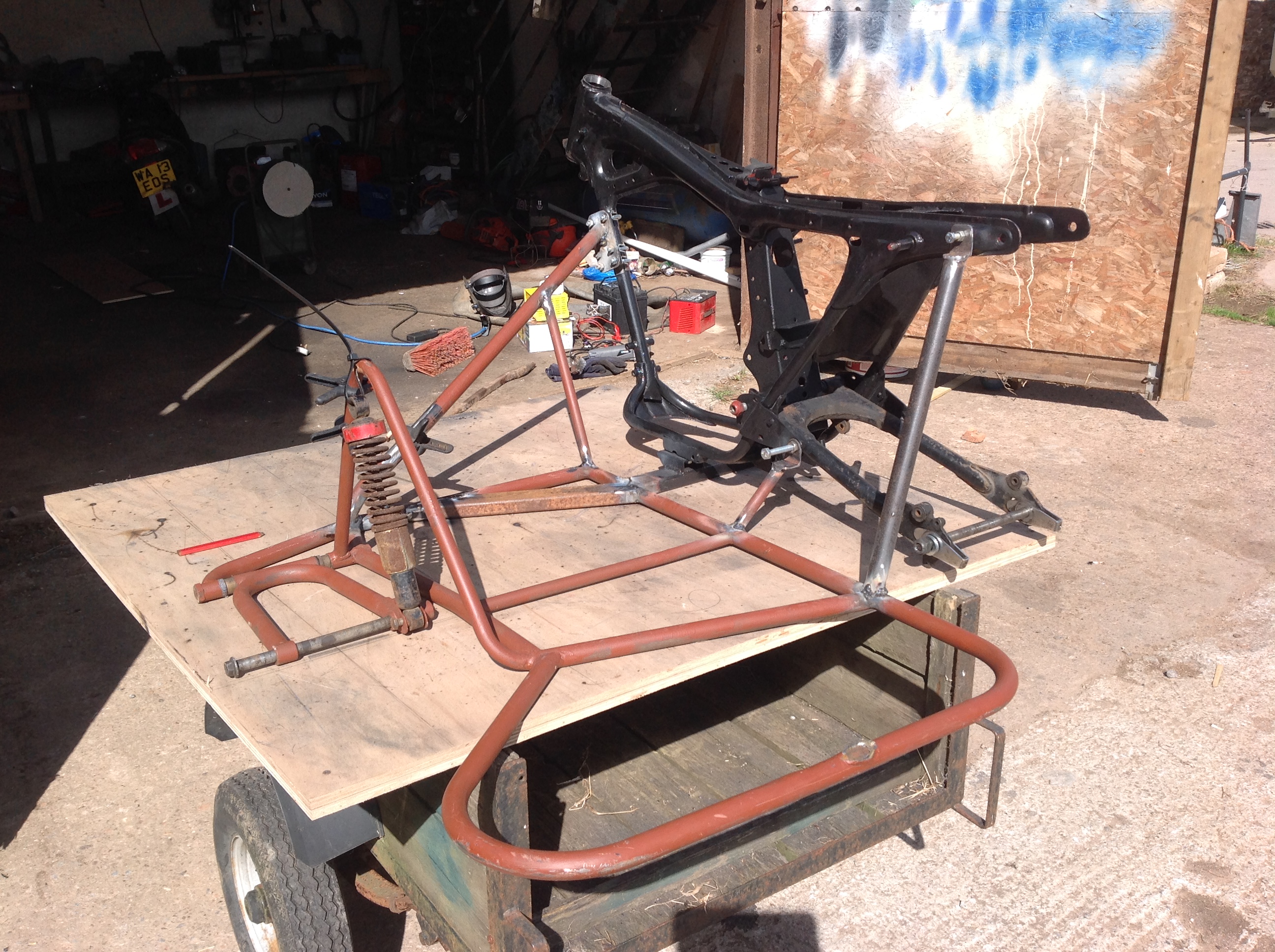

All stuck together, not very prettily but solid.
Not a single mm of movement of the toe in.
Whoop :)

That's a nice fit and now all one-piece :) Will your stock upper rear shock tower still operate on the left(looks like you have plenty of room there) or will you need to fit that side rear shock differently? Have you chosen a fiberglass cockpit for it or will it be an open chair ?

Shock mounts will be the standard ones, there's loads of room. Also need the main frame completely returnable to standard so as to keep the insurance companies and MOT people happy, hence not being able to weld straight on to the frame. However a sidecar is considered purely an accessory and in the same class as fitting a rack or a screen!
Plan for the chair is to fit a nose cone, and will cut that shape out of a steel bath. If it's too heavy I shall use that as a mould and fibre glass one from it.

They classify it as an add-on/accessory?? ask them to drive both types and they may change their mind. :D You'll need to make some Strong clamping mounts or has an aftermarket company already been making those ?

I think the mounts I've made should hold it. There are lots of clamps available for old British bikes of every shape conceivable, but bikes then were made with sidecar attachment in mind.
Yep, it's an odd classification that a chair is an accessory but I'm not complaining.

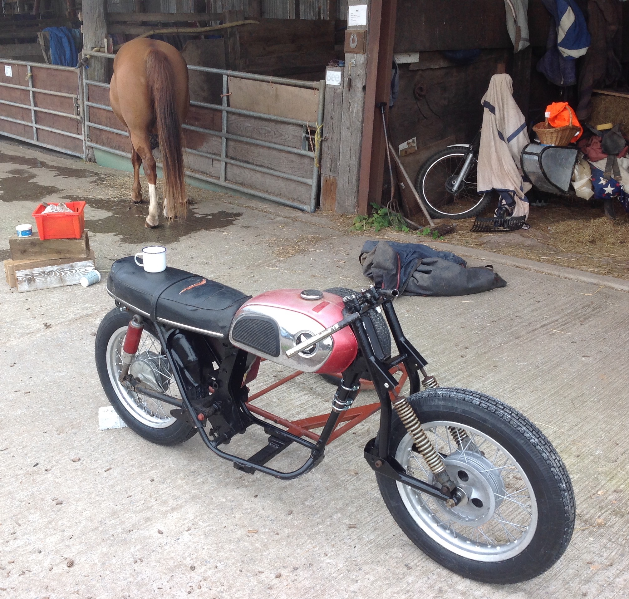

Take chassis, add wheels .....
It's a roller :)

The mounts look properly strong 8) and the Earles fork and the front wheel look a good fit;what type of shocks will you be looking for Steff ?
That's the next big problem .... Finding shocks with a forked bottom mount that are shorter.
The ride height I want requires 10 1/2" so say 11 allowing for 1/2"sag.
Fronts will be 13 1/2 again allowing for 1/2" sag.
Spring poundage ...... Dunno.
May have to see what hagons can do, I'm finding nothing on the shelf for the rears,
For the fronts there's lots to choose from.
For the chair wheel, either something v v stiff or will go solid.
Playing with the look ...

grcamna5 said:
Do you have a different shock on the chair wheel ?
Yep, thats a pitbike one i picked up along the way, its v v stiff, i can't compress it. it may or may not end up being the right length though.
