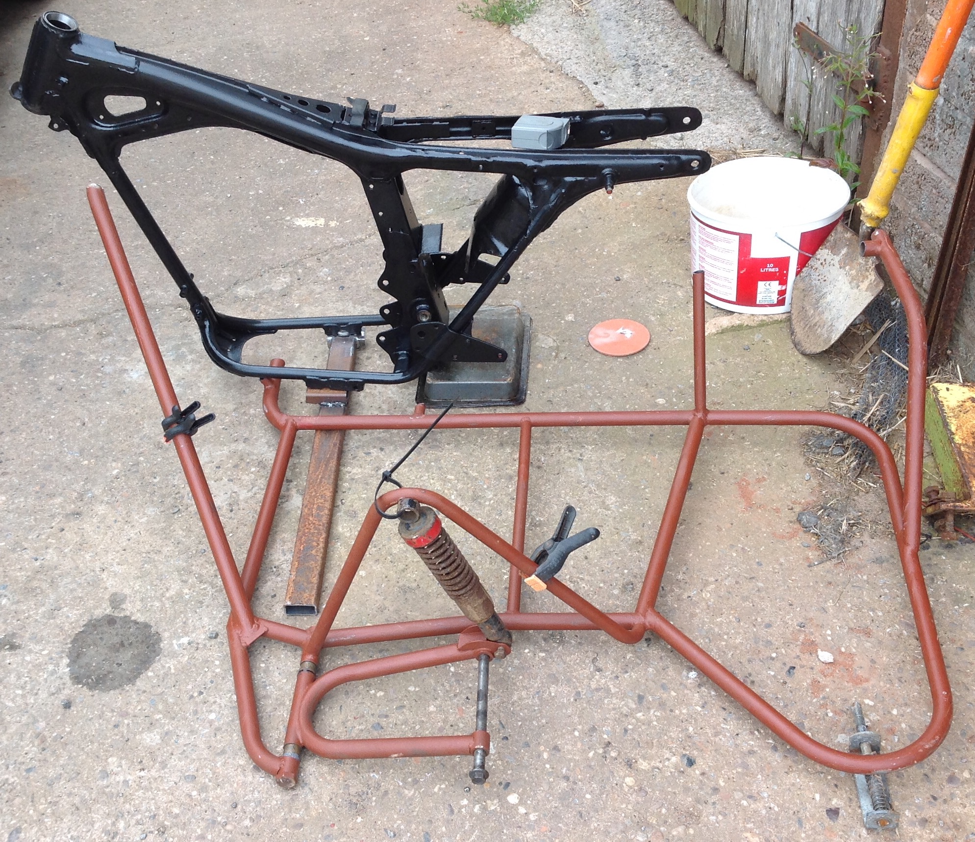

This is with a track width of about 1 yd / 90 cm. My trials outfit is 3'3" / 1m.
Would like to take main mount from footrest brackets under cradle tube and run across to chair swinging arm pivot point. Still haven't worked out how to do it yet.
I'm open to suggestions.

Swinging arm off the spares bike looking solid.

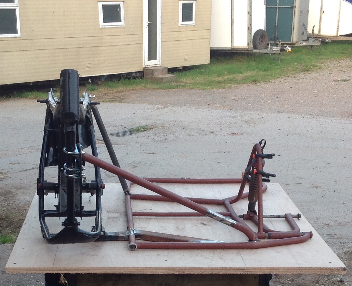

Got the main spar fabbed up. Took a bit of work to mount off the foot peg lugs as they are different heights. Next bit will be the bugger, setting the toe in and welding together.

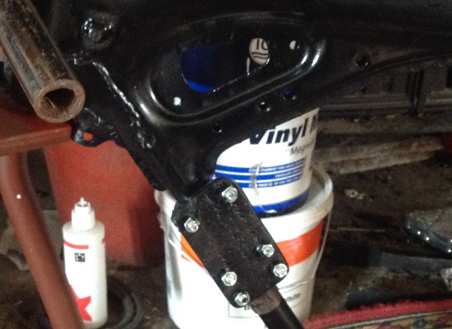

A little progress today. I've made a bracket on to which the main diagonal brace will be welded. It's 1/4" plate and attached by 3 U clamps. I also made sleeves for the down tube to spread the pressure of the clamps. Might be a bit over kill but I want confidence in it.

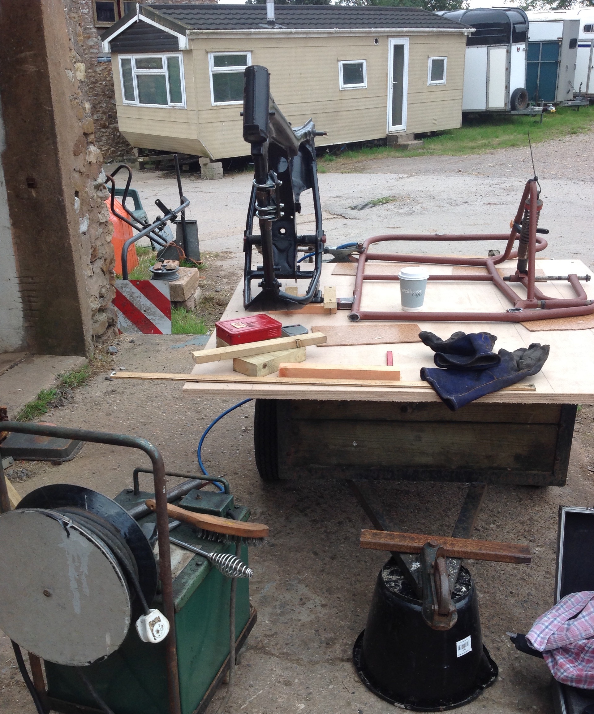

So it's a bank holiday weekend here in the good ole UK of GB.
This means we can get pissed up Friday, Saturday, Sunday and Monday night.
It's also a good time to stay at home and get some serious progress on.
Enter stage right a sheet of 8x4 ply, ruler, set square and pencil and time to get jiggy.
Lined everything up to give 12" lead and 12mm toe in and screwed it all down.
End of today, all tacked up on top and still rocking 12mm toe in.
Tomorrow I'll flip it over and crack on.
