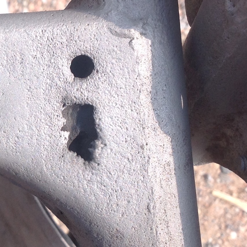

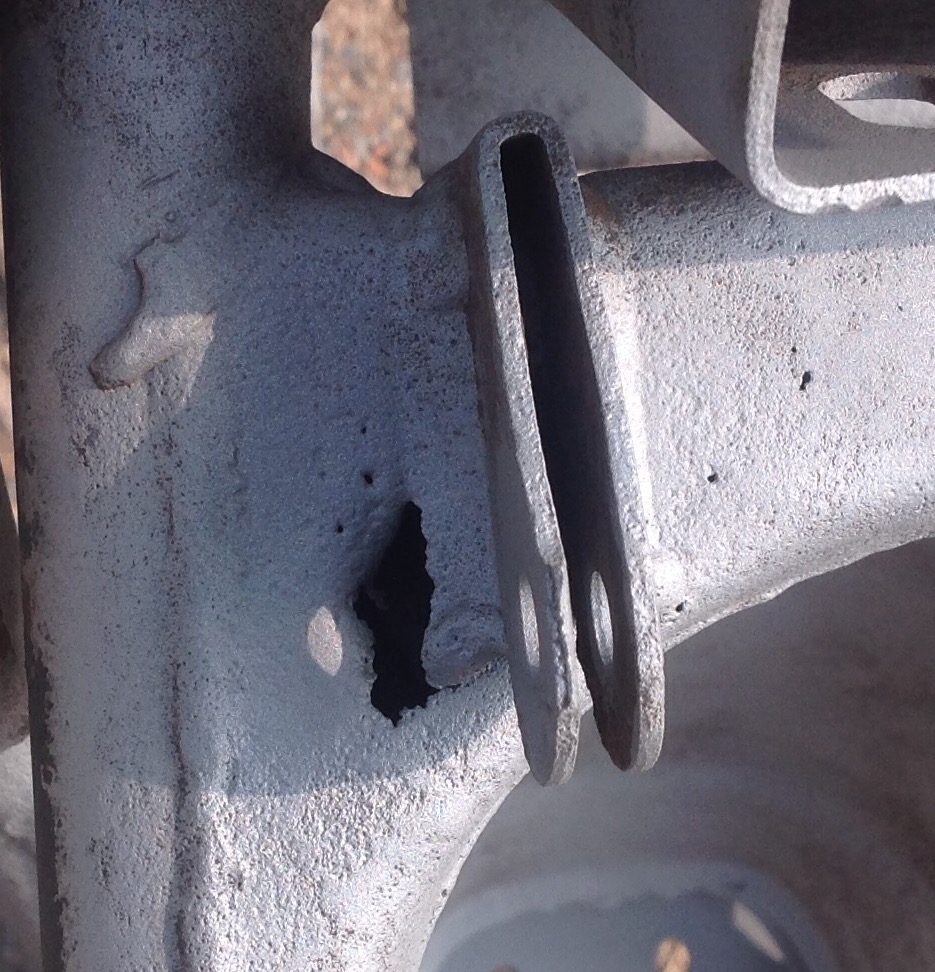

Frame blasted. I taped off the head stock because I didn't want to obliterate the vin and original stickers. There appears to be some corrosion issues on the key areas of the swinging arm. Doesn't bode well for what the eye can't see.

grcamna5 said:
I think you should source another swingarm.. for all the torsional stress that will be in-play w/ 3-wheels.
There is one on the parts bike I bought, I've not had a chance to inspect it properly though. The swinging arm is going to be taking way too much lateral loading. On the both sides the rust has penetrated the internal structure. The frame is pretty sound though.
Back in the day it was de-riguer to add a substantial steel gusset [ as per modern practice ] in that area for sidecar use. Most OEM swingarms of the day [ BSA, Triumph etc ] didn't have that bracing.
Given your fab talents, I would take the best s/arm you can find and cut out that corroded section and replace it with a substantial new plate - taking it as far as practical back along the swing arm side tubes.

What I think TJ is saying is that an old BSA swingarm consisted of three tubes - two sides and the cross piece. They need to have a gusset added to link the sides to the cross piece.
On that rusty arm, the gusset and cross piece are probably one and the same part - stamped to reduce manufacturing cost. Either fab a new swingarm or take an existing arm and make gussets for each side.
Another way to do it is to make a U tube - much like a rear hoop but bigger and weld it to the lower surface of the swingarm so it's unseen or make a full braced arm for maximum rigidity.

Well that explains the plates on the bottom of my BSA swing arm. Thanks TJ.

Thanks for that Teaser.
I like the half tube solution.
Expedient but subtle.
That's what the late Bob Brown did on my CB77 vintage (Historic P3) race bike. It's invisible to the casual onlooker, and makes a huge difference to swingarm stiffness.
