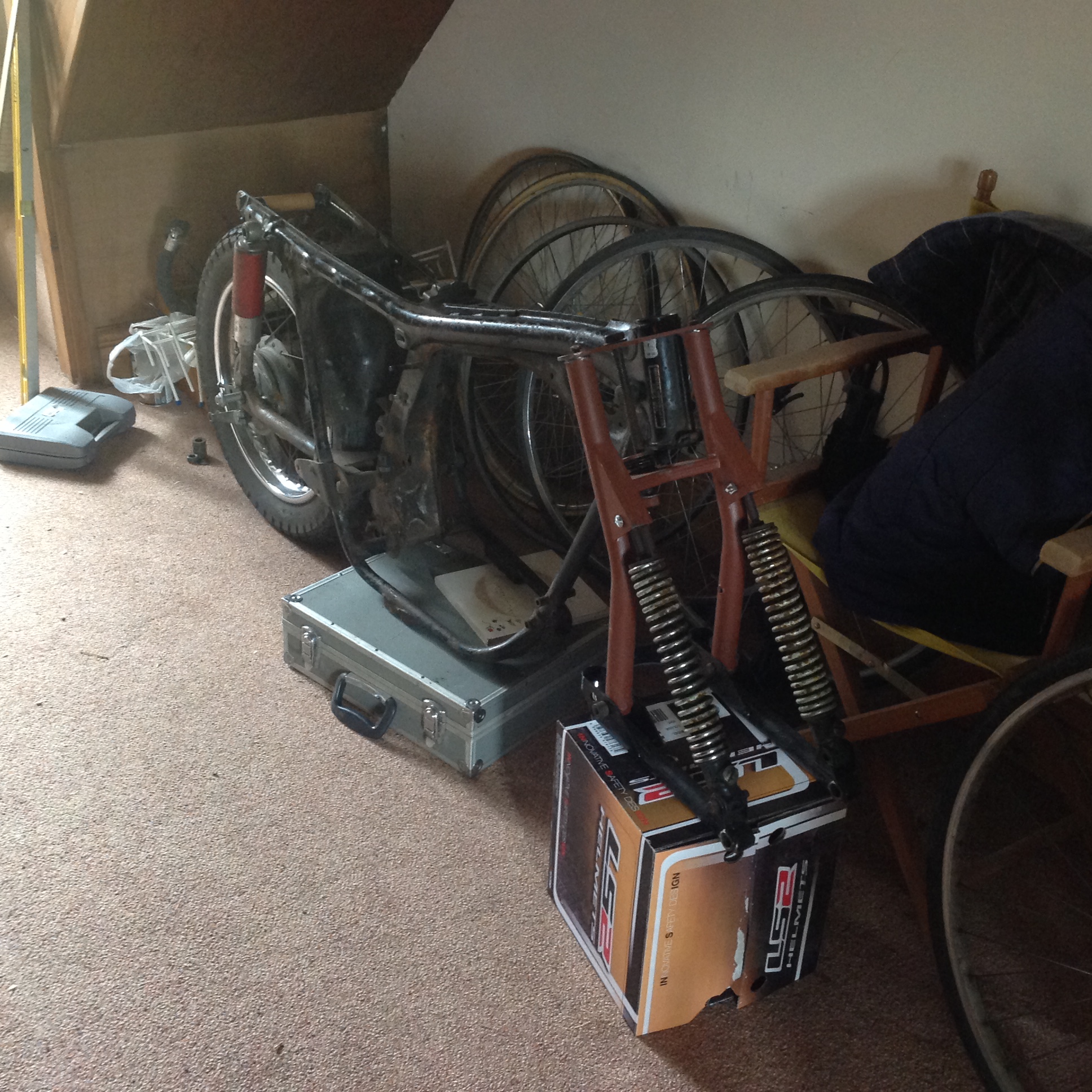

My new frame has arrived from Scotland. It's quite substantial and with the addition of the side car I think it's going to make quite a rigid unit.
The forks are going to require a little work to fit a Honda taper stem and some spacers turn to go under the top yoke. Also a little work on the swinging arm spindle slots as the left was made larger to facilitate a sprocket/drive hold for rear wheel removal (because of the fully enclosed chain) maybe some bushing going on.
Looking at using the footrest mounts on the lower frame rails to bolt on a cross member spanning the full width of the side car. It looks like a bit of a gift. The reality is for road licensing purposes the frame must be totally unaltered from stock. So nothing can be added by metal fusion, however performed. But anything mechanically attached is just fine. There are no legal spec for side cars as they are viewed only as accesories and the onus is on the owner to ensure the design and construction is safe.
Am looking at about 4" ground clearance I would prefer 5" but don't think I can squeeze it out of the front end with out using over long front shocks and having quite a steep swinging arm angle.

Hooked up with my buddy today who has agreed to do the lathe work required to fit the leading links. I need to pick up some bearings first though.

Hopefully by the end of tomorrow the leading links will have be converted to fit.

Well I'll be forked.
Leading links on. Grass track/speedway style .... Taper roller bearings, top'n'tailed with top hat bushes and skewered with a 9/16 engine block stud.
Also got the front wheel aligned with bushing and some XL125 handlebar clamps shortened and tapped m12.
Good forward progress :)
