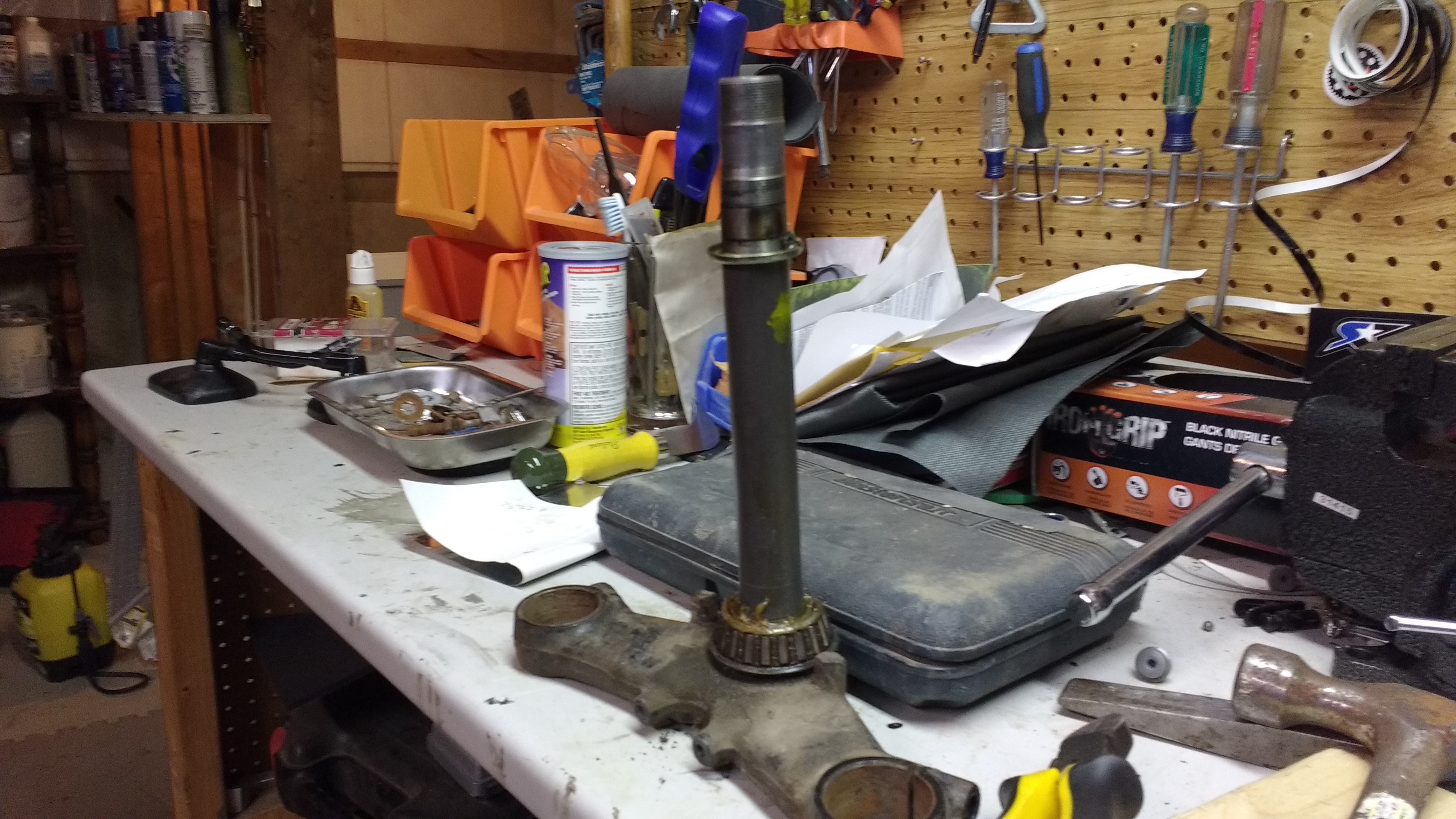

Tires off and cleaned, should be fine. Triples off, 0 damage to the stem, bearings or actual triples. All straight. Neck straight welds good, I sanded paint off and looked. I think I am good to use my titled frame and save a few hundred bucks

I just tried to post picks of the neck and stem etc they have 0 dmage. I wire wheeled thebpaint off the welds and put some dye on them and no cracks showed up so I am good to reuse my motor and titled frame. Will save me about 300 bucks I can put towards mods or parts.
I have some blue ink/dye for actual painting minitures but if you put it on with a brush and wipe it off it highlights cracks pretty good. None of the welds showed any, and the fact that the bottom triple and stem are still straight and true gives me enough confidence to use my GL1000 frame.

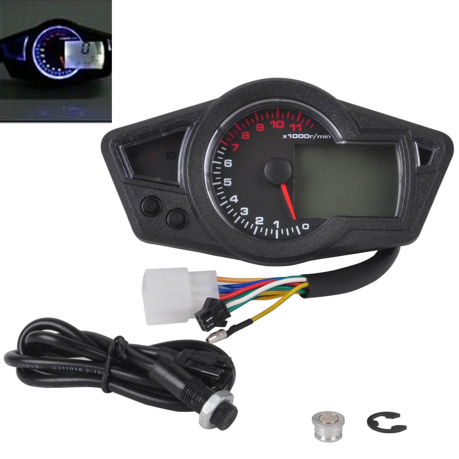

This is the tach speedo deal: I hope it is decent quality because I am not using the gigantic Honda gauges from the 1100

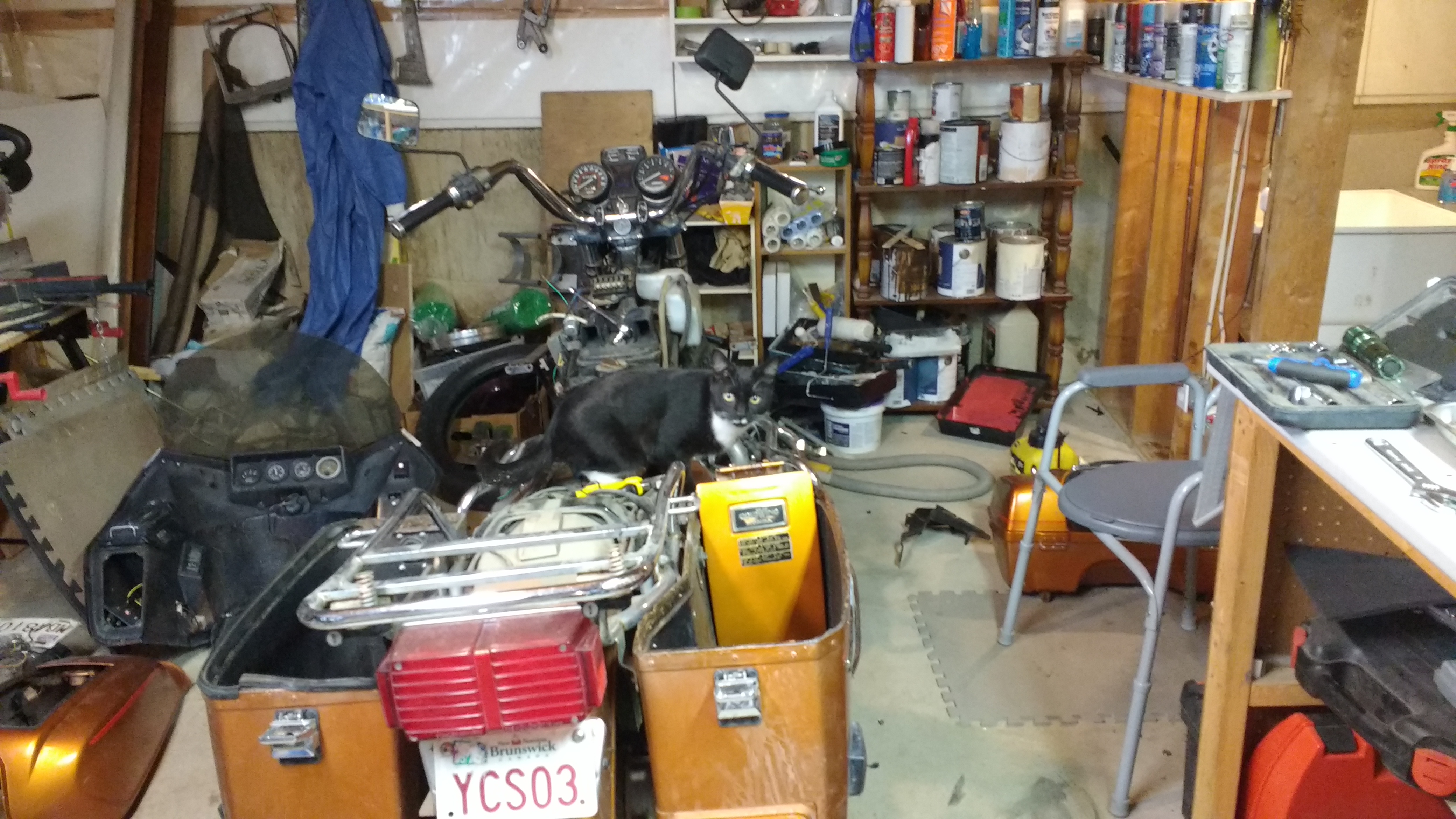

So I started pulling parts off the 1980 1100 and some will work some won't. I will see what I can do. Just realized the 1100 has an 18" wheel so my 19" tire won't fit. So I will have to get a new 18" tire.
Ha yep. There is a spitfire on the rim which is a good tire, not sure of age if not too old I could run it.
