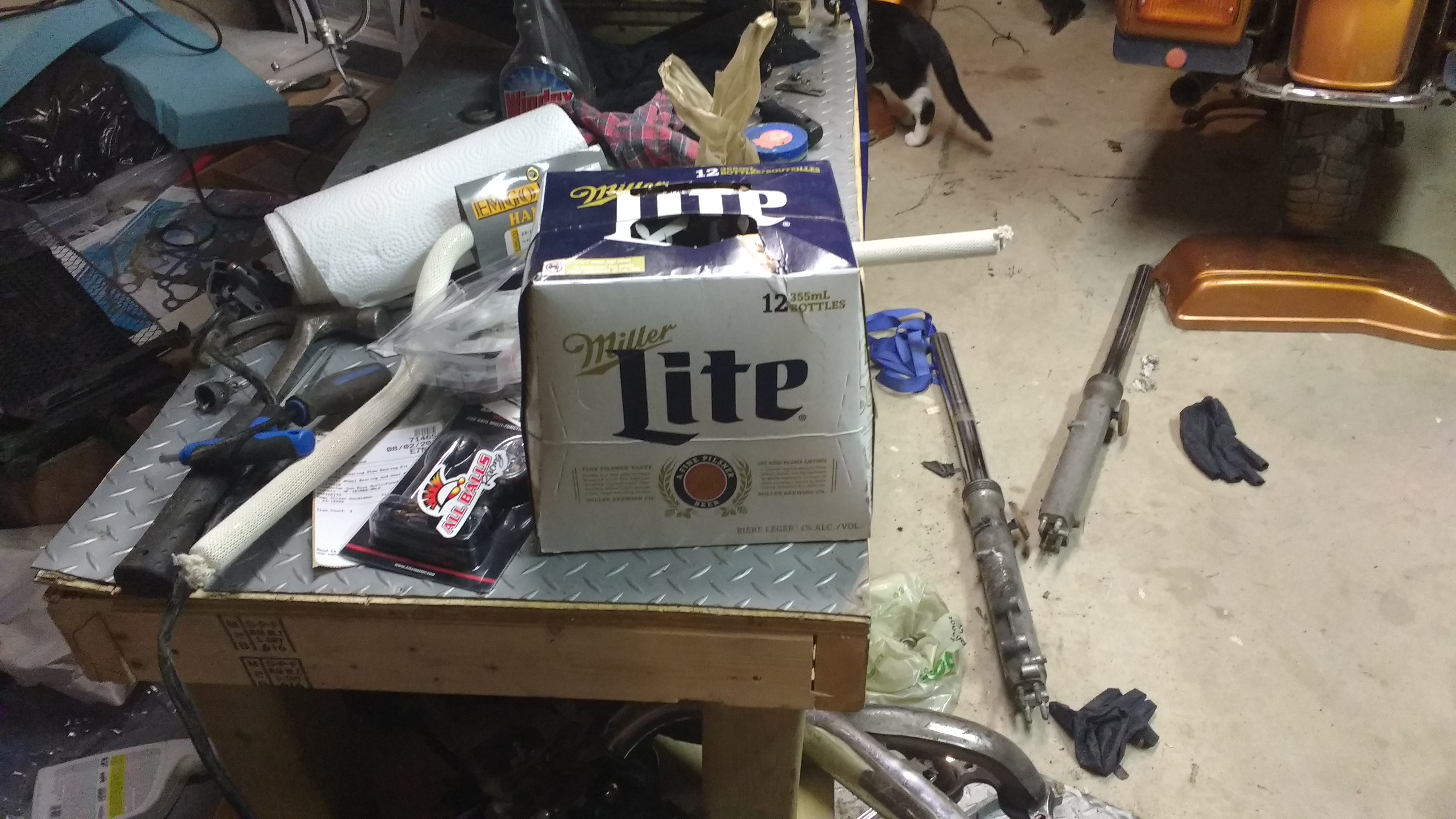

SonI am channeling my inner bradj and going to build a dolly for under the motor to take front end off the 1100.
