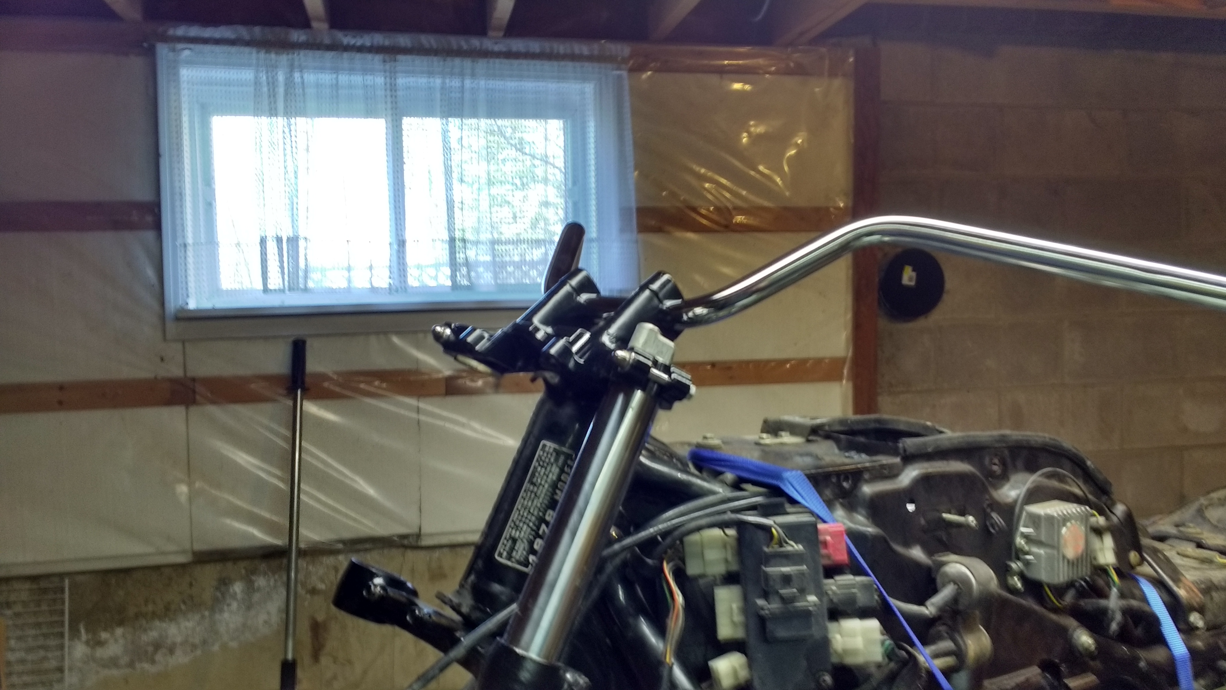

Got the 1100 front completely stripped. Now I need warm weather to get the triples, lowers etc all painted. I didn't take any pics yet but maybe later. Worked for about 4 hours and forgot phone upstairs and so if I get the energy to go back down there will be pictures.
Some progress pics. This was 4 hours work with gimp leg. The brakes were serviced pretty recent. Fluid was clean and pads are brand new. So a new master and lines and a quick bleed and it will be stoppies lol.

Thanks man, I stopped before I pushed to far. My dad in law was being my conscience today. ;D I am going to have it ready to ride this spring, and myself too.

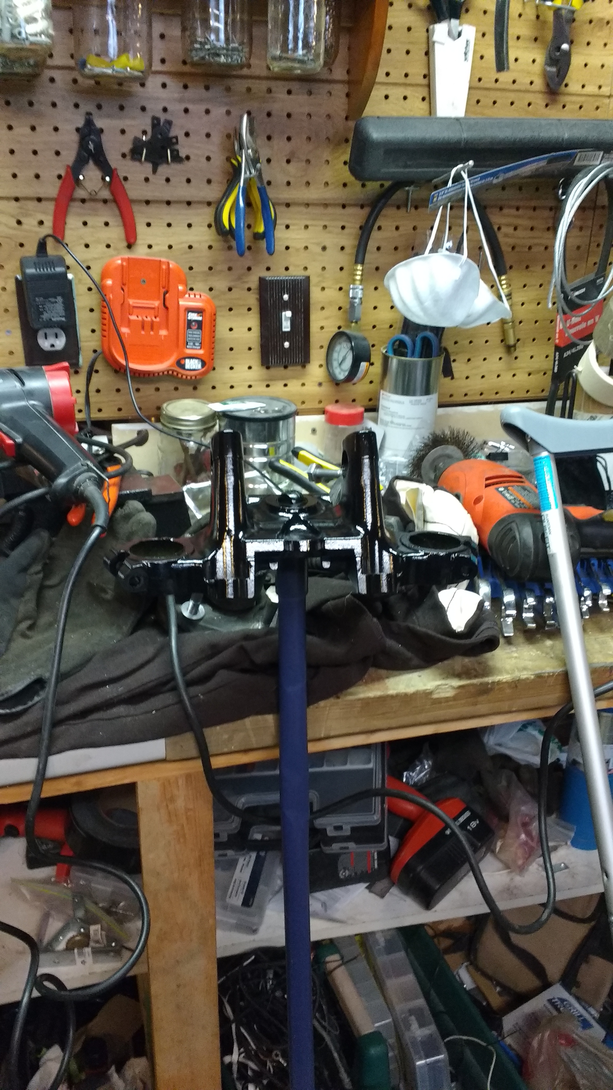

Lower triple in epoxy. Try for upper later. Wire wheeled it, heated it, heated paint, sprayed quick in garage then brought into house to cure.

Lower installed. Upper painted, it's next once paint dries enough. Next is forks apart and lowers clean and paint.

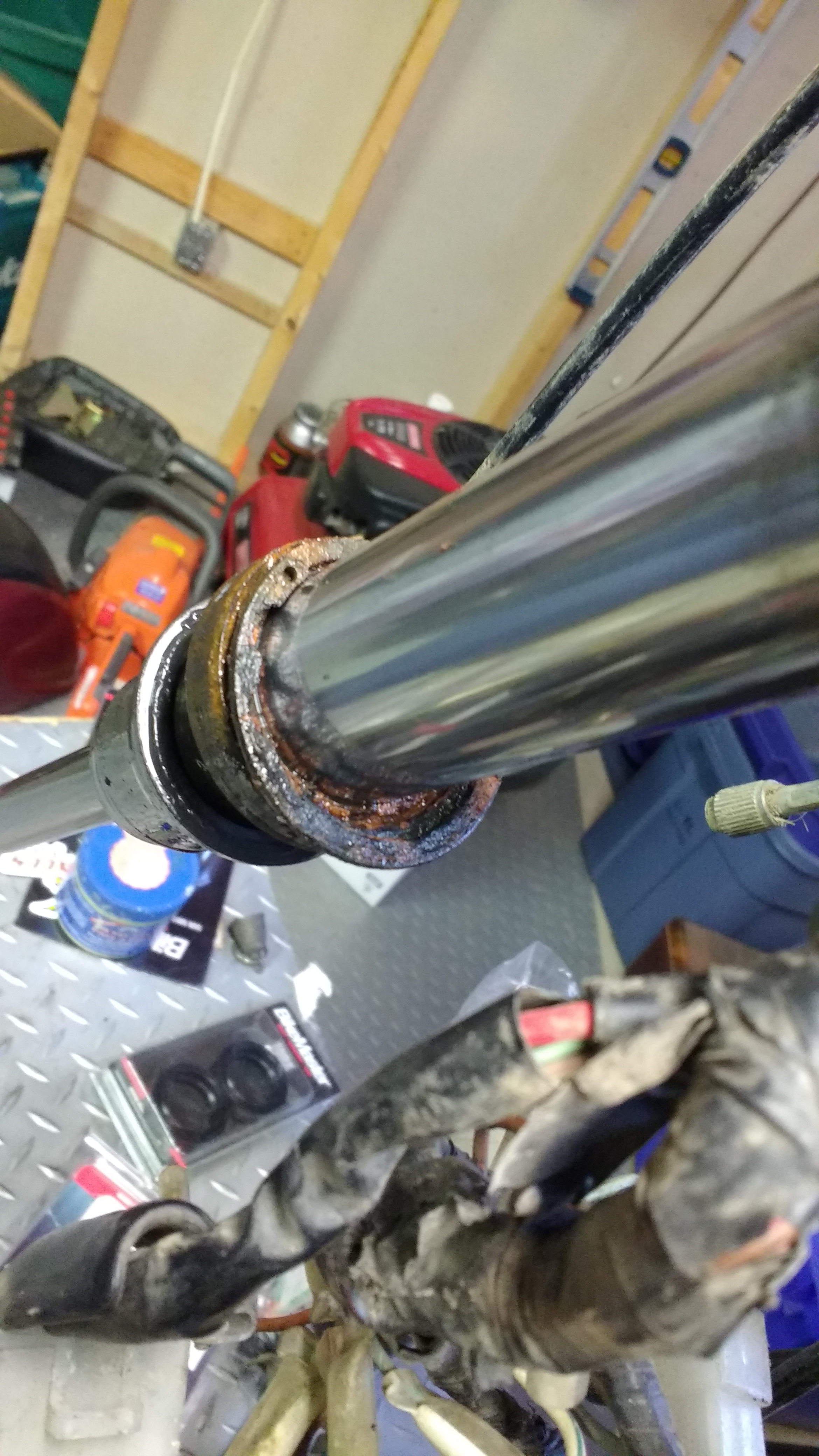

Ok the shitty oil from the forks posted. I had to redo the drain bolt by tapping 1 size up and I had pics o the new top tripe
Le and bars and the really scuzzy oil seal but they won't post cause of my shit internet

Yay pics. I got the one leg lower off and all cleaned and ready for paint tiday. Second leg is being a dick about the circlip so I am letting pb blaster work on the rusty shit so I don't break it. Once it's off and clean I can get them painted, should be 10 outside so getting garage up to the 16-18 needed should be doable
Funny thing, right leg oil was almost new so something got in the left leg to make the oil that bad.
Um..Water? ::)
At some point you rode in the rain and sucked some water in. those are big pumps if submerged, I wonder if you have something directing drainage right down the fork leg.

Yeah water bnt not me riding. These came off a parts bike. I am rebuilding and will put Gators on so shouldn't get water in again
