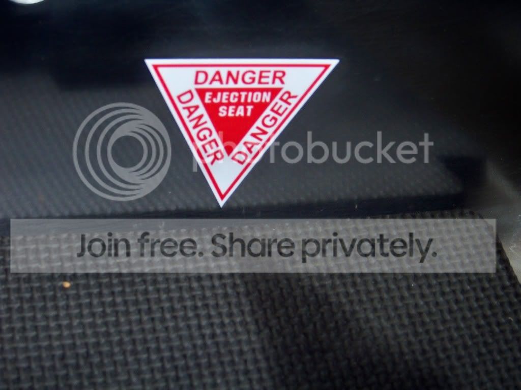

Oh man, got some good stuff today! First off, got these in:
Those are for fun, since this is not to be taken too seriously!

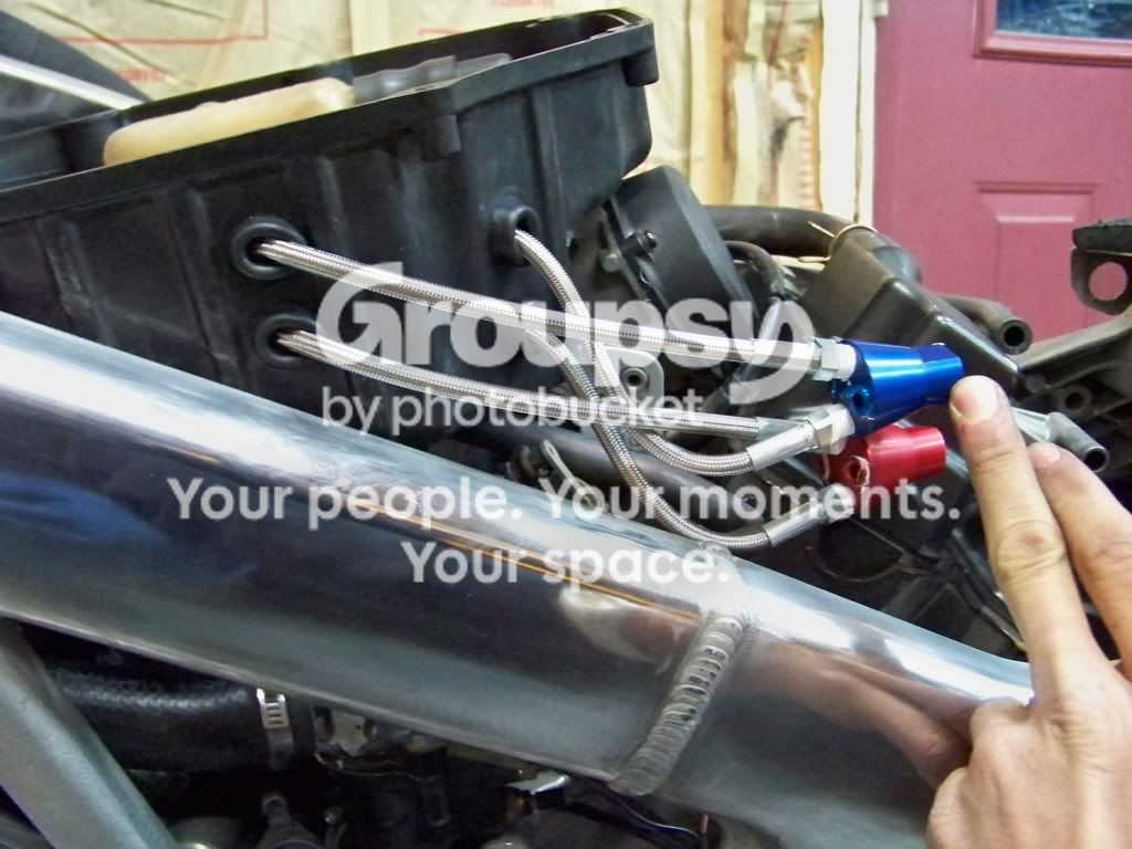

So tonight, I finished up my preliminary jetting of the carbs for the new pipe, since I had the airbox off. Then I remounted the airbox. Then I added in the nitrous and fuel lines. Since this bike has really, really short carb boots and mounting flanges, I could not install the jets between the carbs and intake for optimal operation. I guess throttle body spray will have to do. This necessitated routing the lines into the airbox. Fortunately, the local hardware store had some grommets that worked really well for getting the lines into the airbox and still maintain the seal. It is still a reallyl small area to fit this stuff into and keep nice routing, with optimal injection, but I made it work. With all that messing around, this is as far as I got:
More hopefully tomorrow! Thanks all for following along.

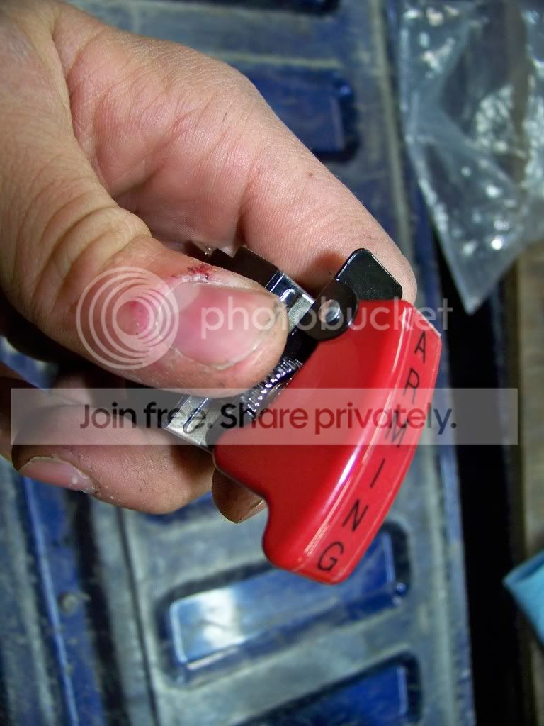

Yes! I was hoping you'd use some guarded switches!

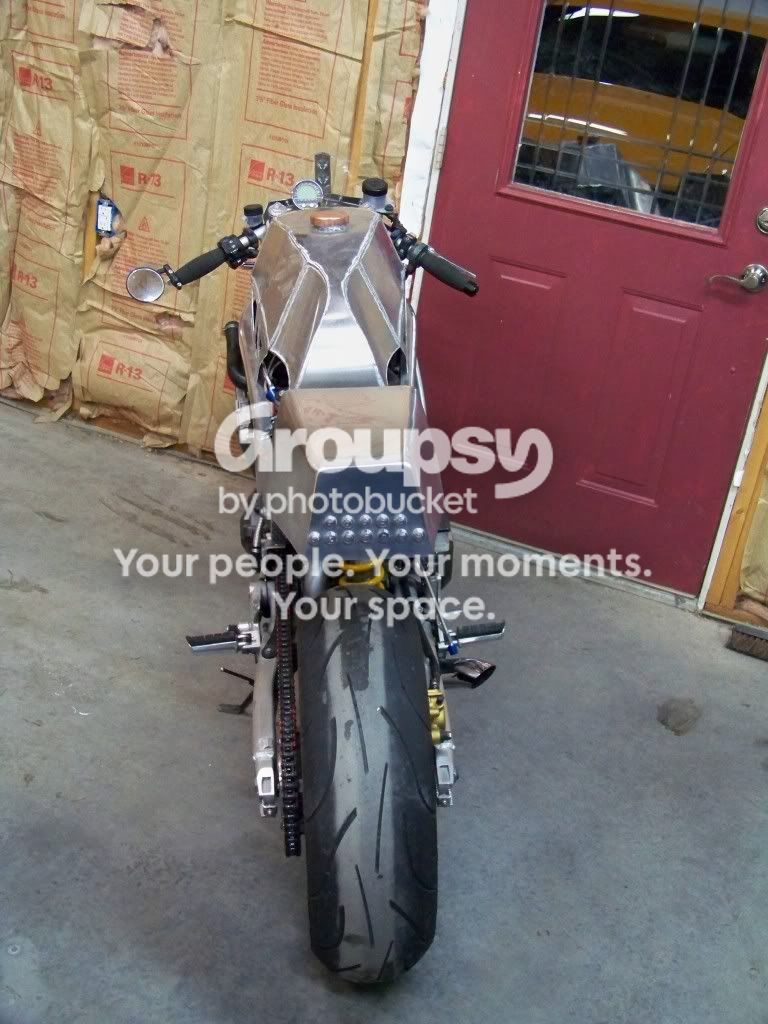

I got the cut-outs done on the tank tonight, and cut the seat to fit the back edge of the tank. I installed it, and the nitrous and fuel solenoids would not clear where I had them. So I relocated the solenoids so the tank would sit down all the way. This is actually going to make for better fuel line routing anyway, so no worries there. And, I think the color of the anodized bits helps the high tech look a bit. Beyond that, everything fit how it was supposed to. So here are pics, but you have to imagine it polished...That won't happen until this weekend.

Can't wait to see that thing polished, man! Excellent.
Re: Modern cafe, "Project Kool-Aid"...unpolished tank pics
Ah.......good old aluminum tanks. Turned out great!
Are you going to polish the entire thing? Only reason I ask is the glare coming up from that could catch ya in the eye or something.
Looks fantastic, my man.
Maybe you should polish the sides and anodize the top.
