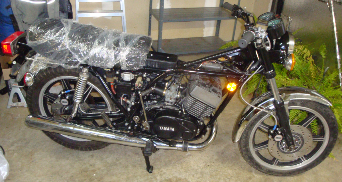

Brakes are bled now. Not perfect, but a good amount of pedal and lever available. I got a new (NAPA) 3 pole electronic flasher to work. Yamaha for some reason swapped the load pole position on the relay. All that I had to do was swap the yellow/green connector with the brown/white connector, and at least flasher-wise, it is working great! Remind me in four or five months to report on if the cancelling function works.
Probably the last photo for a while. Carbs are on, everything hooked up except fuel and oil supply lines. Now to wait for weather to paint, decal, and clear the tanks and side cover. Then make smoke!

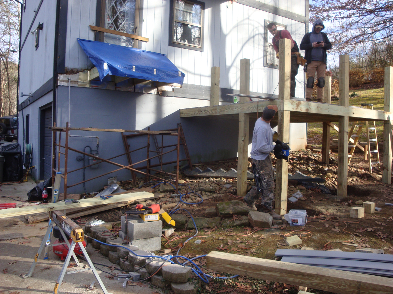

Thanks! And, none too soon. I rolled it out to the shed today so that tomorrow they can pull down about 6' X 8' of ceiling sheetrock in the garage to access the rotted joists for our deck cantilevered by the kitchen door. Those joists will be pulled and replaced, then the sheetrock redone. No room for three bikes and that work in our less than one-car garage, so Geneva rolled out to the shed (brakes tested on the way). Then comes waiting and watching for painting weather.

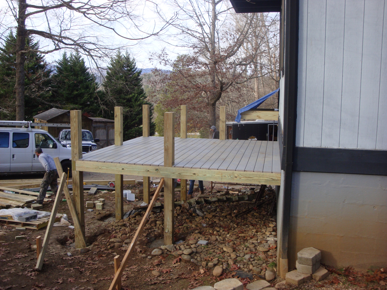

Things are going slow thanks to weather. The 12X12 deck is framed and decked, the cantilever joists are replaced, but no decking on them yet. Decking is Fiberon Paramont ($$$$) in Mineral color - as close as what we could find to the previous color.

BTW, deck is on hold until 16 and 20 foot decking comes in. Hopefully in a week or two.
Minor update today. RD is back in the garage. The siding and decks on this West end of the house are completed. Still need decking on the frame for the front deck, but the lumber yard is dragging their feet supplying the 20 and 16 foot boards needed for it. I thought that this decking was composite, but doing more study it seems it is pure recycled PVC. Wife is happy with it, so that is a big plus.
