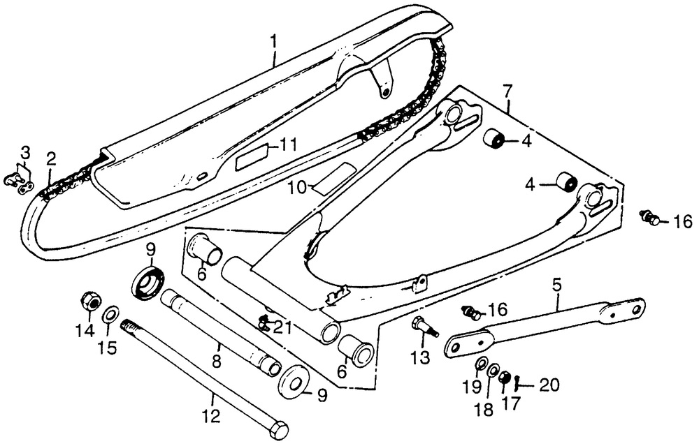

The 550F and the 550K had different swing arms. pics of your setup would help. The swing arm is the only part between the two models that's different in that area. Here's a couple pics to illustrate.
Here's the 550K

That being said, the axle is the same length on both models. The hub and brake panels are the same part numbers as well, so regardless of which swing arm you have, the parts should work. Pics of the setup would help to figure out the problem.

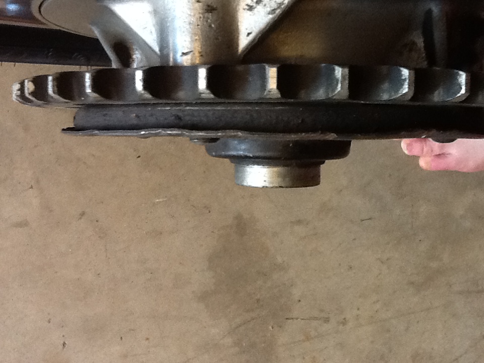

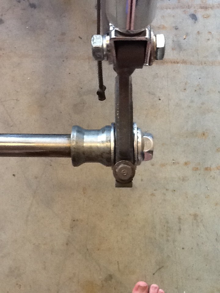

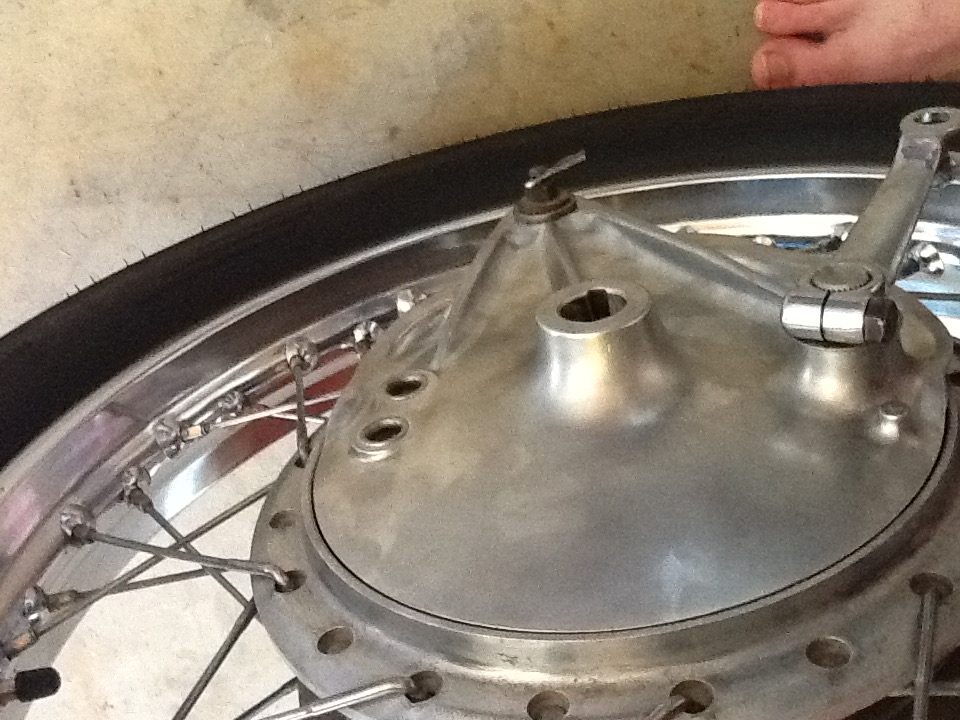

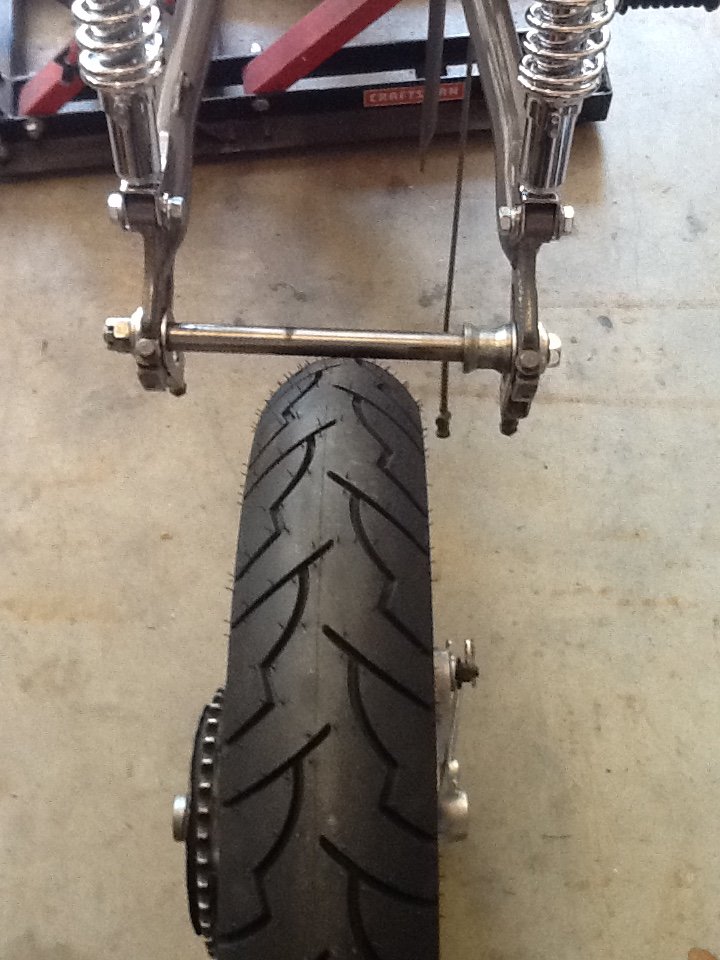

Sorry for the poor quality pictures. If you need a pic of the wheel on bike, I will try to get some for you later on but I cannot atm. Thanks again.

The spacer/bearing in the second and third to last pictures is what seems to be taking up most of the required space in order to thread the castle on all the way (maybe about 1/4"). And based on the pics you sent, I definitely have the K swingarm.
The castle nut looks like it's on far enough - nothing between the swingarm dropouts can change that - what exactly is the problem you're trying to solve?
The swingarm doesn't compress together - the wheel and all the spacers/adjusters needs to fit between the dropouts with almost no play. You're not supposed to squeeze the swingarm tight using the axle nut - it just tightens up, and is kept from rotating off with the cotter pin.
That castle nut is on about as far as it's supposed to be for hand tight. Keep in mind that the torque setting for that nut is 57 - 72 foot pounds, which will get you at least one more turn. Then you line up the hole in the axle with the notches in the castle nut and put a cotter pin through. The only error I see in the pictures is that you've got the axle going right to left. It should go left to right. The spacer that's on the spindle in the pictures is in the right place - brake side (right side). You're fine - just put the wheel on and torque it up!
It looks far enough on because the wheel isn't mounted. If I put the wheel on and then try and thread the castle, I can't get the cotter pin through. I need like 2-3 more threads at minimum. So something is too big for my setup (maybe the spacer on the drum side or that spacer/bearing on the sprocket side) and is taking up that extra 1/4" of the axle I need to thread it properly.

Yep, that sounds right because the tabs on your swing arm are thicker so the spacer should be shorter. Well, we've eliminated almost every variable! Mount the wheel the best you can and take pictures of it from the same angles as before, also where the brake panel meets the hub. I gotta go out for a couple hours but I'll check back in when I get back.
