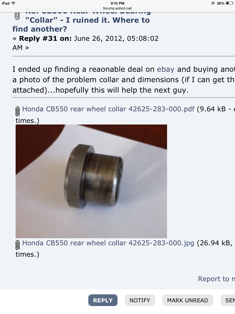

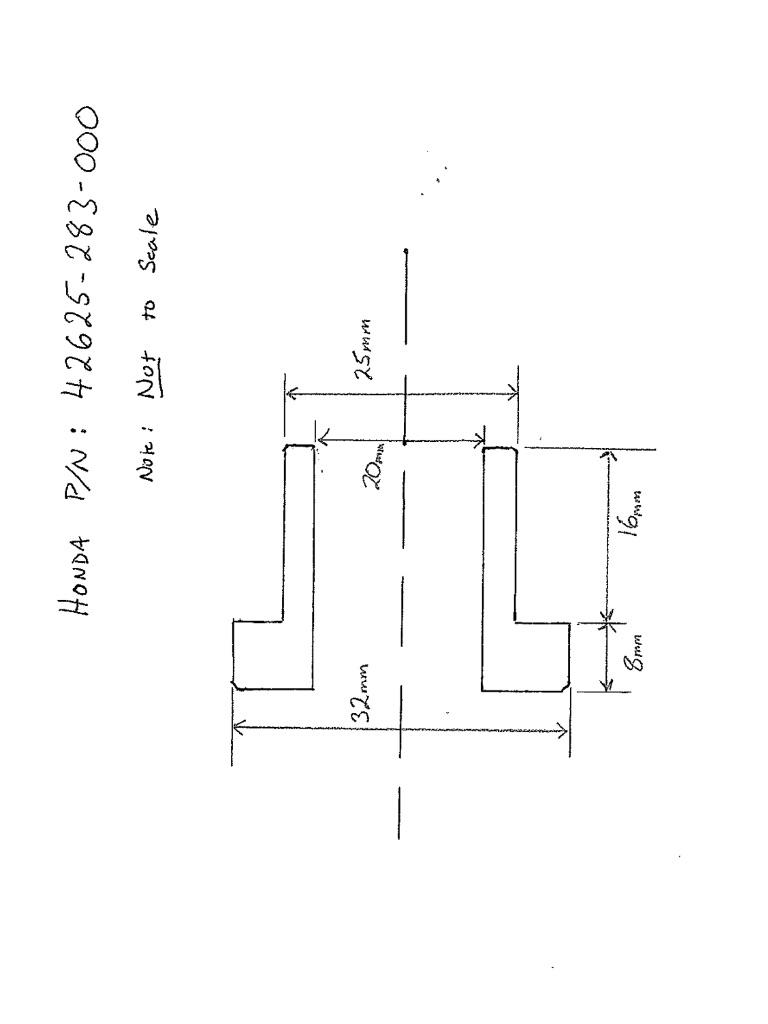

I am going tomorrow morning to a machine shop to have the spacer taken down. Mine measures 1.5 exactly. Does anyone know what the dimensions of the K sprocket side spacer are?
I found this online, but it is from a 72' CB500. Will these be the required dimensions for what I need?
