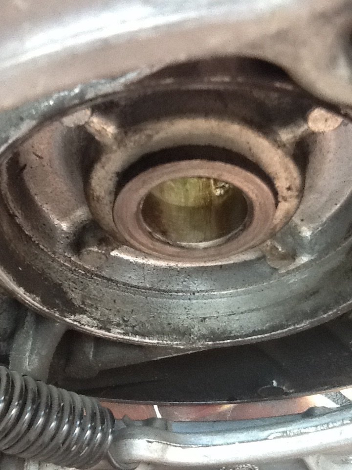

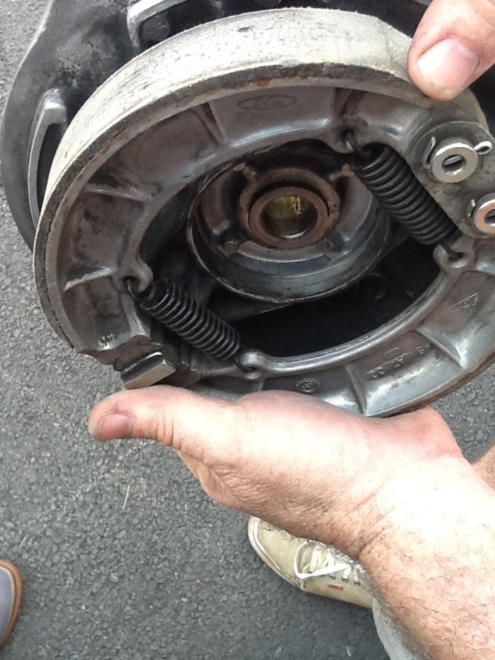

Here are some pictures I snapped of the brake drum. Should the shoulder shown on the inside in the middle of the assembly sit against the wheel bearing? Because when I push the drum onto the wheel, the two push against each other and I am easily able to rock the drum back and forth inside the hub. Should the drum fit snugly without any movement, or should it be able to wobble like mine? Also, which may just be a coincidence, the width of the exposed shoulder is approximately how much room I need on the axle to thread the castle.

Yes, that center sleeve should rest against the inner bearing race. The brake backing plate is aligned by the axle, and the only parts it should touch are the axle, the inner right side bearing race and the spacer that goes between the backing plate and the chain adjuster (excluding all the brake parts and brake stay arm). When the axle is tight, the backing plate can not rotate. One thing to check (which has already been mentioned, but you need to verify) is the proper installation of the wheel bearings. There is an exact length spacer between the wheel bearings which makes it possible to tighten the axle without loading the bearings themselves in compression - just the inner races. The wheel bearings need to be pressed into the hub far enough so that the internal spacer is held with zero play between the inner races. When the axle is tight, that spacer gets clamped tightly between the inner bearing races. The rest of the components on the drive side stack up against the left side inner bearing race and should end up being an exact fit up to the left chain adjuster. Some swing arms are a hair tight, or a hair loose, but not the obvious problem you are having. So along with determining the correct parts, make sure that all the stacked components that make up the span between the chain adjusters are in fact contacting each other, and not being held apart by some other issue. When you put all the bits together, the wheel should spin freely, and should spin just as freely with the axle fully tight. If not, there is a mechanical issue improperly loading the bearings, or interference between parts somewhere.

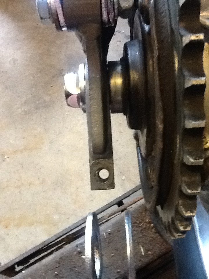

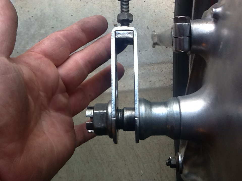

First up, here is a shot of the wheel with the axle installed but not on the bike. On the sprocket side - everything is in contact and looks good. On the drum side - the chain adjuster overhangs the threads by 1/4" (reason why the castle wont thread all the way).

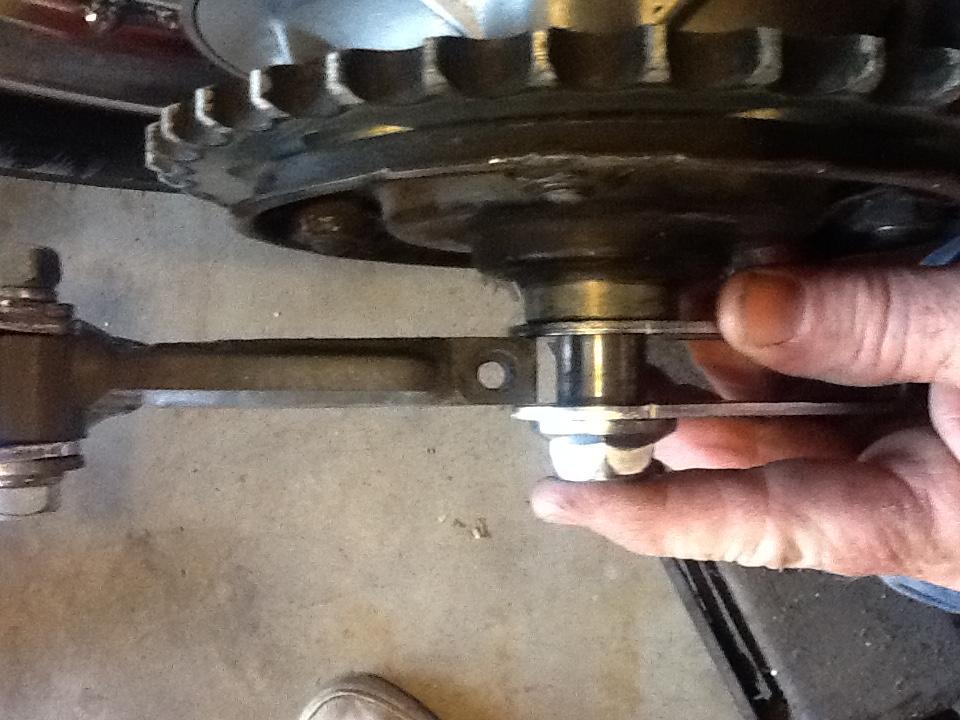

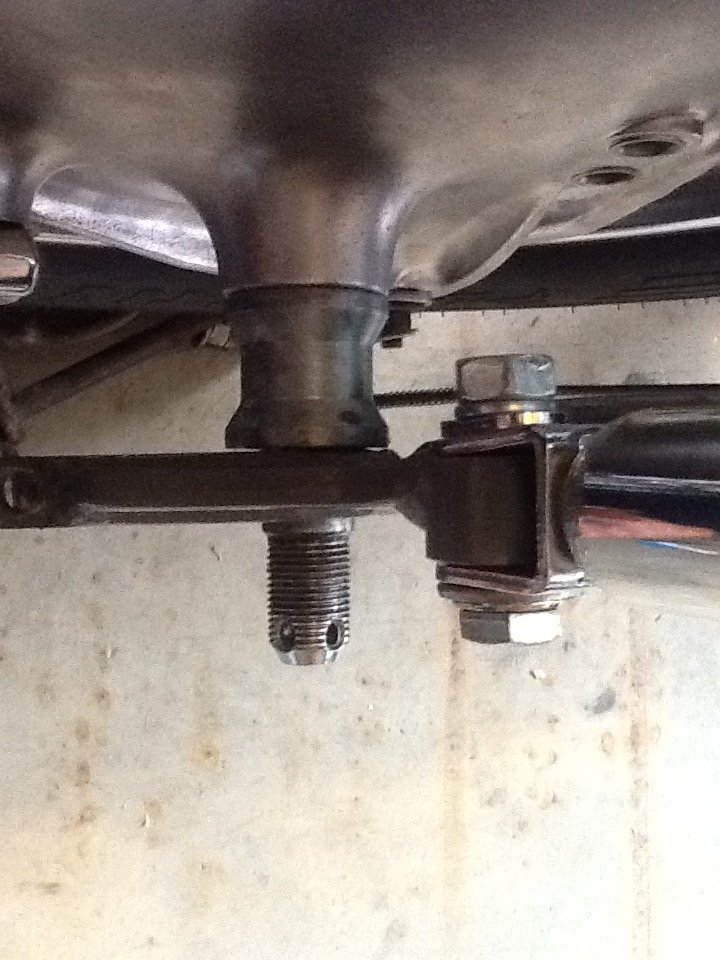

Next up is the wheel and axle installed on the bike. The sprocket side looks good, but notice that on the drum side the swingarm isn't wide enough to make it to the chain adjuster. Additionally, the chain adjuster overhangs the threads by 1/4" which doesn't allow the swingarm to sit on a level part of the axle (even if we pulled the swingarm wide enough to make it fit).

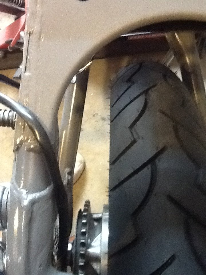

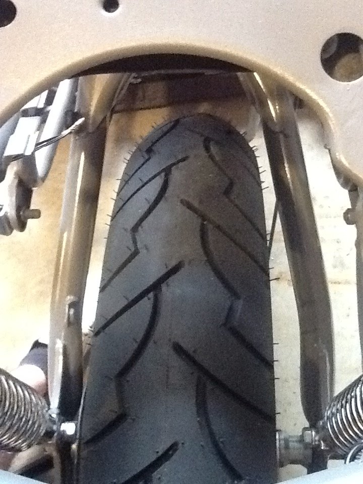

Additionally, if I remove the chain adjusters and mock up the wheel - this is what you see (in the pictures, the wheel/axle is pushed as far forward in the swingarm as possible). There is about 1/8" between the swingarm and the threads - obviously not enough to fit 4 chain adjuster widths. Furthermore, look how far off the wheel is from center. I can fit 2 fingers on the sprocket side and barely 1 on the drum side.

So far everything I have seen leads me to believe that the bearing/spacer on the sprocket side that sits partially inside the hub, is not correct. If it were 1/4" less protruding out, it would allow the swing arm to rest on a level part of the axle, allow for the castle to be threaded all the way, and would solve the issue of the wheel not being in the center.
the tire will not necasarily be centered in the swingarm what you want is the sprockets inline and the wheels on the same centerline
Ok, that clears that up. Thank you!
