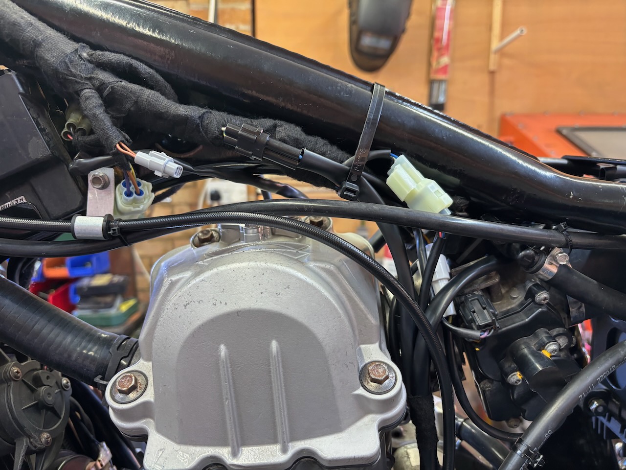

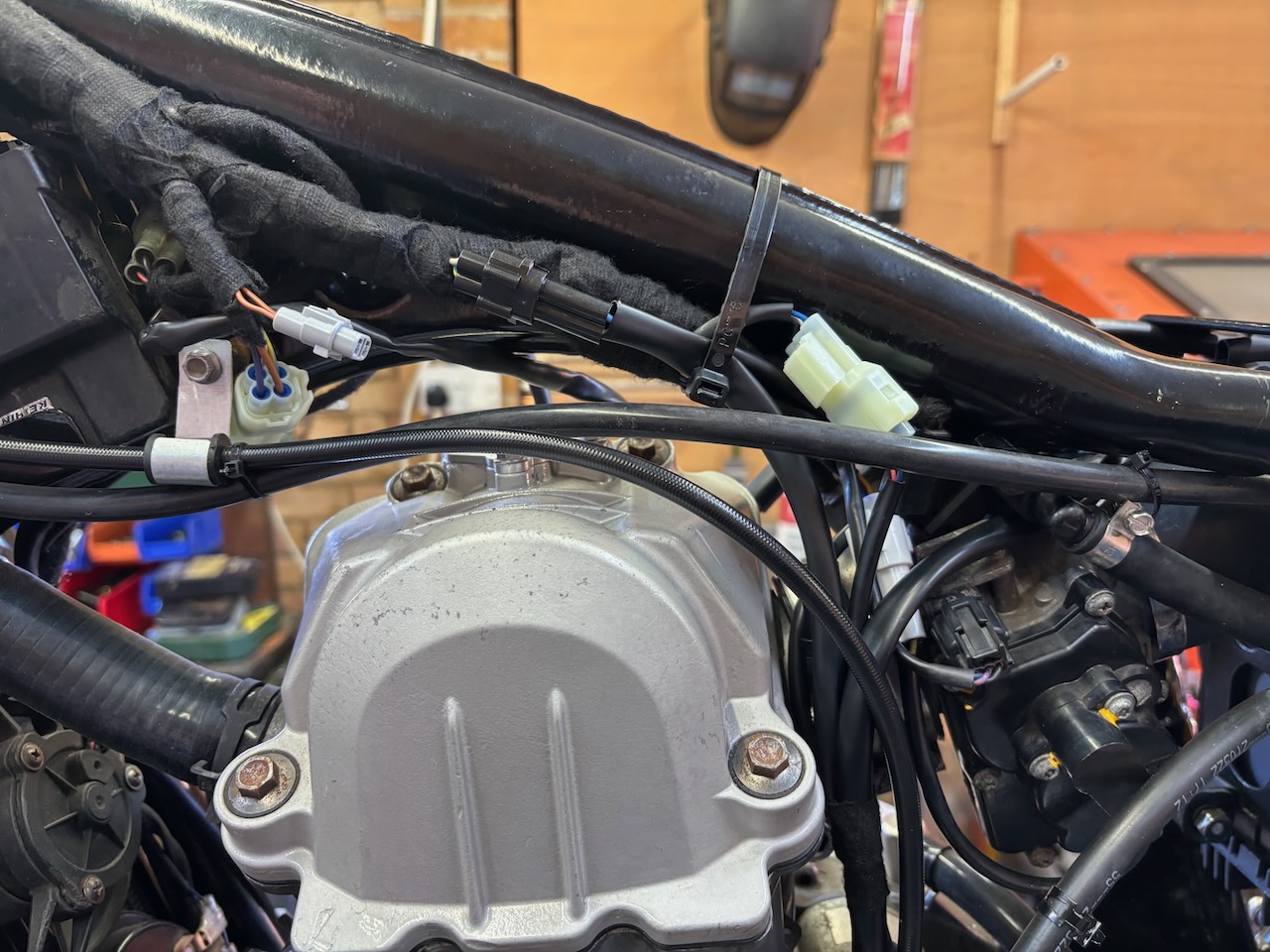

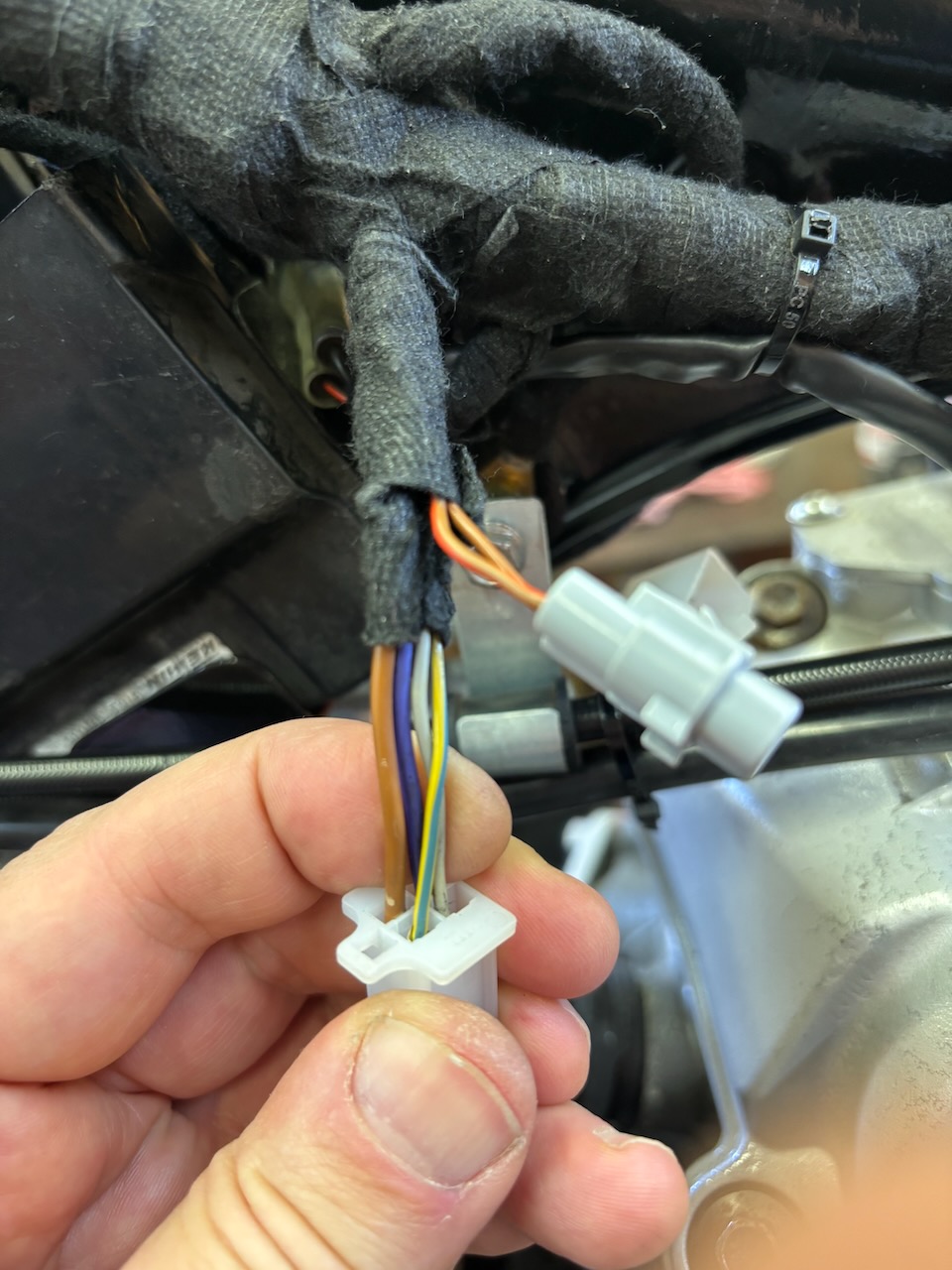

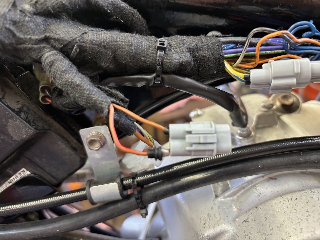

Why doesn't the neutral light work? Let's spend 2 hours hunting it down. I checked the function of the gear position switch. I poured over the wiring diagrams. I checked the continuity from the connector to the EFI computer and the instrument display. I checked that I hadn't incorrectly reassembled the connector and misplaced the wires. Oops. I had swapped the neutral switch connector with the throttle position sensor connector. They are the same 3-pin connector and are very close to each other. Problem solved.

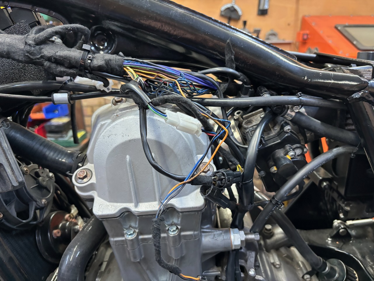

I was never completely happy with the wiring harness I made, some of the spurs didn't end up coming out of the harness in the right location or the spurs were too long. Now that I've got it partially un-taped I can correct that, so silver lining there.

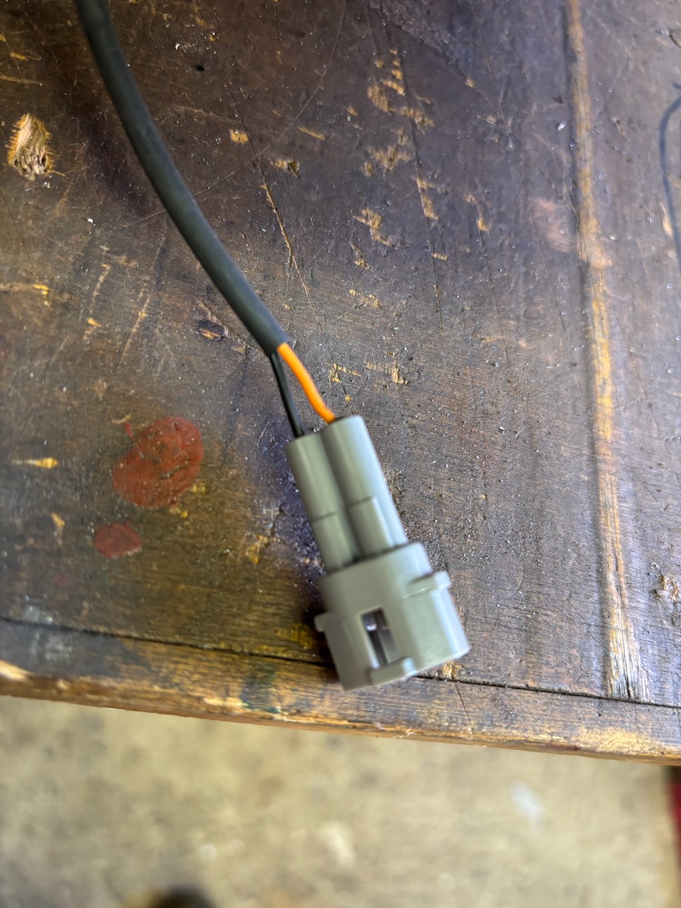

I took the opportunity to replace a bunch of connectors with automotive style sealed connectors. Specifically Sumitomo HM090 and MT090. I love them.

Harness is all done now, and better than it was before.

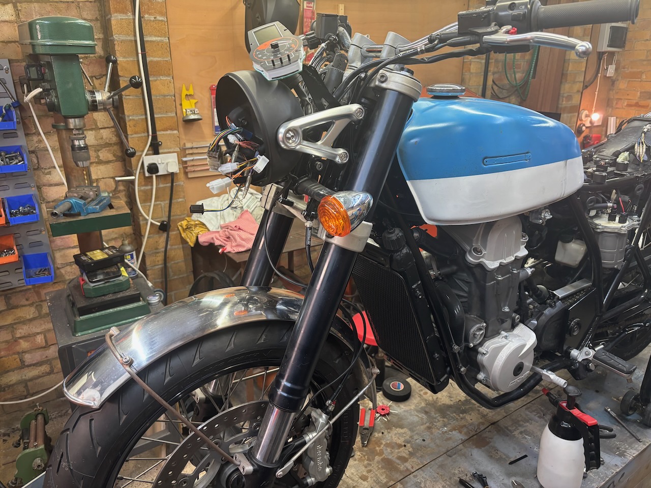

Hey I'm really struggling to pick out a paint scheme, what do you think? You think it needs something bright to balance out the black frame and wheels and stuff? I was thinking one solid colour, but can't really choose one.
Seems like the various manufacturers have a favorite signature colors; red for Honda, blue for Suzuki, yellow for Yamaha, isn't KTMs color orange? Maybe KTM orange in a Honda-like paint scheme?
I had thought of that! Maybe the CB550f orange colour? Or maybe KTM orange but in the two-colour CB350 scheme?

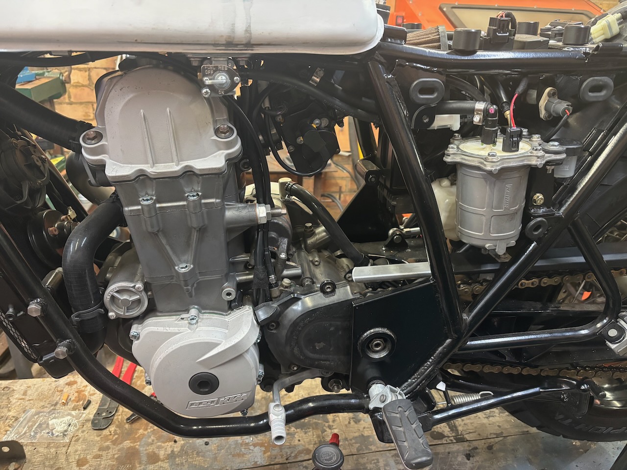

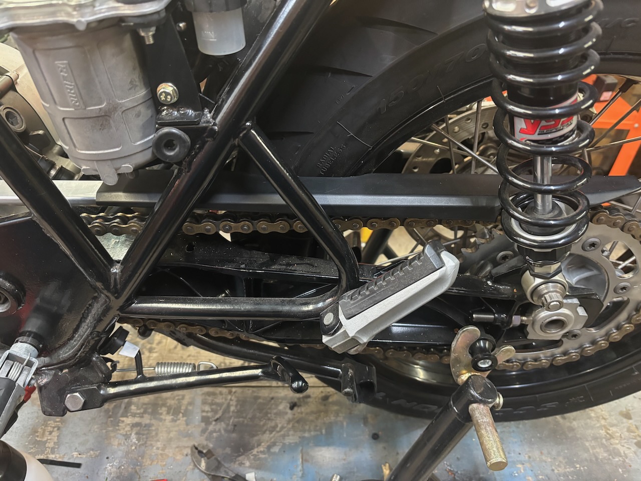

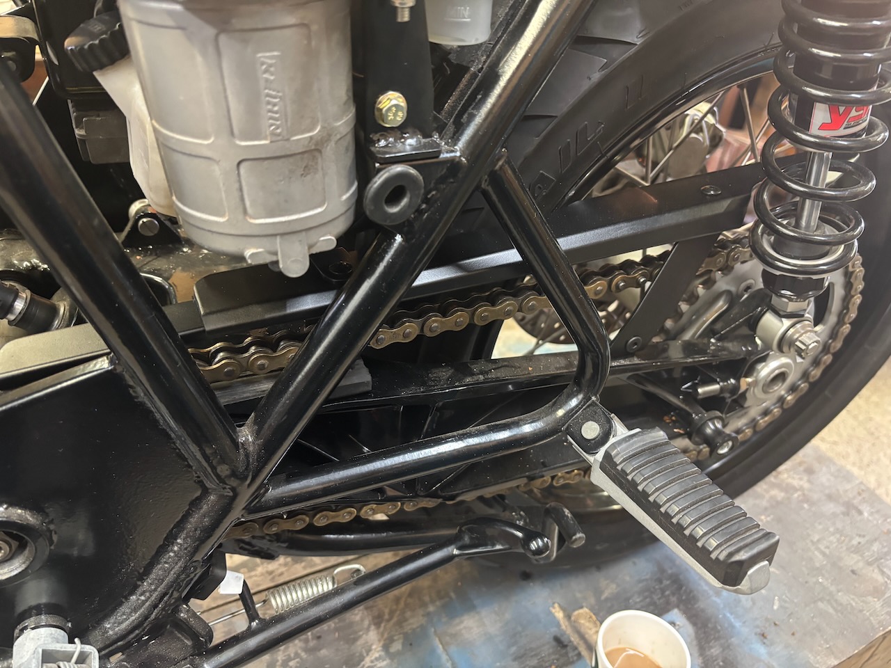

Chainguard is complete. It is a cut-up KTM part, with the original mount removed and replaced with aluminium, and a relief area for the shock. Also I extended it a bit in the front to get better chain coverage right next to the sprocket. I don't love it, but it disappears in the bike and looks fine.

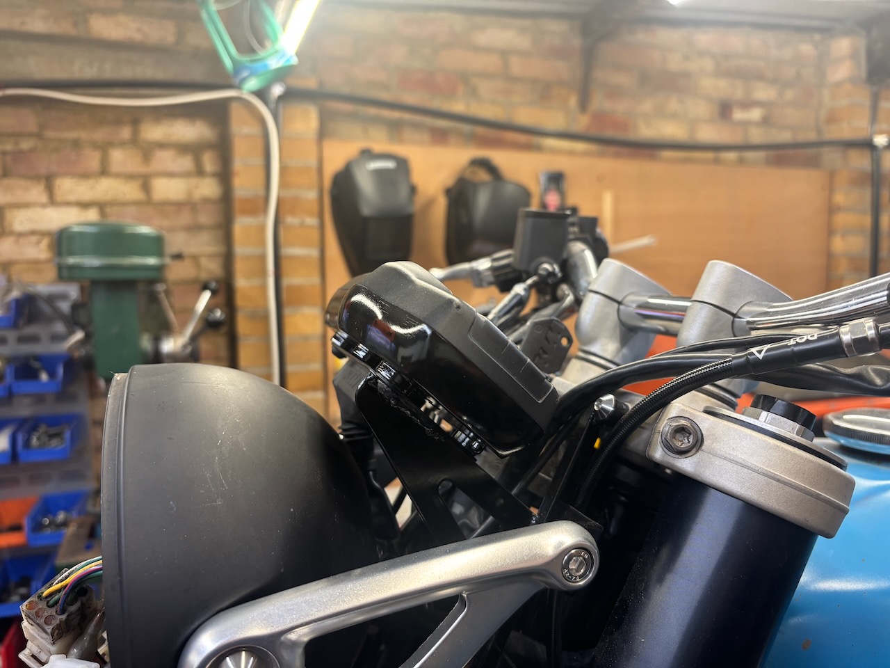

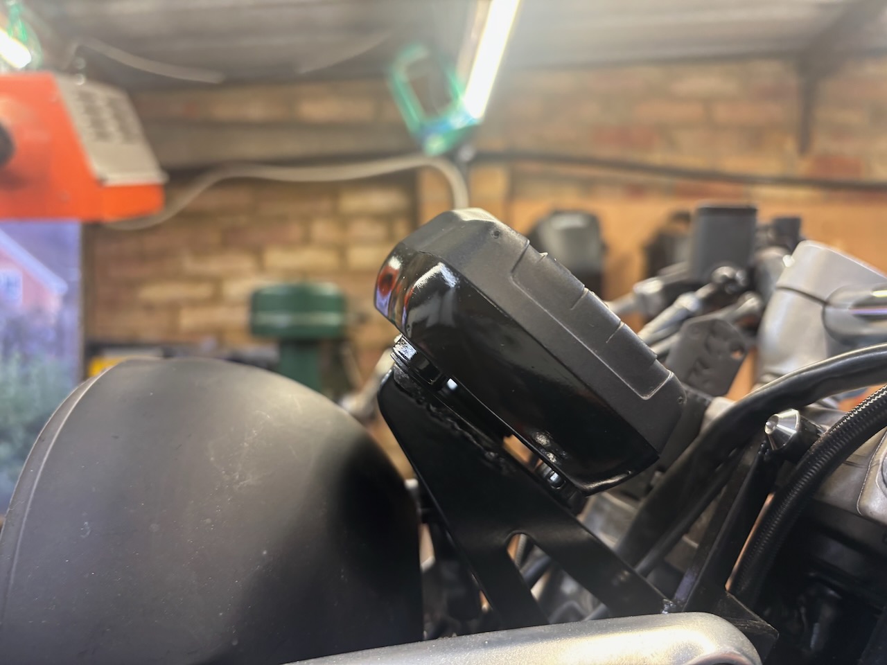

Also finished the instrument pod. I finished sanding and prepping the epoxy filler and gave it some paint, also don't love it, but man I have to finish this bike. It looks fine.

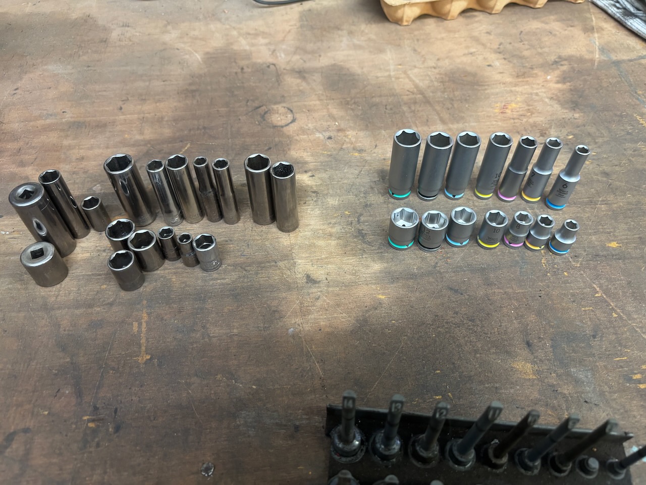

Also replaced my 20 year old Craftsman 1/4 inch set with a new Wera set, highly recommend.

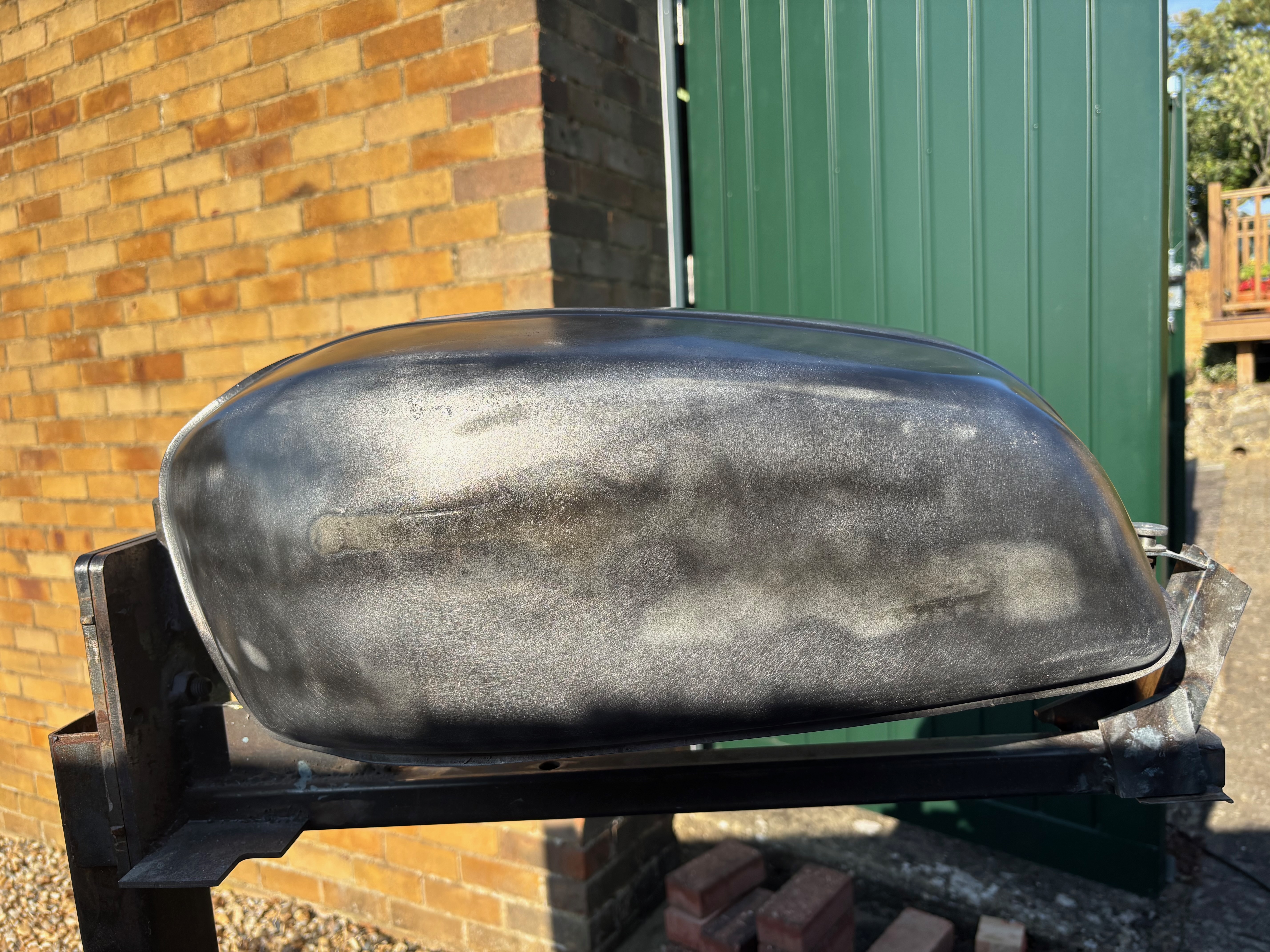

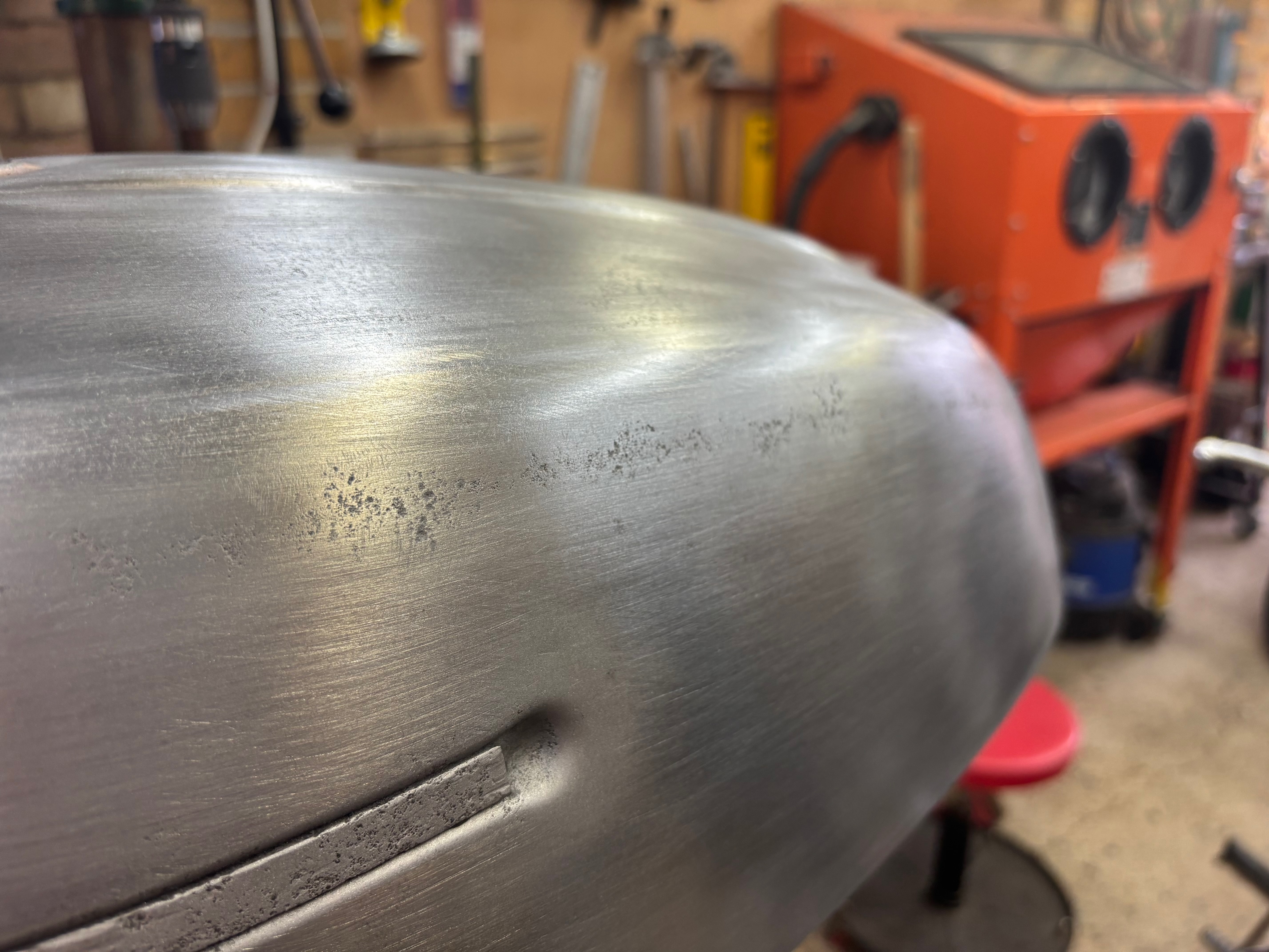

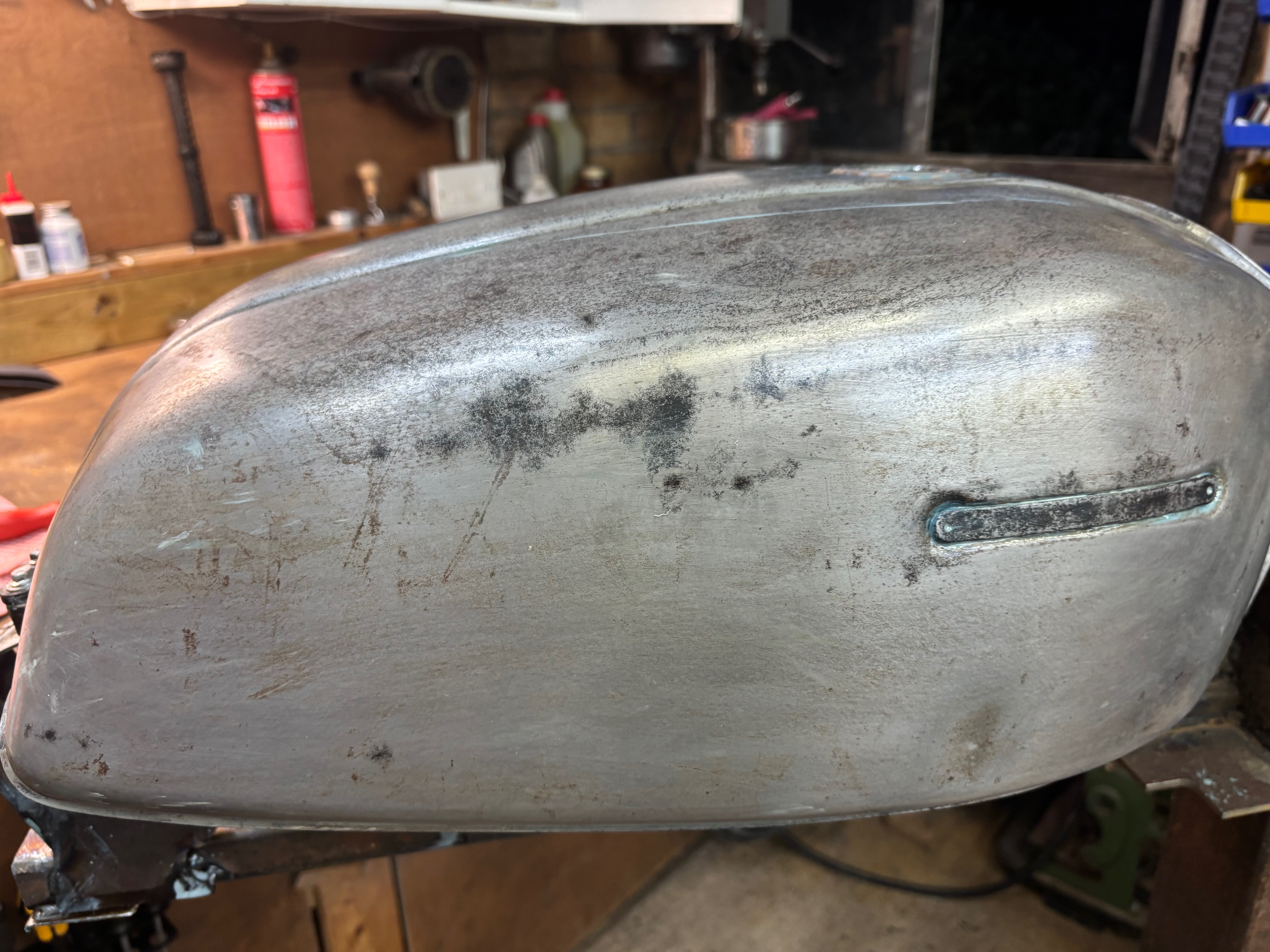

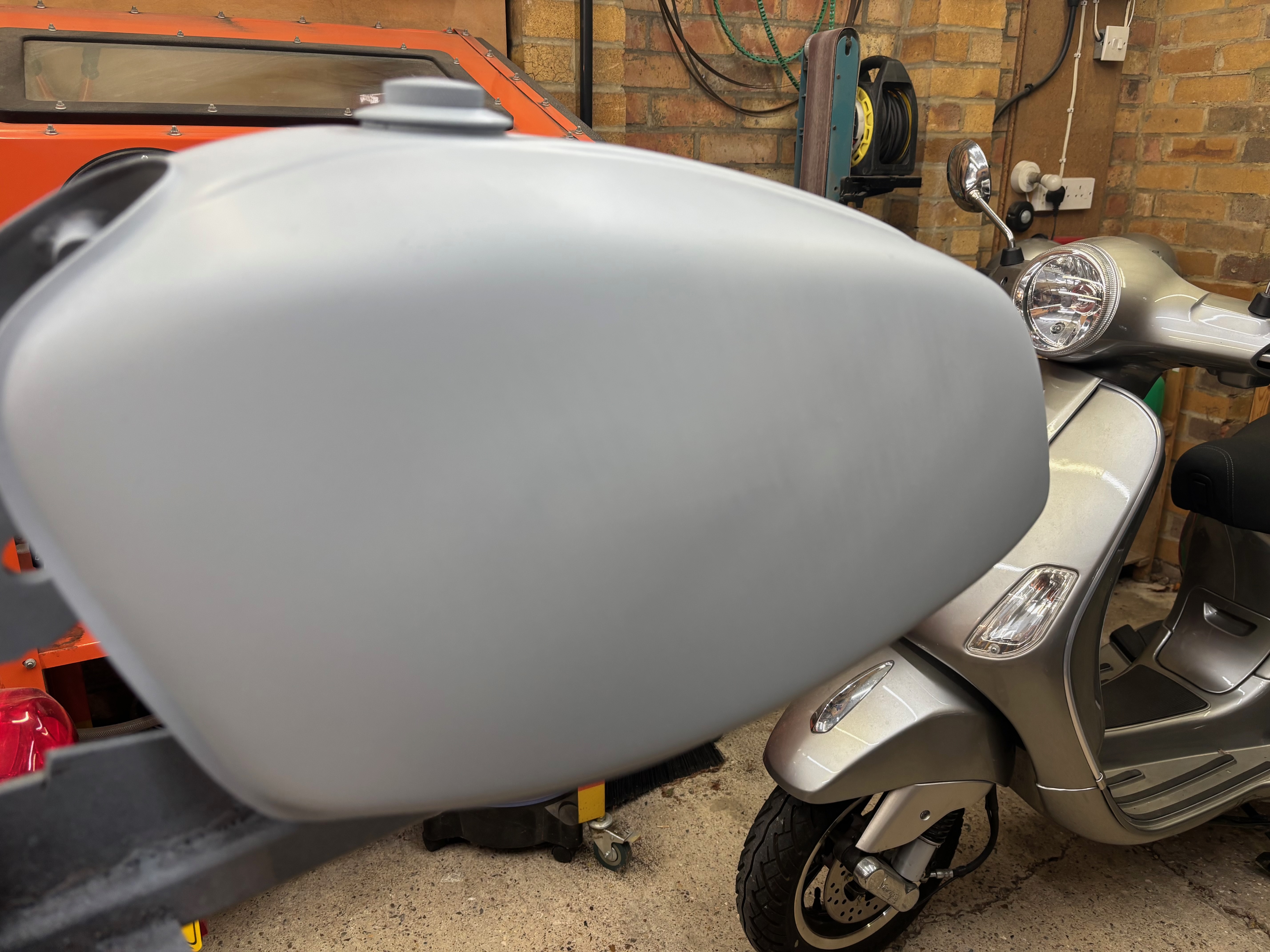

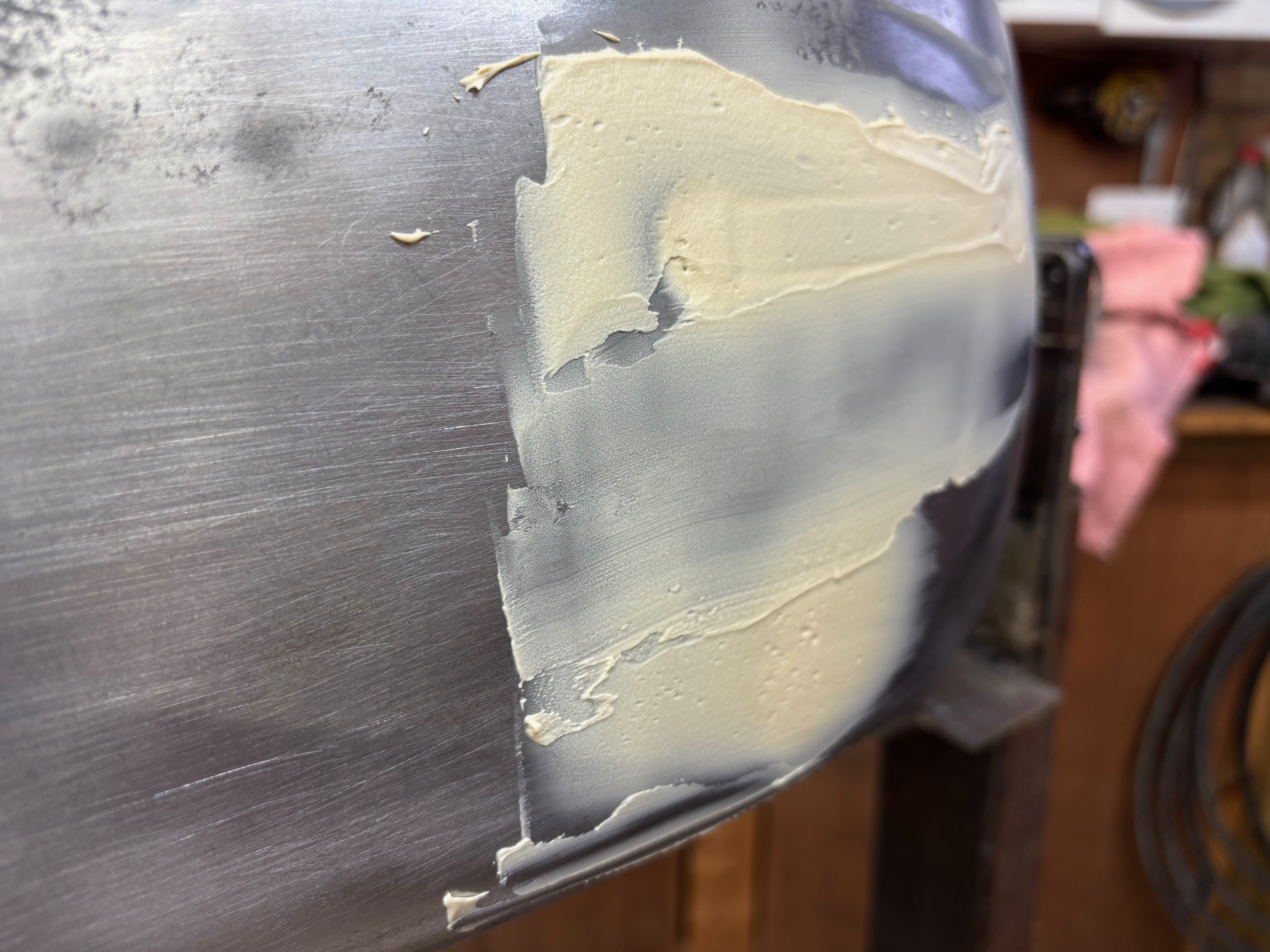

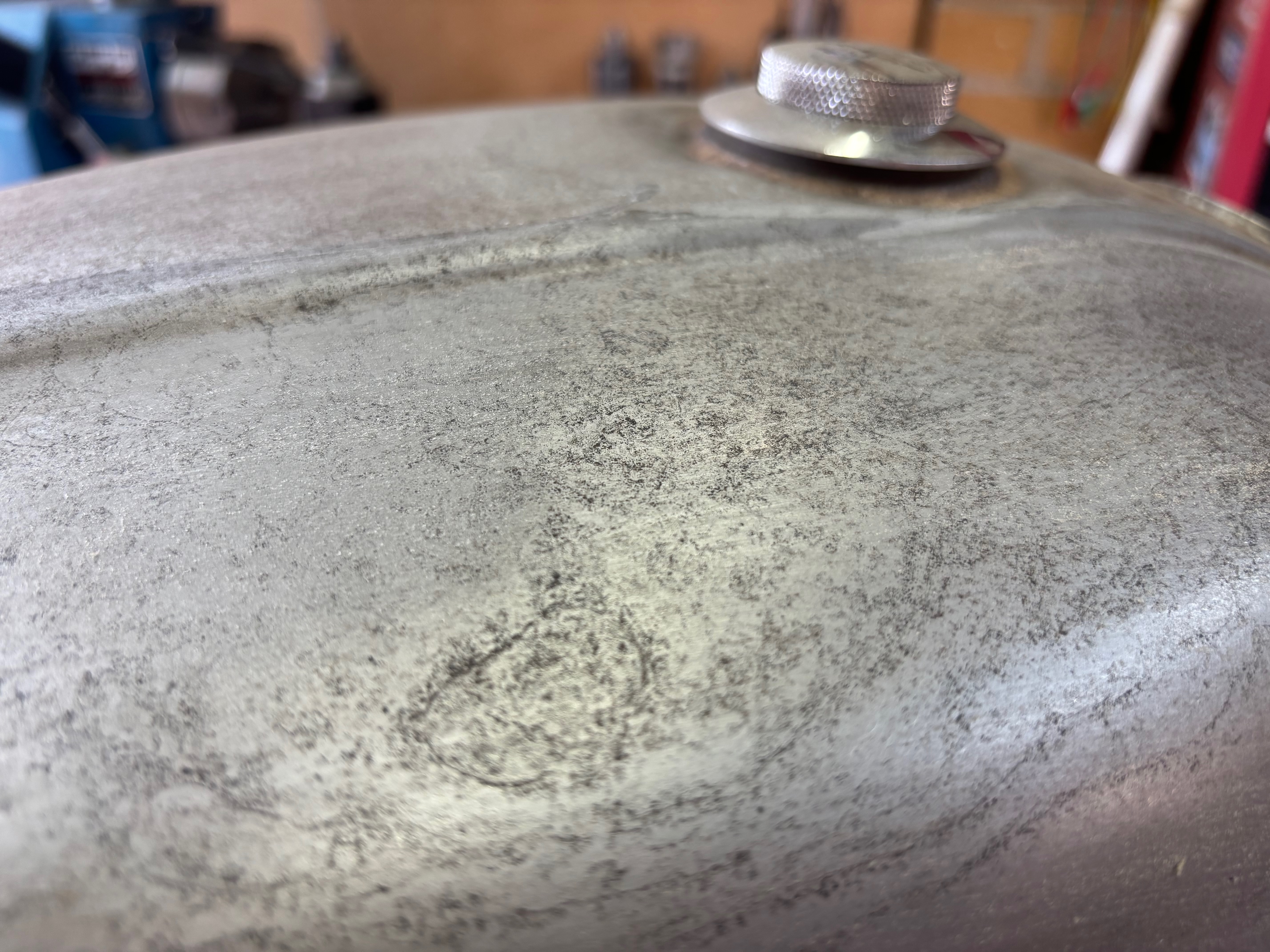

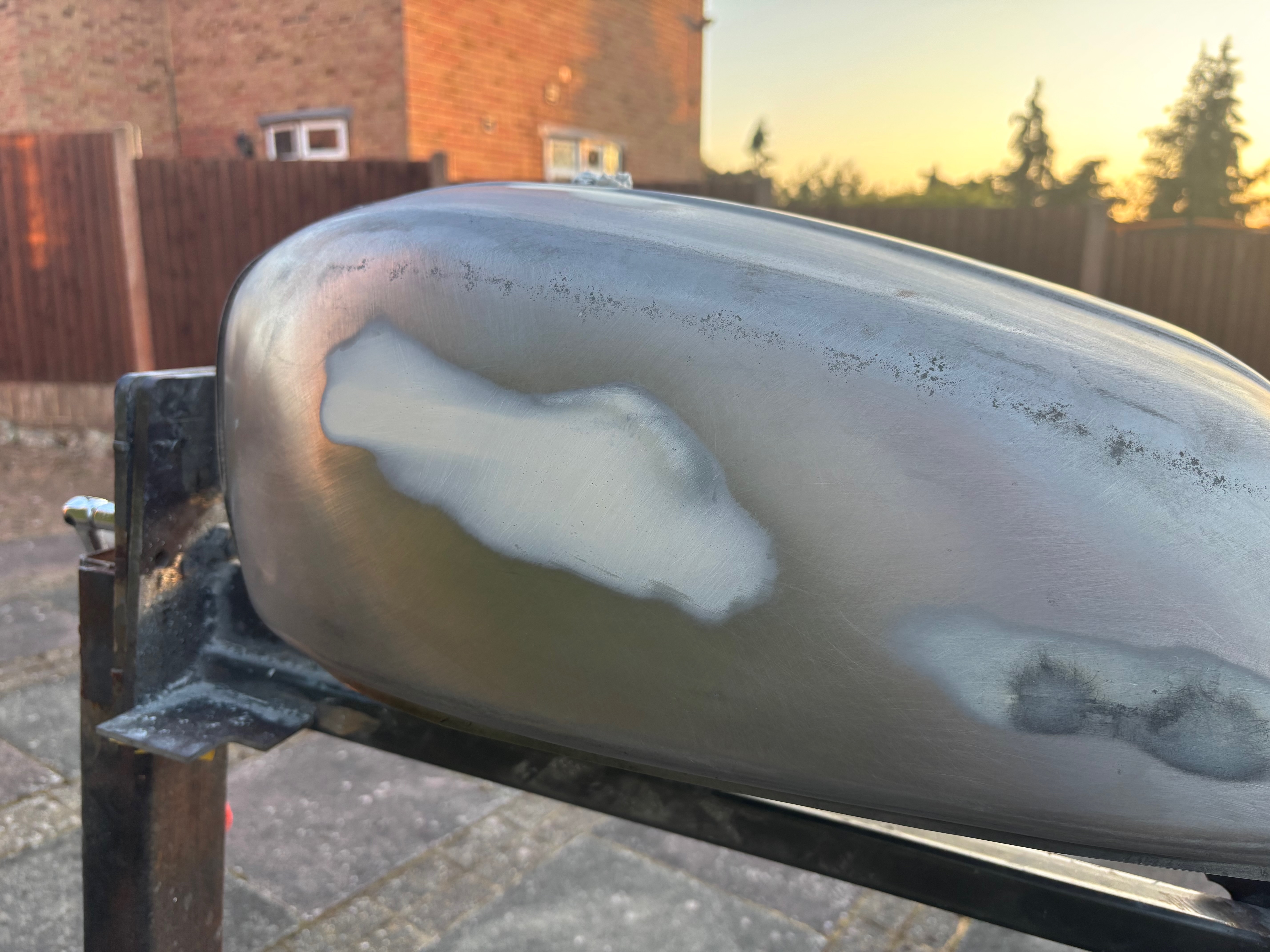

I stripped the tank and sanded down to the base metal. The tank was much more pitted than I had remembered, especially under where the original decals went. After much work it smoothed out enough.

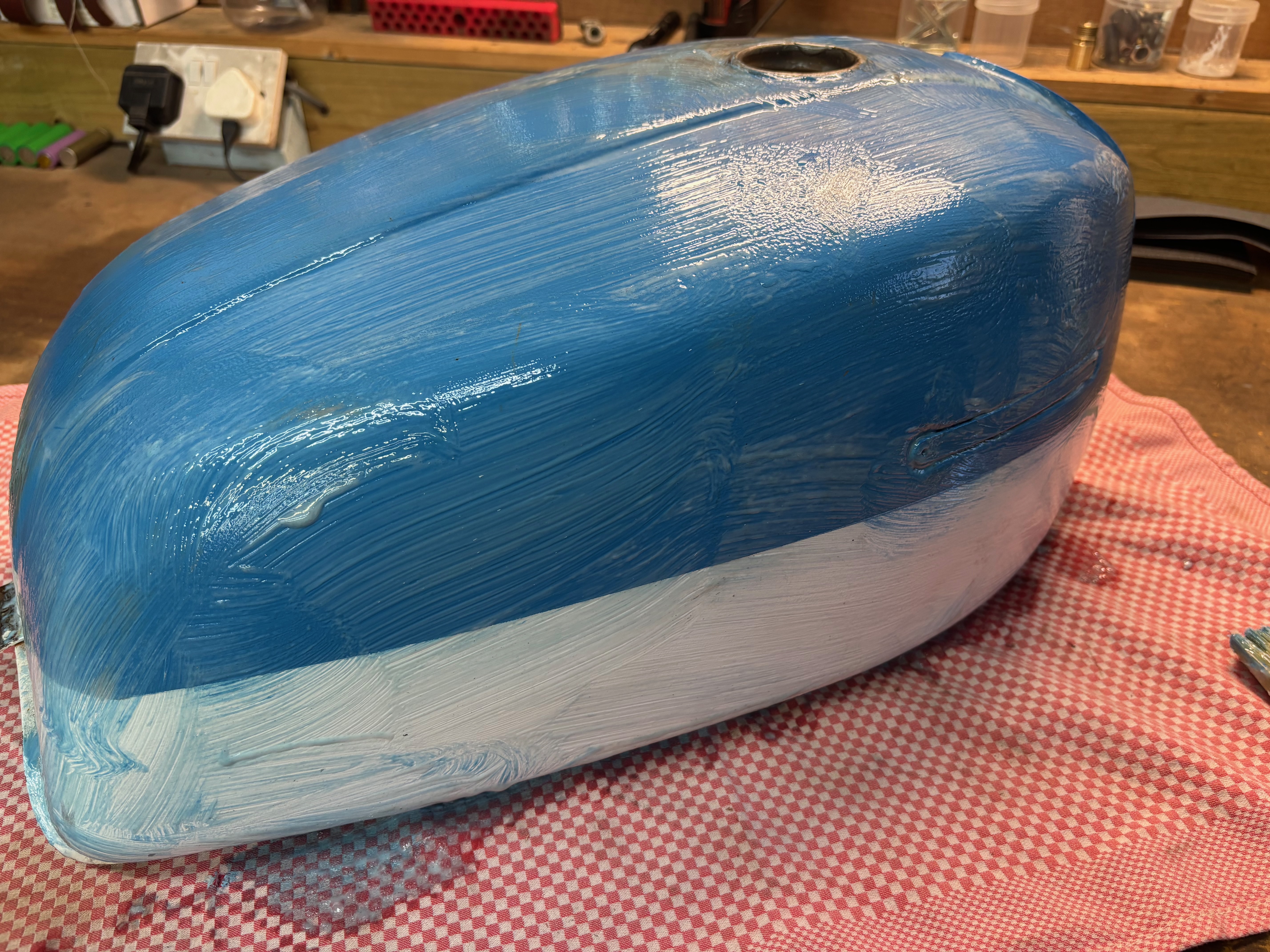

Polyester filler, sanding, guide coat, etc. I filled the tank badge hollows, but then sanded down too much. All in all this took several days of re-application and sanding.
By the way, I bought some really cheap cutting boards from amazon, they do a great job for mixing the body filler, and other epoxies and such.

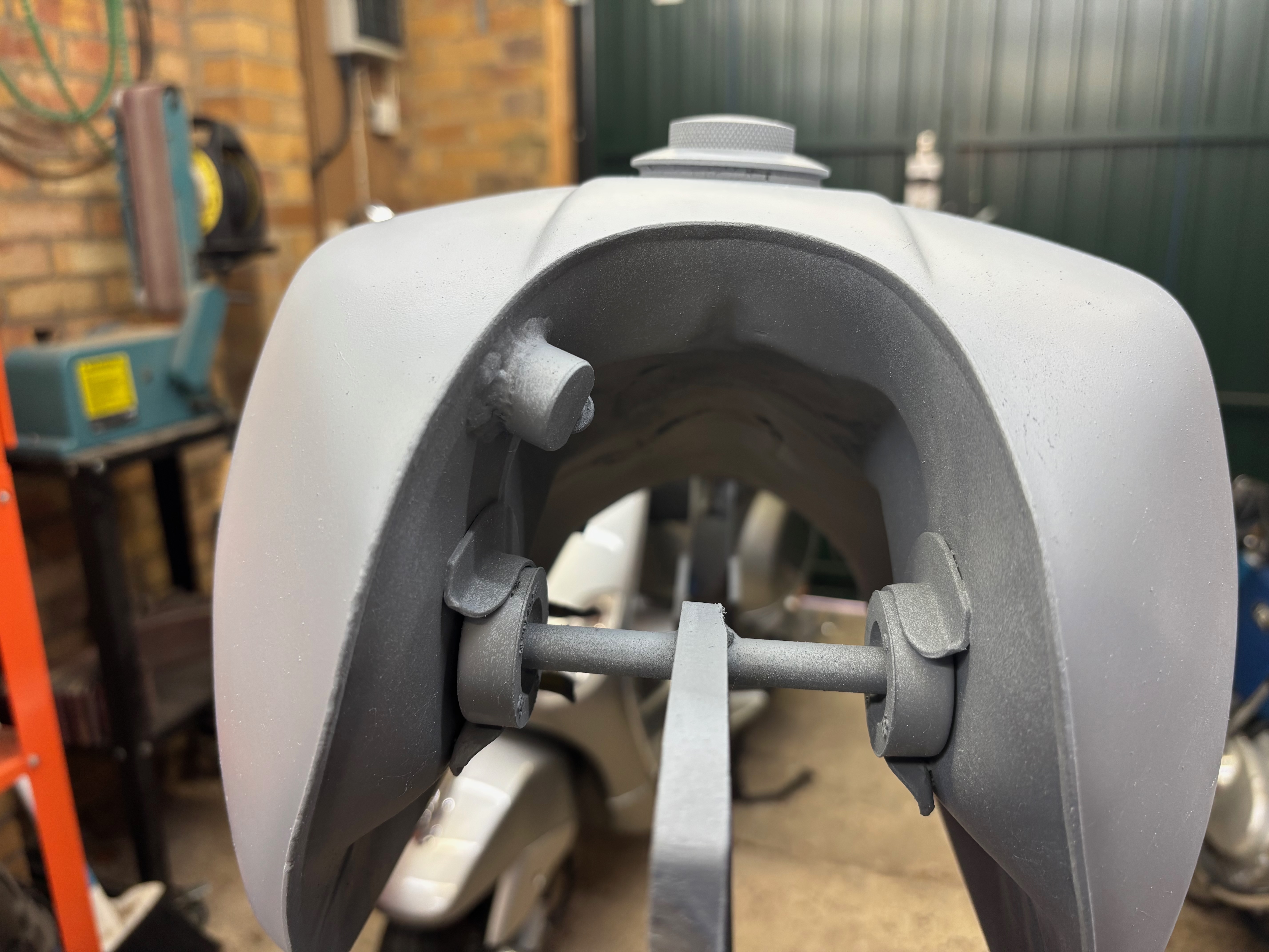

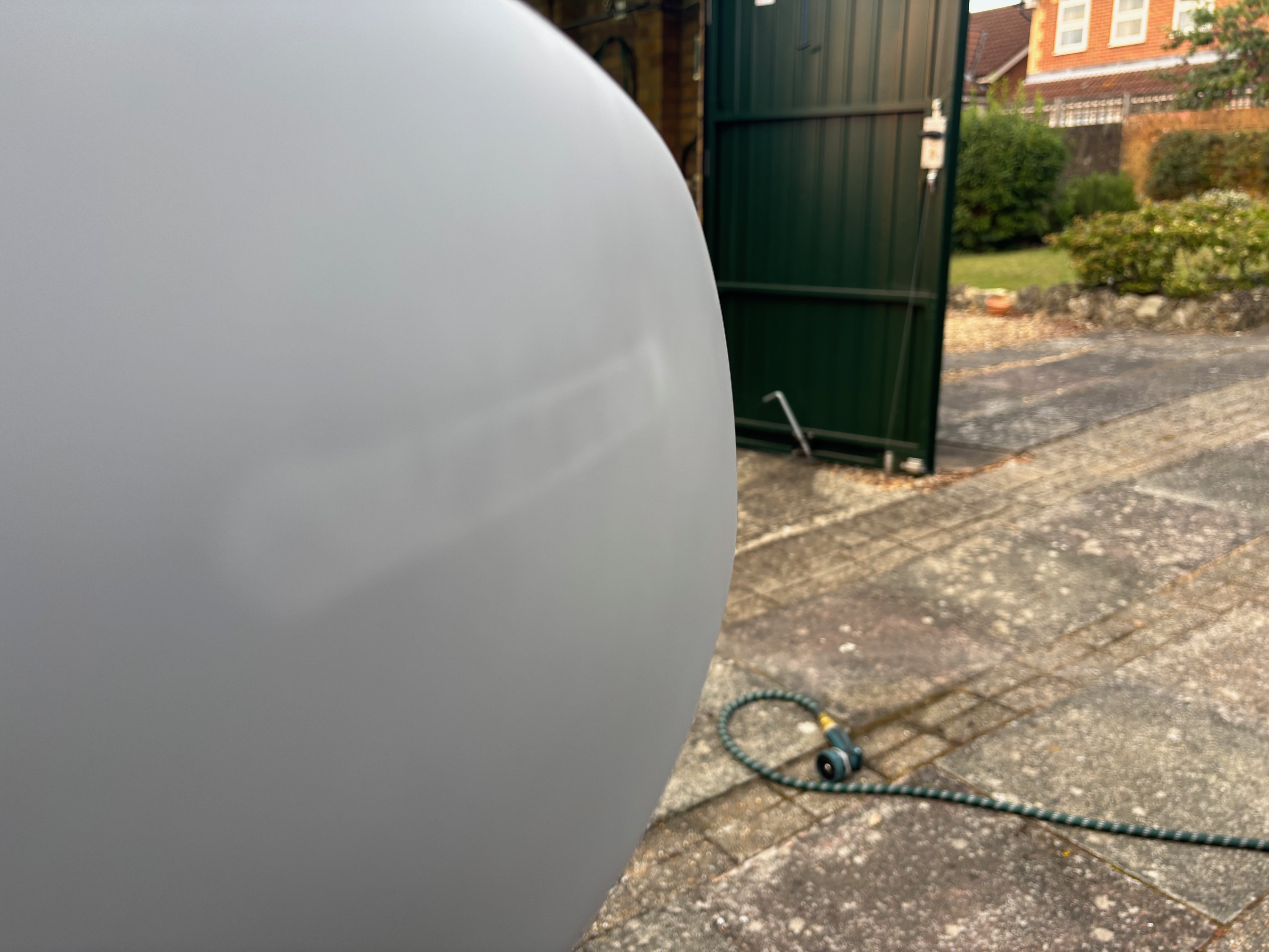

Final body filler and sanding, then etch primer. I did about two coats of etch primer, then switched to high-build primer to help fill in the corrosion spots. Oh and the side covers, too, don't forget about them.

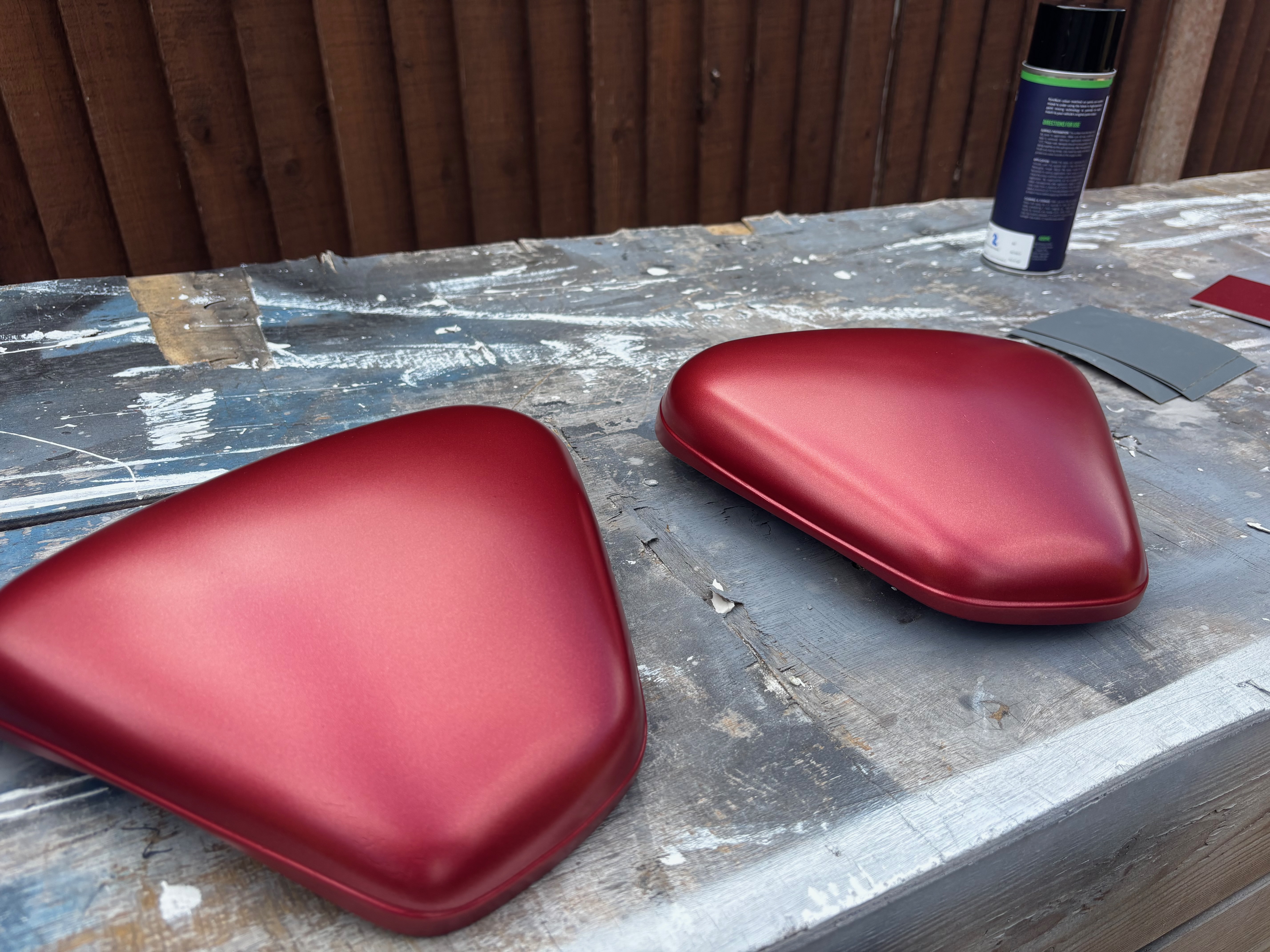

Color! It is Mazda 46V paint, Soul Red Crystal. It's a 3 stage paint, so it requires primer, base, pearl clear, and final clear.
