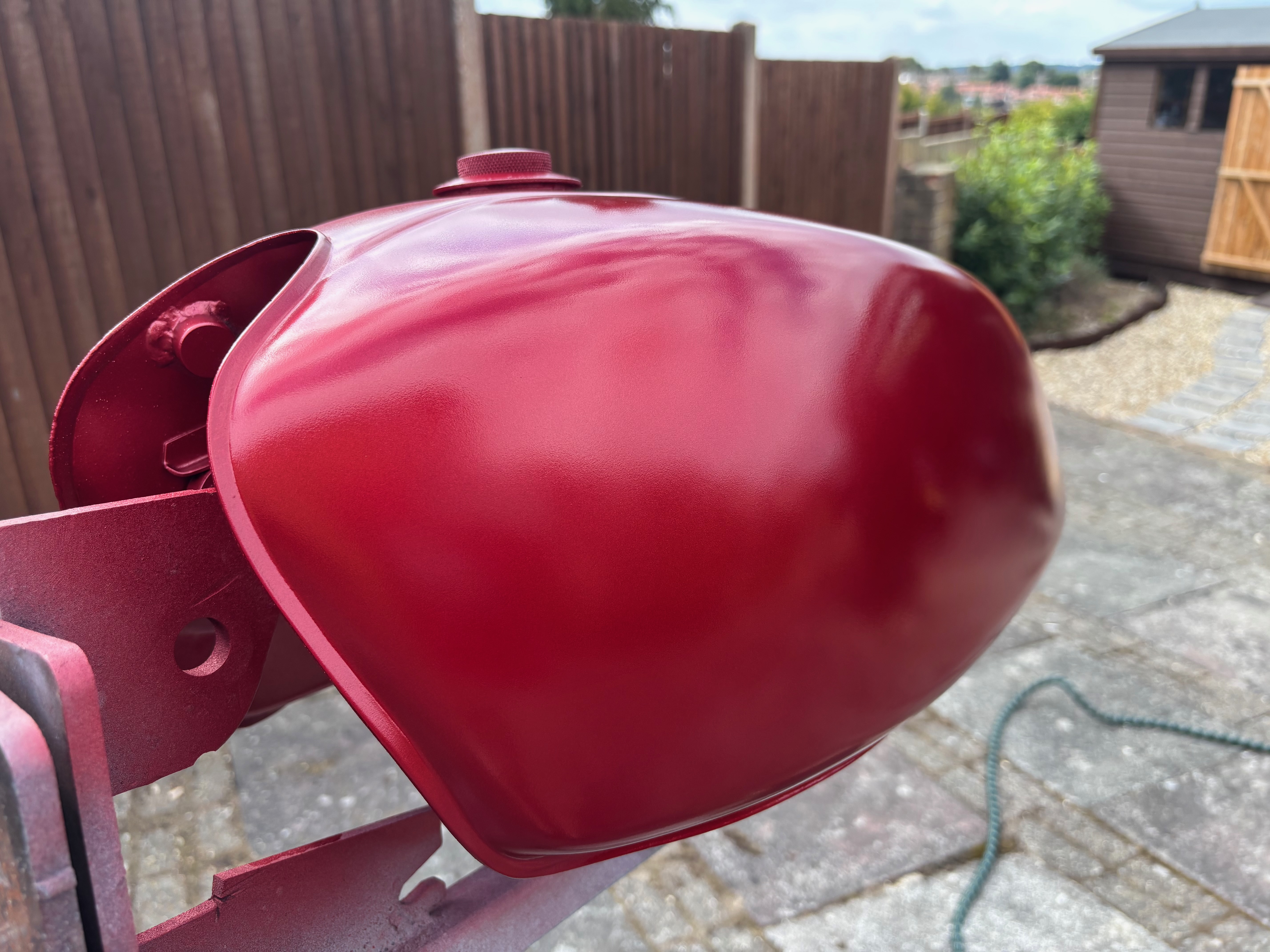

Sanded back to correct some defects, then more base colour.

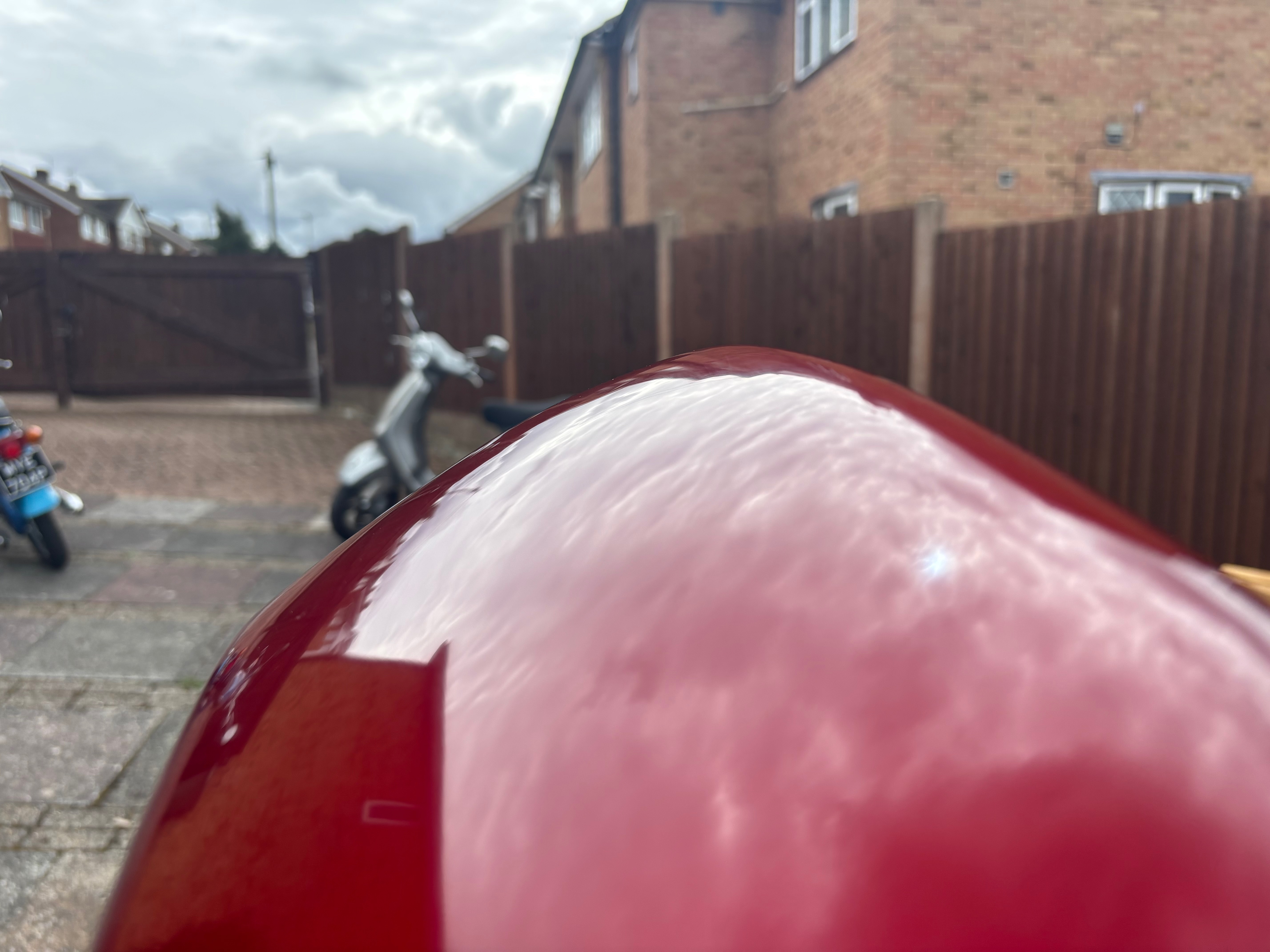

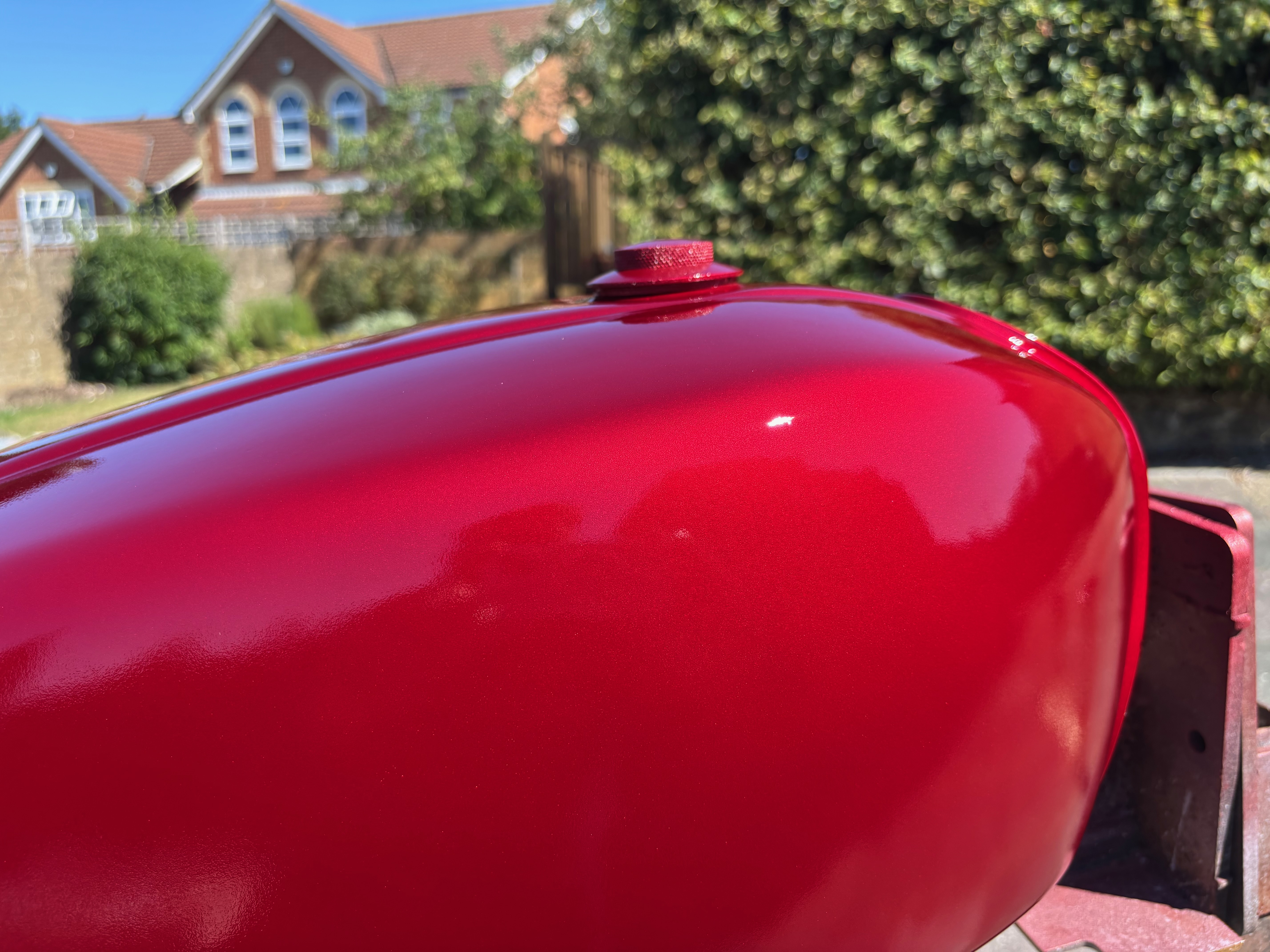

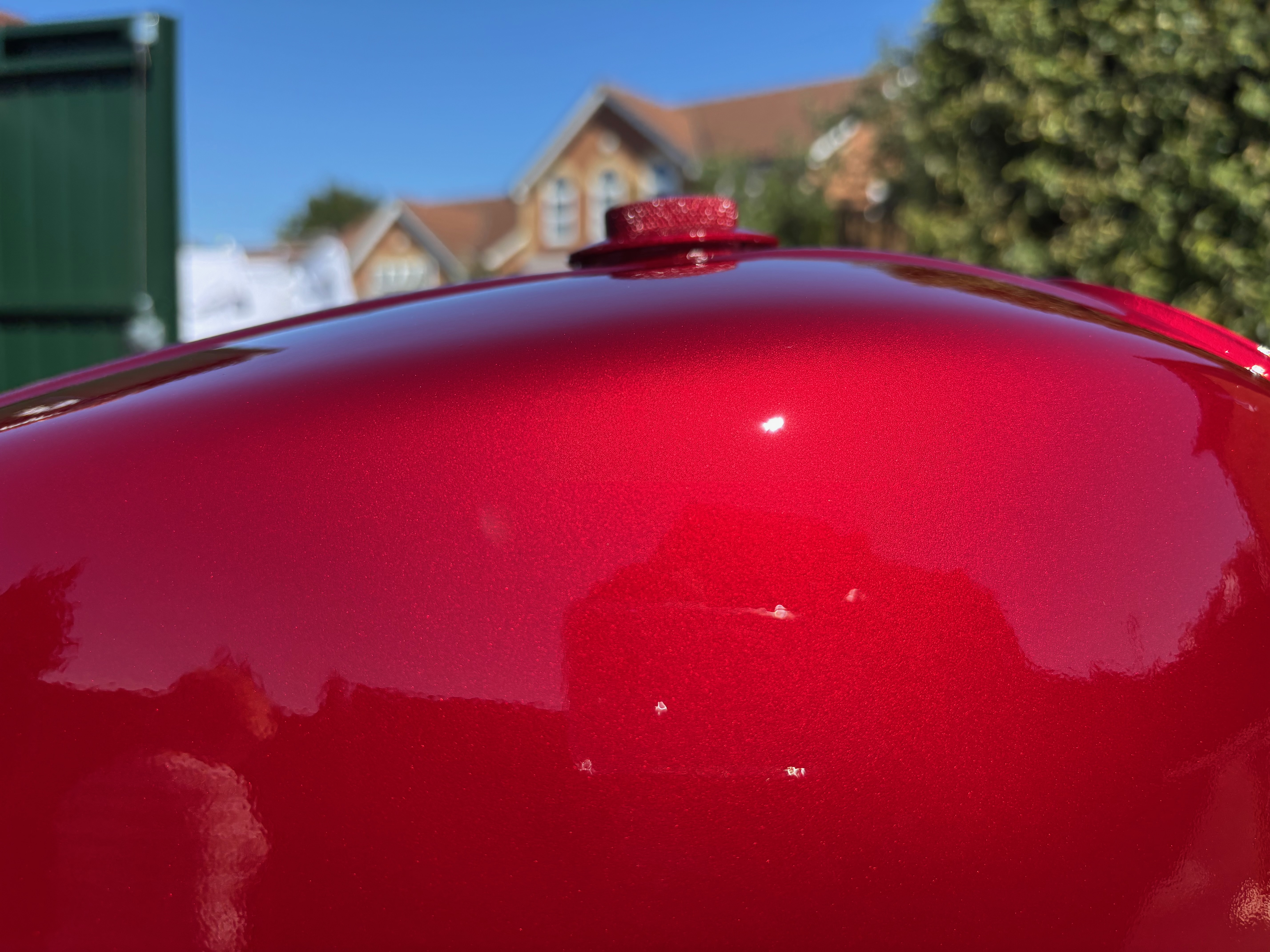

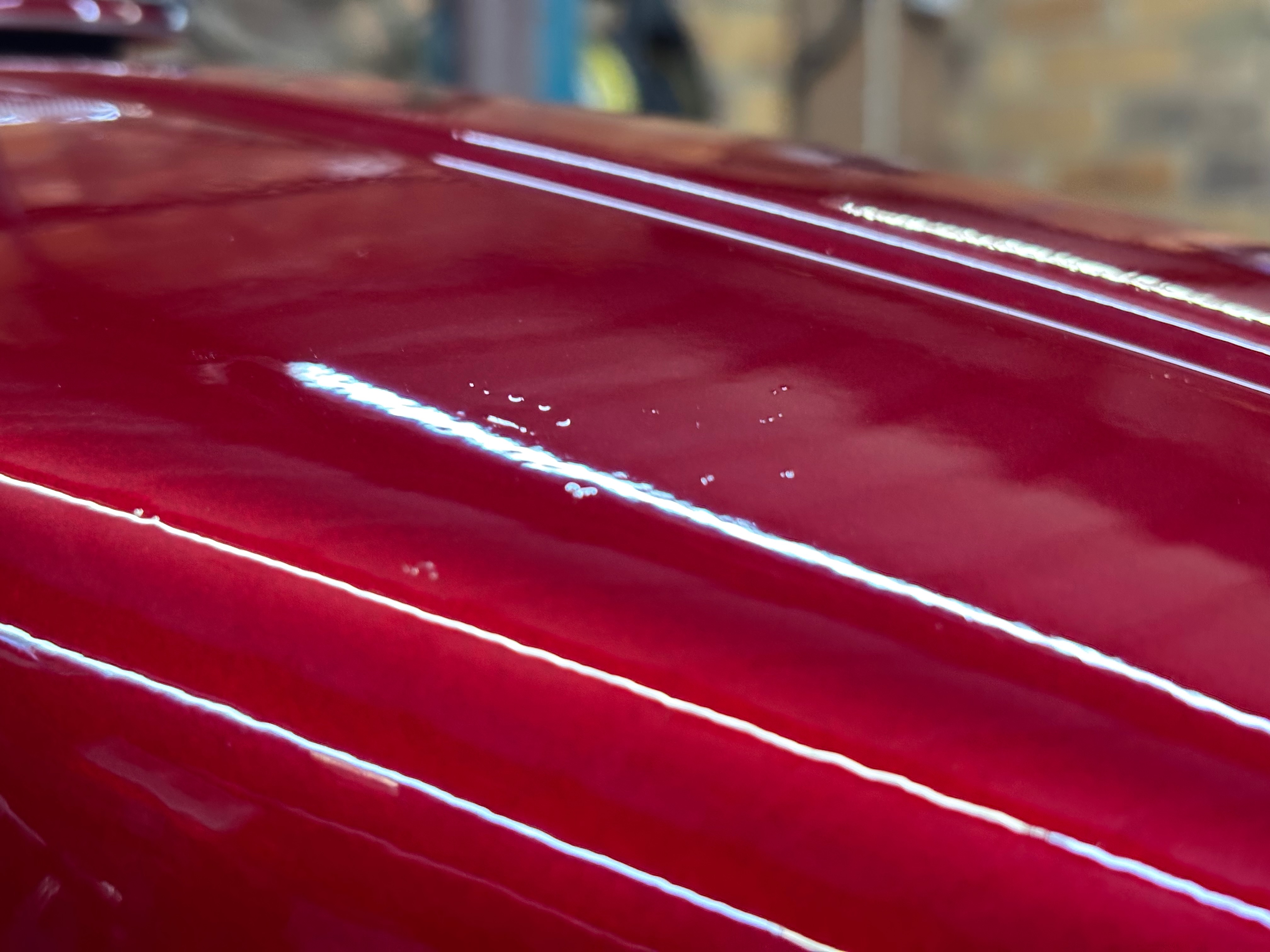

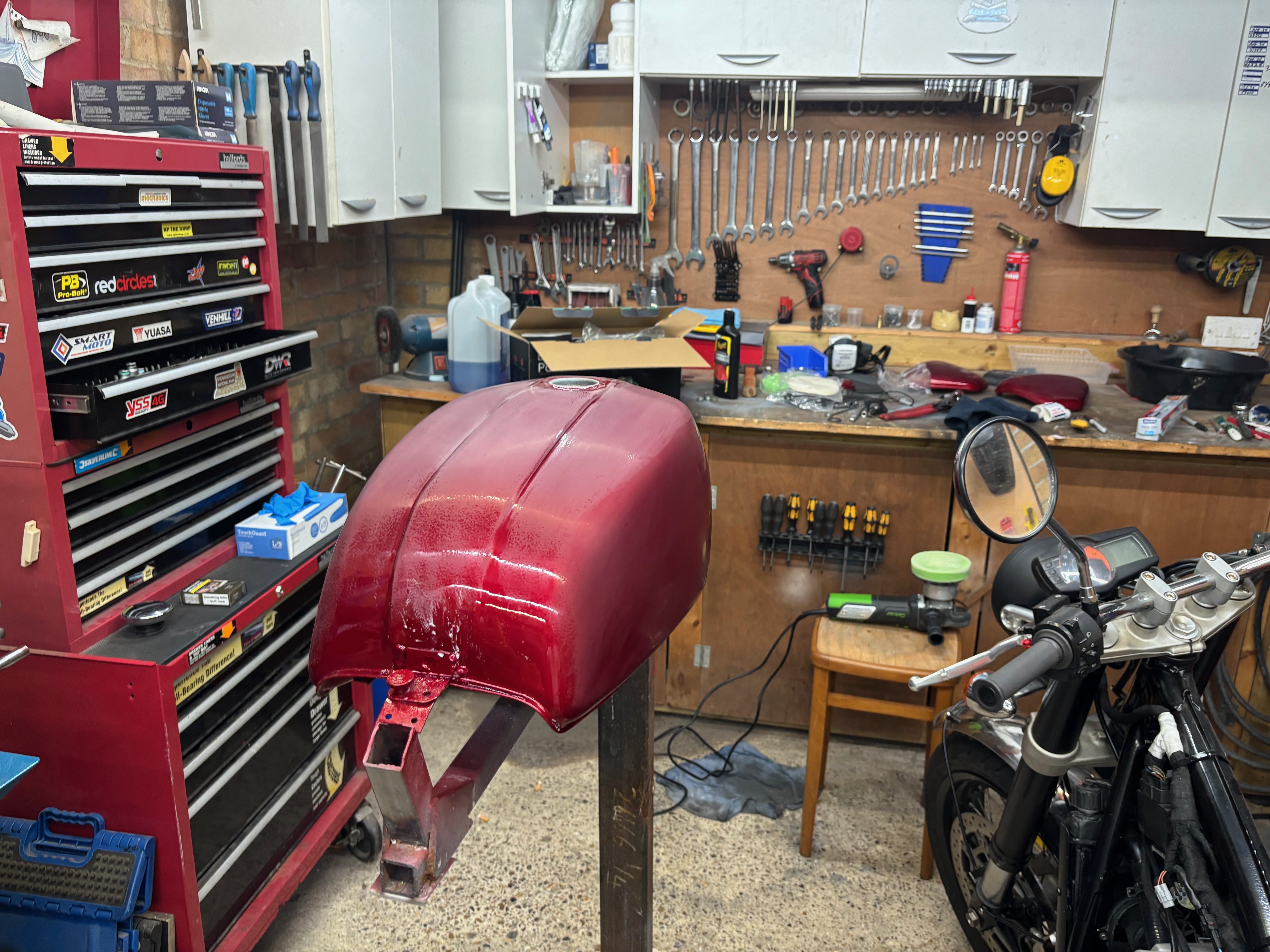

And after the 2K clear! Wow, the gloss in incredible. But, there are some pretty bad defects from dust and dribbles and stuff. It will need to be sanded.

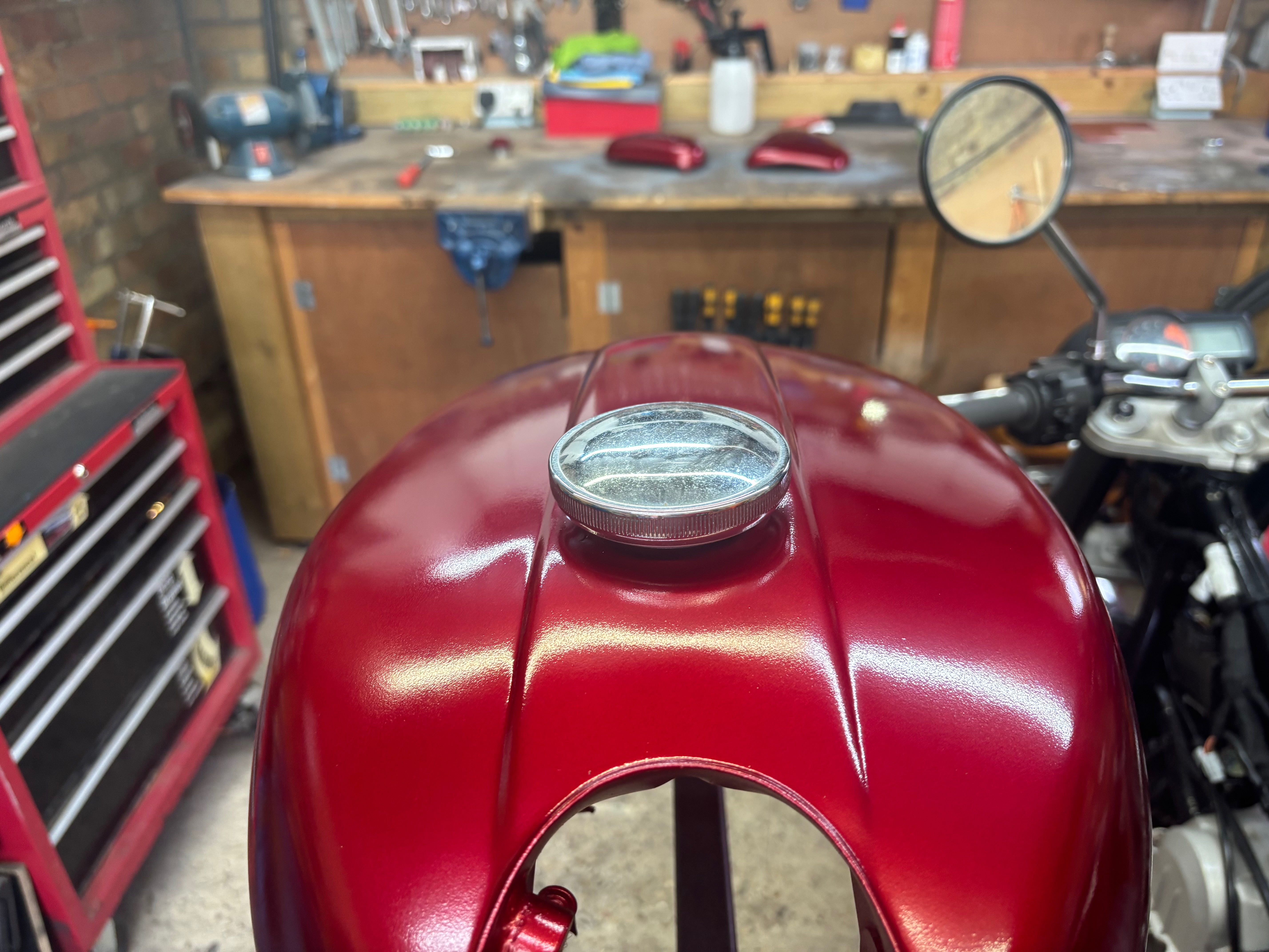

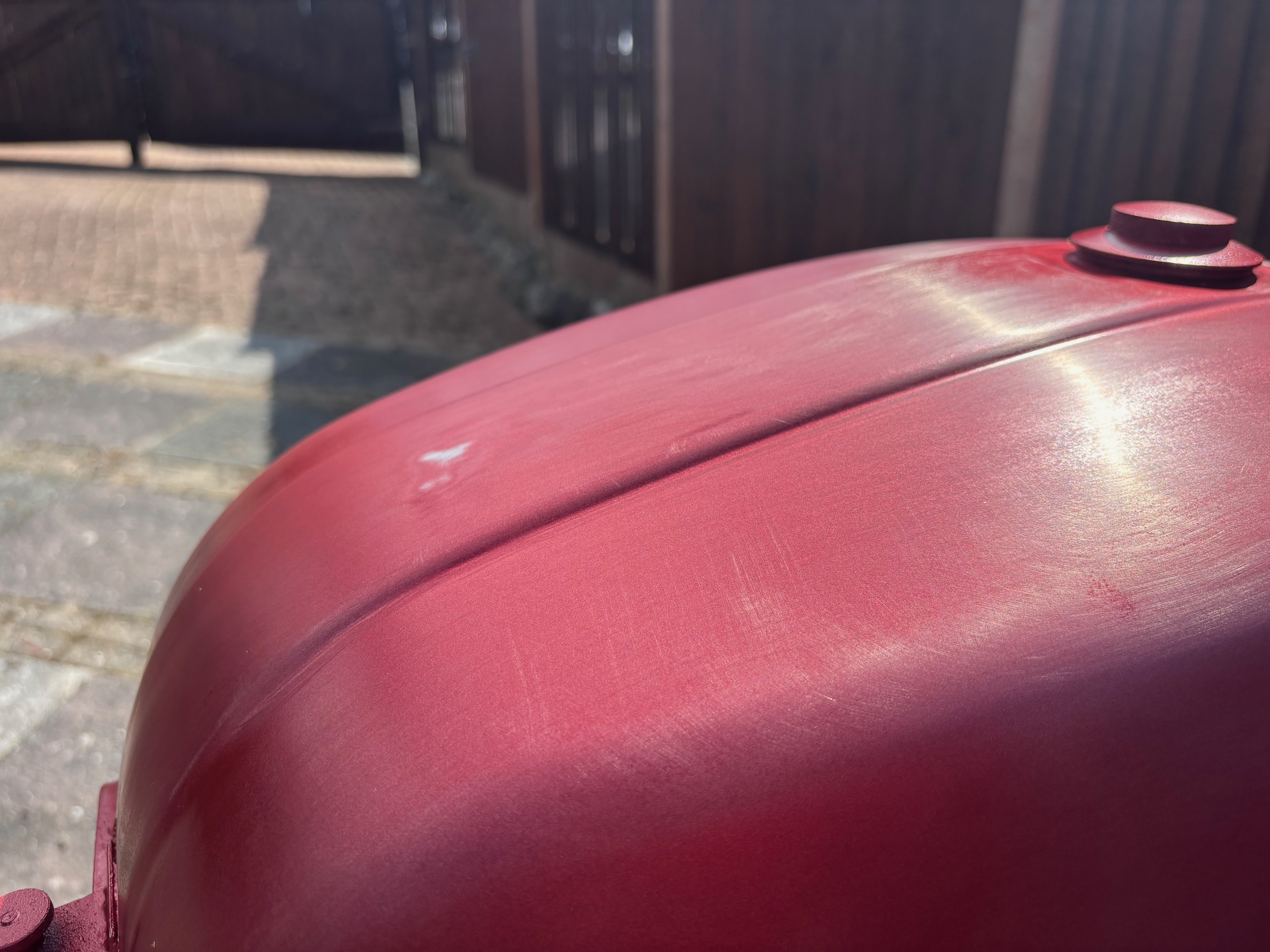

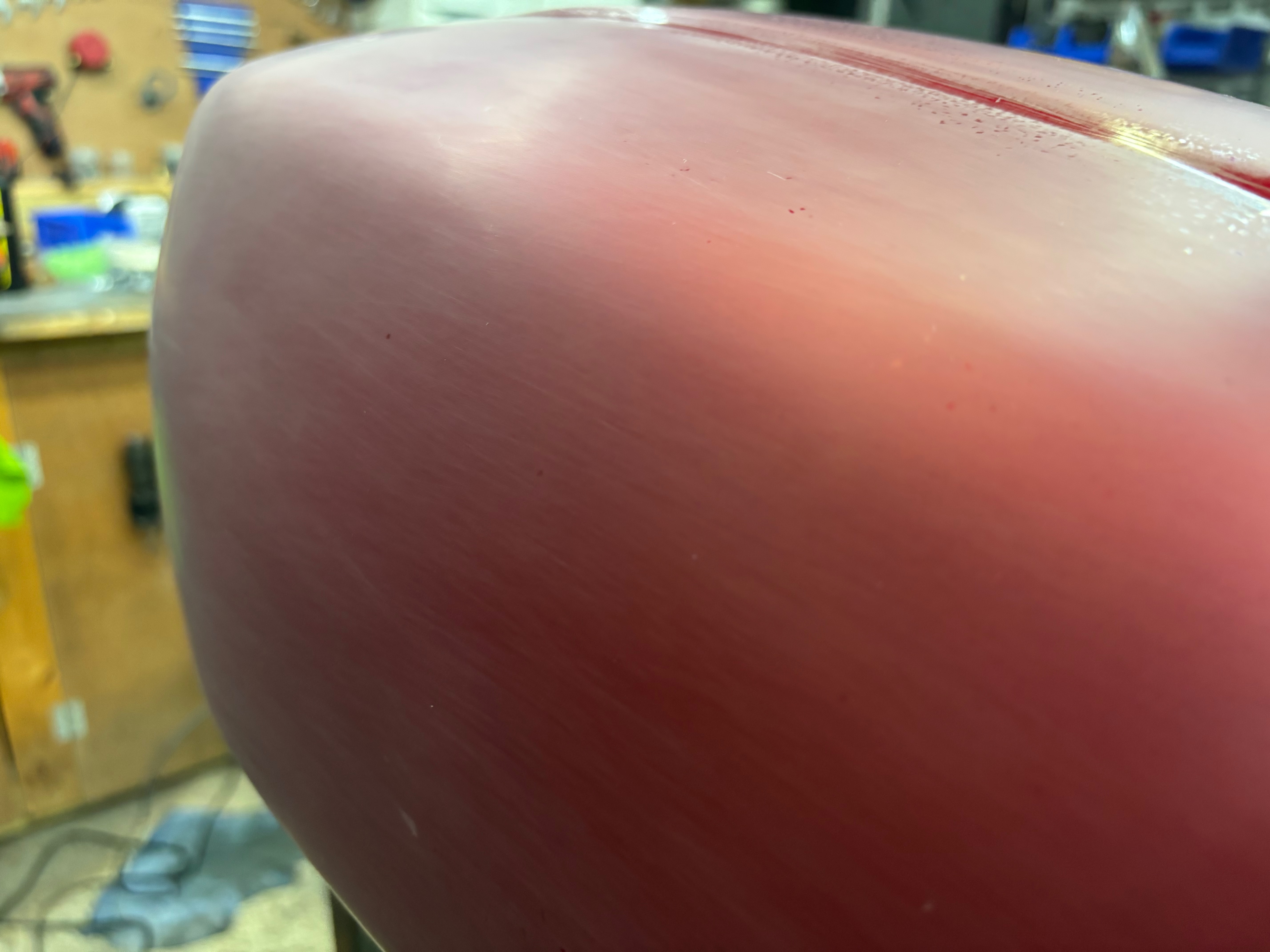

Sanded from 1000 to 1500 grit, then started on compounding.
By the way I have no idea what I'm doing. Just watched a lot of YouTube videos.

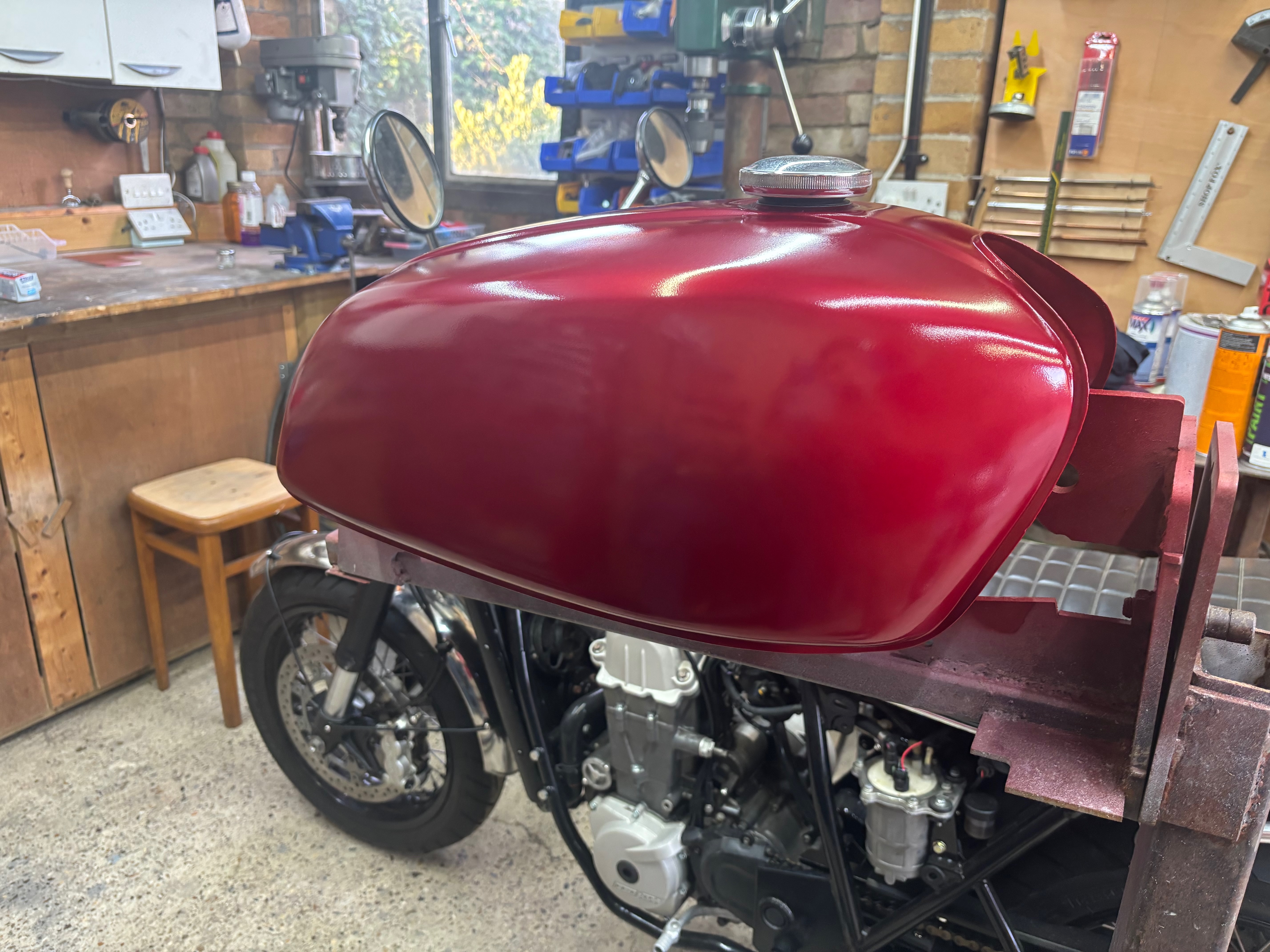

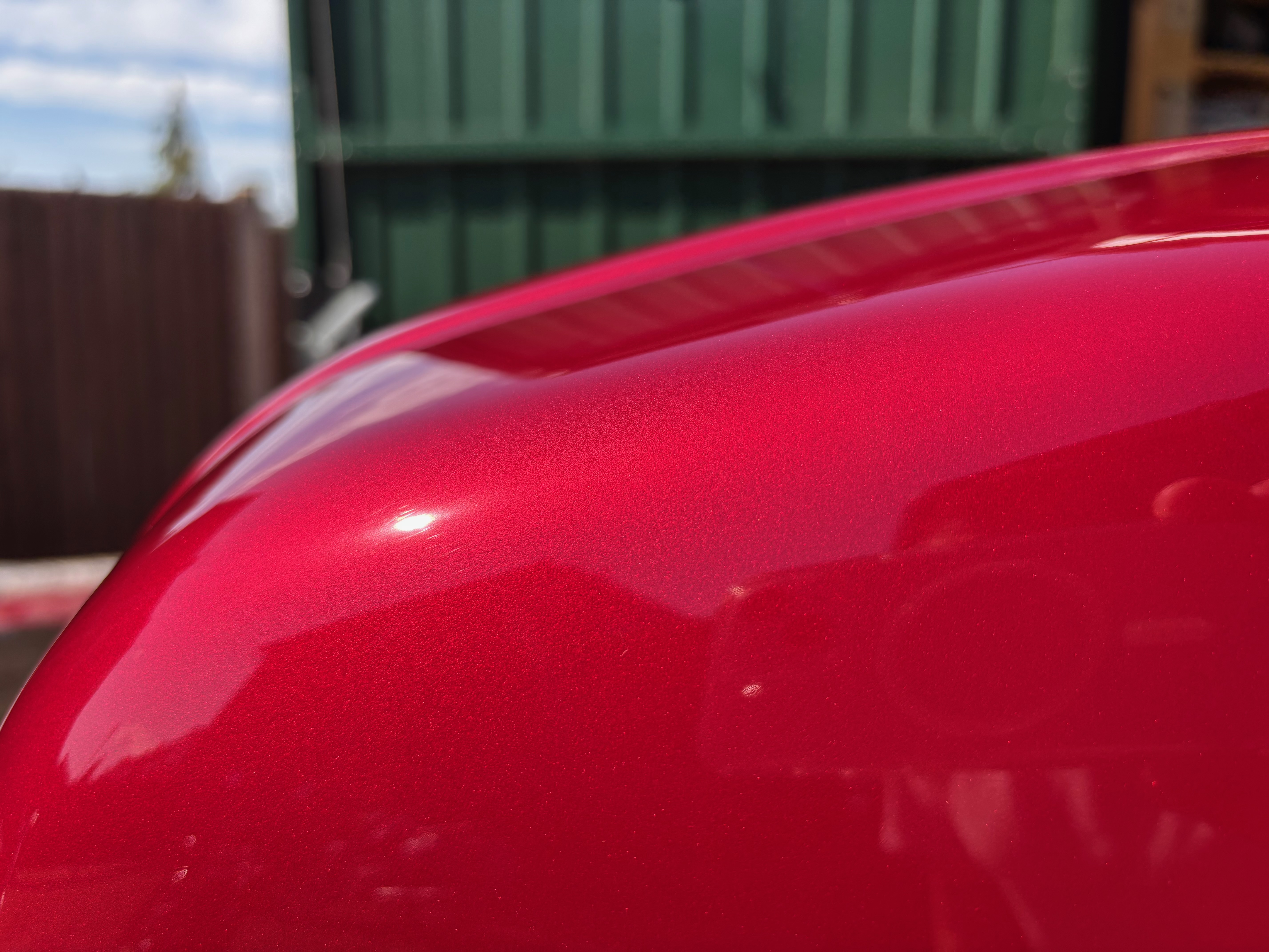

Ok, almost there. It's still not as glossy as before I sanded it, but it's getting there.

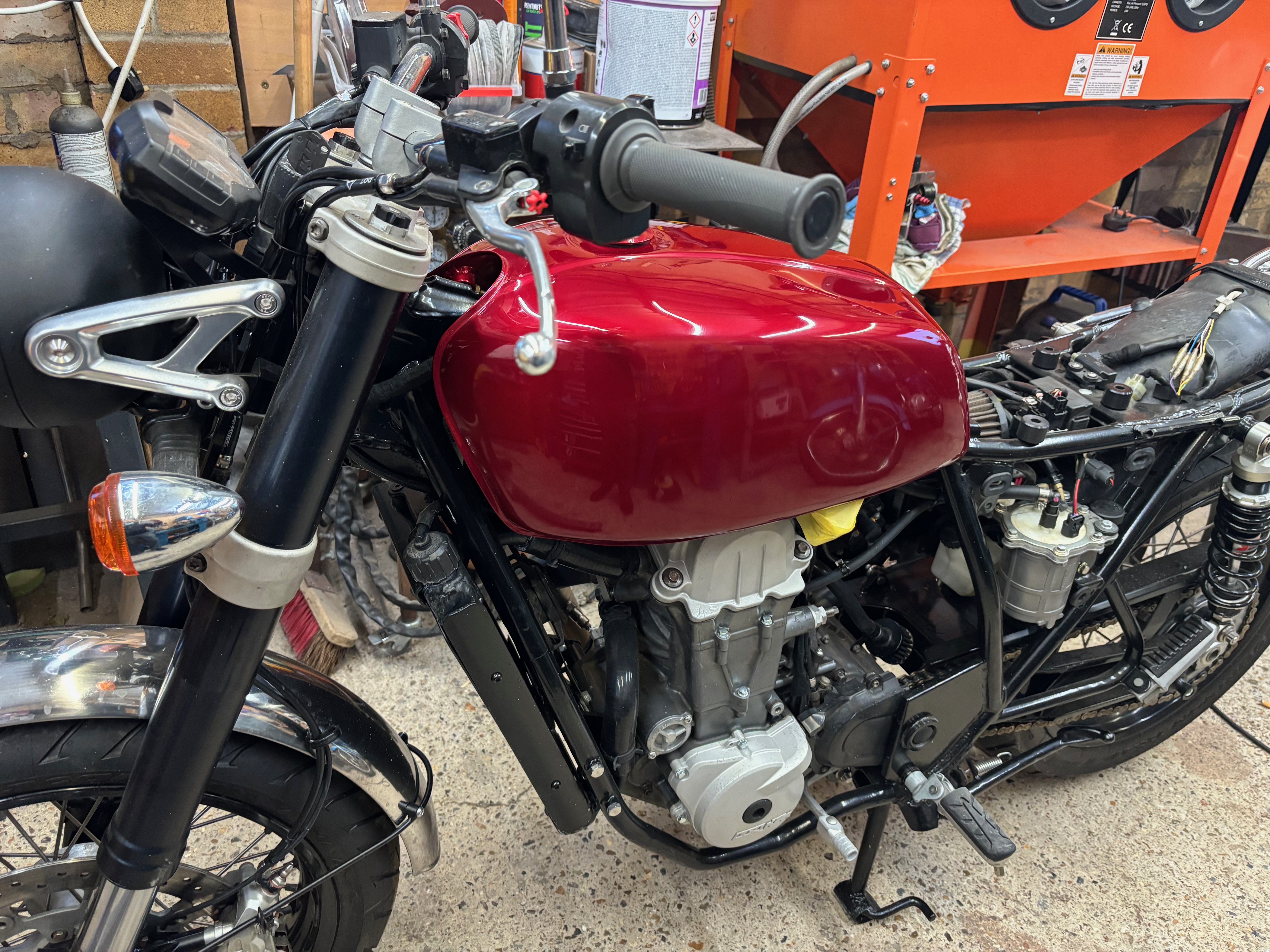

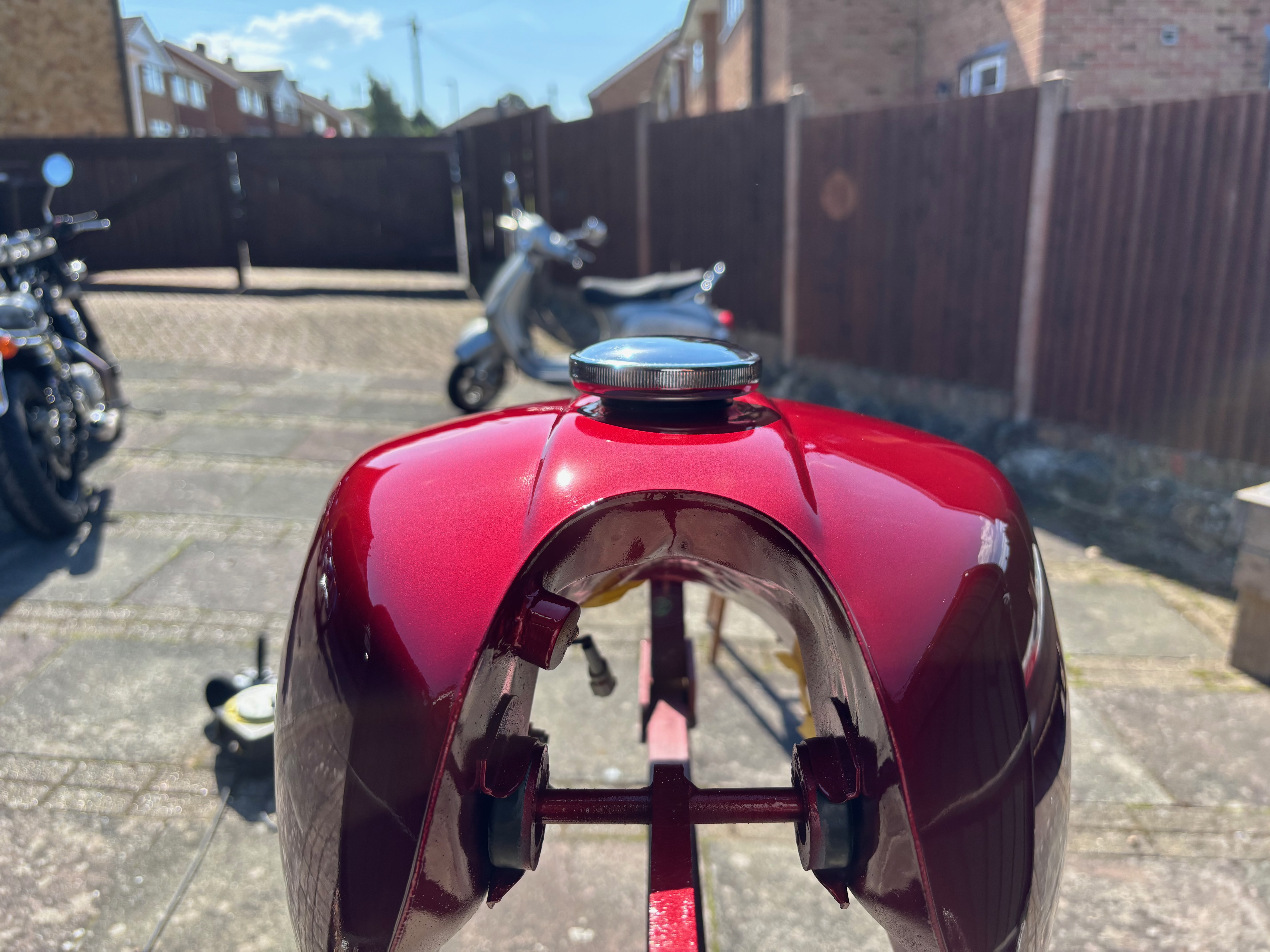

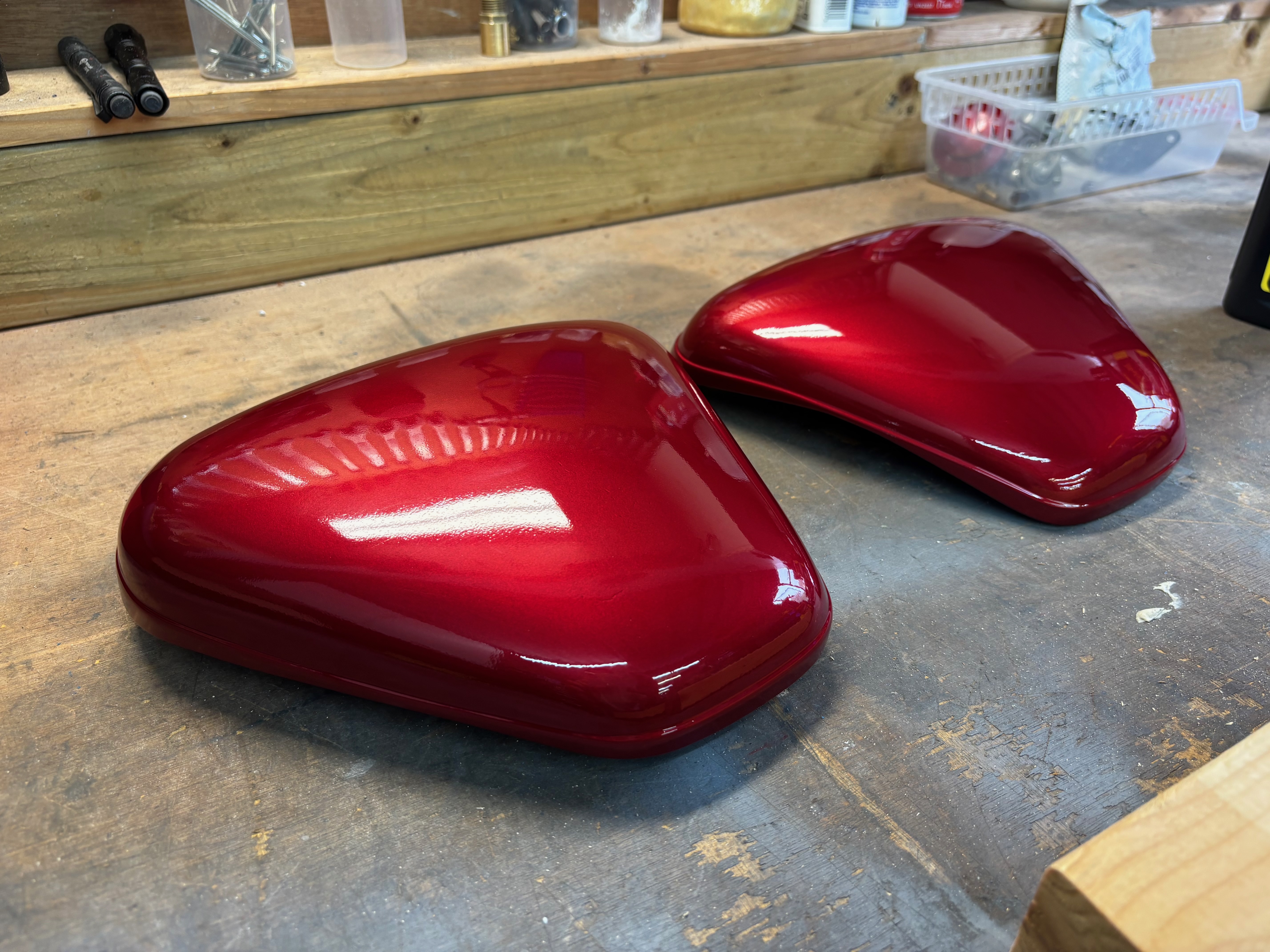

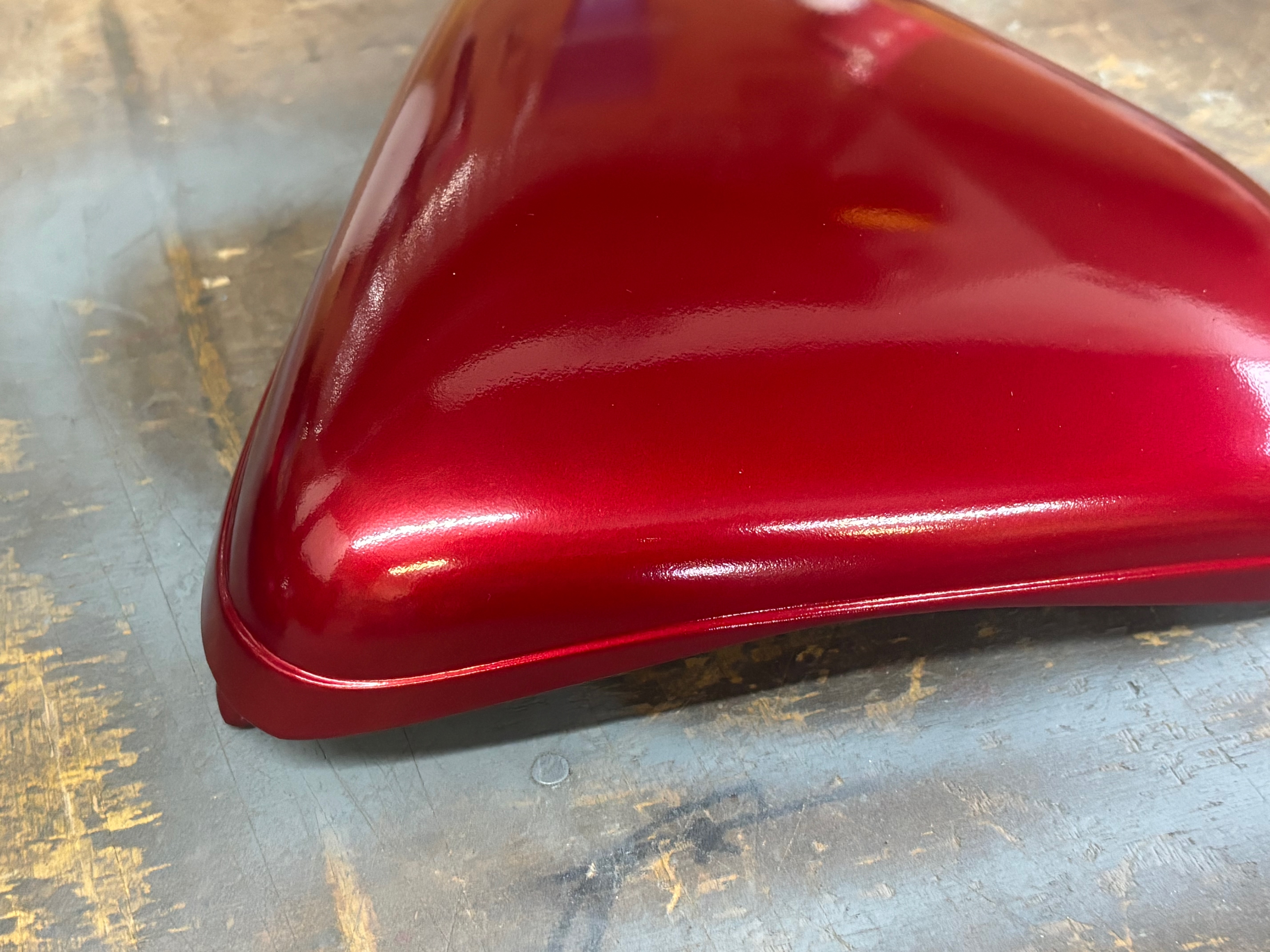

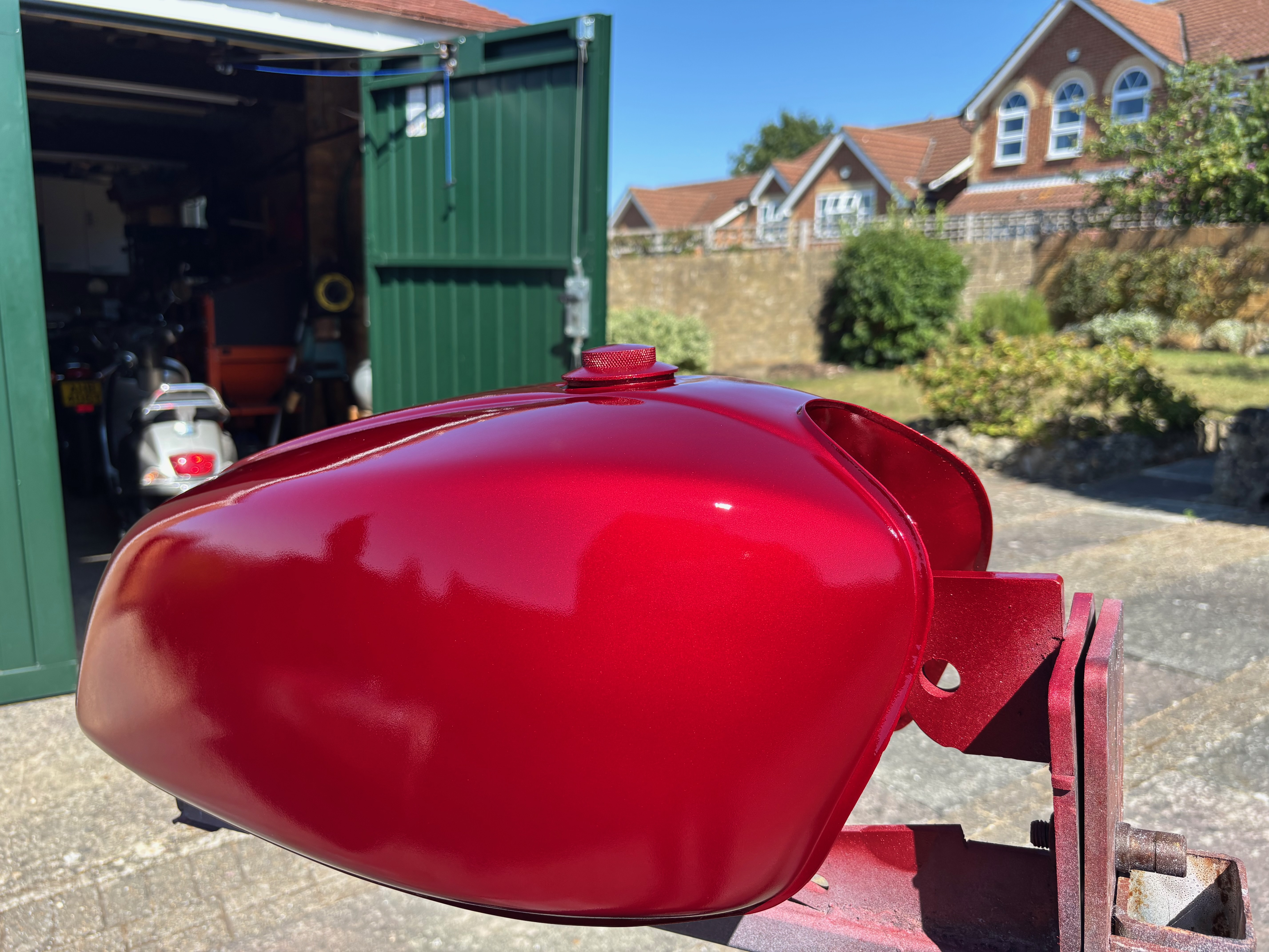

Tank and side covers finished, all compounded and buffed and waxed. The bits have been installed in the tank and it is ready to go back on the bike.

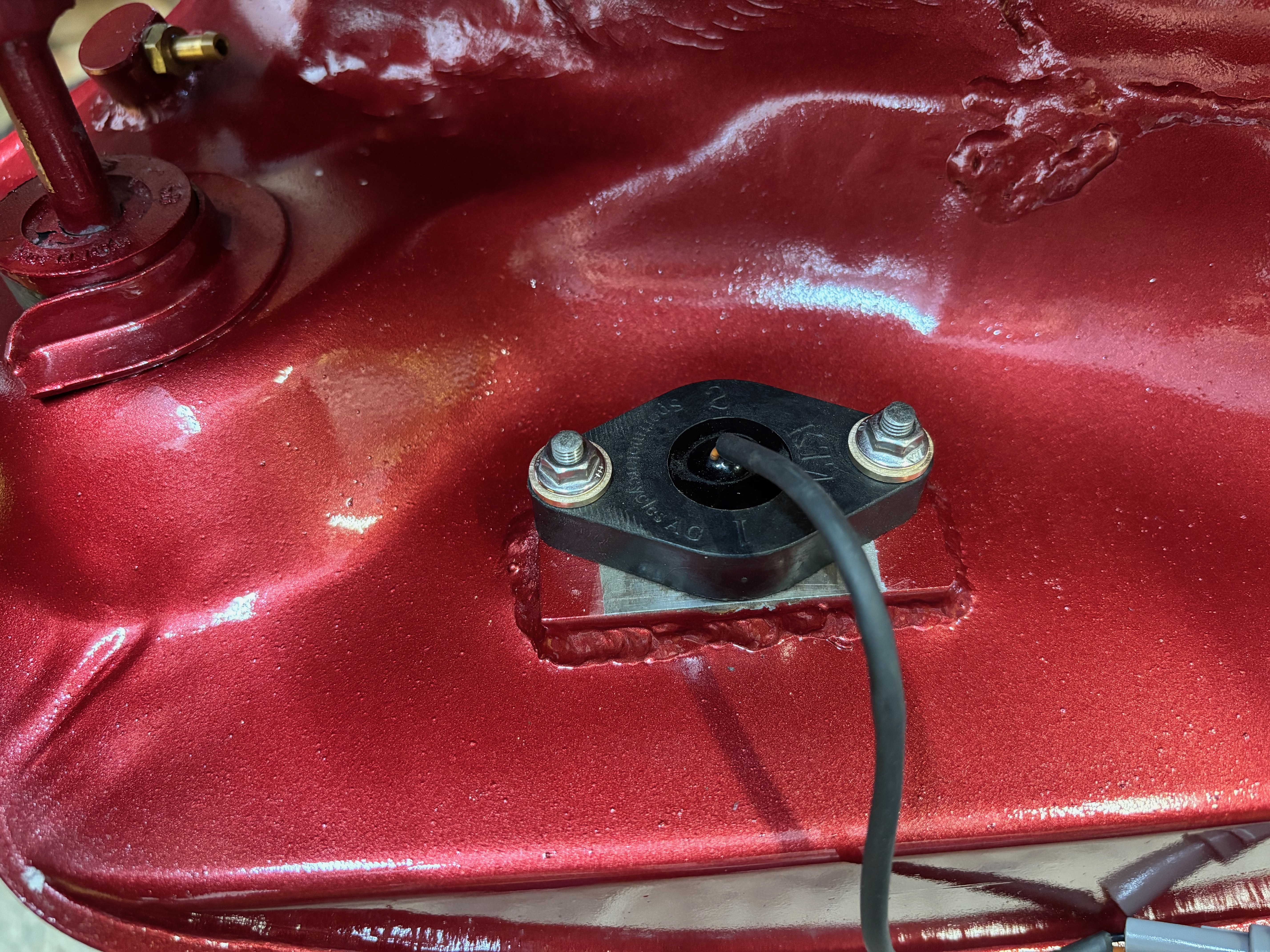

Not quite done yet, had to make some bushings to better support the fuel level sensor. I made some brass bushings on the lathe and installed them, they fit into recesses in the sensor body and spread the load out better. I'll put the sensor on with aerotight nuts when they arrive tomorrow.

First look at the tank and side covers actually on the bike. Very happy with how it's turned out. I do need to do some more compounding and buffing, but it's very very close.

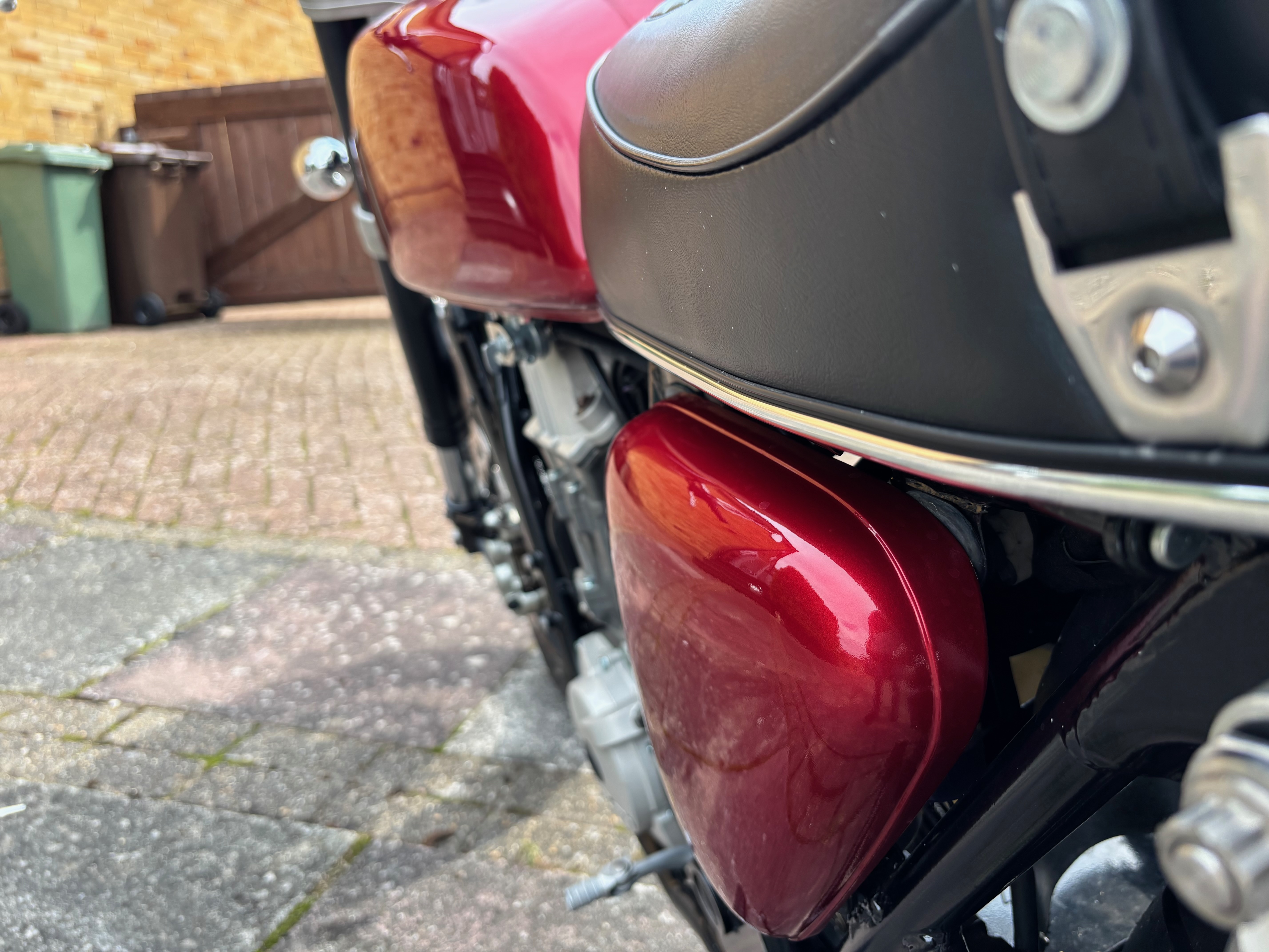

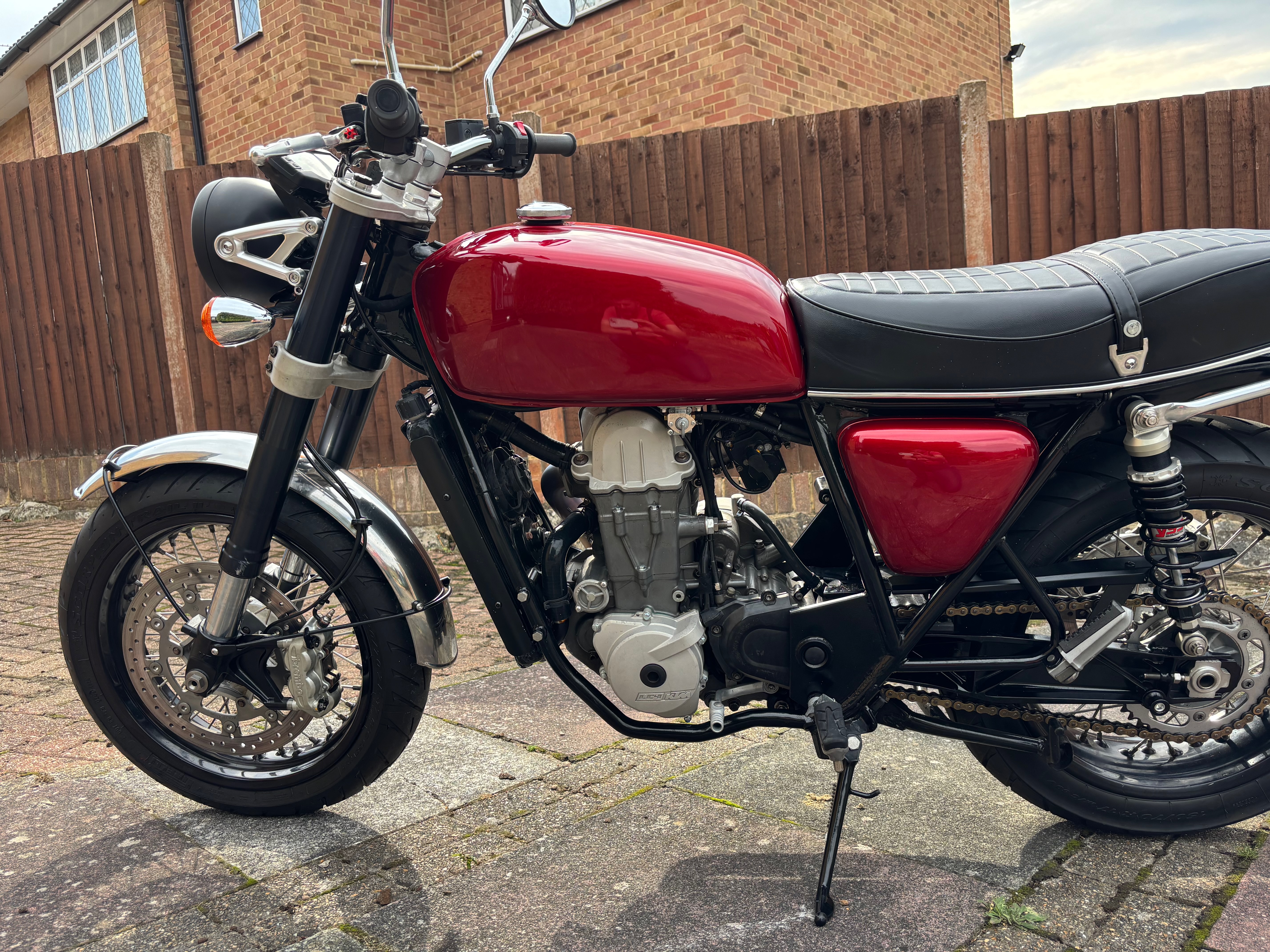

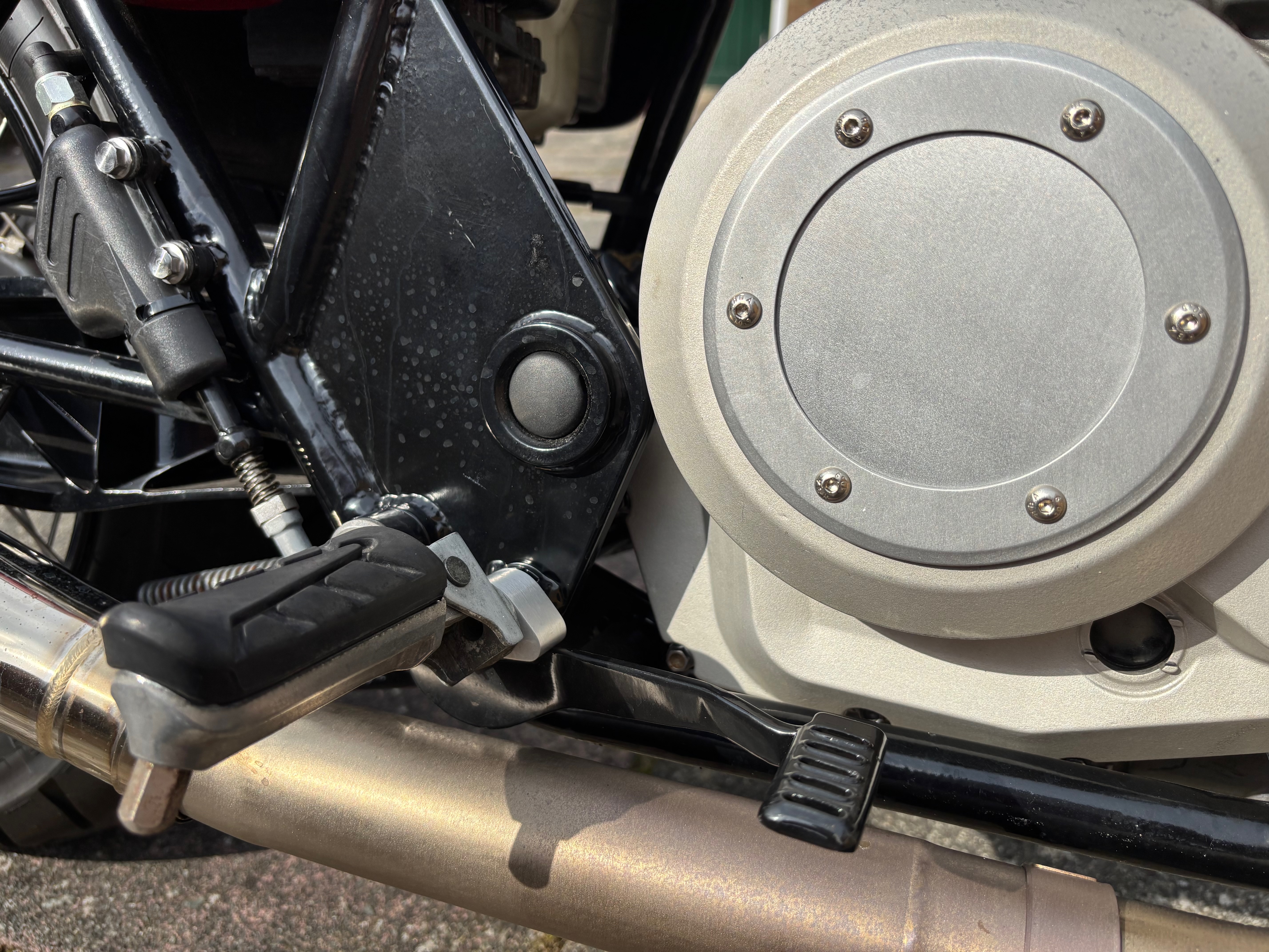

Compounded and buffed the paint again, and installed the tank and side covers.

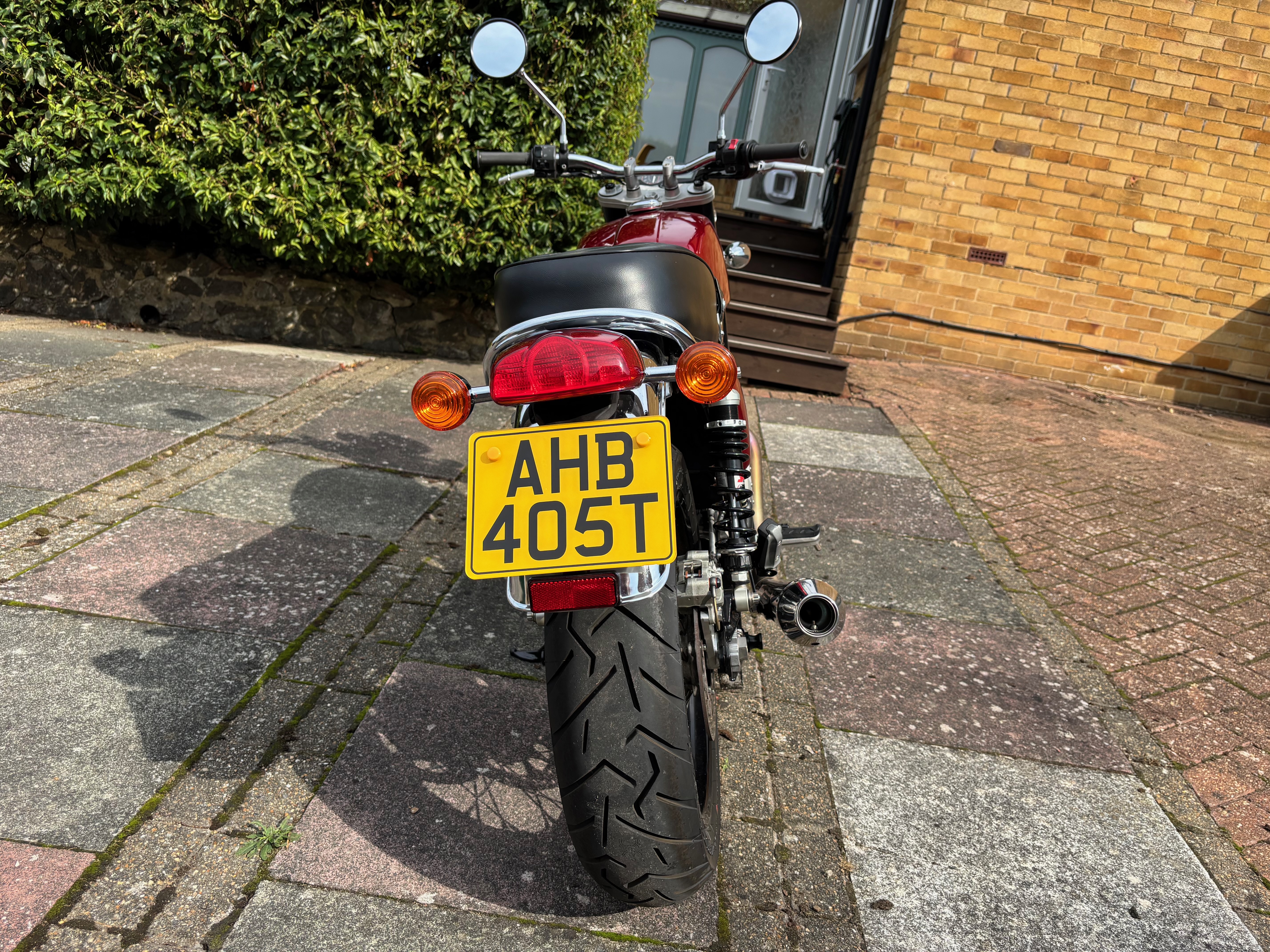

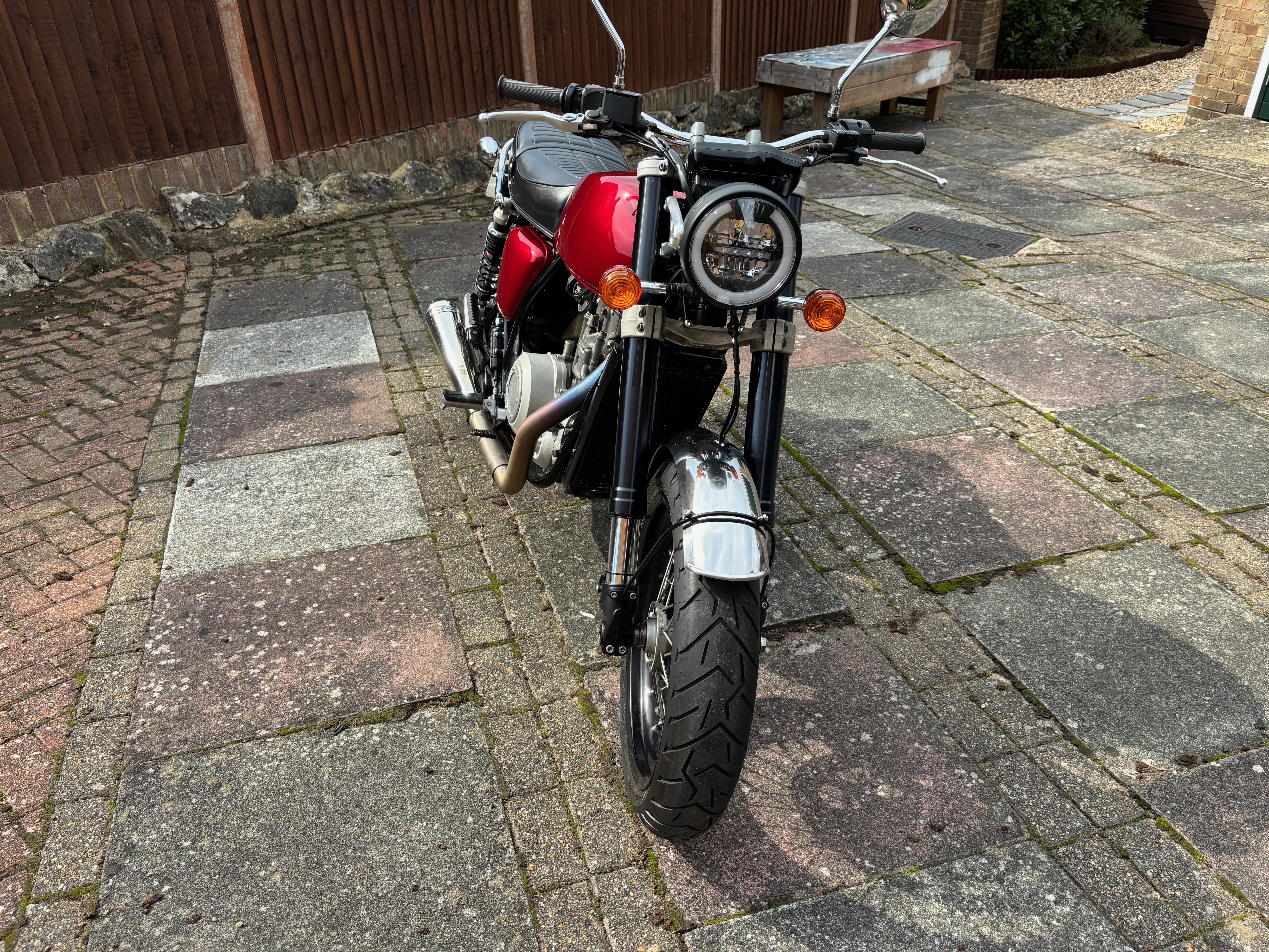

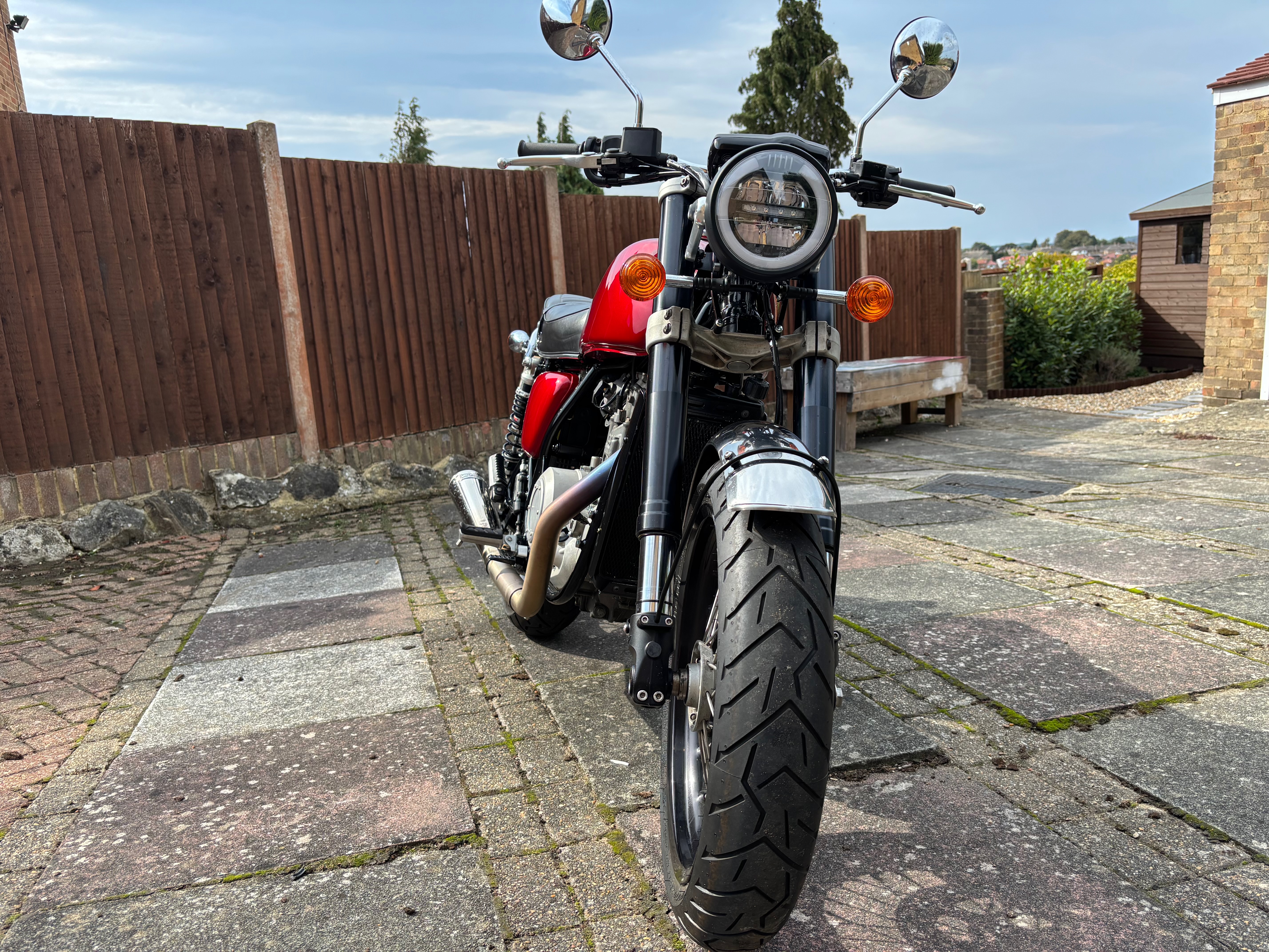

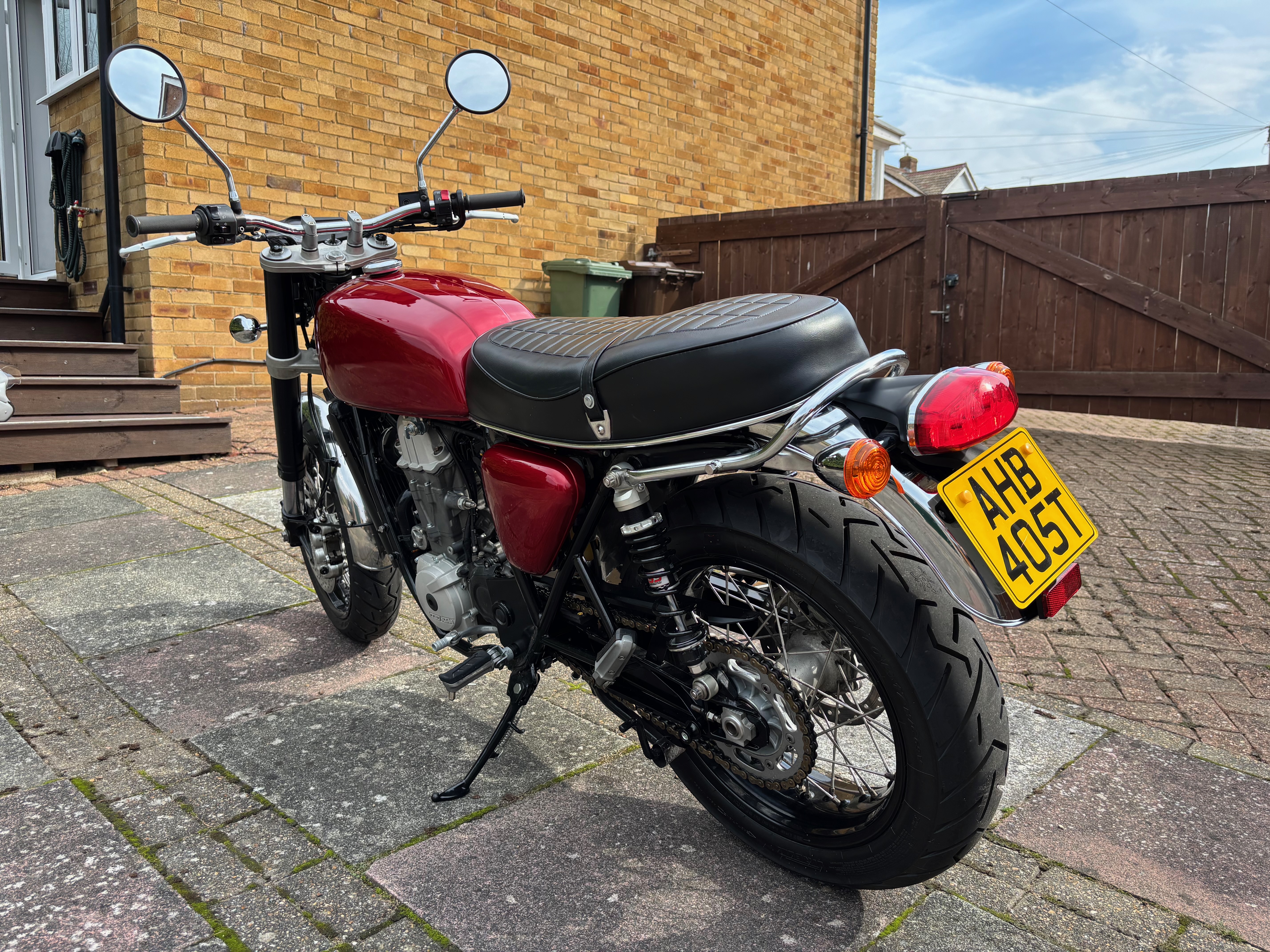

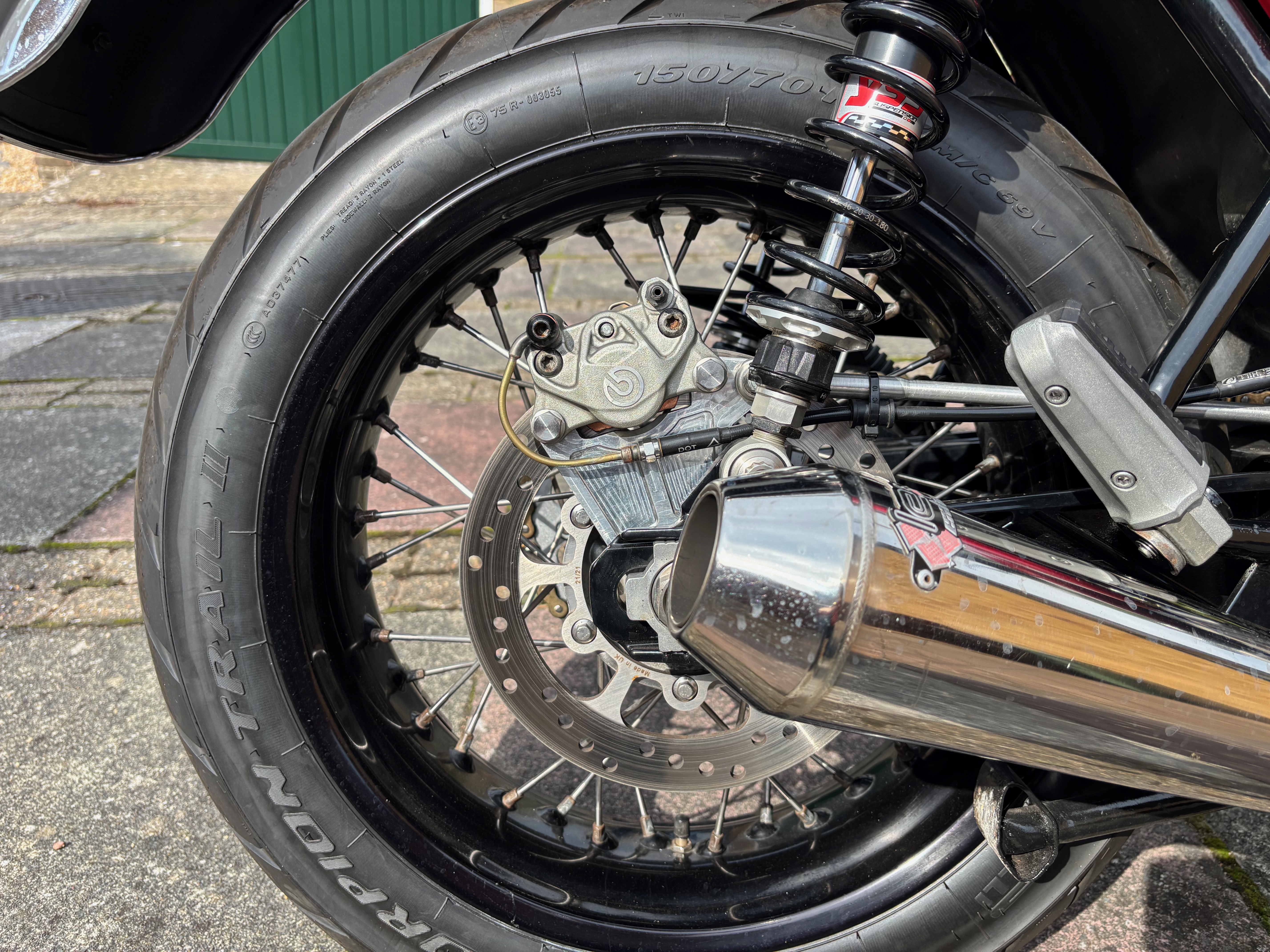

DONE.
Final fluids check, final adjustments, fuelled it up and checked for leaks, washed it (I wish I had not compounded the tank within reach of the bike, I got tons of compound specks in very hard to clean places) and set off for a test ride.
For one moment in time, the bike is finished. I will probably have to revise/repair/clean things in the near future, but for today, it is done. It has been 7 years.

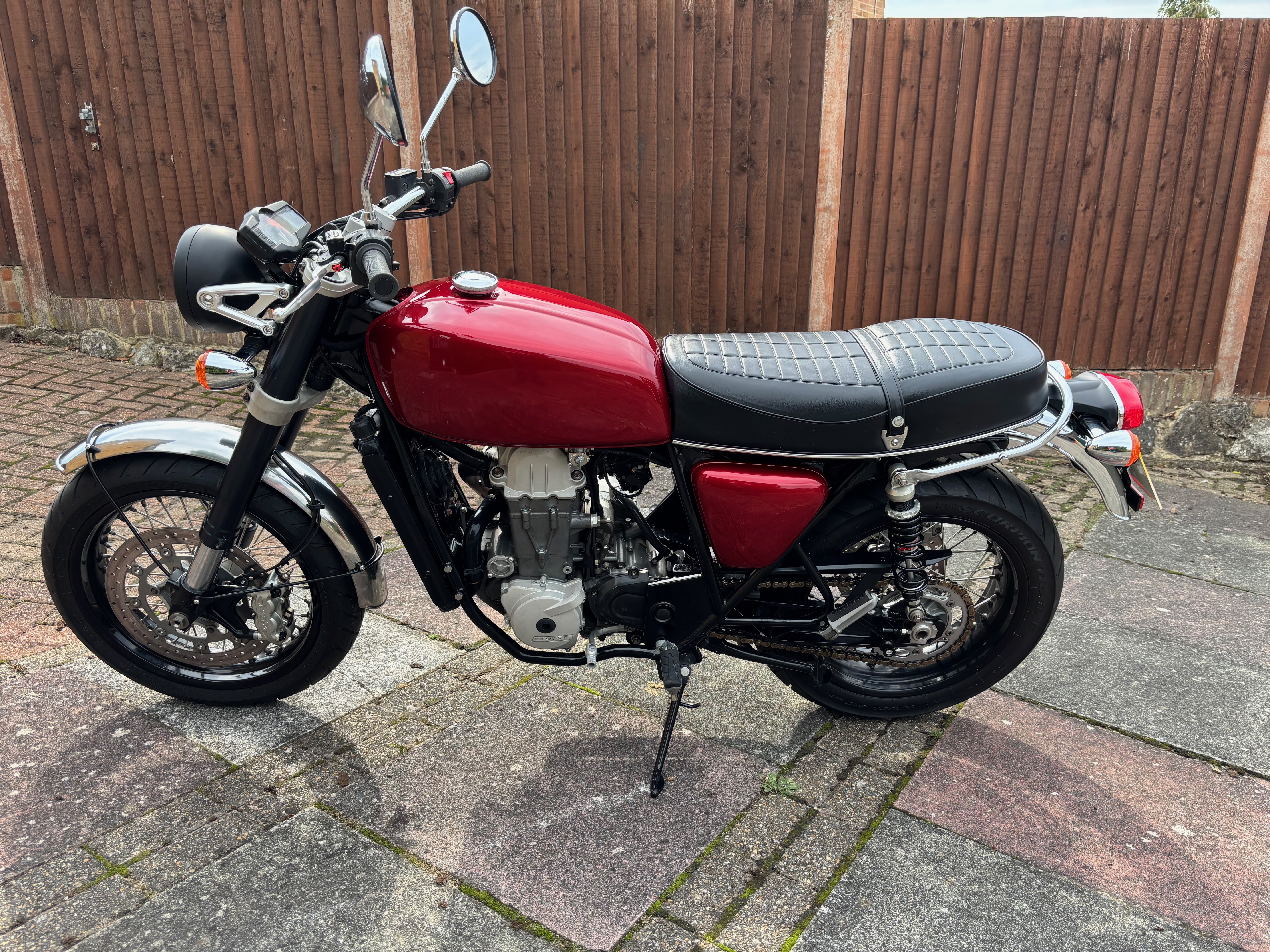

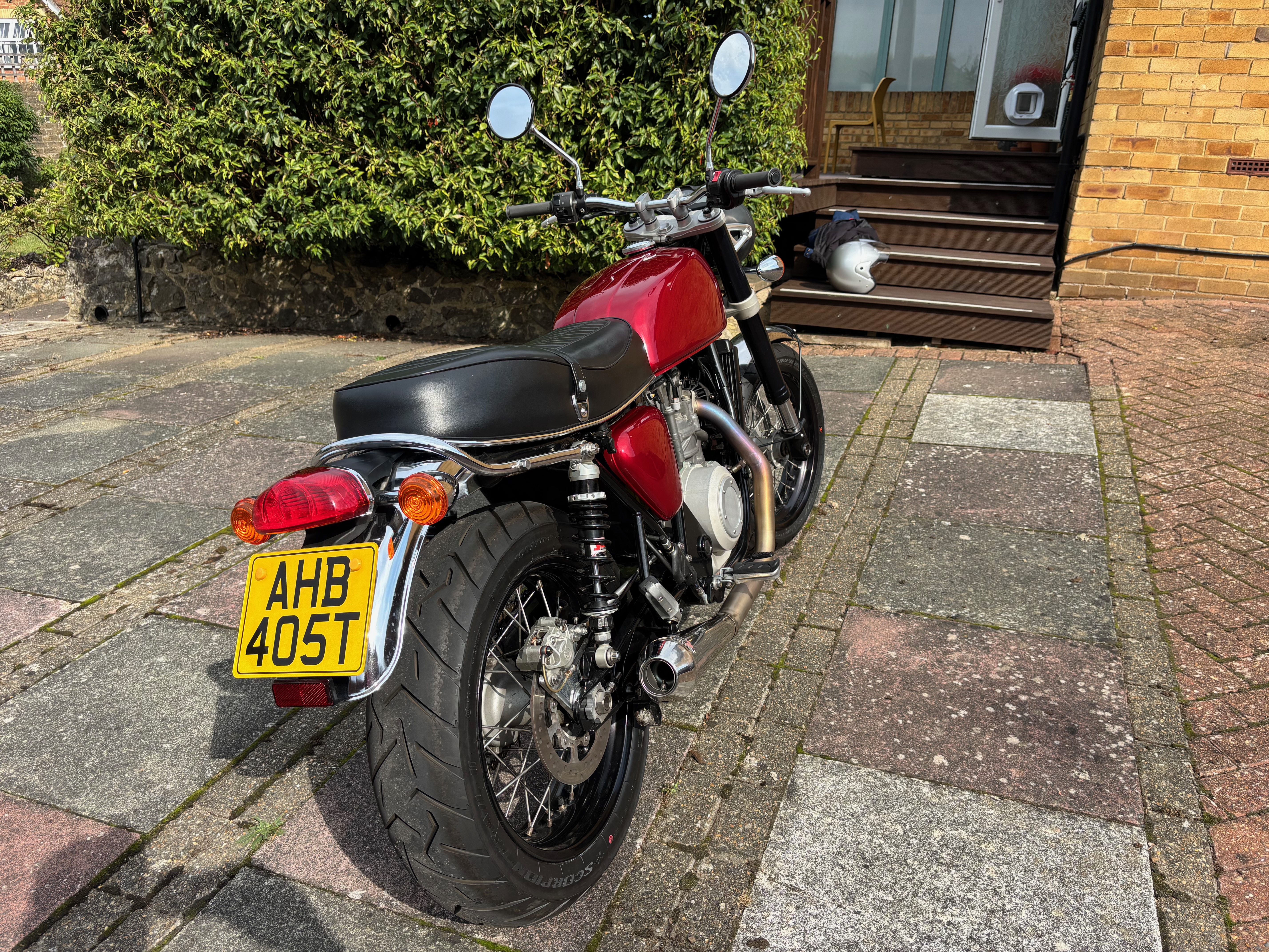

All done!
