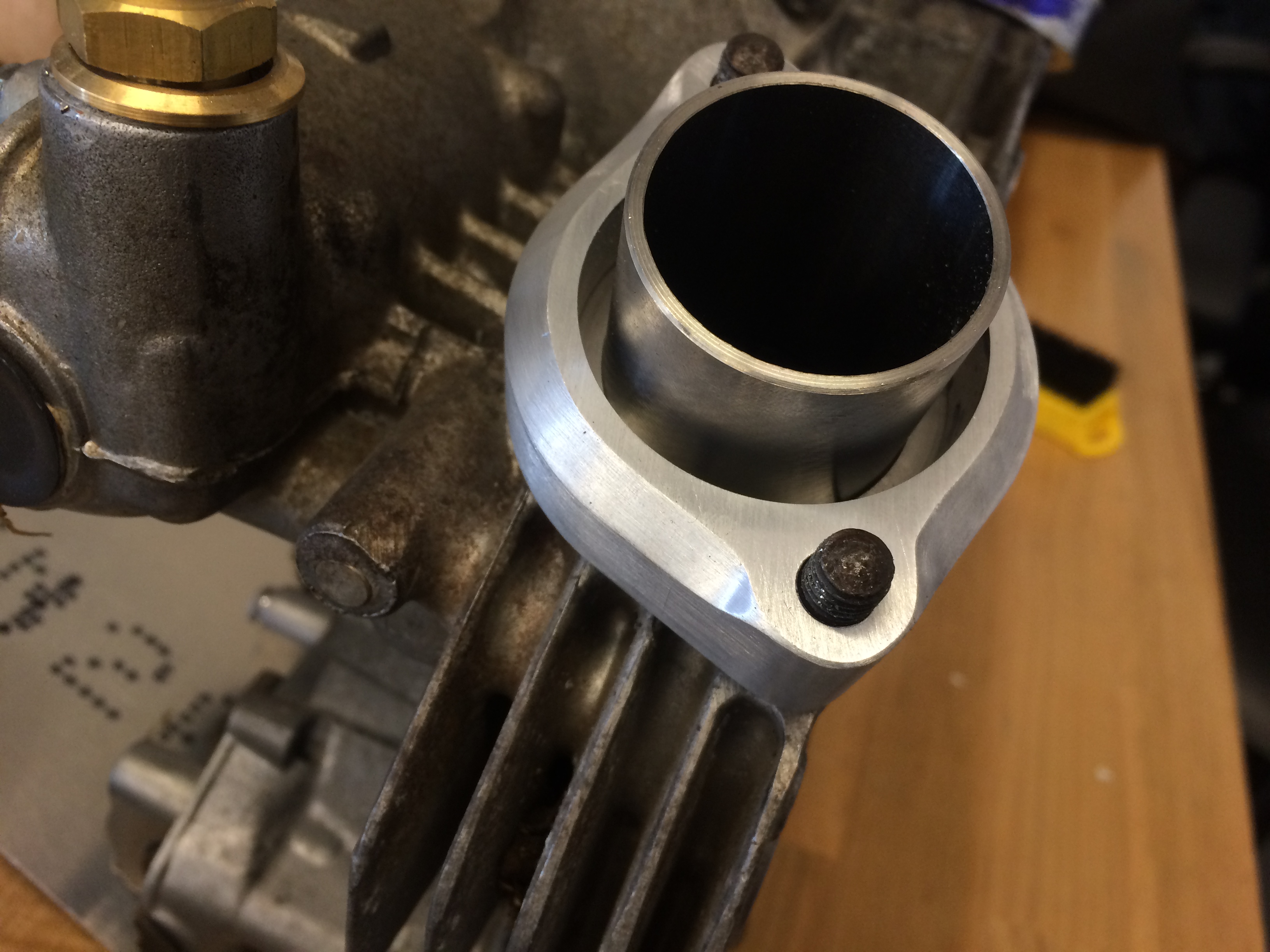

Got a start on the exhaust collars.
JadusMotorcycleParts said:
Man, cant believe you machined those exhaust flanges from billet stainless. That shows extreme patience and dedication! They look wicked.
You can't believe it because its actually aluminum. I might be stupid, but not crazy enough to do this in stainless.

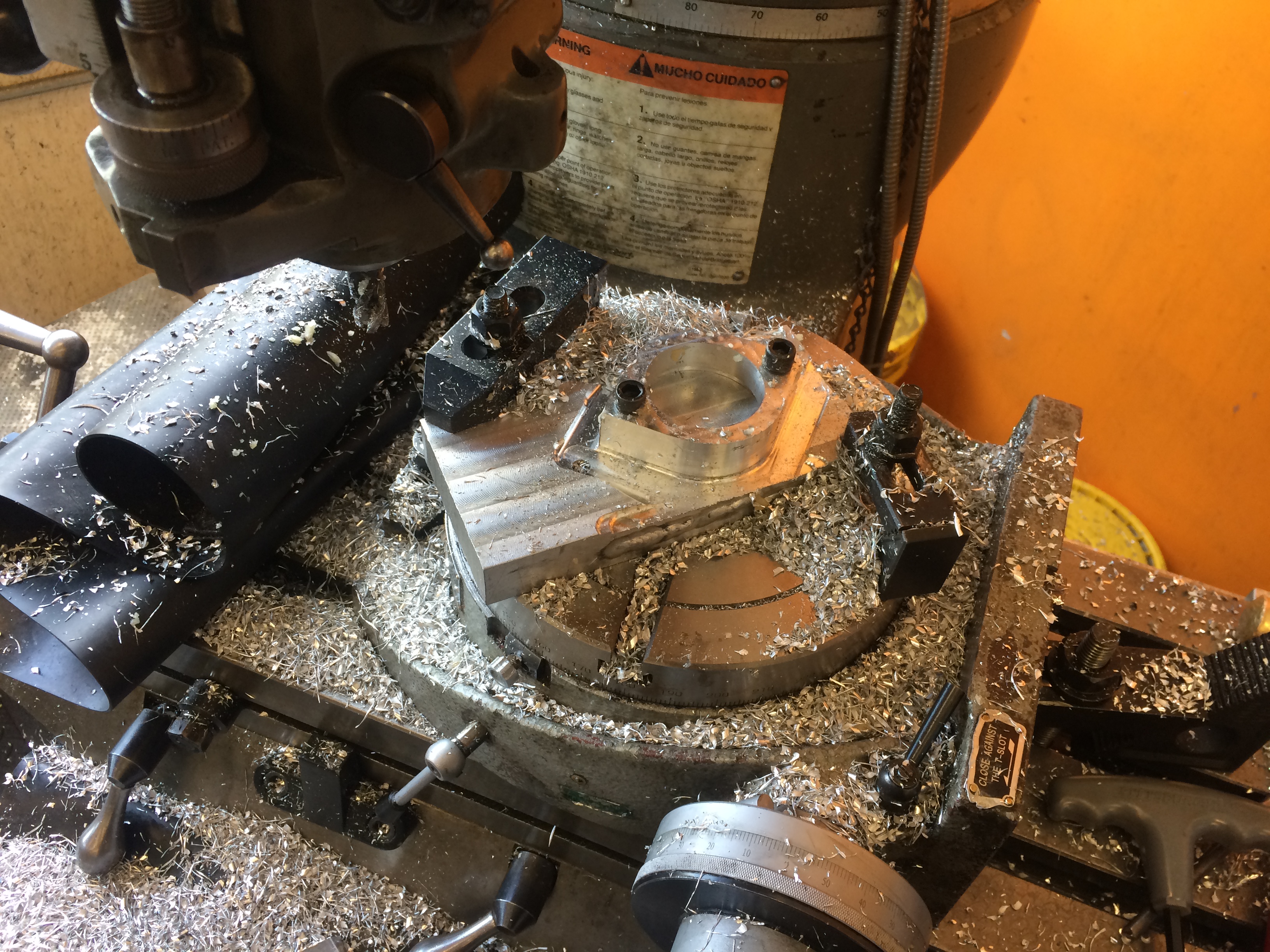

Exhaust flanges are nearly done. Had some fun on the rotary vise, also thinned them a bit and sank the retaining ring a bit deeper. No chamfer mills so I chamfered them with files. They still need a bit of polishing.

thanks fellas. this is just a junk head to test fitment, I'm planning on using some stainless cap screws :D
