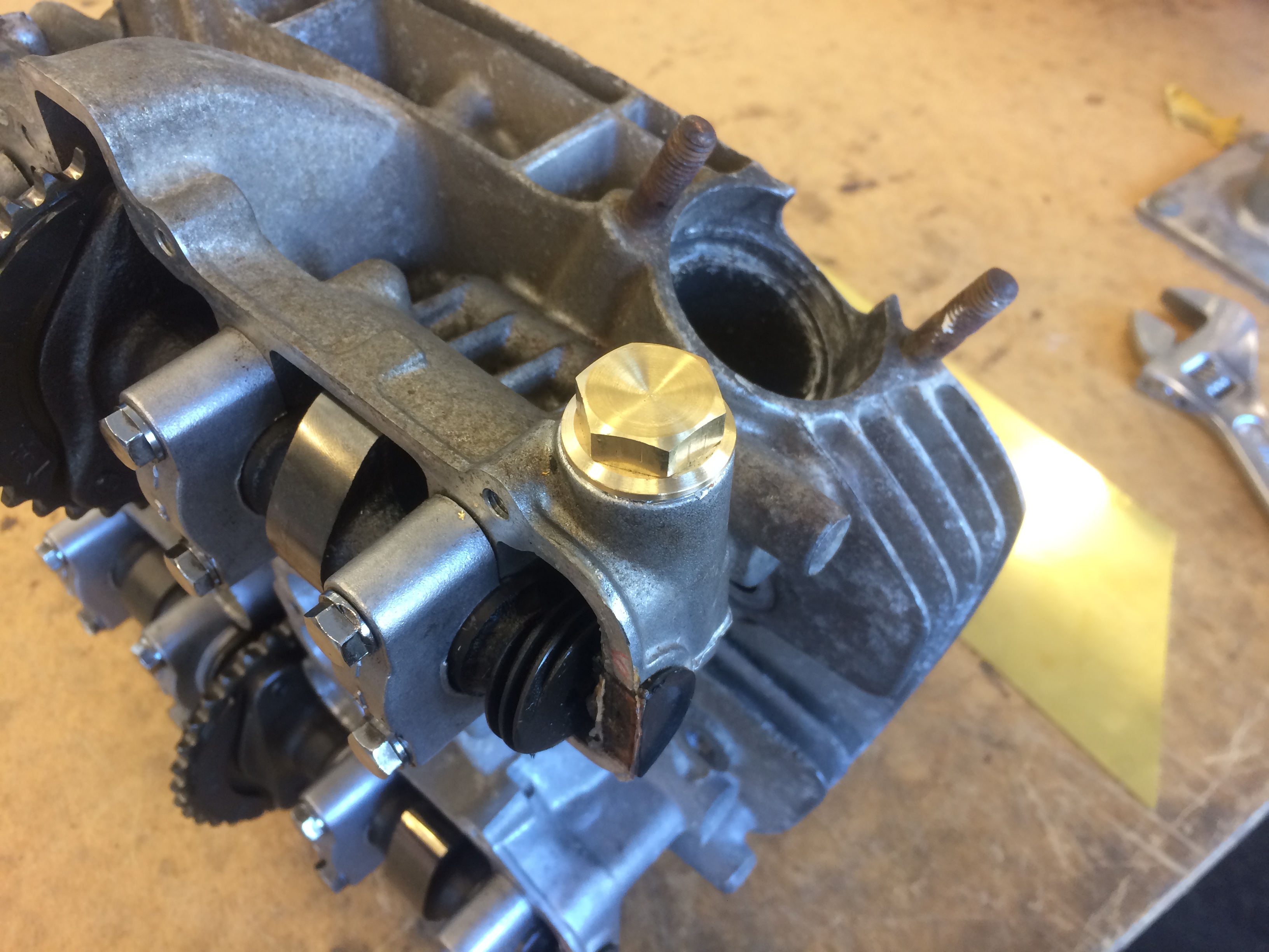

I ground the tool for the buttress thread and went for it. I remeasured the threads and it was 10 tpi. The threads didn't come out perfect but they very snugly grip the gauge so i'm calling it a success.

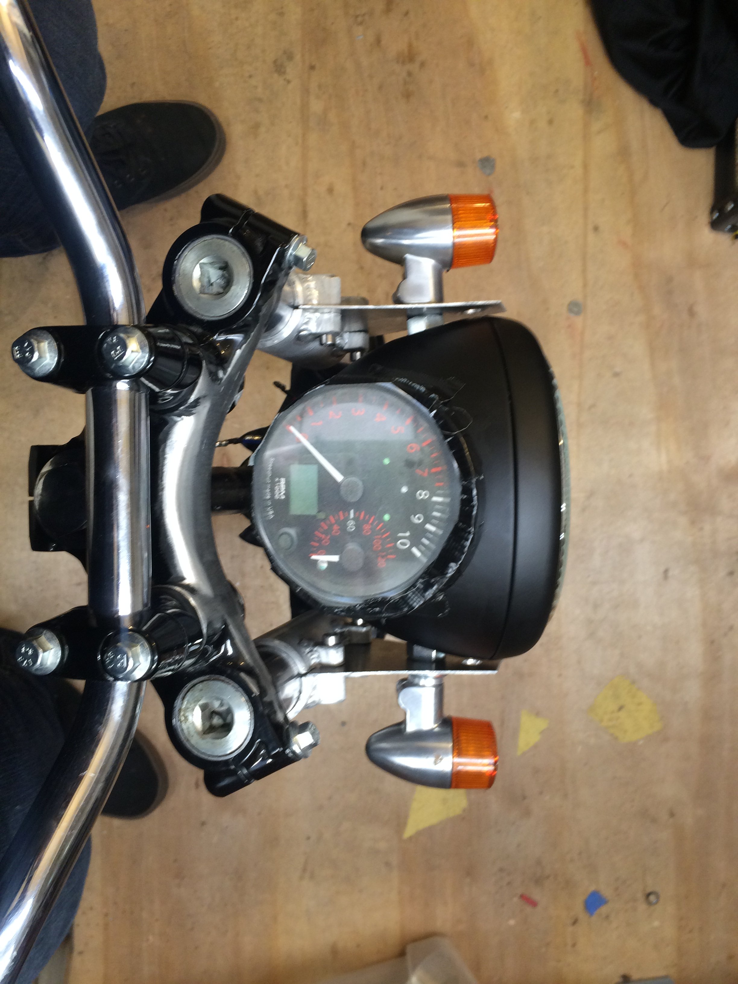

I have been doing some brainstorming on the solution for the oil light. I figured since the tach is integrated into headlight why not integrate the oil light into the inside of the left fork ear? it might look stupid once i mock it up, but i'm entertaining any possible idea right now.
If my memory serves me right, those fork legs had a rubber cap that fit the square insets, maybe mount the light in one and the neutral in the other with some real small ABS tubes for wires tight on the back side out of view?

Yeah I thought about the fork tube cap but the light is so big it would have to stick up pretty high and look weird.

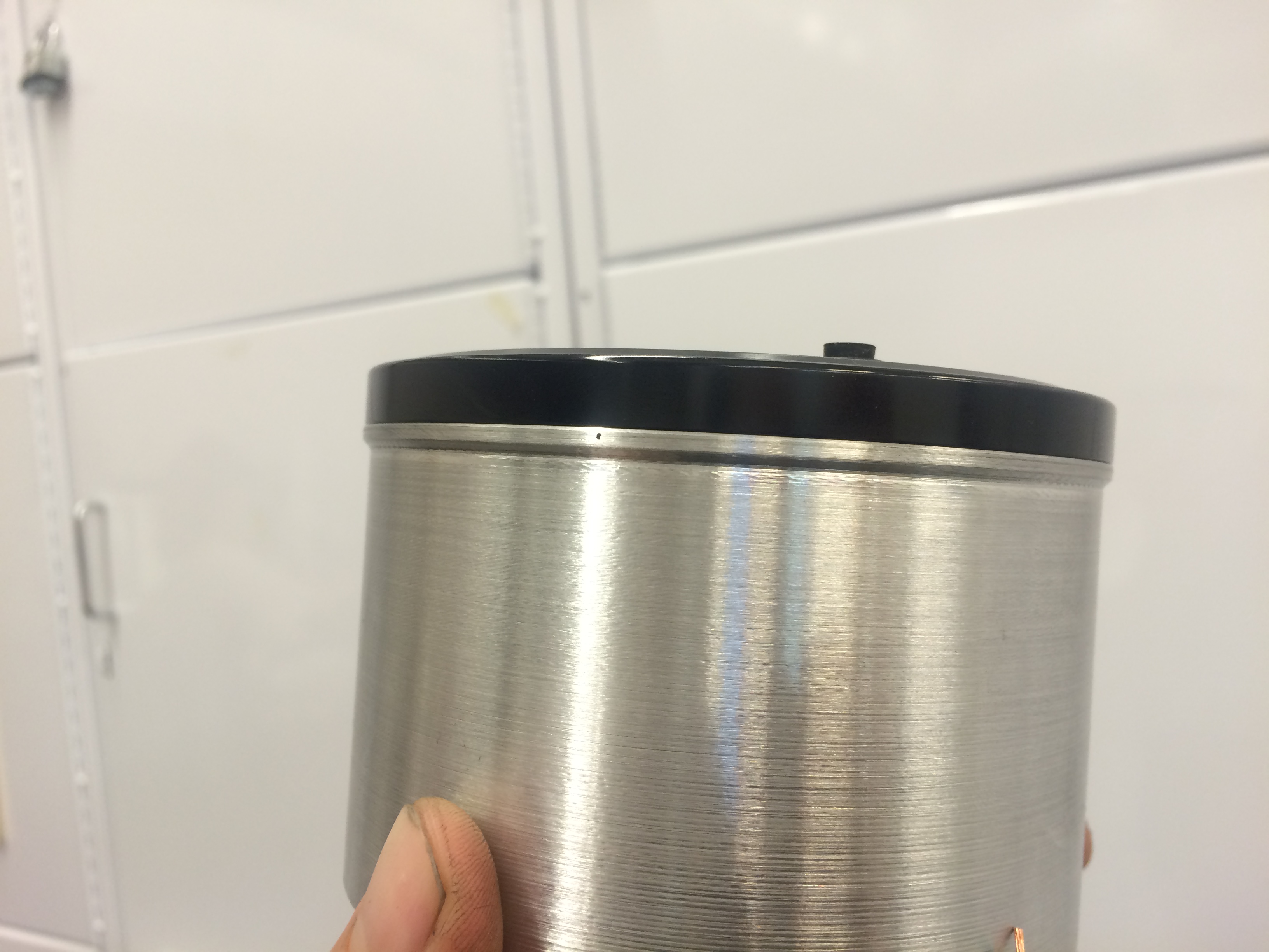

Had a little down time today so I re did the gauge housing. The threads are much nicer this time. You can see the one on the right has less chatter in the thread. I also added a little lip that I will leave polished with the rest painted. As much as I would like to use this headlight I think it is throwing the proportions off so in gonna look for one a little bigger, like a 6.25"

I picked up this 6.25" headlight. I think the proportions are much nicer now.

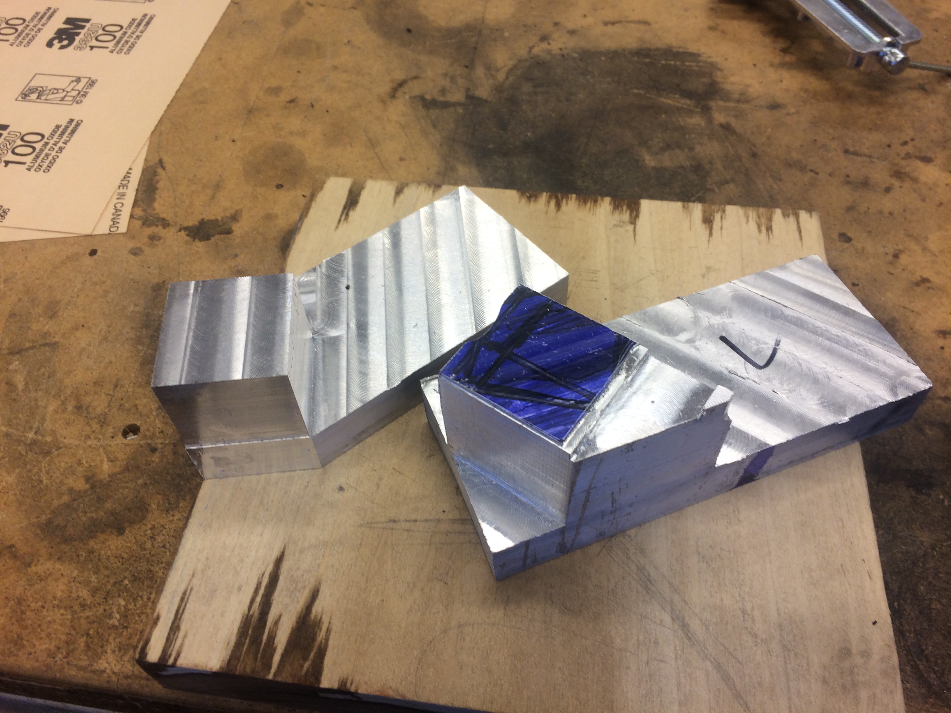

Got a start roughing out the footpeg brackets today

Got some more work in on the footpeg brackets. I screwed up and mis-calculated the chamfer on the folding boss and cut too deep. So I fired up the tig and put a dab on there and filed it back down. It looks ok. It's on the bottom so you won't see it when it's mounted. Still a ways to go. I have no real clue what I'm doing so the going is slow.

The school/work combo has been kicking my ass and I haven't gotten any time in on the projects. I needed an easy win so I did sneak a little time on the lathe and made the tach plug.

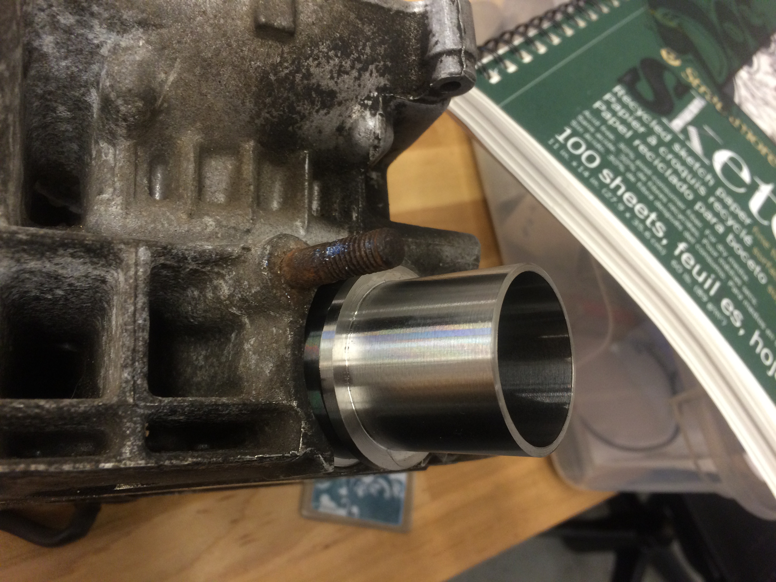

Finally got a start on the stainless header. Exhaust flanges next

Id have to try harder at sourcing some appropriate tube for that. I couldn't find any stainless tube that met the ID and OD requirements so I turned these out of a solid chunk of 2" 304. It took FOREVER.
And likely why they don't exist in our world, no cost effective materials. I want four when you find it for KZ1000
