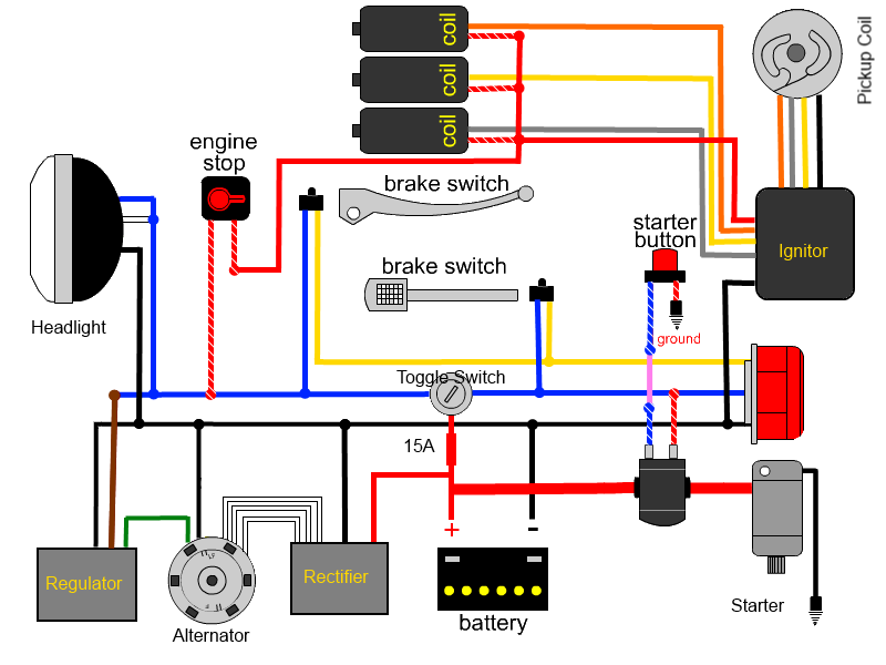

Can somebody please do a quick check of this simplified wiring diagram for me? It's basically stock CB/CL 350 with a PAMCO instead of the points, a Kohler Regulator/Rectifier, simplified switches, and no dash lights. Everything looks okay to me but I went a little crazy in Photoshop erasing wires and want to make sure that I didn't take out a connection that is needed.

Sonreir said:
Barebones diagram for the Honda twins and singles. Only enough to get the bike running and keep it that way. No lights, signals, or gauges included. Though not pictured, I recommend a 5A fuse on the black wire leading to the coils.
If you're running a total loss setup you wouldn't need the regulator/rectifier "branch" would you?
Correct. Just power straight from the battery to the coils (usually with a switch in between).
That is so easy it just didn't seem right. Thanks for the info.
Kevin
Kevin
That assumes you're using points, however. Gets trickier with some of the electronic ignition systems.

Thanks for these fellas...great info here. I'm want to wire up my GS650 from scratch. Any major changes for the 4-cylinder from something really simple, like Sonrier's first example?
In the first example I don't include much wiring for the ignition system and that would be a concern (especially if your ignition is electronic). Also take a look at the alternator and charging system as those will almost definitely be different.
