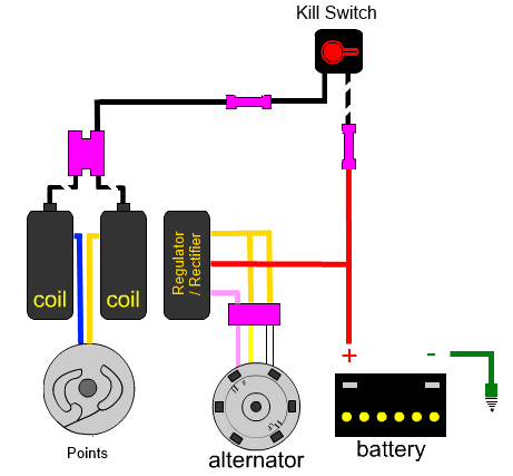

Barebones diagram for the Honda twins and singles. Only enough to get the bike running and keep it that way. No lights, signals, or gauges included. Though not pictured, I recommend a 5A fuse on the black wire leading to the coils.
I PM'd you, but I think this will give me what I need. Just wanted to double check though... chassis ground to the body of the coil mount is really the only thing not shown, correct? And I can just leave the entire R/R section out for a total loss circuit, correct? The electric start wiring is easy enough.
Correct on most counts. The coils don't (strictly) need to be grounded though.
ok, one other question... I don't think the 360 are waste spark, so it should matter which cylinder the plug wires go to from the coil. Probably a dumb question, but is it blue/left, yellow/right (as seated on the bike) or vice versa?

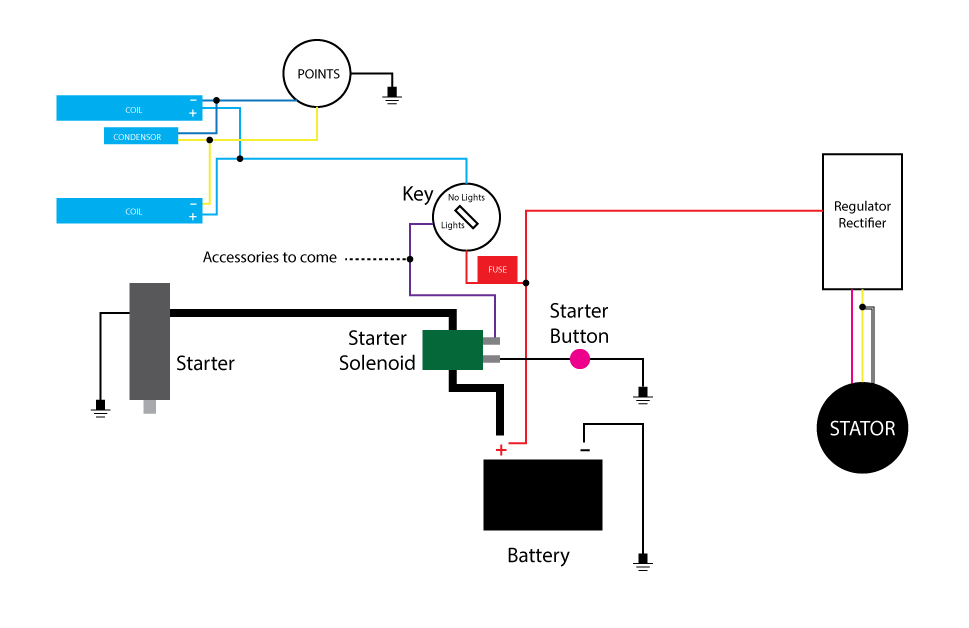

sounds good. So does this seem reasonable for a total loss system that includes a starter (this will be on my starting stand).

No idea if I'm even close on this but I figured I would get some direction.
Its for a CB360 with a starter (The wiring going to the solenoid is whats making me scratch my head). I figured I would ask if this is right, before I add anything else.

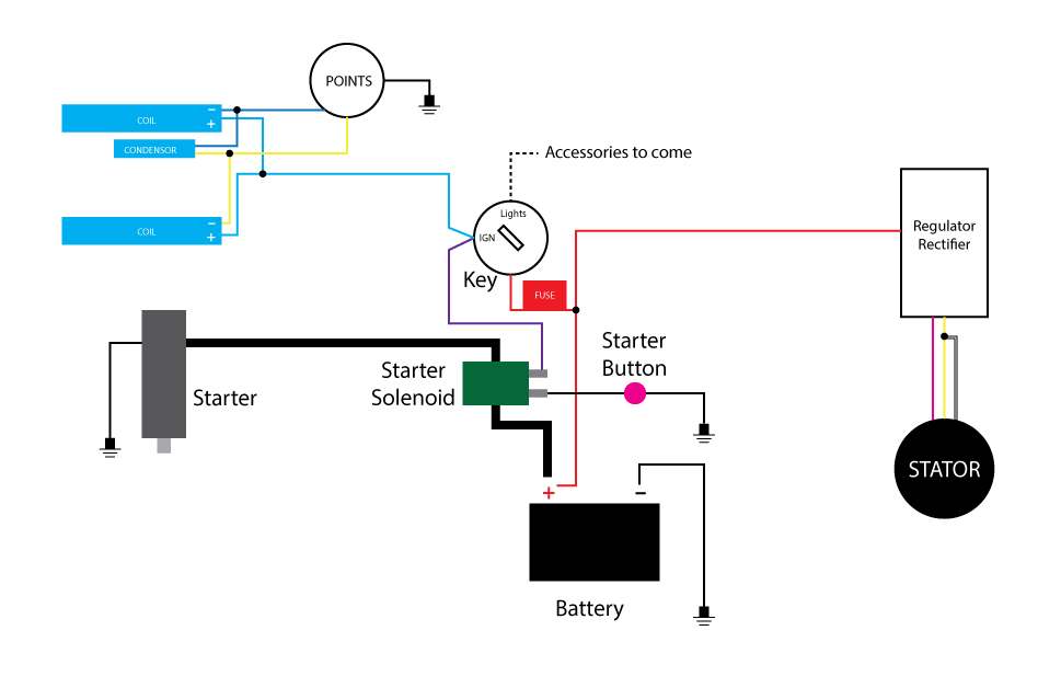

If you're running without a kill switch, power going to the coils and power going to the solenoid should come from the same source.
Updated, I hope this is what you meant. Thanks for the help!

Hey Sonrier,
I've made a first attempt based on a combination of the two wiring diagrams. I hope this makes sense. Left out the obvious ones.

Red/white coming off of the ignition switch is only for the solenoid. All other power sources should be fed from Acc or Ign poles. Acc is the first and second "clicks" on the ignition and the Ign is the second click only. So Acc would be stuff like parking lights and Ign would be for ignition coils, head light, etc.

Two questions if you could help me out.
On the ignition switch(Standard Square plug) there are 4 wires, Red, Black, Brown and Brown/White. I'm know red is power and I'm assuming black is ground, what I'm not sure is which colour after that corresponds to Ignition and Accessories.
Second question, on the solenoid (New ebay one), theres two screw posts and then two wires that come out, Red/Yellow and Green/Red. Again I'm assuming that one of the screw posts connects to the battery and the other to the starter. Then the Red/Yellow connects to the starter button and the Green/Red connects to the ignition switch (Which ever colour corresponds to ignition on the ignition switch) Does this sound right?

Sort of.
Red from ignition switch to battery +, black from ignition switch is your power. This goes to the green/red wire on your solenoid as well as off to the ignition coils, lights, etc. Yellow/red on the solenoid goes to your starter button and then button then completes the circuit to ground.
Brown and brown/white not needed unless you want parking lights.
