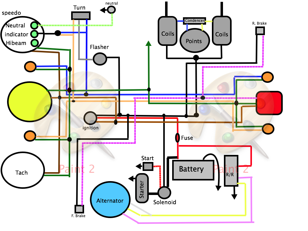

you guys mind picking my wire digram apart. I just completed it...????

High beam indicator needs a feed from the high beam, too. Start button doesn't usually need a ground as it's grounded through the bars. There shouldn't be a brown wire for the headlight, either. Brown wire is for parking lights, so if you put a brown wire on the headlight, you'll drain the battery if you switch the key to park. Headlight needs a black wire or to be fed from the handlebar switch. I'm pretty sure the SL350 K0 had on/off switch for the headlight as well as dimmer.
So I slapped myself for not providing some info...
Not sure I am going to wire up the high beam... This is because I am doing custom controls. One for the turn signal, left side. An start on the right, witch is why I added the ground for the start button. I am up in the air on a kill switch and high beams, this is an day/town cruiser for the wife.
The brown wire for the headlight was ran through the ignition cause there is not going to be an on/off switch. Just want it to always be on for her.
At last I am up in the air for a fuse block. I was thinking ignition, charging, aux, lighting
Thoughts?
Brown wire doesn't have power unless you have the ignition switch in 'park', so if you're wanting an always on setup, remove all the brown wires on the bike and replace with black.
Oh I didn't know that, so how does the running tail light get power? I see how the rear brake works...
When you turn the headlight on and the ignition switch is in the 'on' position, the brown/white wires from the headlight control feeds power into the backlights on the gauges as well as feeding power into the brown/white wire on the ignition switch. The power then comes out on the brown wire to the tail light and running lights (if present).
