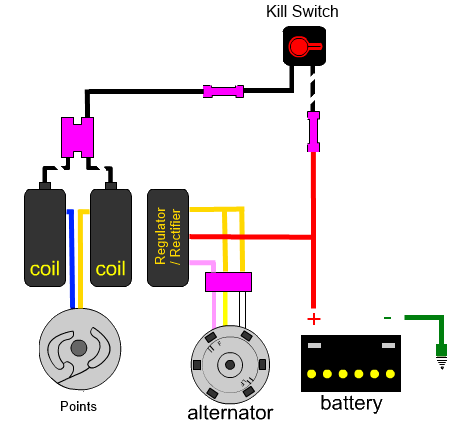

Sonreir said:
Barebones diagram for the Honda twins and singles. Only enough to get the bike running and keep it that way. No lights, signals, or gauges included. Though not pictured, I recommend a 5A fuse on the black wire leading to the coils.
Any chance you could give me some pointers on a similar set up for a CB900C 1982 Four?
I plan on running nothing but a horn

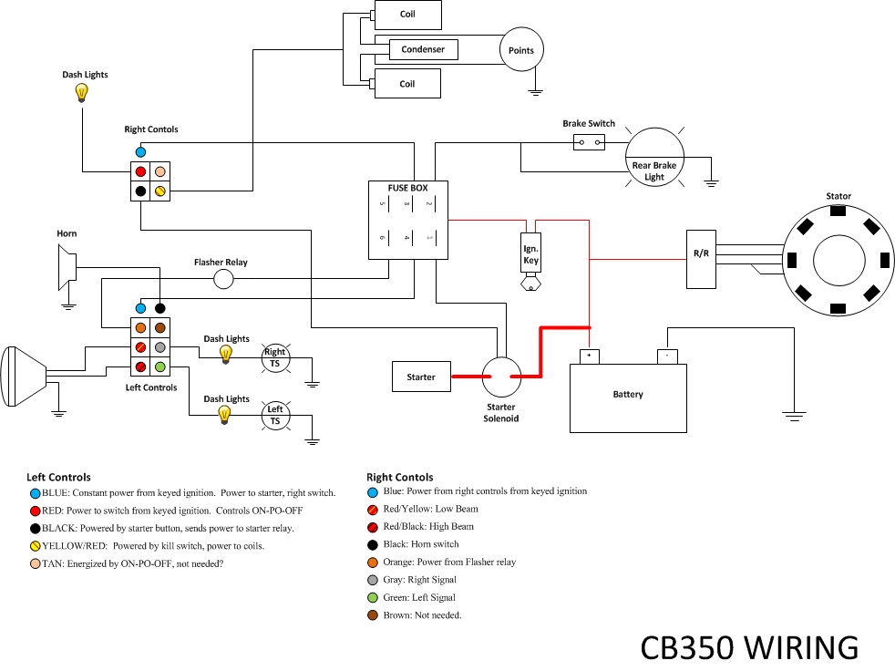

Was hoping you guys could take a look and give me some feed back on the diagram I made for my CB350 twin. This is using EMGO controls and a fuse box. This is my first go at wiring, so bear with me!
Tips on using factory key switch with this "barebones" setup? The 4 wires on my key switch have me dumbfounded. I got it wired up like this waiting on reg/rec kohler unit to be delivered today.
thanks
Brandon
Yup.
You only need the red and black ones. Skip the brown.
Red comes in directly from the main fuse and black goes out to feed power to everything.
