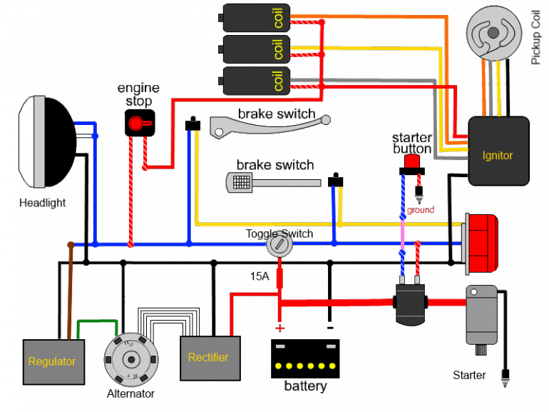

Sonreir said:
Yamaha XS Triple with no turn signals or idiot lights.
High beam wired to high beam always on.
Anybody tried this one out? Wondering if it applies to the 850, or just 750.

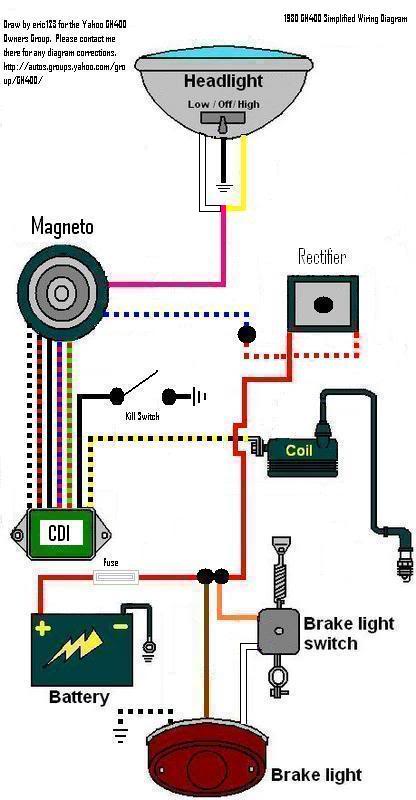

Sonrier - what would the process be like if someone wanted to add turn signals back in to a simplified wiring diagram? i.e. that XS tripe diagram, or the attached GN400 diagram.
Seams like it would be as simple as "power - control switch - signal relay - signal wires"
If so... where would you splice into the simplified harness?
For the XS, you can tap a flasher relay into a blue or a brown wire. The negative side of the relay then goes to the switch and the left and right output from the switch goes to the lights on either side.
For the GN, it's an AC bike, so it's going to be trickier. I would use the signal circuit on the DC side of things, but the above diagram doesn't have an ignition switch, only a kill switch. So your turn signals either work all the time (even when the bike is off) or you add another switch to kill the signals as well.

Alright, so I'm about halfway through this simplified wiring diagram and I'm a little hung up on the headlight wiring. This diagram has the pink wire from the magneto running into the headlight, but very little explanation beyond that. The switch has off-on, high and low. Any input appreciated.
So that's an AC bike setup for always on.
What you'll want, instead, is to run the pink wire to the switch, and then the output of the switch to the yellow and white wires (for high and low beam, respectively).
Okay, so it's just pink in - yellow/white out. The switch control has a million wires coming out of it, way more than I'd expect. So I'll have to take it apart to see what I'm doing.
So with this method, is it safe to assume that the headlight will only turn on when the bike is running? Since there isn't any direct power running to the headlight.
So based on the attached diagram, and what we have discussed, it looks like I just need to connect the pink to the red/yellow coming from the controls. Then internally the red/yellow will connect to green when the lights are ON. From green I can power the speedo light. Then yellow is high beam and white is low beam. That sounds fine... but what about the other 5 wires at the top of the control? (brown, orange, green/white, red/white, blue/white)
Orange is DC power. With the headlight switch on, it feeds DC power from the battery to the tail light. Green/white and blue/white provide charging for the battery at different quantities (depending if lights are on or off).
So what should I do with them? They are ignored in the simplified wiring diagram. I already wired up the tail/brake light via the method in the simplified diagram, so the orange I can ignore. But will the battery not receive proper charge if I ignore the green/white and blue/white?

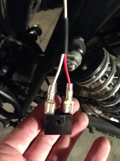

Alright... I hooked it all up last night and no spark. I have power to the tail/brake light which I had already tested, but no spark.
1) I guess my first question is whether or not the regulator needs to be grounded. See attached pictures. This is a new unit, and from what I can tell, it is the only think sending power from the battery to the regulator (red/white - blue/white in the diagram), which then has to send power to the coil via the black/yellow wire. If this is a self grounding unit via a bolt running through it, that could be my issue. If not, then I'll move on.
2) The kill switch wire that they have in the diagram connects the coil ground to the frame. Question is, is grounded going to kill the bike, or not grounded? Based on the stock diagram it looks like grounded will kill the bike.
Other than those two things, everything else looks good. So I'm a little lost.
You sure that's a regulator? Looks like a rectifier to me.
That said, spark is completely controlled by your CDI. Make sure the yellow/black wire isn't grounded.
Sorry, you're right. Rectifier.
I'll make sure we aren't grounded and try again. So the CDI is only getting power via the battery (red) - rectifier (red - red/white) - magneto (white/blue). Then the magneto transfers the power to the CDI which send it to the coil?
