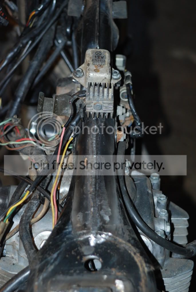

Got some more done. cut the rib on the back bone to make it flat and stronger
Welded the rib and ground it back flat (almost flat still raised some) welded tabs for electronics (KISS ) not fancy but it works
I off set the hole for the rectifier to allow room for the wires. Then remembered that I didn't need to because I'm using the radio shack one. Oh well.
Here is everything except the fuse panel. It will be mounted behind the rectifier on the rib. I need to purchase a little more flat stock to make its tab

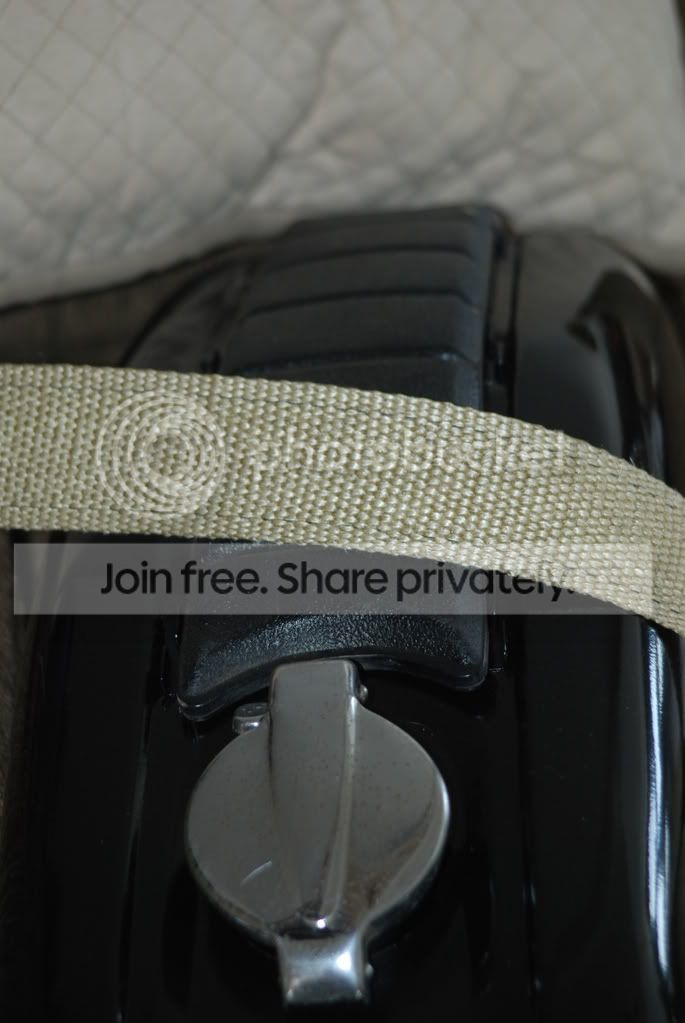

I'm considering a cream stripe down the middle of the tank. It would continue down the back of the seat. most of the stripe on the tank would be covered up by the pad. I'm not sure about the wheels. The rims will stay chrome but my spokes suck (rusty). They need painted so I may paint the spokes and hubs like JRK style with the epoxy. Not sure if I'll do this with cream or shiney black. If I use the cream, I'll use it sparingly in other places like maybe shifter linkage etc...??? Any iinput would be appreciated.

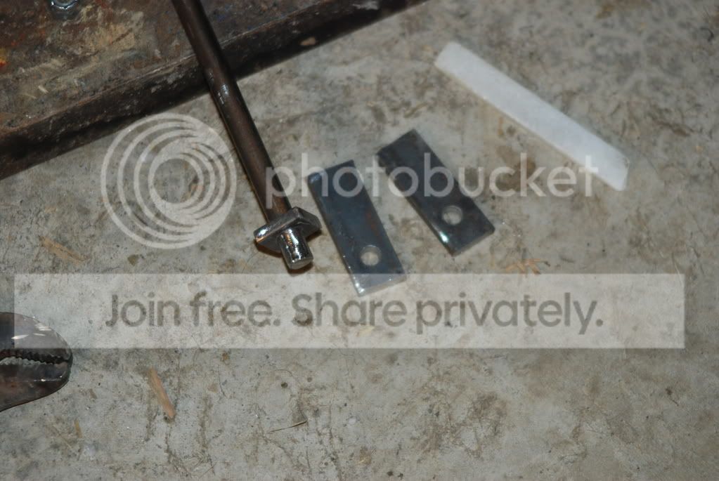

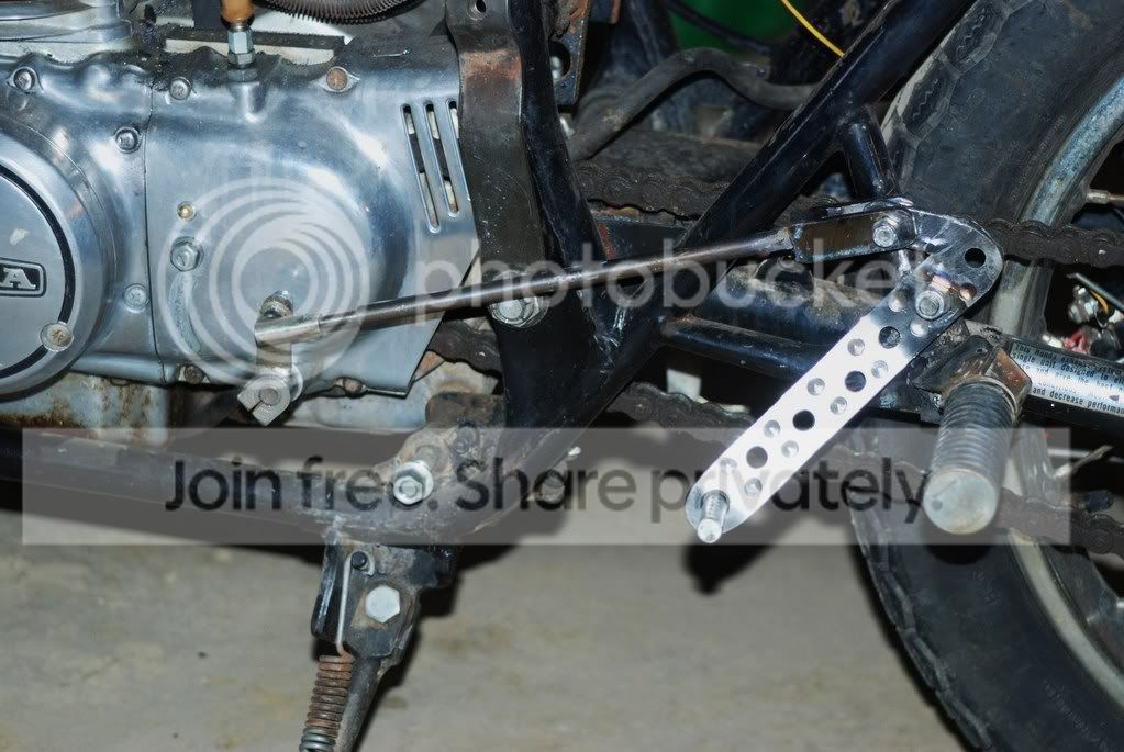

Finished the shifter linkage today. Made my own yoke and welded it to the linkage rod (pretty basic stuff). Cut this from flat stock.
Then welded it together to get this

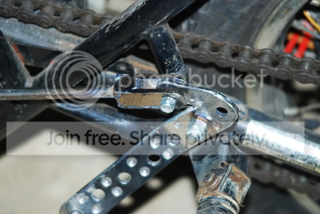

I also cut down the previous shifter lever to make it shorter. Then made a new mount for the linkage at the top. I felt the old one was a little too big and now I think it fits the bike better.
Has some nice angles. Don't have the brass washers yet, but it works real nice. Stamp it done. (May add another foot peg later) Except for sand polish etc...

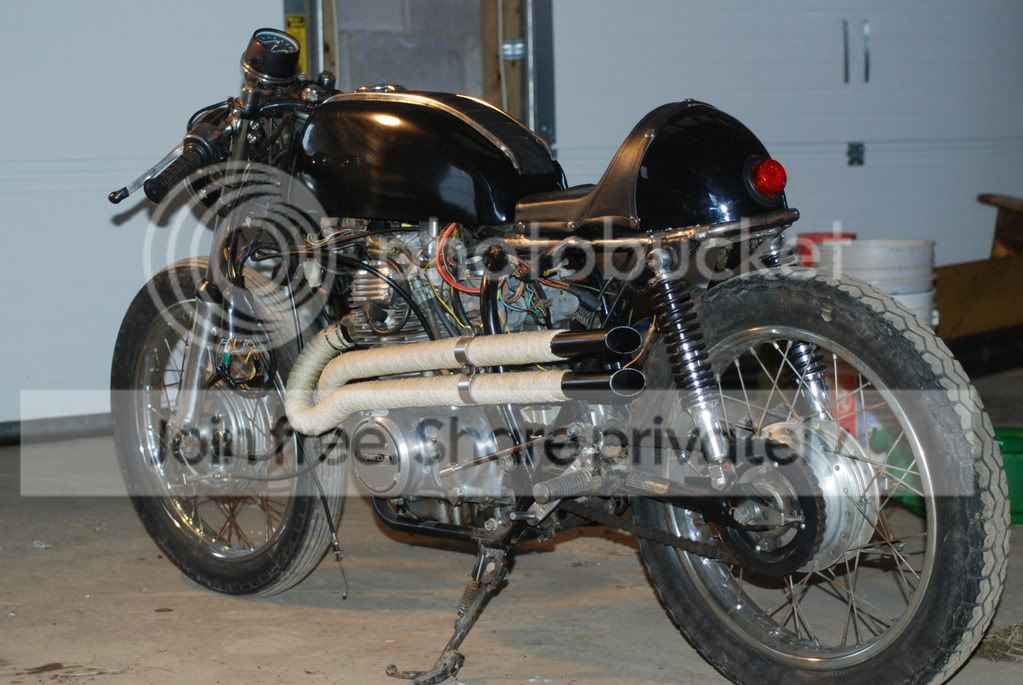

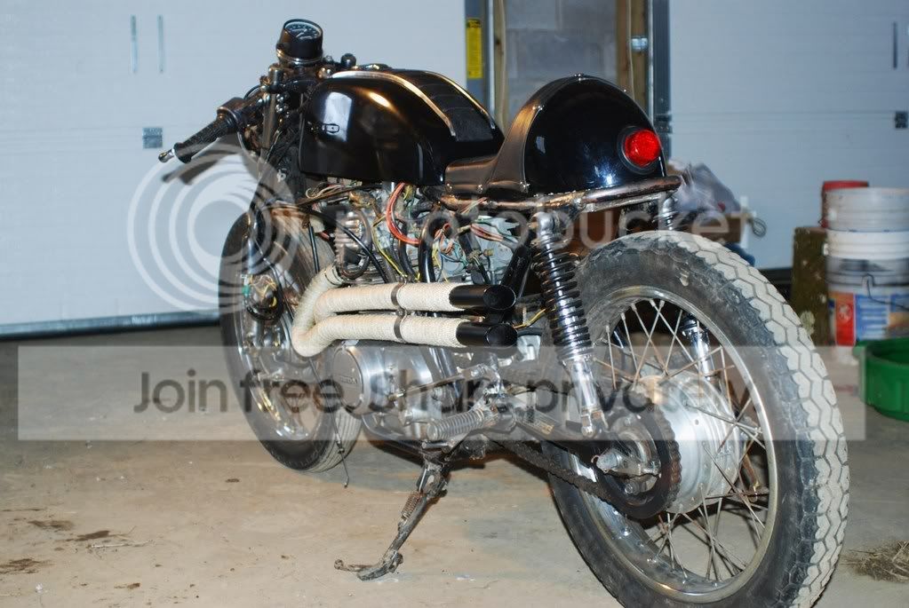

Ok, this is where I need some help. Wrapped the pipes and stuck them back on for mock up. I need to figure out the rest of the paint scheme. So here are a few photos. I have to tell ya that I'm really digging the Shiney Black and Chrome. I was planning on doing the Hubs and spokes in gloss black. Dust covers shiney chrome/aluminum. Rims??? The tank will have factory rubber Knee pads but I 'm really liking the all black tank and tail. Not sure what to do with shifter and linkage. Thinking about Chrome powder for those but would depend on cost. They are not that fancy but I made them and they are a little different. Shiney chrome might top top them off.
Any way here are the photos. (I did get a hard on while mounting those pipes. I'm real happy with them ;D) Don't look at the wires. This is just mock up. But I'm thinking of leaving the motor as is and doing the wheels/spokes??? Any ideas?????
Stance:
Wrap turned out real nice. This photo captures the color pretty good (might be a shade darker than the pic shows). Plan to spray with silicone to help seal the color and block dirt
