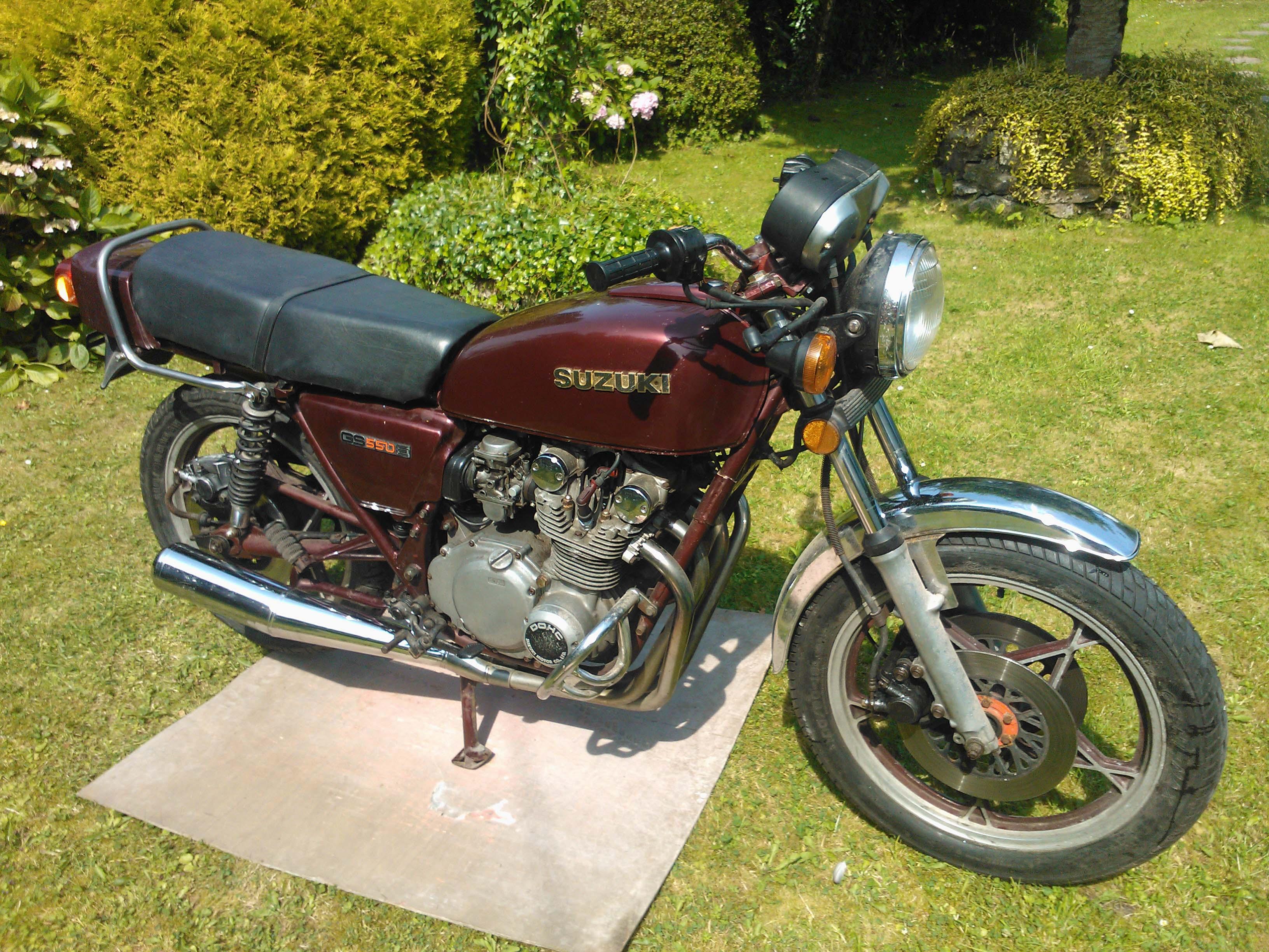

A quick strip down and it was getting better! Only very minor surface rust in the odd place. It looked like the bike had been covered with WD40 or something when it was apparently stored away for 10+ years. So the metalwork is all good! I hooked up a spare battery and turned her over. She had good even compression :)
I was beginning to believe the previous owner's story and the mere 26K on the clock and I started to get excited about this bike!!

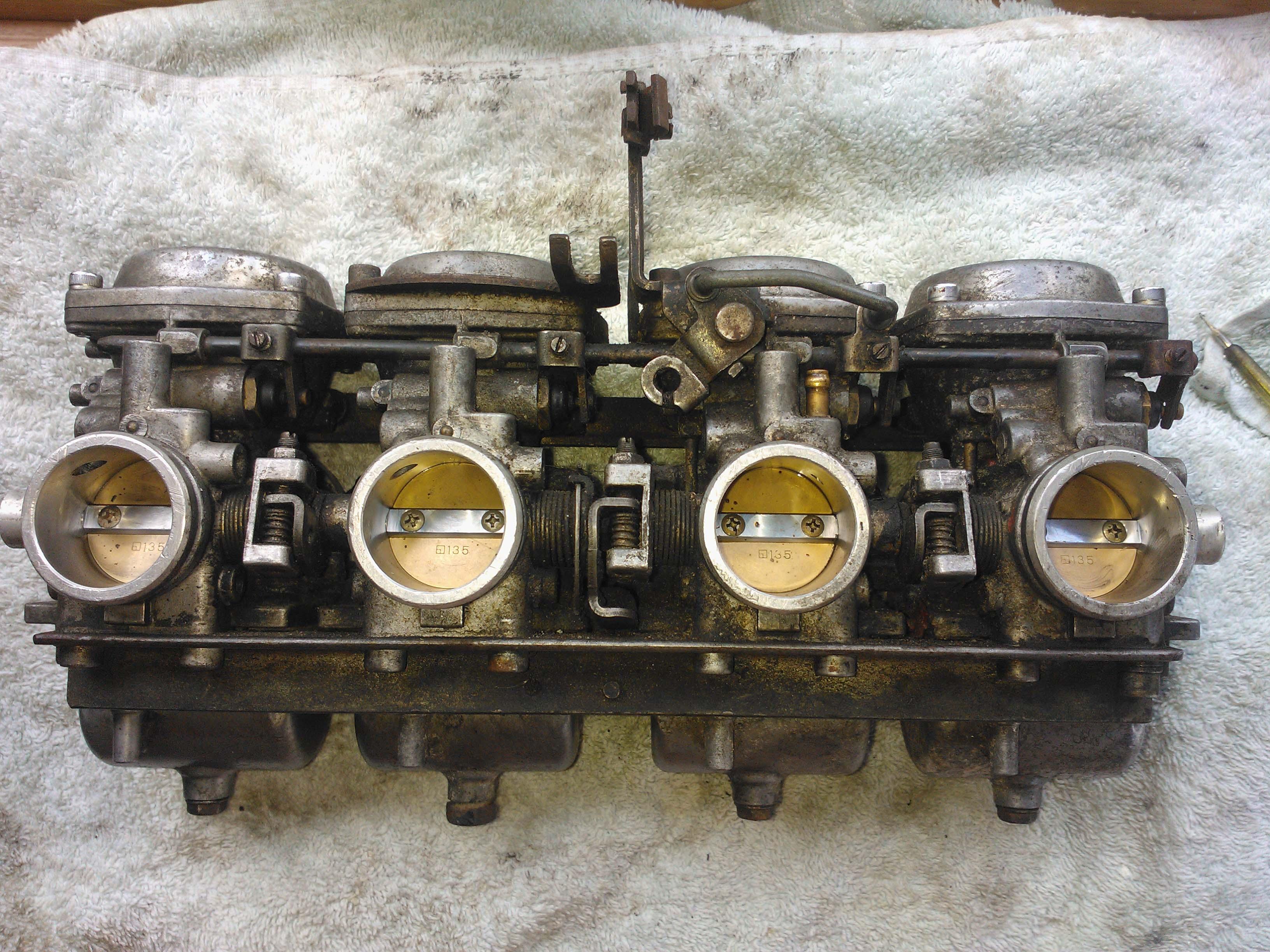

First point of call was draining the tank and carbs to see what I've got... Yep the previous owner hadn't even touched the carbs or put fresh fuel in! So he didn't stand a chance of getting her running with 12 year old fuel in there!
I stripped the carbs and found that they were completely covered in varnish - old petrol. I had no carb dip stuff so I just spend hours with a can of carb cleaner carefully removing all the varnish and trying to unblock the jets and other holes...
How awkward is it to remove these carbs?!! There's no room to get them out! The air box and frame is in the way. I'm planning to fit pod filters but I just want to get her running for now...

After the 4th attempt of cleaning the carbs and a tinkle on the points - she coughed and showed signs of starting! 5th carb overhaul and clean and a fiddle with the pilot jets... She started a beauty! Purring like a kitten now :)
Nothing more satisfying than getting a non-runner going again after 12 years :)

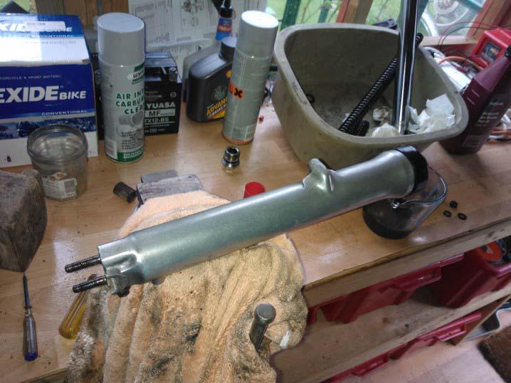

I decided to get her through an MOT as the next priority. So it's fork seals and brakes...
I found that the previous owner had tried to fix the rear brake by buying a new caliper and filling with new brake fluid but just didn't bleed the brake. So all that was needed on the rear was a quick bleed and it's working great. The front needed a new reservoir and overhaul. The calipers were great though. I found a second-hand reservoir with braided lines so I fitted these.

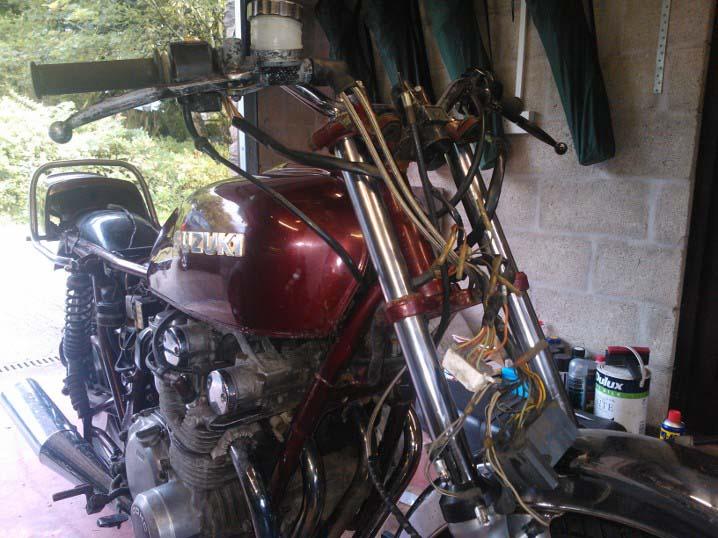

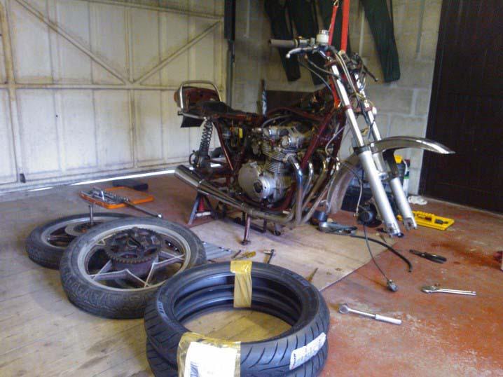

Next I needed to fit the existing seat properly, sort the wiring, new headlight, clean the chain and sprockets, and new tyres and she'll be ready for MOT. The indicators don't work which is an MOT failure, but apparently if there aren't any on there then it's fine! So I'll take them off for now...

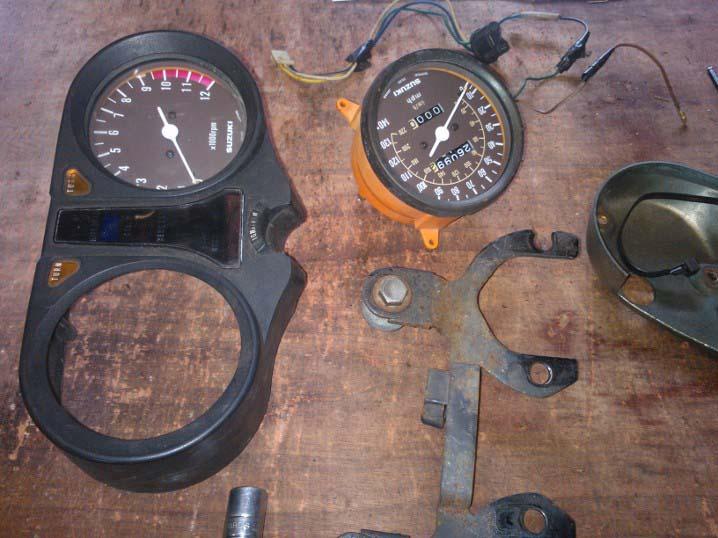

I decided to start getting the essence of a cafe racer and modified the big plastic clocks...

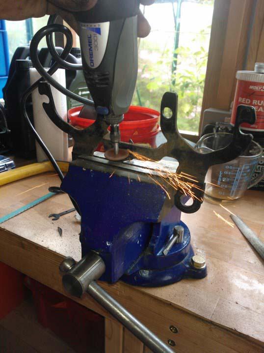

I stripped it all down and just modified the bracket to fit the speedo in the middle I like the classic look of 1 big clock in the middle rather than the two small speedo and rev counter layout. It needs work though coz it sticks out a bit over the ignition switch.

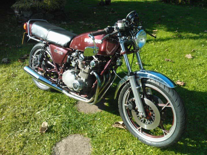

Cheers Gary. I've got quite far down the line of my project now. I kept meaning to post the build on here and I've only just got round to it so I'm posting the first few months in one go!!! Yeah your right about the missing/damaged parts - like the seat and headlight :)
Got to MOT garage and I noticed my fork seals were leaking from the short journey there! ???
But managed to blag it and passed MOT! :)
She is running sweet. Got to 90mph down the A road :) Not quite the ton yet though!
Yes my 90's leathers look a bit odd on this bike HAHA. I will have to sort that out since the bike will be heading towards teh 60's/70's cafe style!
I'm not so happy with my speedo clock sticking out and I think the Bates style headlight is a bit small for this bike. I'm looking forward to getting a mono seat now though!

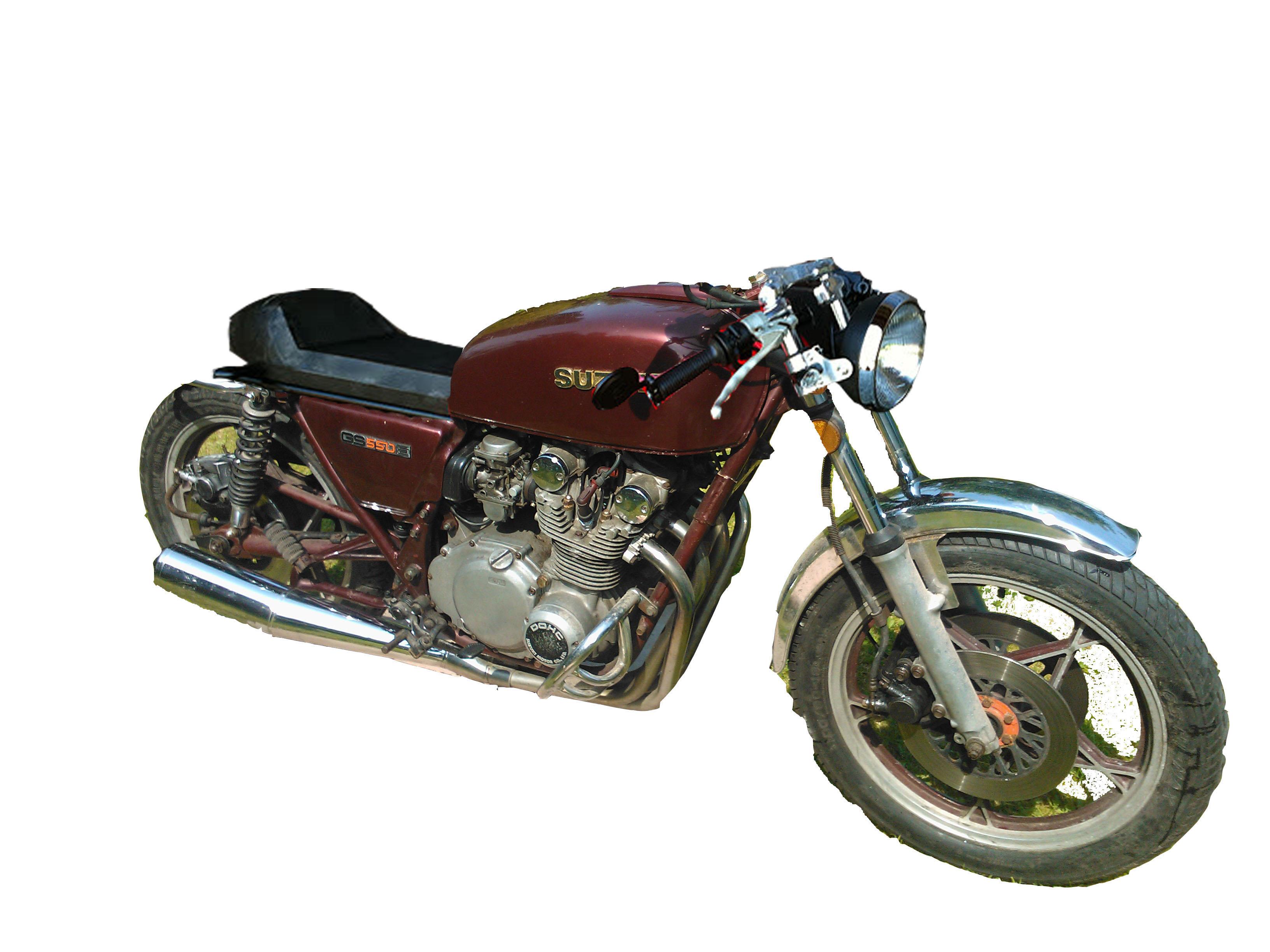

I had been toying with the idea of making my own seat hump as I am on a budget. But it seamed as expensive to buy the flower foam, glass fibre and paint etc as to buy a pre-made shell. I made a mock-up of one I found from the measurements and pictures of it...
I'm happy with the seat mock-up so I ordered that!

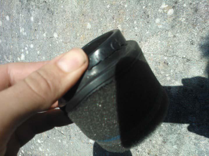

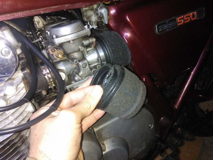

I fitted Pipercross pod airfilters. I wanted to have paper cones but I can't find any that will fit without squashing againt the frame. I've noticed there's a lot less room with these Mikuni carbs than with the earlier models.
The first set of filters I got just fell to bits the first time I fitted them! I thought I had tightened the jubilee clips too tight but I complained to the shop anyway and sent Pipercross and email. Pipercross got back to me the same day saying it was a known fault and they will send a set of new ones out :)
I originally went up 2 main jet sizes but was still running lean on these filters, so I went up a couple more. Now She's running really fast and responsive! Makes a lovely deep growl too!! I ended up going up 1 size on the pilot jets too coz I was running lean on part throttle even with the fuel screws right out.

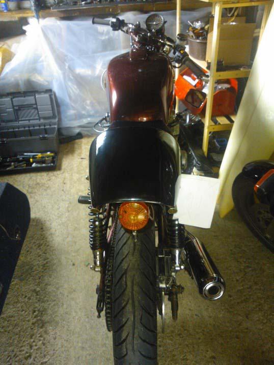

I like the length of the seat. It means I could cut down the frame and mudguard just after the gusset and also keep the bar at the back to bolt the rear light onto. This also keeps the stiffness without having to do any welding (as I can't weld!) LOL.
I mocked up a round rear light using my old indicator and a sheet of paper for the numberplate.
I don't like the round rear light so went for an oval one...
I want to fit some small indicators onto the end of the frame...
