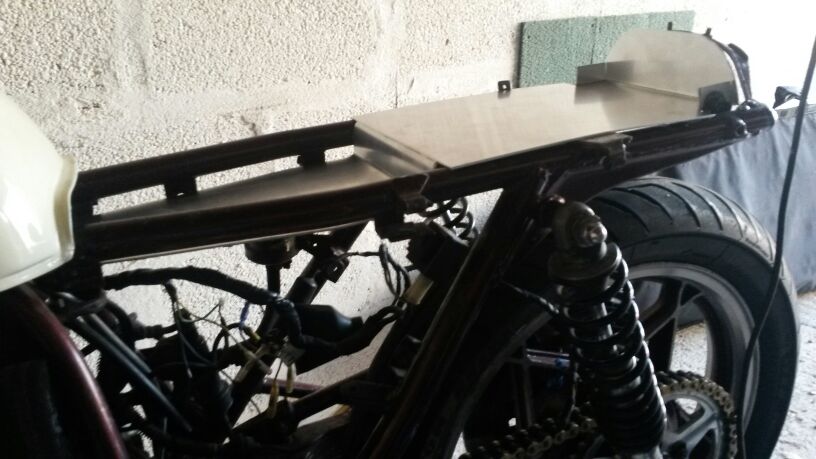

I made a template tray out of cardboard. Then cut a piece of aluminium and bent it to shape...

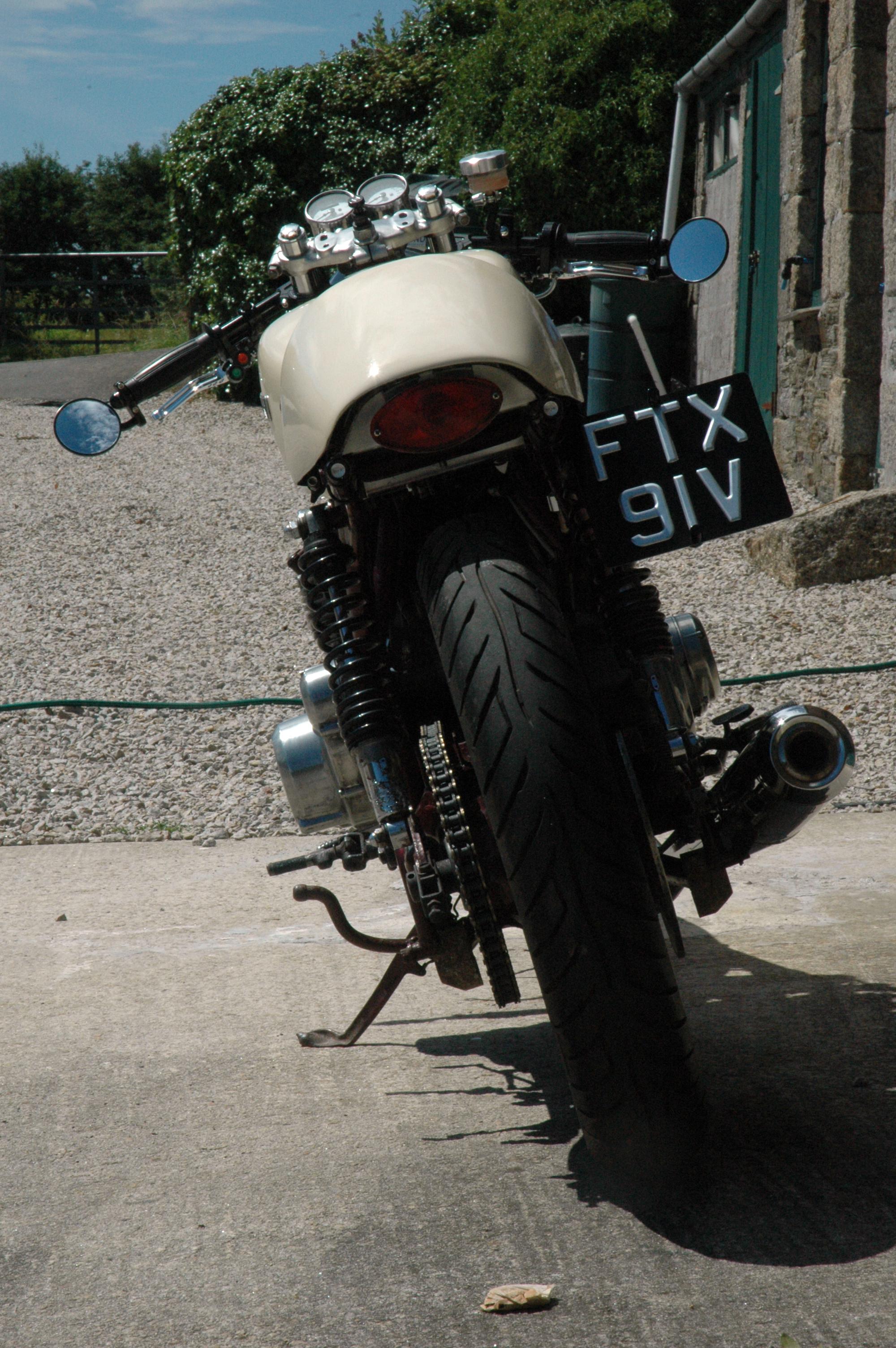

nice looking bike ;)
but a silly place to hang the plate,if you have to get off the bike that thing is gonna cut you wide open :(

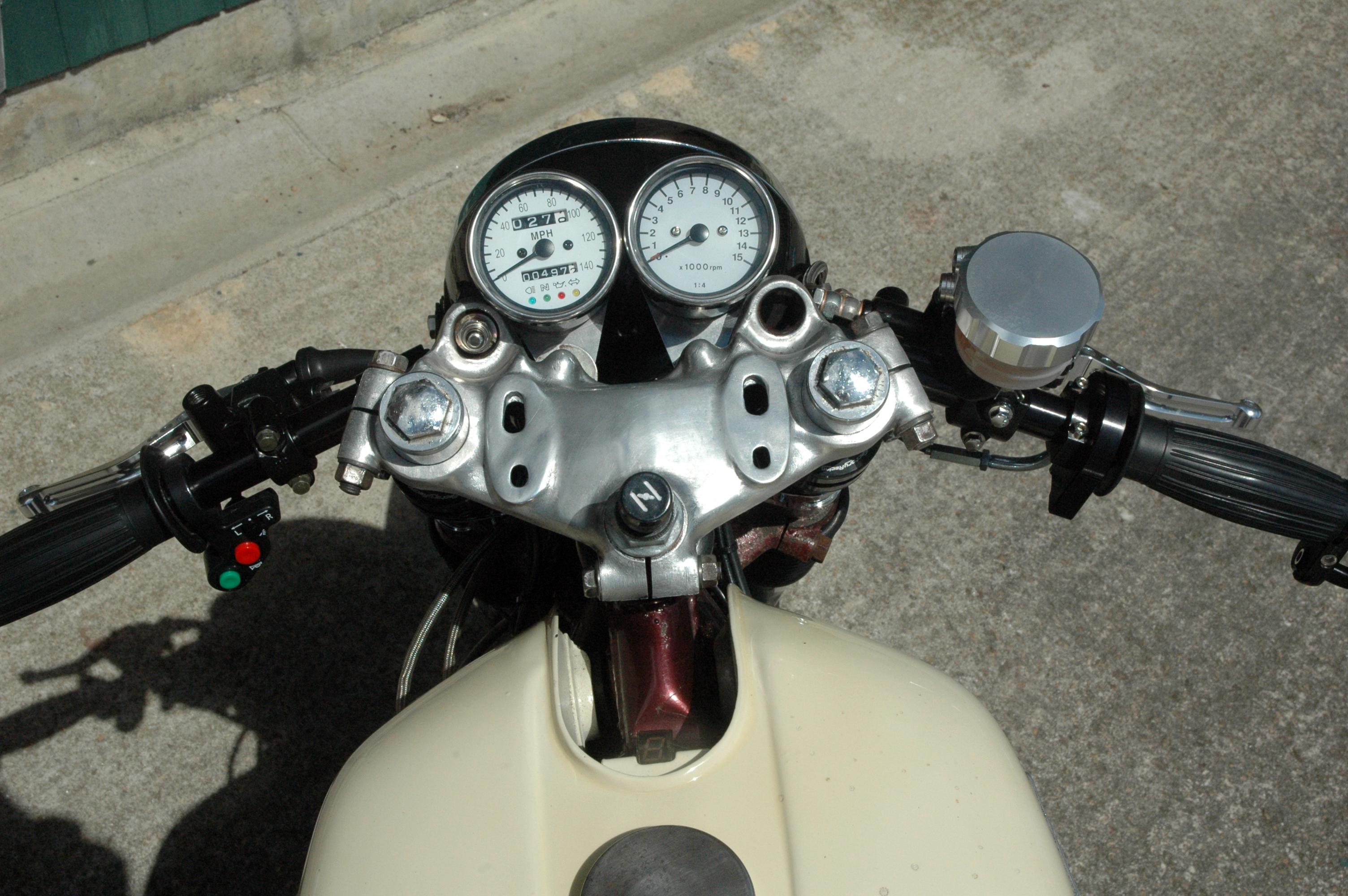

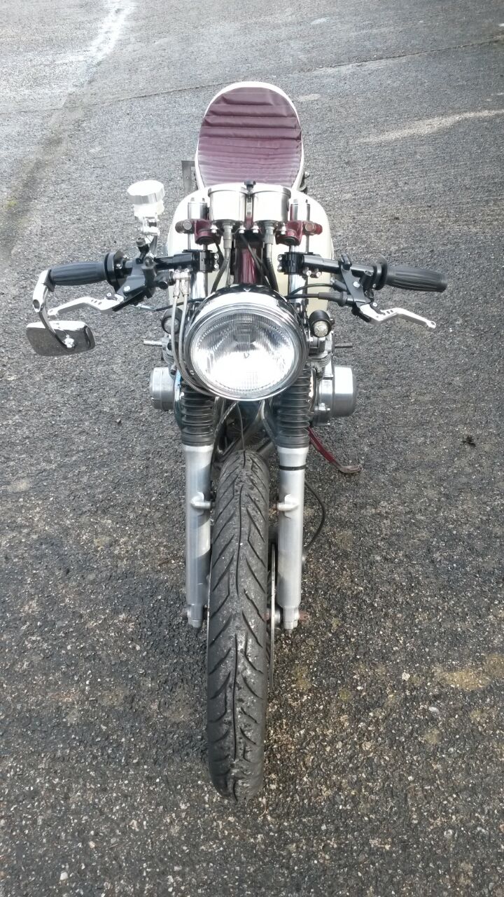

Then I went for clip-ons...
Good point, but I think it will just bend easily. The plate and bracket is aluminium so it'll just bend and not cut me open! :D
Then came new levers inc master cylinder and reservoirs. No more leaky master cylinder and spongy brakes! :D
And new switch gear.
I wired up the lights to the ignition switch, and used a switch relay so the light on/off switch does the high/low beam switching. I still have to mount the starter button, which will sit between the clocks.
Bad over-exposed photo.
I'll add more when I've finished the starter button
keep dreaming,but don't be stupid, that is an extremely dangerous lashup you got there

Thanks for your interest. Trust me, the plate bracket is flimsy! It will bend before the plate puts enough pressure on me to puncture through Kevlar jeans and skin. I wear protective clothing, not like a lot of Americans I see wearing shorts, trainers and a shirt, with no gloves. I know it's hot over there in SoCal but come on! I cede it is a valid point, and no it would not pass an Isle of Man TT inspection ;D but it has passed several MOT inspections. I also wear an open-face when riding the GS and I think I'm more likely to cause some serious problems when my face/chin when it meets tarmac/car! :o Can we leave the plate now?! ;D

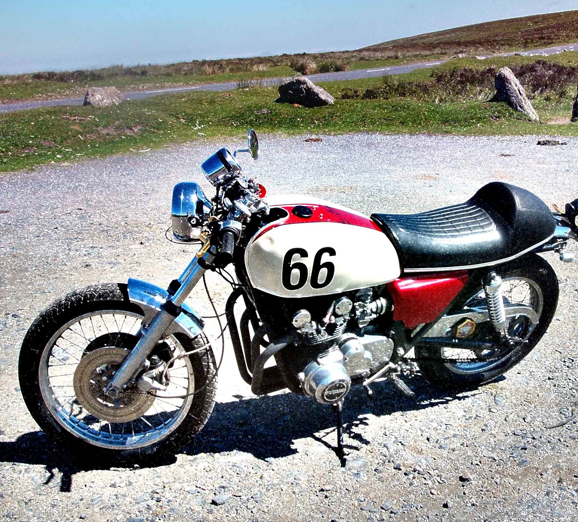

Aha! I just remembered rhe bike t
you were talking about earlier, "race cream" from Matteucci in italy, if I'm not mistaken. .. a nice piece of work... in fact that was the bike that made me really want to build a cafe racer instead of another restoration!

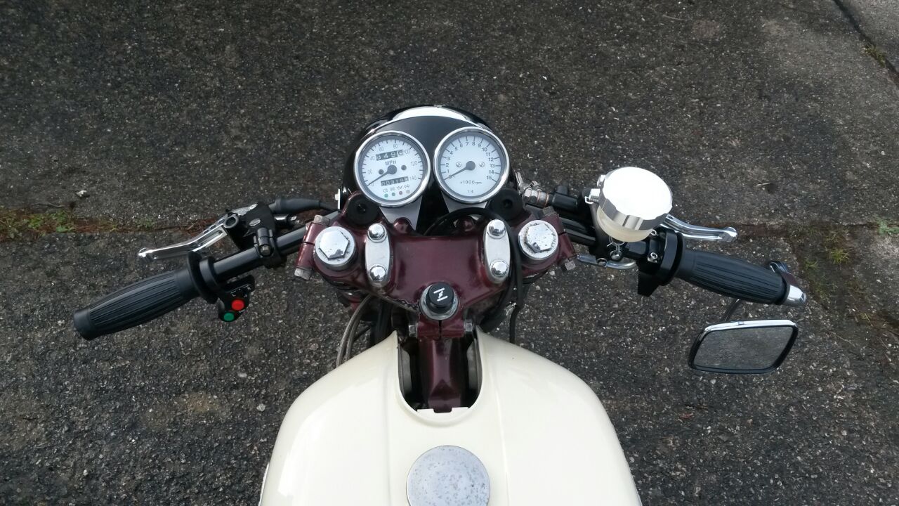

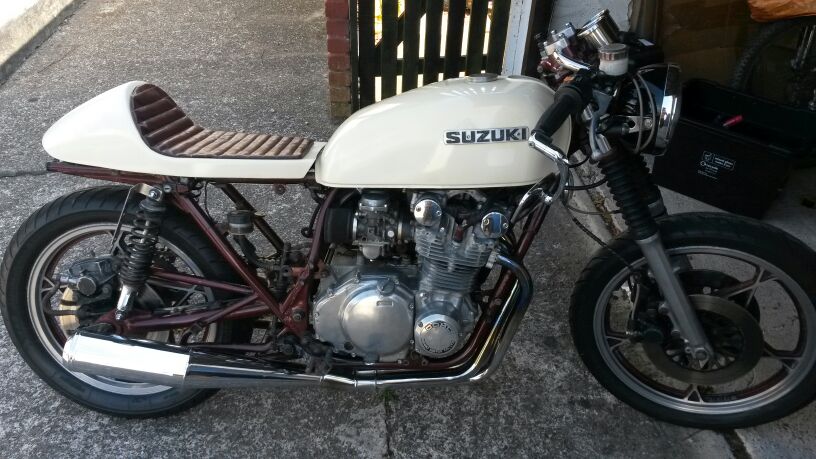

A few more changes since last posted...
Finally cut the old bar mounts off the yoke and took the paint off.
Fiddled about with the heights of the headlight and bars to create the right lines.
I've taken the rev clock off now coz the cable snapped. And then I decided I liked the single clock look anyway.
Then last week my regulator/rectifier went wrong and burnt out my Dynatek ignition sensors and coils!!! :( Along with my headlight bulb and rear light bulb. And melted the bulb holder wires off :o
I'm currently fixing all the wiring and finding replacement parts.
I've found a second hand Honda regulator/rectifier and fitted that.
I bought second hand OEM coils, thinking these would be better than new chinese coils (I've had a bad experience from these before). But they were faulty. Cheeky of the Ebay seller to sell these. I tested them with a multimeter and found they were faulty but I fitted them to my bike to double check. One was almost dead and the other actually blows my fuse when I plug it in. I've now bought some Velo Sport coils hoping they are better than the most common rubbish coils I've found.
I've bought an LED rear light and I'm waiting for that delivery too.

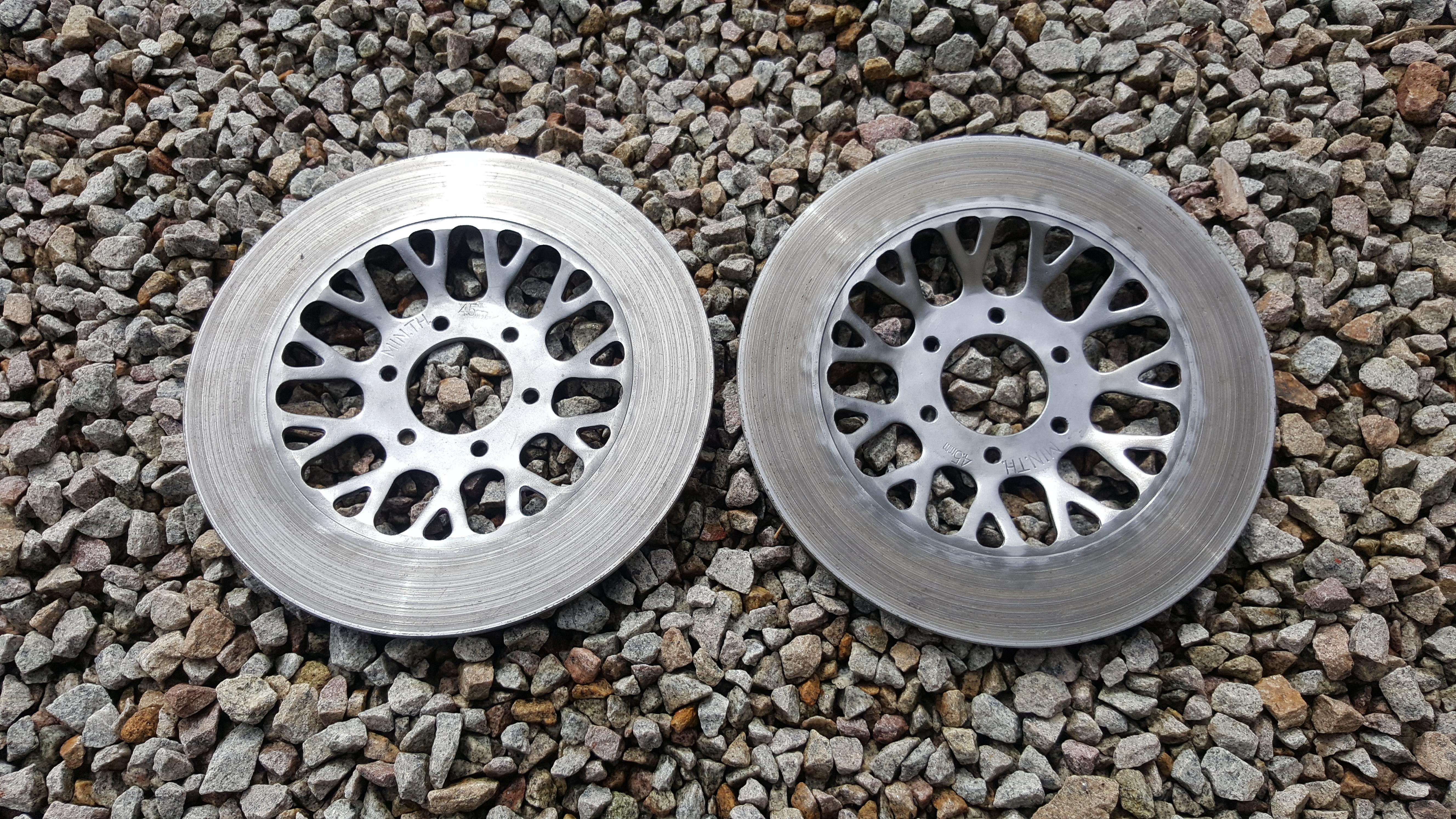

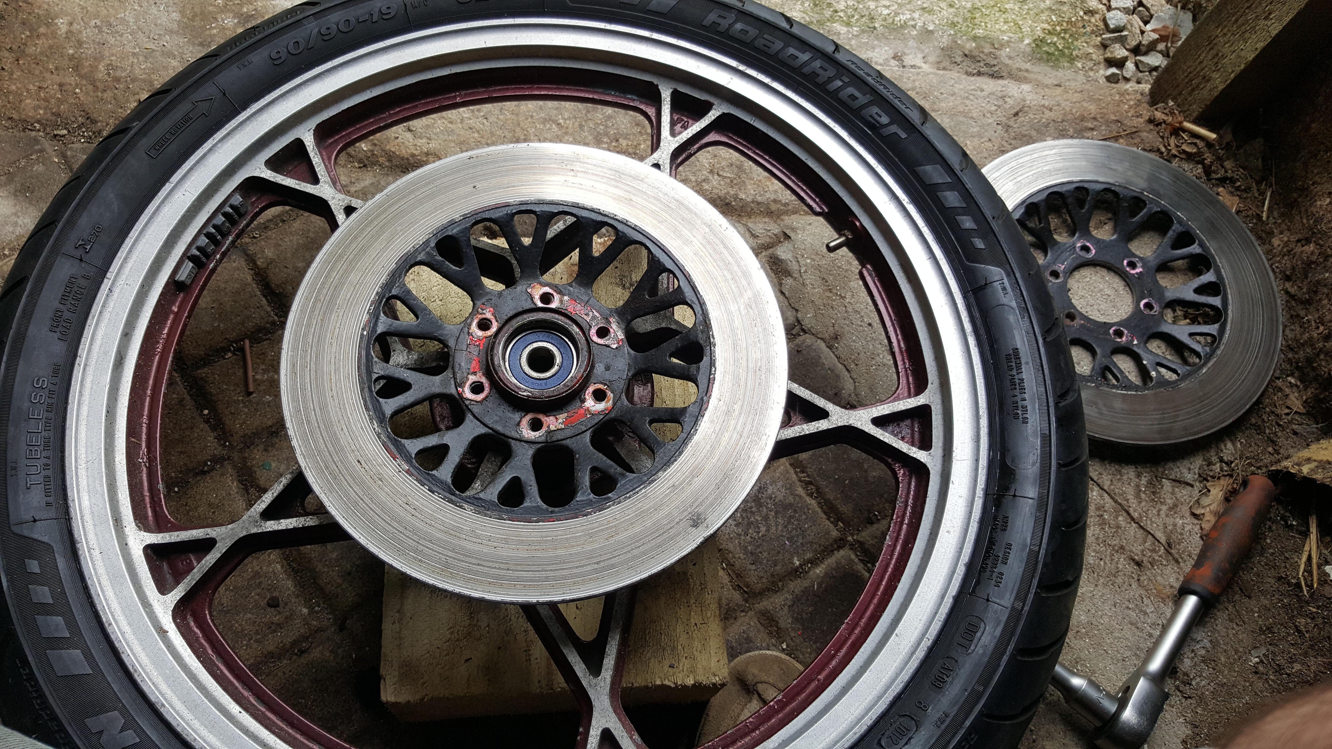

This year I cleaned up my discs. Stripped the paint off.
Sprayed my wheels satin black.

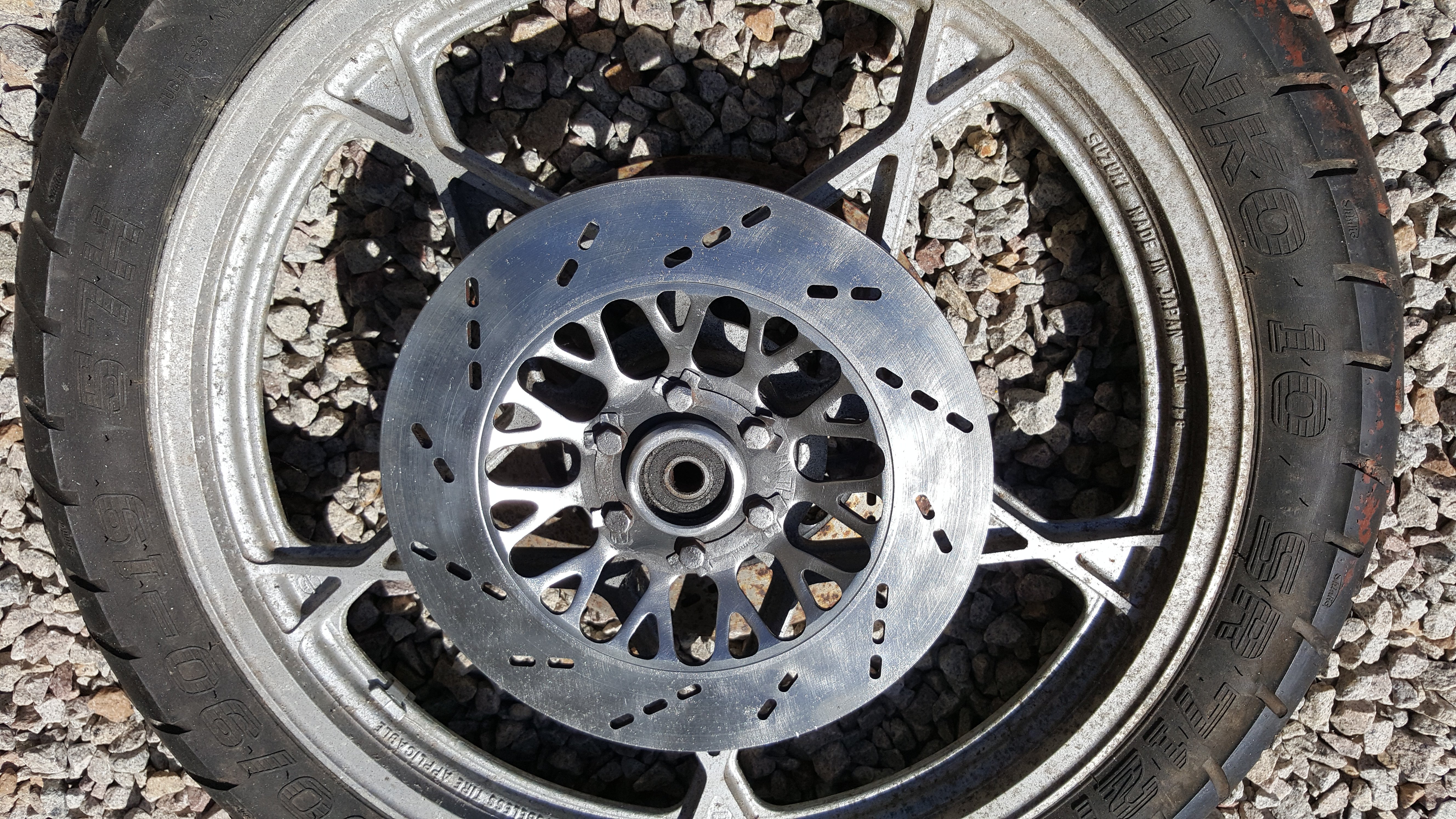

Then just as I'd finished that, someone was selling some gs550 wheels locally for £15 the set... and they had the drilled discs I've been wanting for ages!
