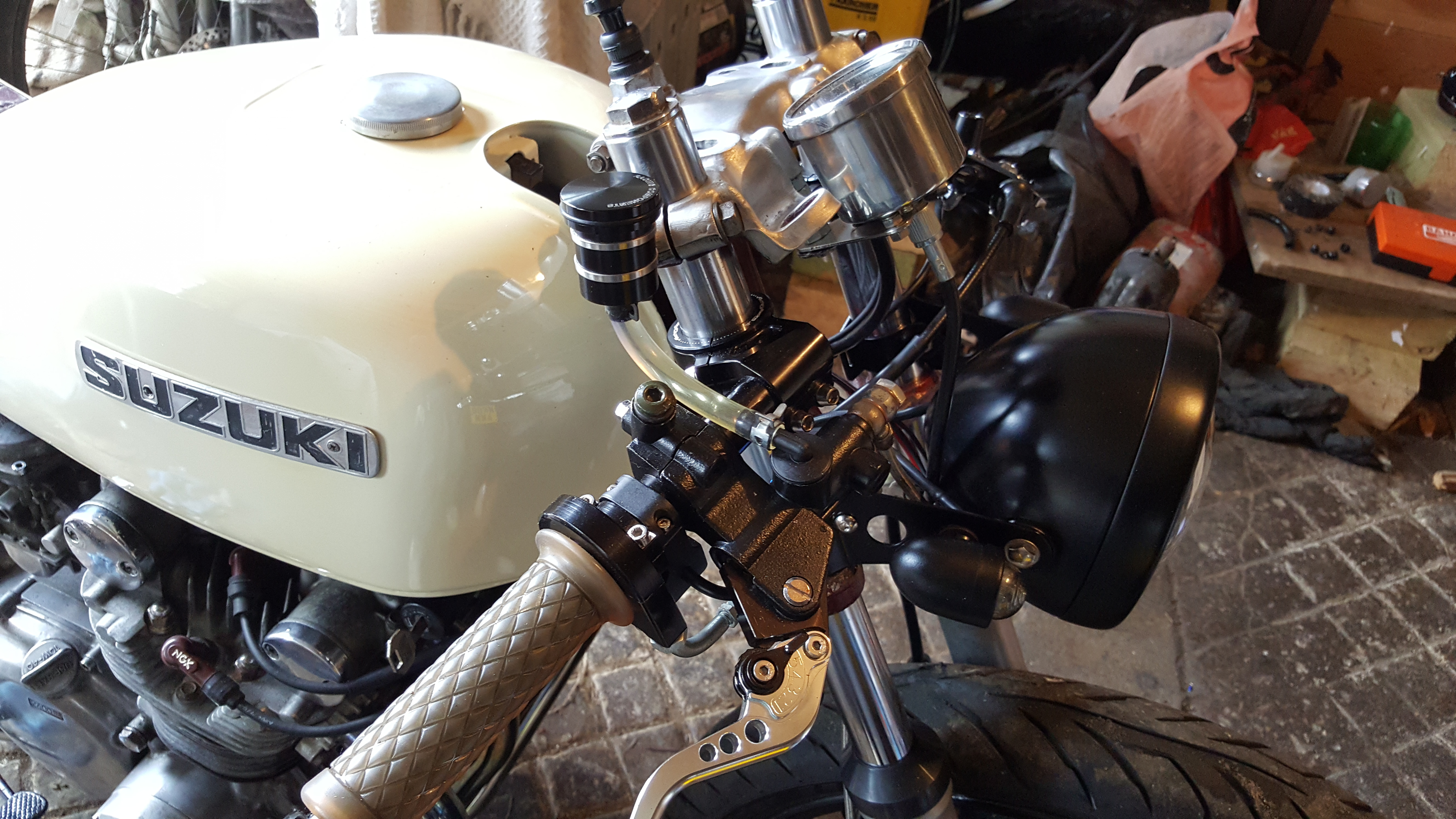

I've already fitted modern levers and led bits n bobs. So I decided to go for a more modern twist all round. I fitted an halo / projector headlight in a 5.75" headlight shell. Painted satin black with left-over wheel spray.

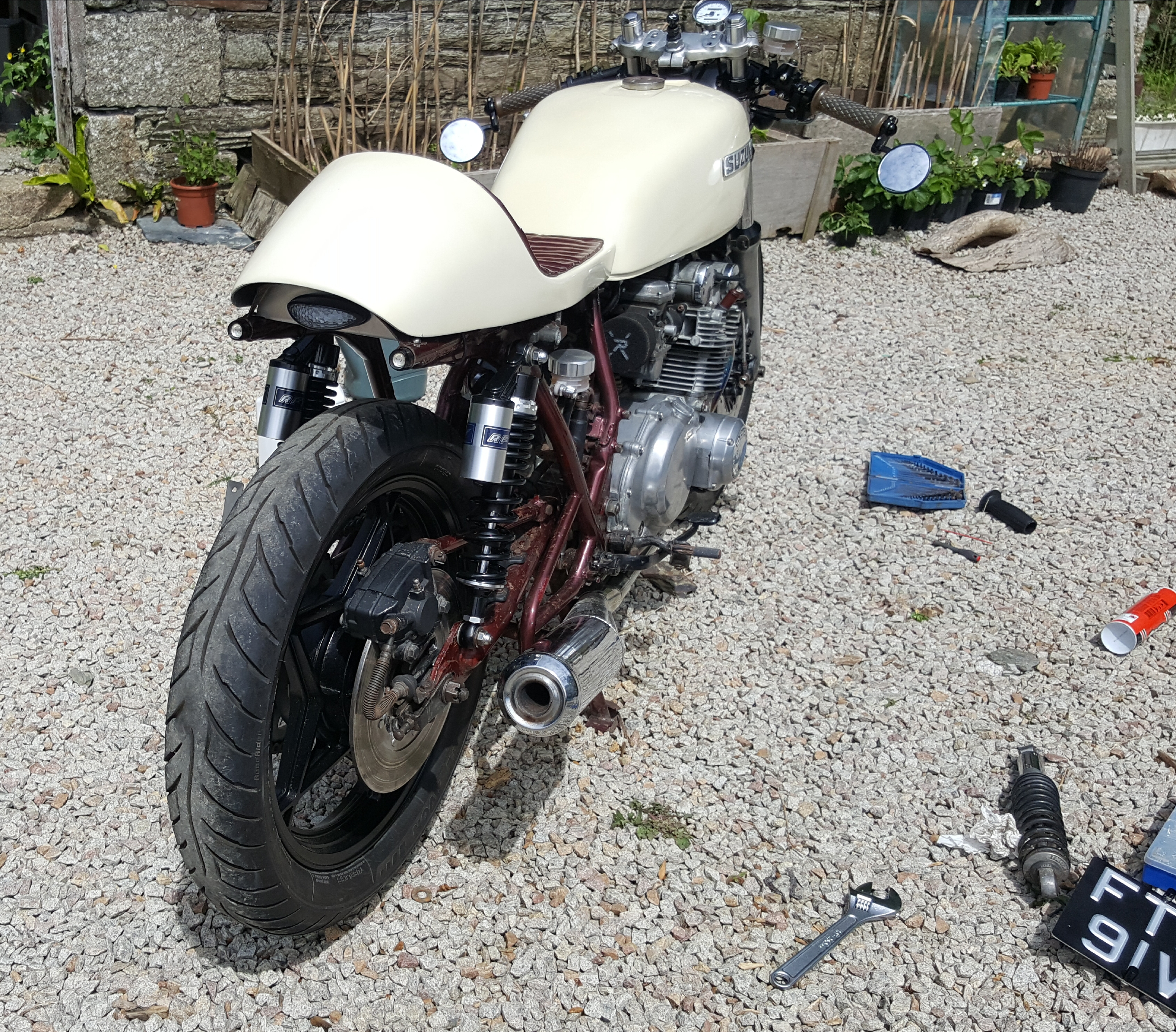

I then fitted RFY shocks. These are a massive improvement over the tired Koni shocks I had on. And it lifted the rear about an inch. They are fairly cheap but I'd say really good quality. I had read a few bad comments about them but for an old heavy gs550 I think they're great!
I also got some gum grips.
I've added very small black brake reservoirs. I had an issue with the old reservoir hoses sweating. So I made sure I got good quality hose. I went for clear hose to act like a window because the mini reservoirs don't have windows.

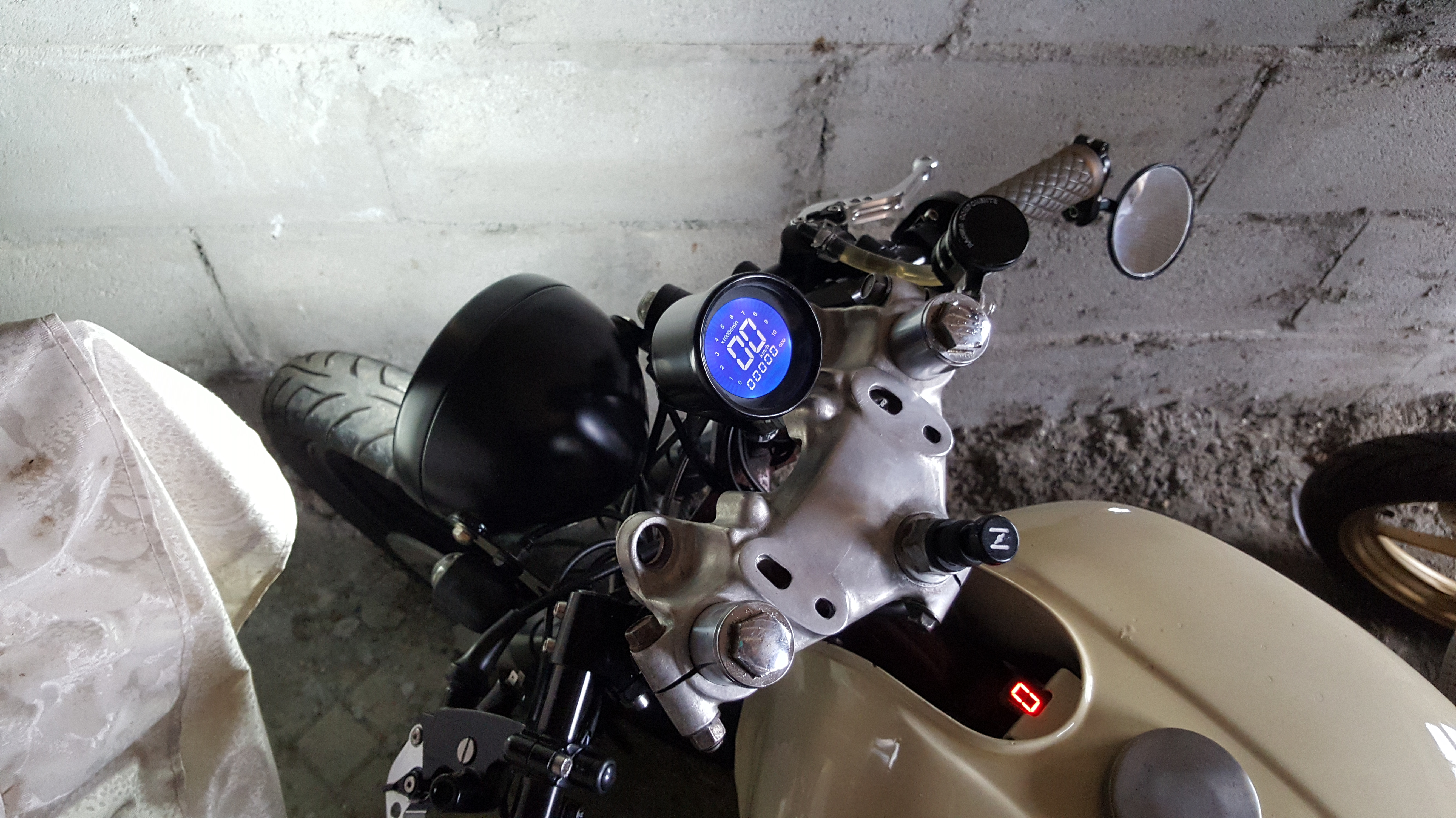

I've now wired up new switches. Finally getting rid of the cheap plastic switch gear on the left.
I found momentary buttons that are part of the brake/clutch lever bracket. These are for horn and starter. Then two sets of two on-off buttons for indicators, headlight and high beam.
So the halo comes on with ignition and then a switch for dip and high beams.
I've also fitted a digital speedo that has revs in it too. I prefer the single clock. It's just a cheap chinese clock so I can decide if I like the digital style. I like it, so I might get a good quality one sometime in the future!

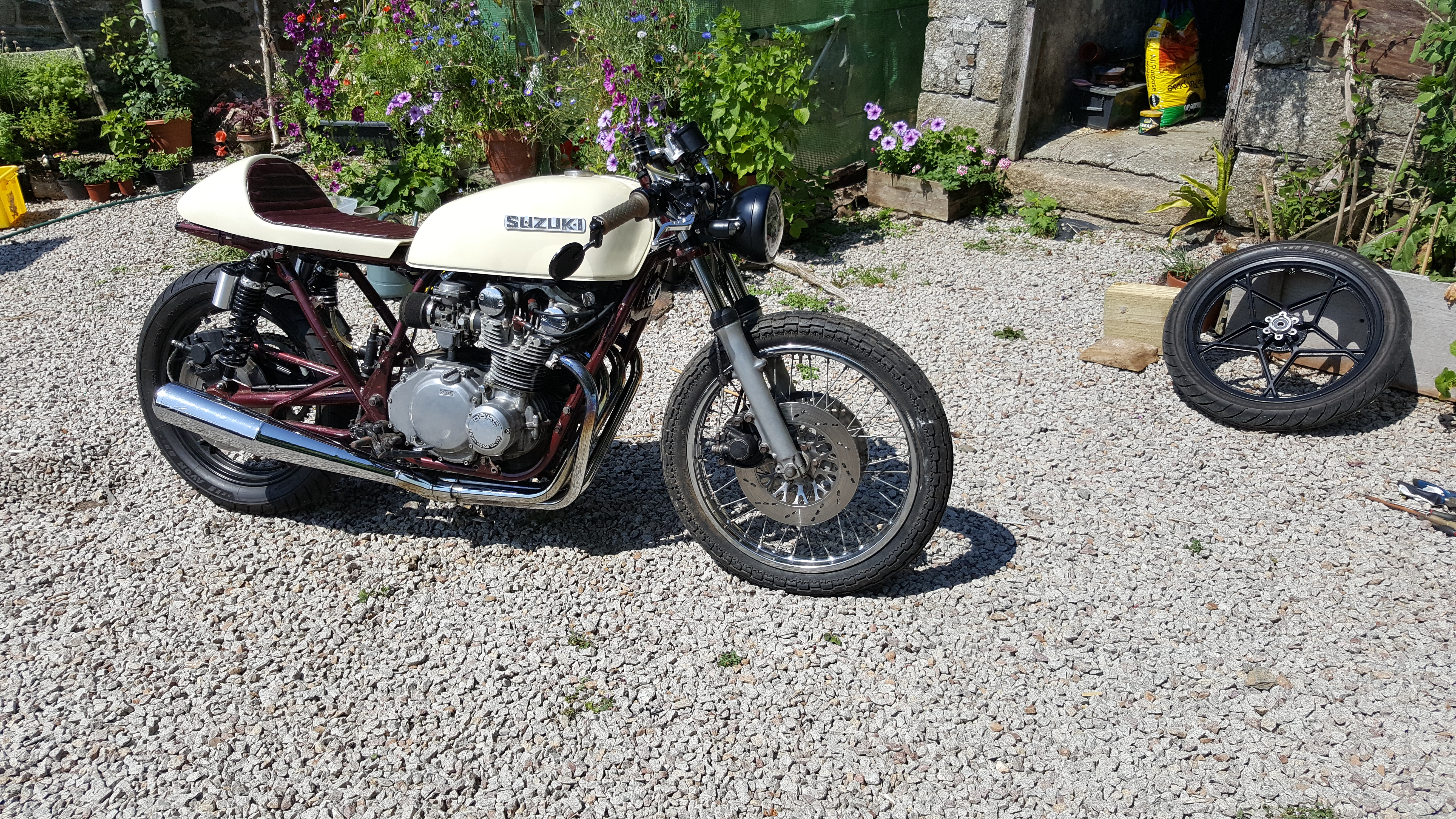

My current project is converting to spoked wheels... now i finally sprayed my wheels!
I found a gs1000 rear wheel with rear disc brake. So I don't have to convert to drum brake. I'd rather keep my new drilled disc! Found on eBay, the seller had a few blurred photos of it so I asked about the condition on the chrome rim (I thought I could re-spoke it relatively cheaply but re-chroming would be expensive!) He said the chrome was in great shape. It wasn't!!! It had been roughly sanded down on one side! Annoying coz I still want the gs1000 wheel but should've paid a bit less for it!
Postman just delivered the front wheel I found. Hopefully I will be able to make it fit! It's a '74 GT750 front wheel. Apparently they're all tapped for twin discs anyway coz I want to keep the twin discs (UK standard on the gs when US still had single discs I think). This is in goid condition.
So I'm trying to sand and polish out the deep rough sanding on the rear wheel. It won't be mirror finish chrome but hopefully decent enough.
I think I've got to change the front calipers because the gs550 calipers will touch the spokes. I'll double check this weekend.

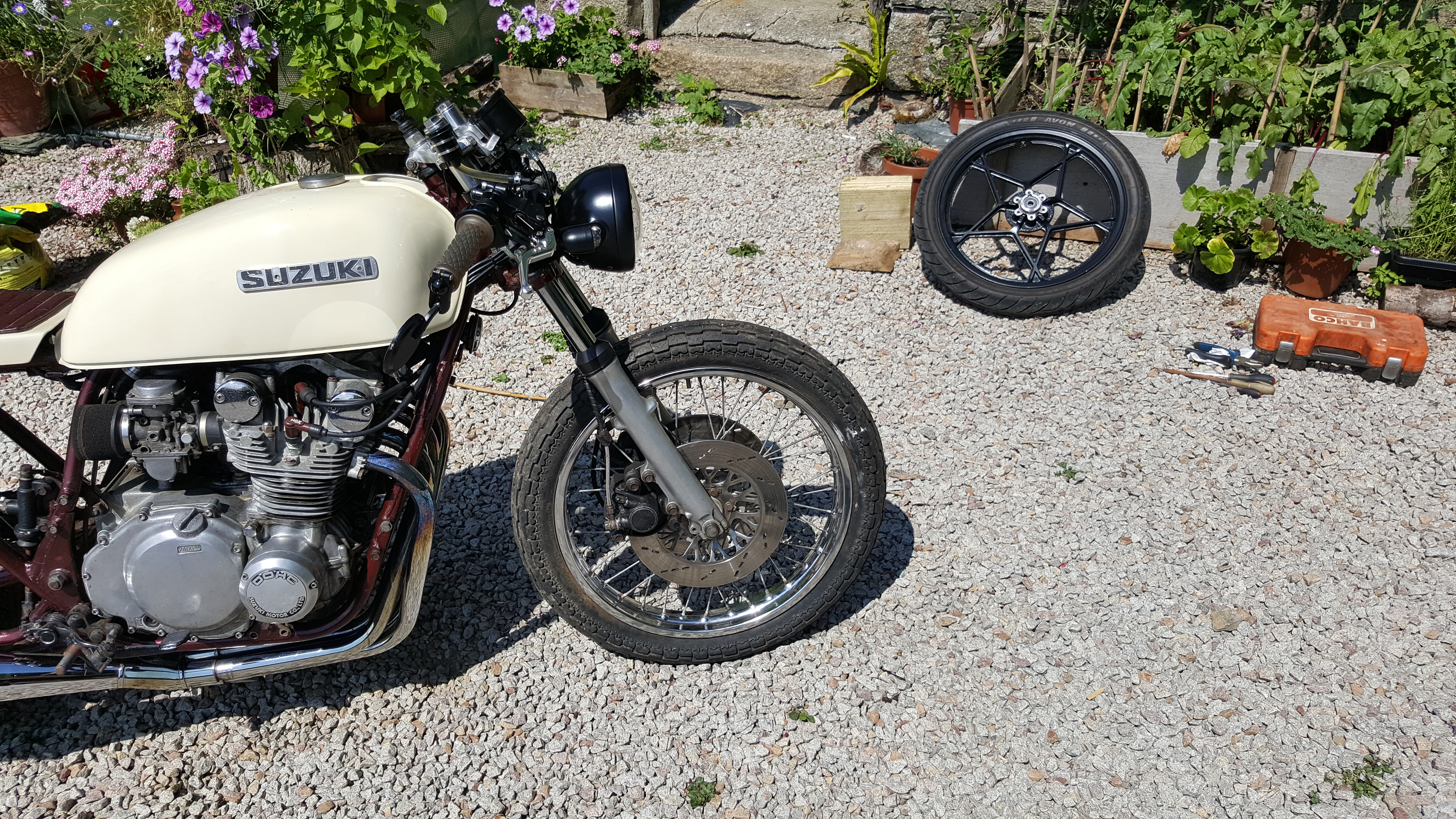

I fitted the gt750 '74 spoked front wheel today. It slotted straight in with no modifications from the standard alloy/mag gs550 wheel :D Same size bearings/axle. Same width hub.
Even more suprising was that the calipers fit fine too! I had read that I'd need gs1000 calipers to clear the spokes. But that wasn't the case.
I'll need a new tube and tyre though.

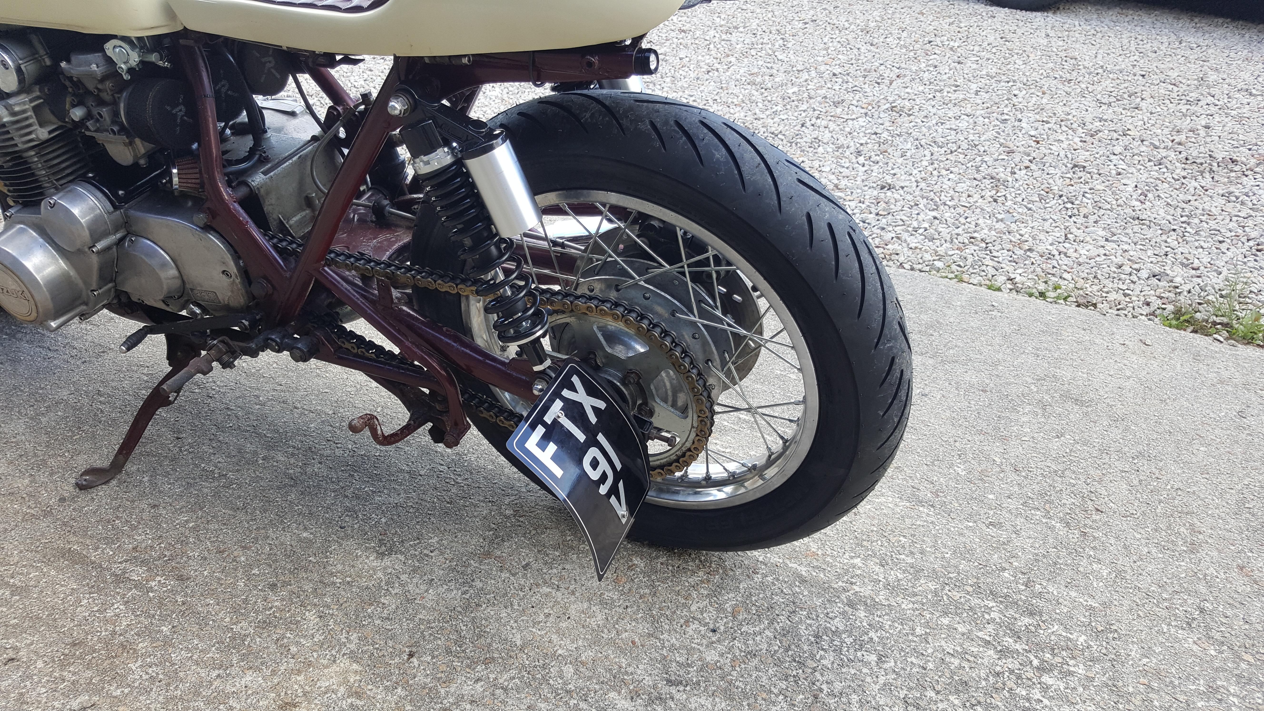

Finally sorted the rear gs1000 spoked wheel.
Recap...
I found a gs1000 wheel on ebay. Badly listed. Rim was scratched up badly with what looked like 100 grit or something! Spokes were rotten. Tyre was useless but I was gonna fit a new tyre anyway.
Spent hours/days sanding the chrome rim with fine wet n dry abd polished with autosol and a buffer on a drill. The rim turned out pretty good. Not mirror finish but shiney and no deep sanding scratches!
Changed the bearings to fit my 17mm gs550 axle / spindle.
I found NOS spokes from germany. Found a nice local wheel builder (awesome retired dude into his old British bikes). Finally got the tyre delivered and fitted today.
Still waiting for the front tyre! Tyre Leader.com terrible customer service.
I sprayed the hub shield, rear caliper bracket and chain adjusters satin black while I was waiting for the rear tyre.
Bought a curved number plate bracket to fit to the axle. My ali brackets were too flimsy to go anywhere near the sprocket. And I could no longer fit it to the shock now I have the gas reservoirs on the shocks. The numberplate looks a bit odd on the photo but looks good in real life I think.
