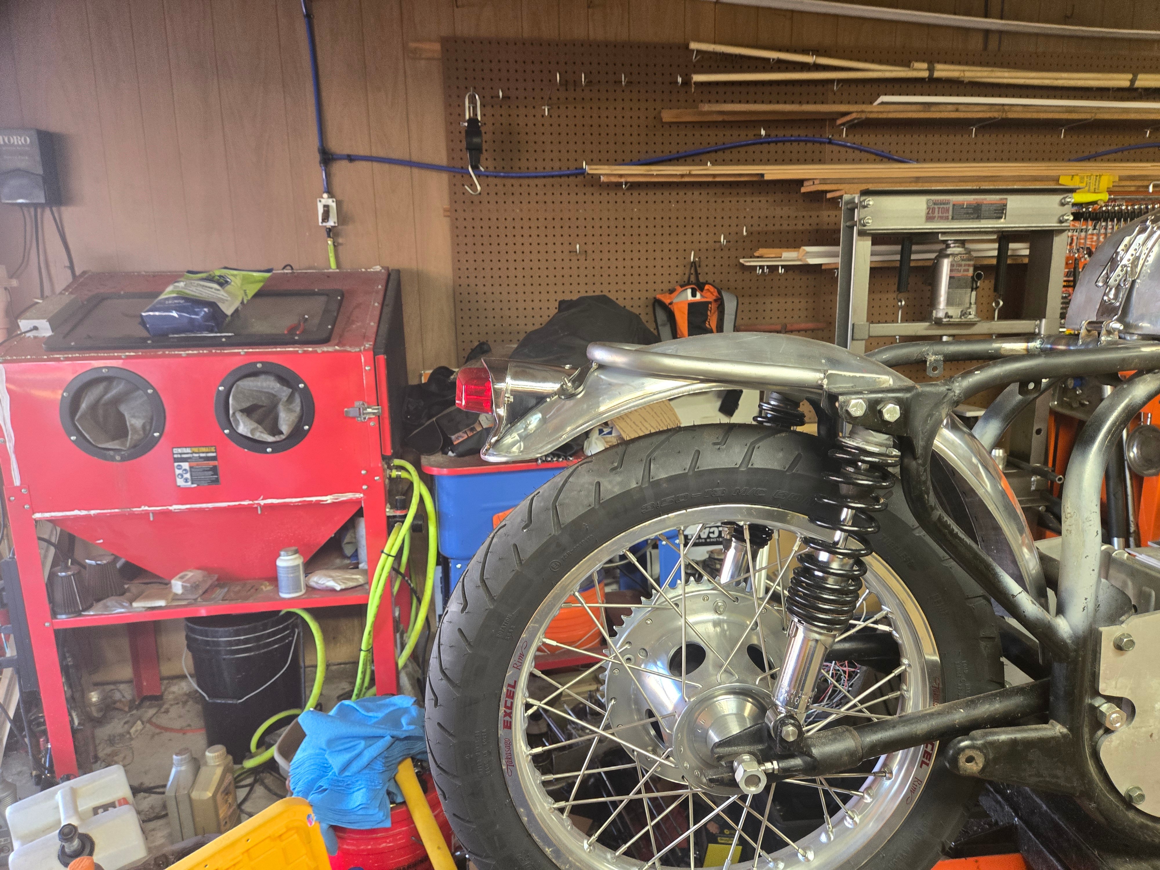

Slow progress is happening. Koni shocks are rebuilt and installed. Tail light is mounted and garage is cleaner with more to go.
Man, that is a clean machine! I like the way you mounted the rear cowl for easier access.

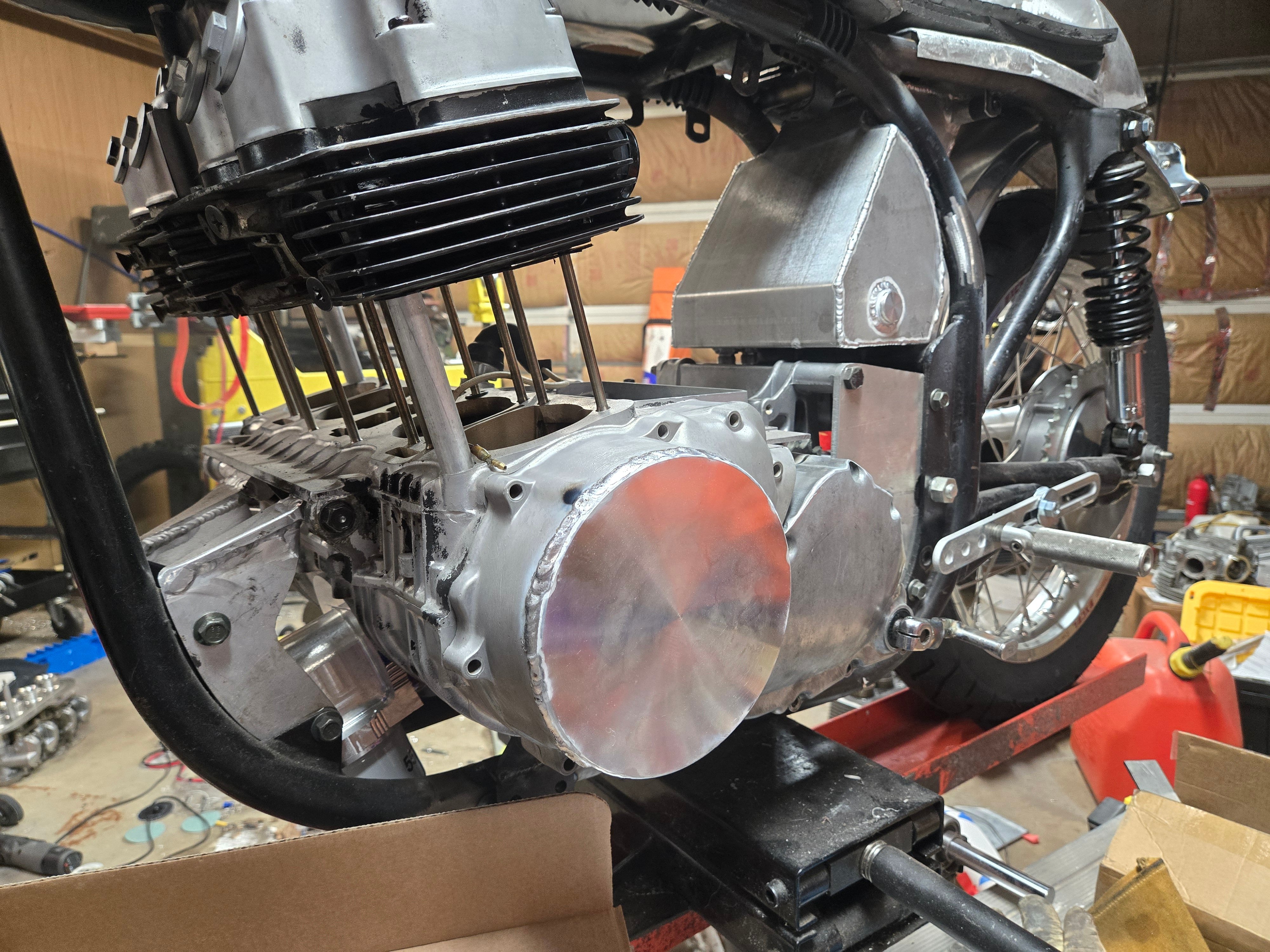

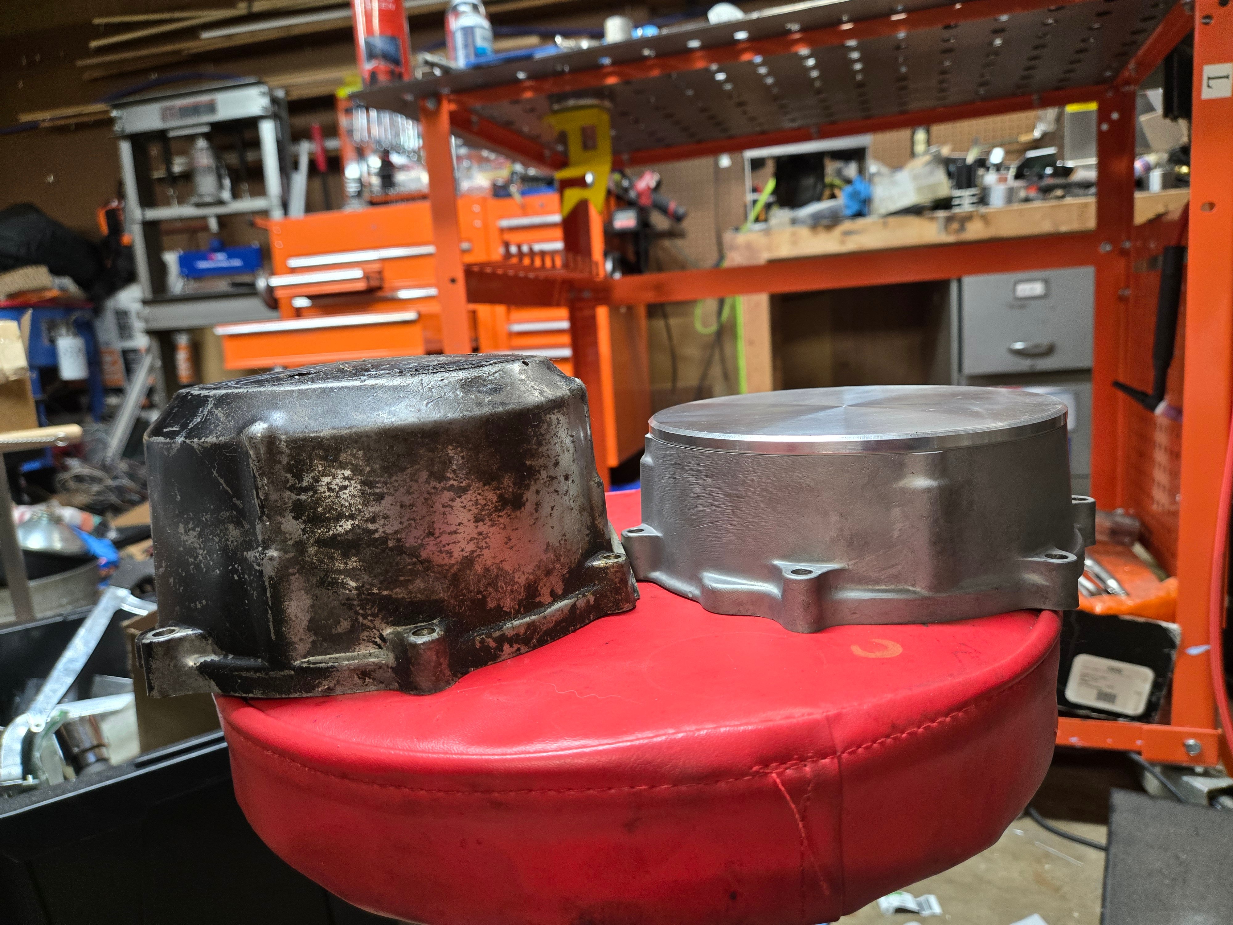

Thinking about exhaust options and shortening the stator cover. I'm using the PMA charging system from anders288 on the sohc4 forum.

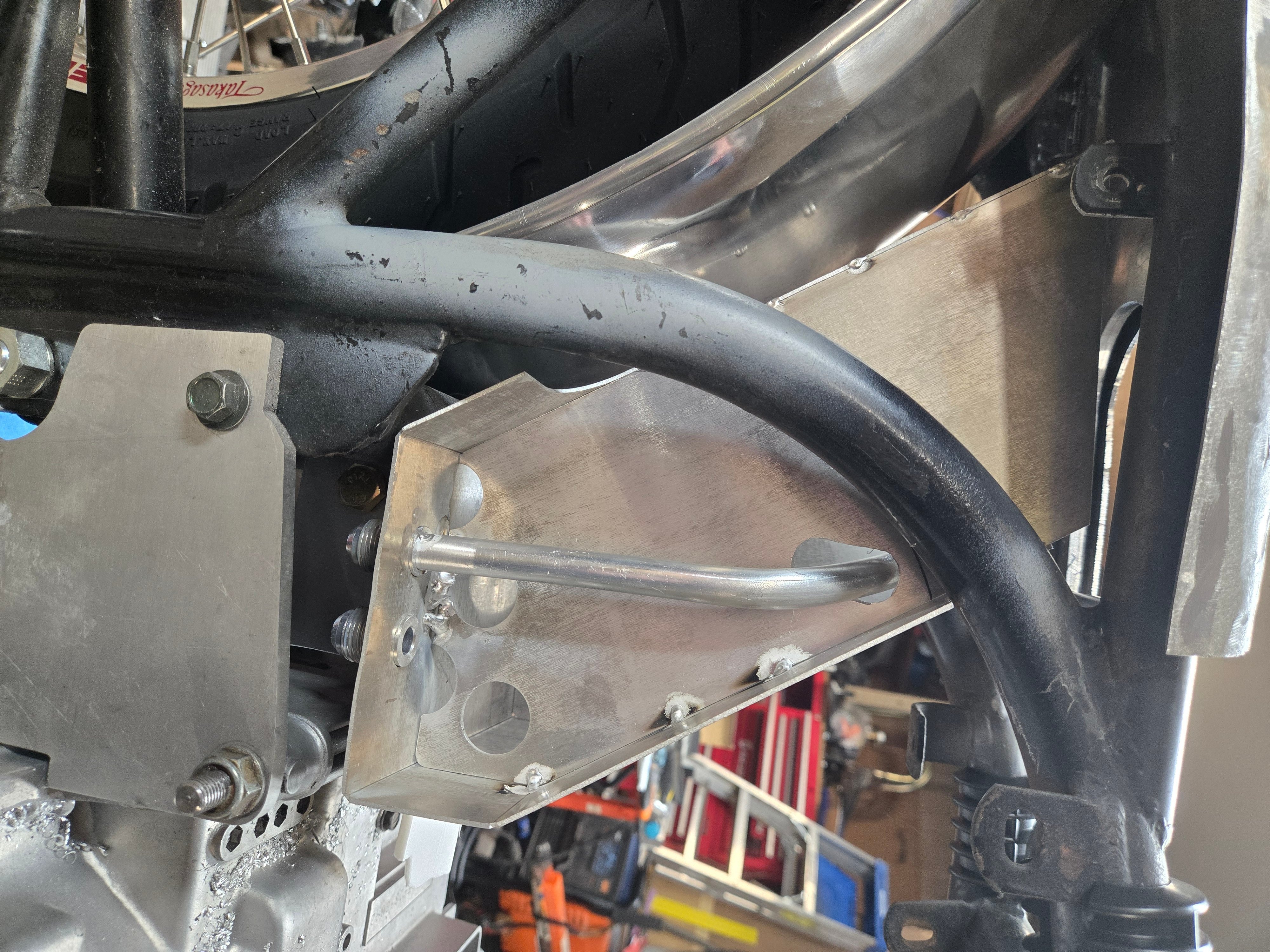

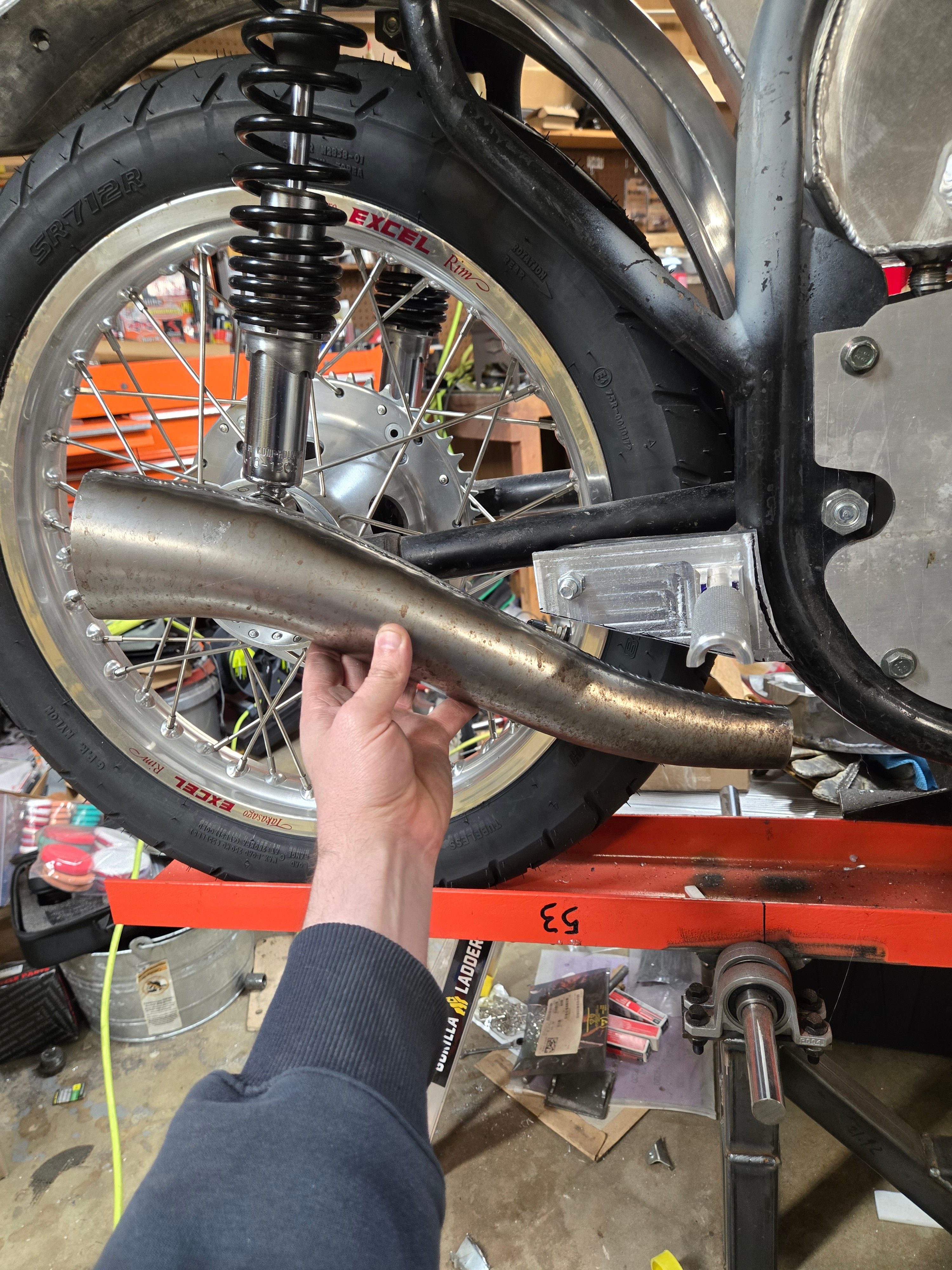

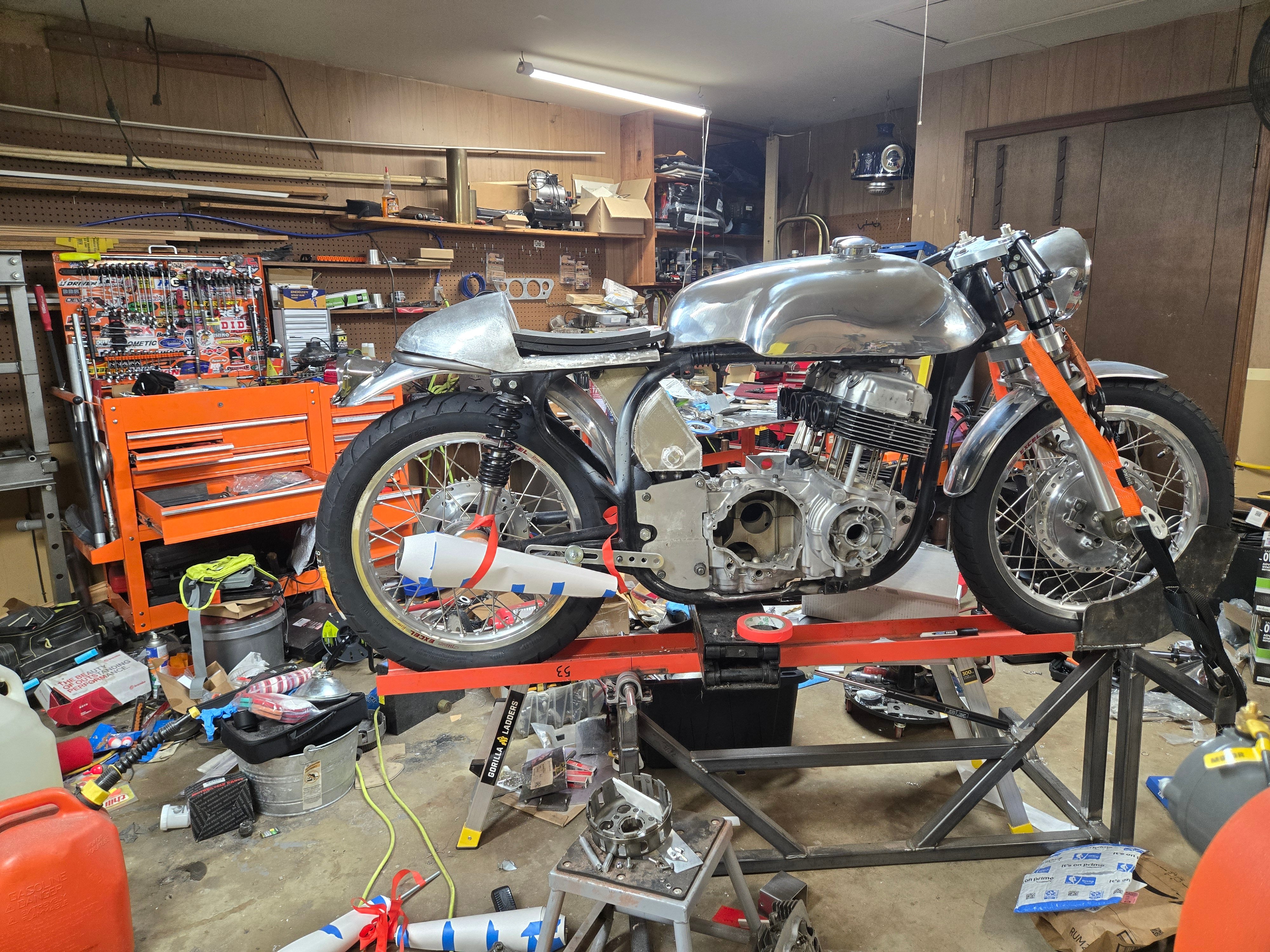

Started working on footpegs and mounts. Also made a template to attempt some hydroformed megaphones. No pic of the template, but if it works the way I want I might make a dxf file and see what it would cost to have them cut by sendcutsend.
I like the 4-4 exhaust systern on thoose old Honda engines, even if a 2-2 looks more clasdic with the Norton frame would I go for a 4-4. If it was mine build i would do the mufflers straight as the megaphones was on the vintage Hondas like the RC166.
I like the pegs nice work, are the footpegs in aluminium or steel?
Footpegs are aluminum. Should be plenty strong.

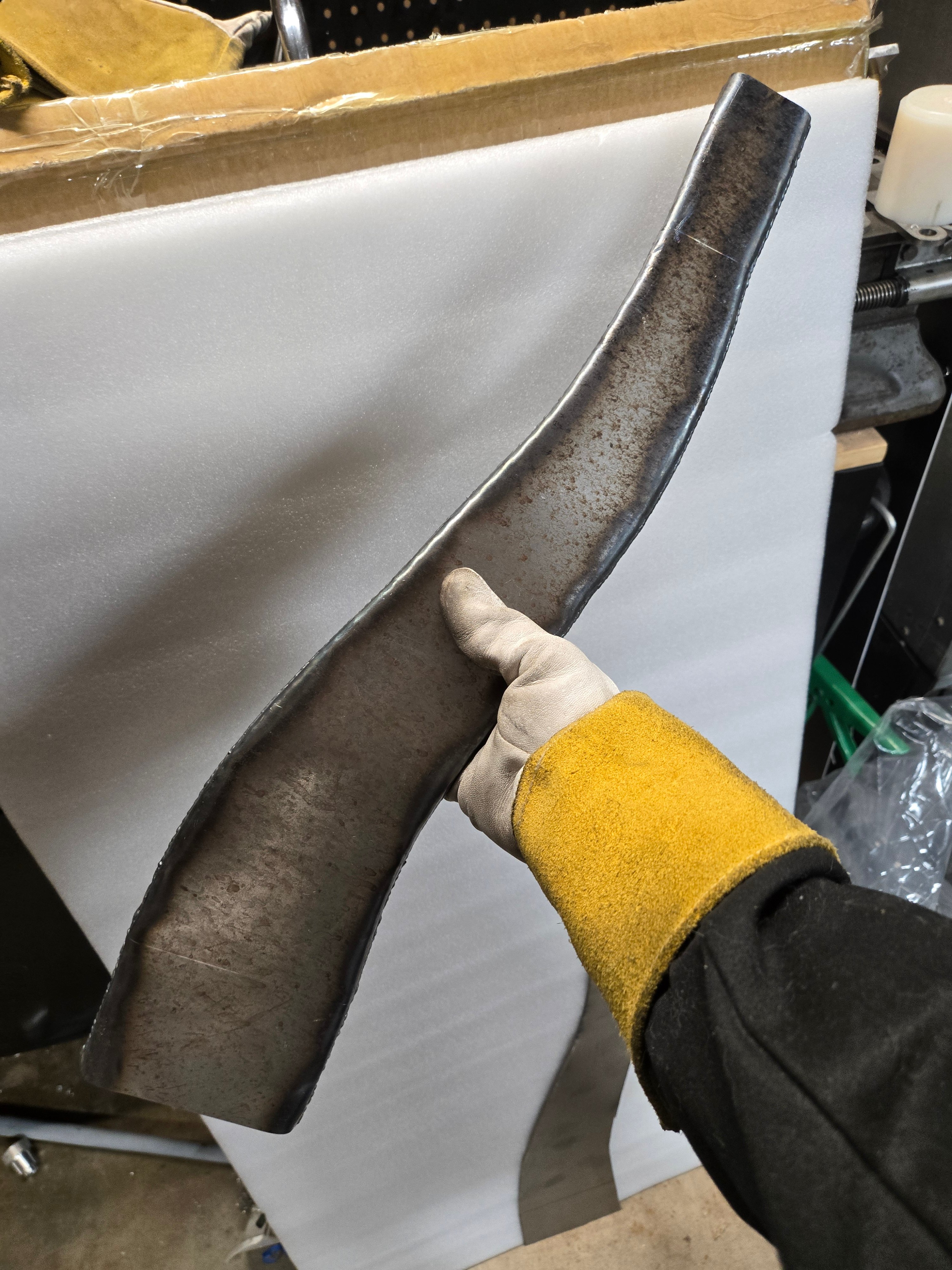

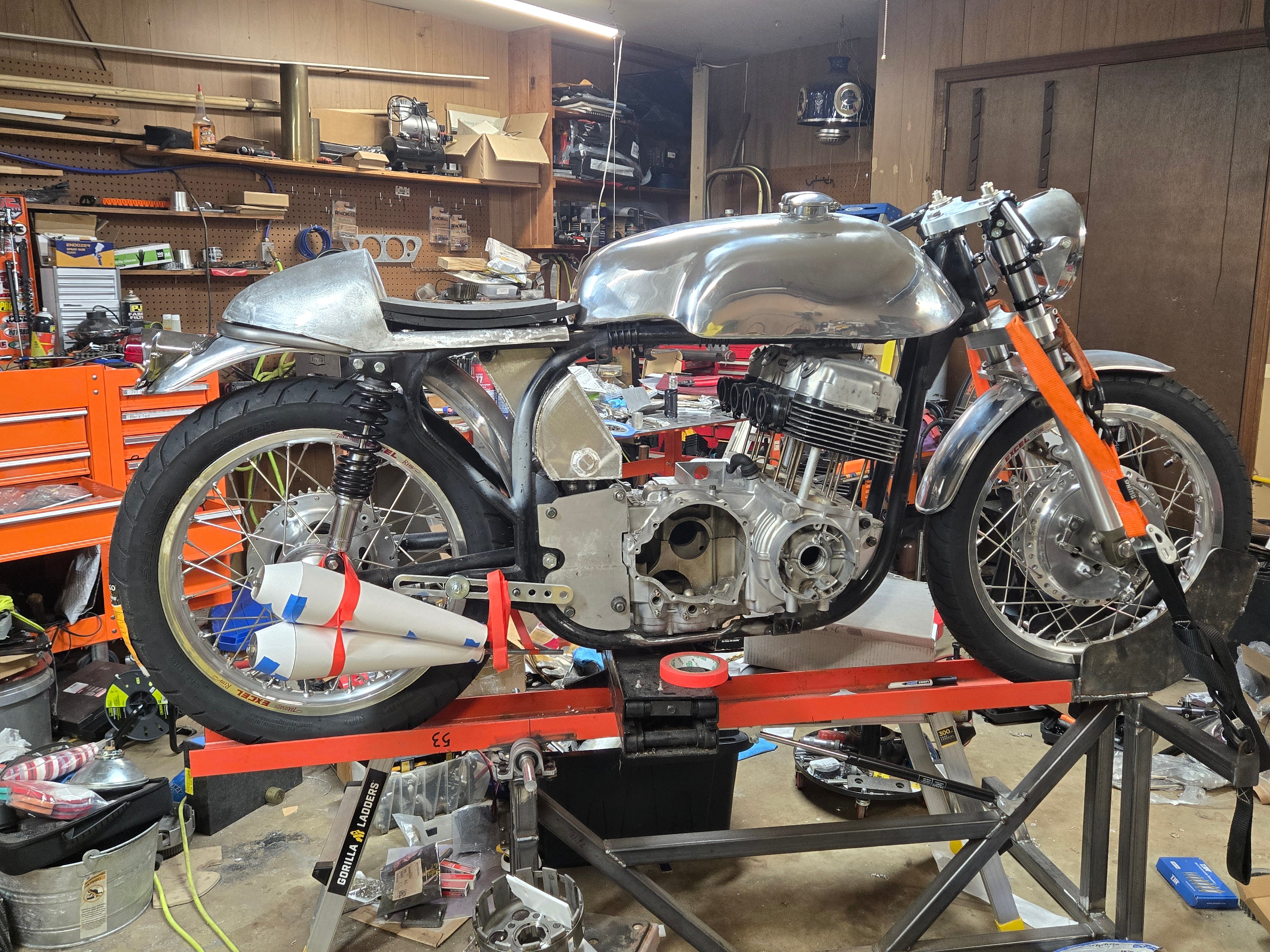

I'm really thinking about hydroformed cones now. I made a DXF and 2 pieces to test it, so now that I know it works I can get the parts cut by sendcutsend out of stainless for a little more than material would cost.
View attachment 242290View attachment 242291View attachment 242292View attachment 242293View attachment 242294

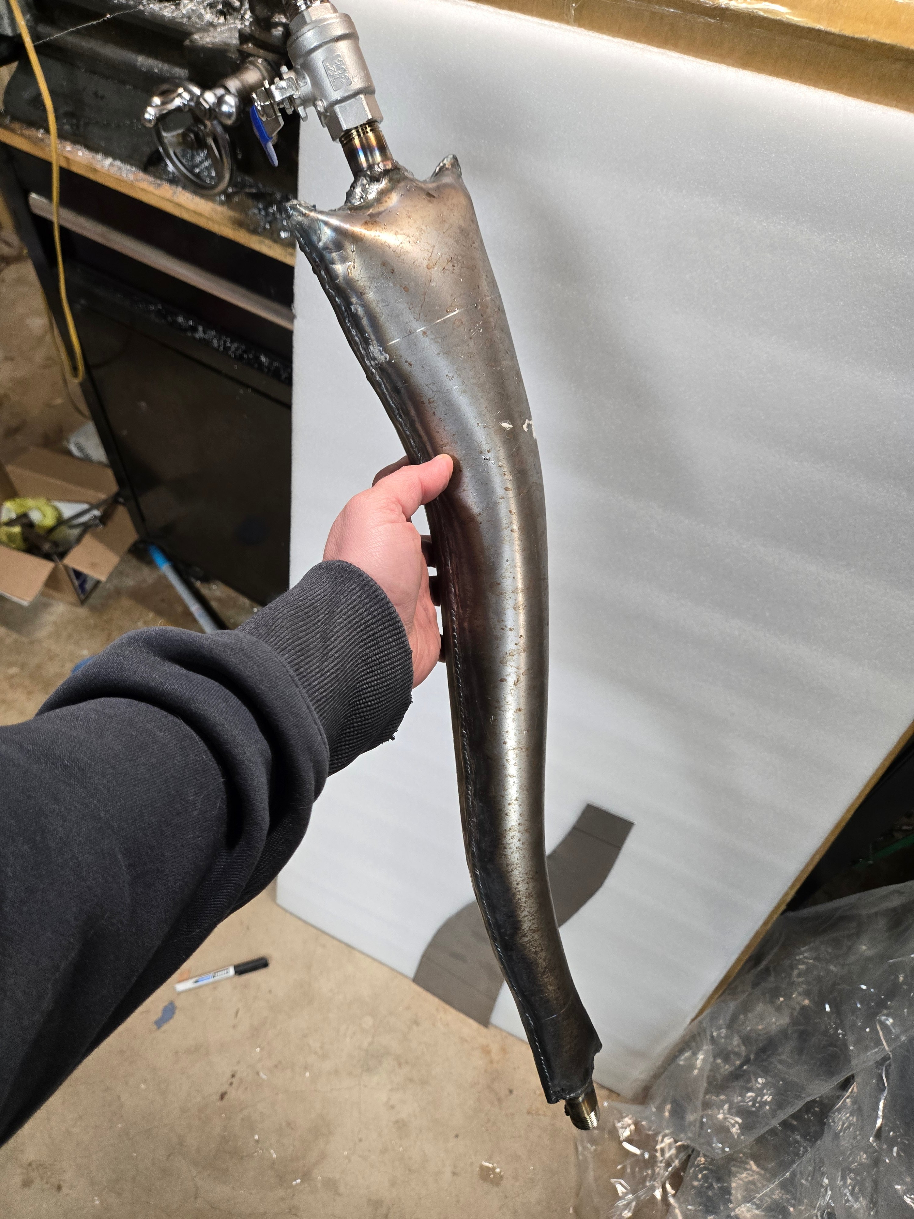

How are you doing the hydroforming? Have you just weld the two plates together and then pressurised with fluid or do you have some template (mabye not correct name) to put it in before you pressurise to get the right outside form?

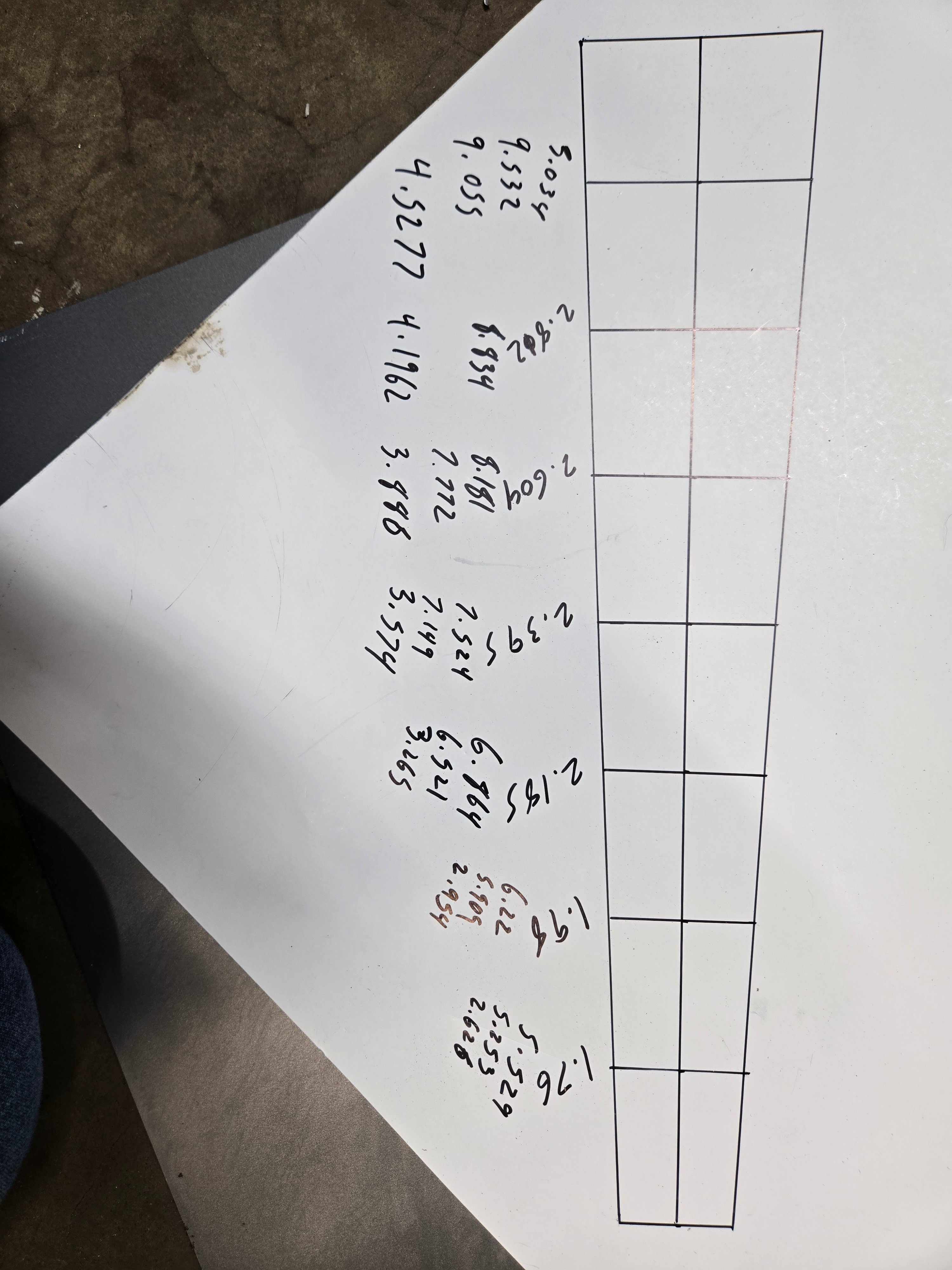

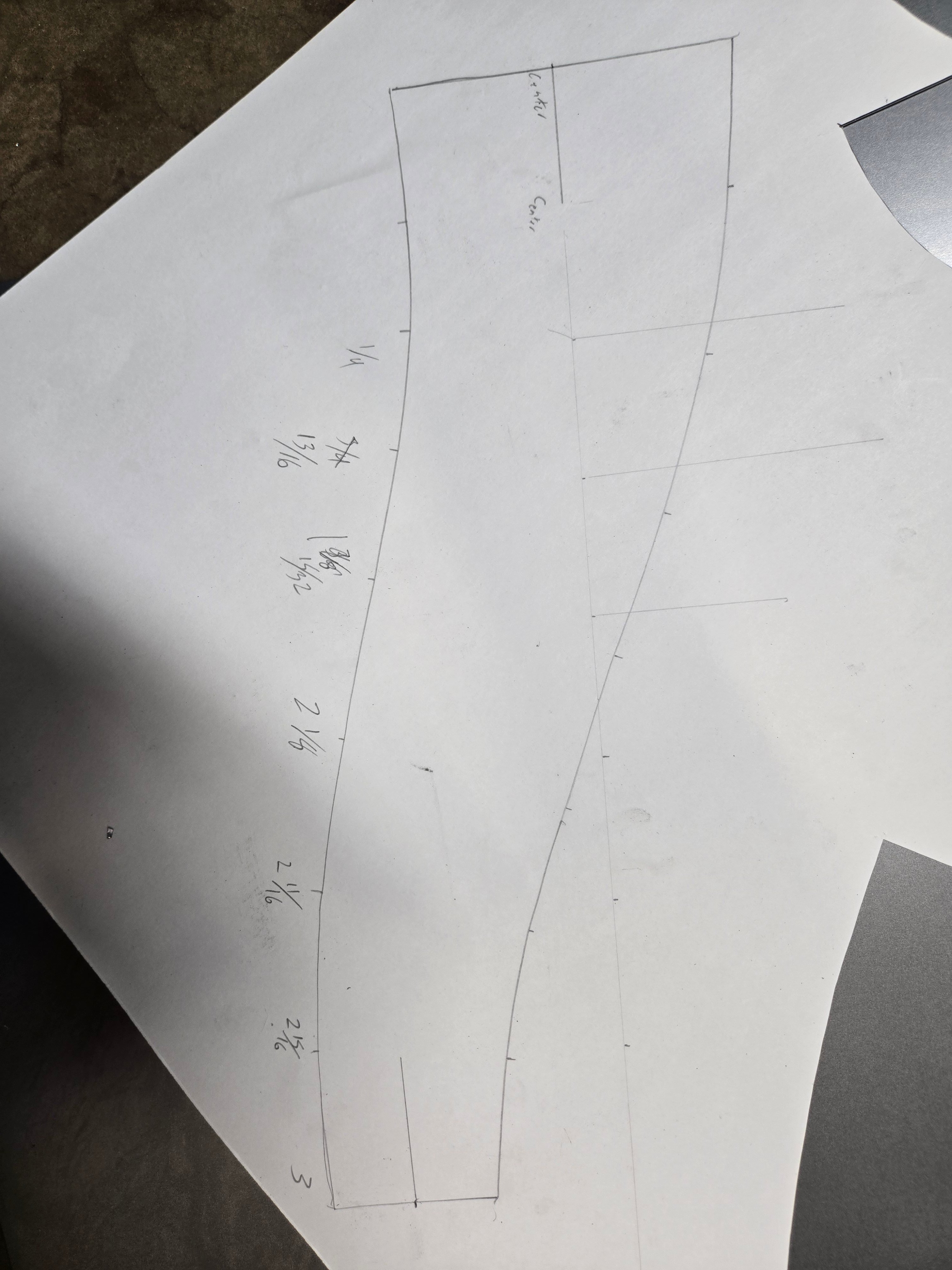

Final form is controlled by the pattern. So I made my pattern, first I layed out a straight cone and got the diameter every 2 inches. Then I figured out how much curve I wanted. The diameters were then converted to circumference minus 5% for stretch and then divided by 2. The resulting numbers were used to lay out line perpendicular to where they fall on the curve and the outside was connected to match the curve with the taper included.
The edges got rolled over about 45* then tapped together to create a flat butt weld on the top and bottom. the ends were closed with 1/2" npt pipe nipples welded in. One end gets a valve and the other connects to the pump. The valve lets you bleed all the air out.
Once that's done you fill it with water and slowly start adding pressure. This starts the metal expanding and while it expands you tap along the seams with a hammer to help avoid wrinkles or creases. You keep adding pressure while helping it form to the final shape you want. If it pops a leak, you stop, drain it, and reweld the leak. Then continue. Once the pressure is around 800psi you continue tapping along the seam in areas that need help getting to final shape. Once it's as close as you can get it the ends get cut off and you can use a metal rod as a mandrel to do any final shaping.
This was my test piece. I drew my pattern in CAD and saved it as a DXF file so that I can have sendcutsend cut the pieces for me. It's actually cheaper than just buying material to cut myself.
Here's a pic of the end of the megaphone before I sealed it. It shows how the edges were formed into butt welds.
