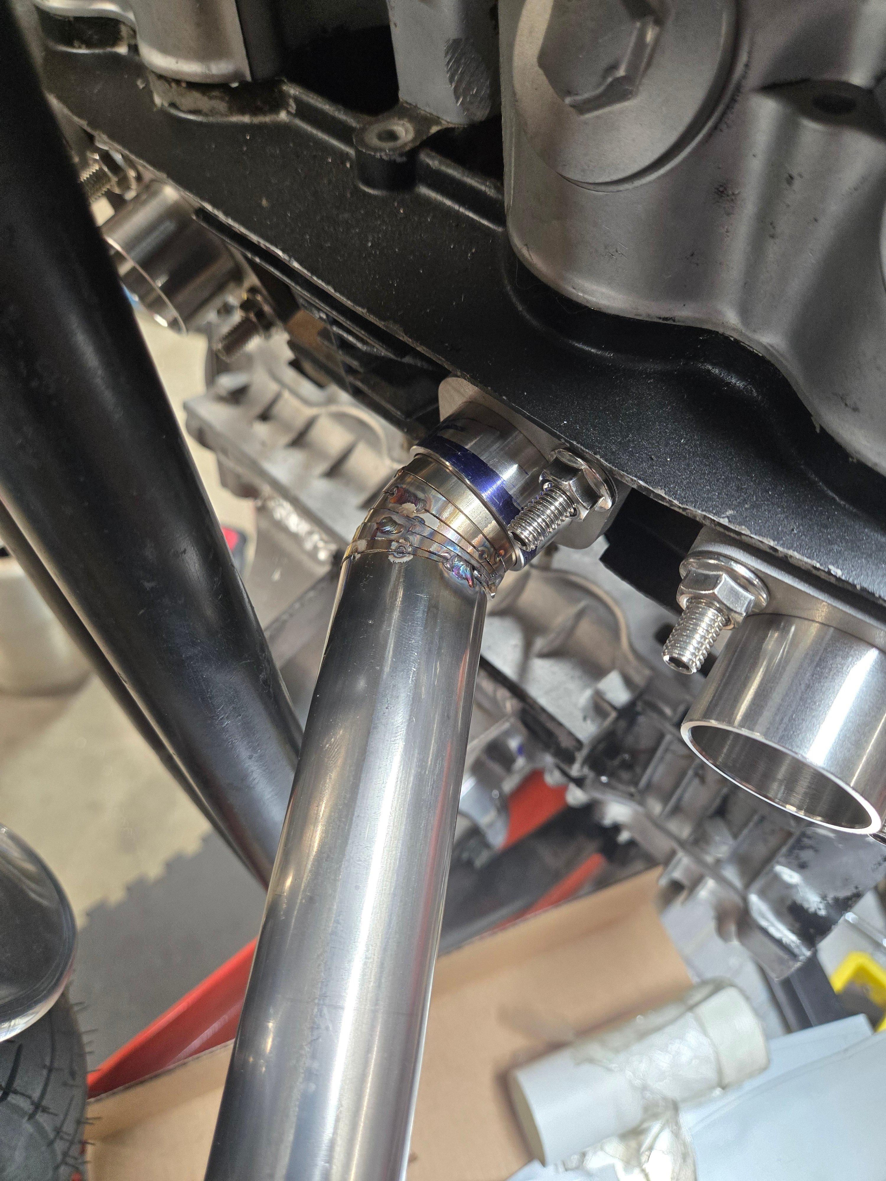

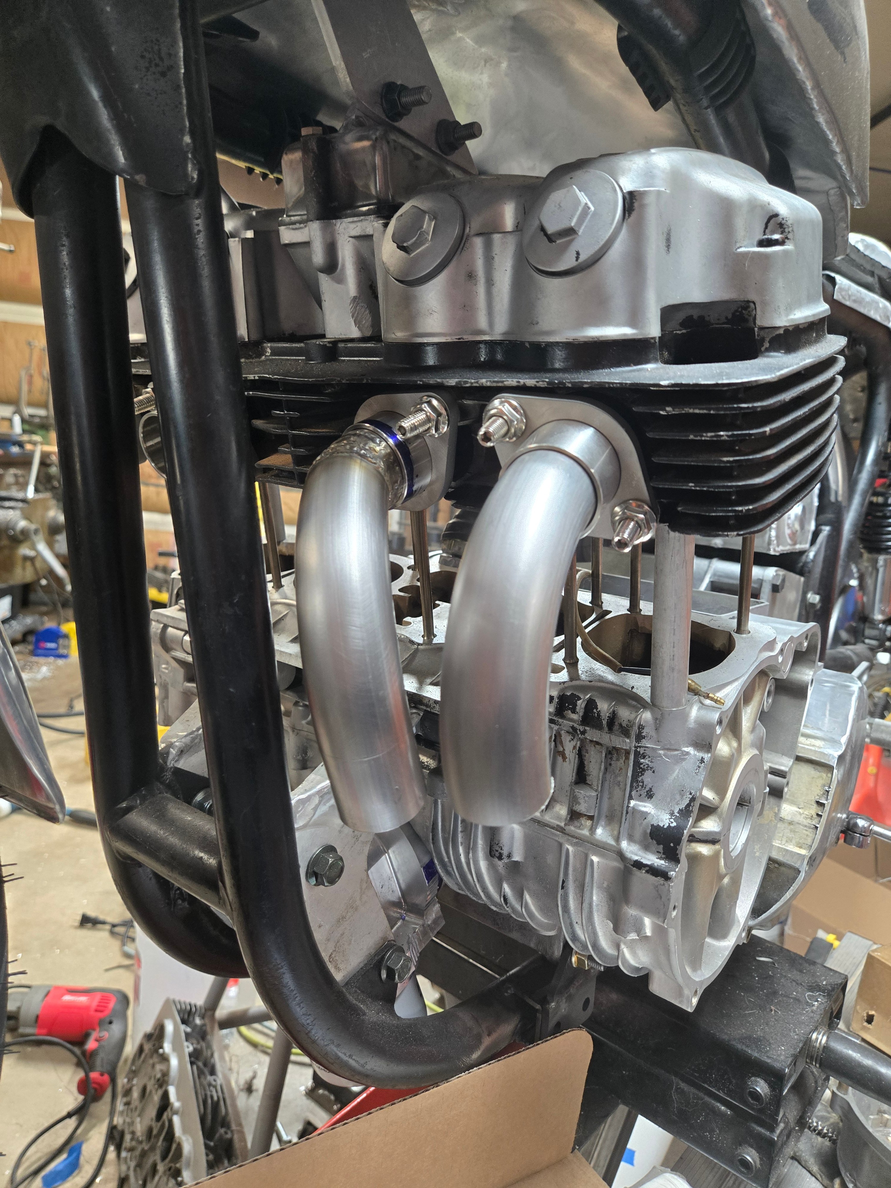

The problem with frame swaps is sometimes a simple part gets complicated. Cylinder 3 had to get its exhaust hub shortened .35" and some pie cuts in the tube to clear the frame.
