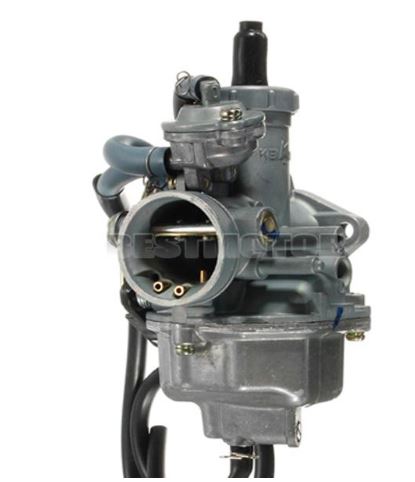

Also I don't know if you would be interested (might help with tune and off the bottom snap), but I just yesterday received in the mail a pair of I belive and will verify 26mm Keihin carbs with accelerator pump and choice of manual or cable choke for $40 ea. eBay add with listing: http://www.ebay.com/sch/m.html?_odkw=&_ssn=cenn2010&item=161446088160&_osacat=0&ssPageName=STRK%3AMEBIDX%3AIT&_from=R40&_trksid=p2046732.m570.l1311.R1.TR10.TRC0.A0.H0.Xcarber.TRS0&_nkw=carburetor&_sacat=0
Image of my carbs

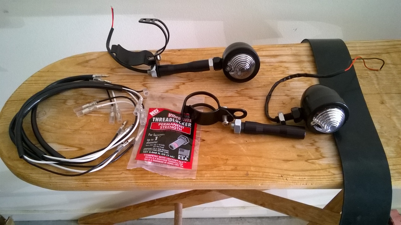

Yep I did get it. It looks as good in real life as it does in the pictures :-) Once fitted, along with the ignition key move, new headlight and new indicators, I will put some pictures up.
Here are some pics as they are.
Rubber strip in the headlight and indicator pics is to fatten up the forks and I will use double sided tape to secure it to the forks. Will also use double sided tape to secure a cool belt to the tank.
I will not have the nut in between the indicator and the extender stem, have tapped the stem out far enough that it is no longer needed.
Check out how skinny the wires on the speedo/tacho are, had to buy the smallest block connectors I could find (i did a 2 way for the power and the others in a 6 way). You will see in the back of the speedo pic that it comes with some orange splicers. Not using these to splice in to existing cables. Using regular bullet connectors to splice my way in as I don't trust those orange ones to be reliable, particularly where I need to splice in to ignition power wires.
