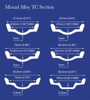

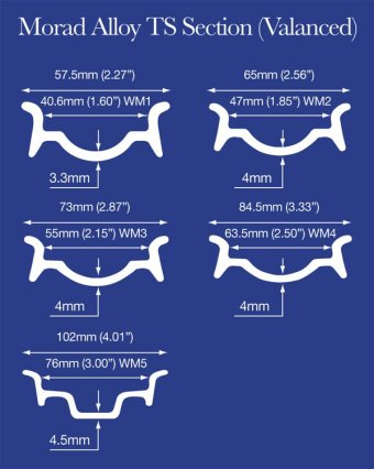

Your information on tyre/rim sizes is a big help!
I'll definitely be using a 1.6 front and a 1.85 rear. As you say, no problem on the back and the front can be sorted several different ways.
I was aware (somewhat) of the recent history of Borrani but wasn't aware that they made two different quality rims. The Record 11 would be the way to go for my purposes as some of the best rider's roads around here have a pothole or three.
That said, my thoughts are heading towards getting rims from Morad, as they seem to be more available here in Oz.
The Morad TS rims are similar to the Borrani but the TC rims are more robust (and easier to keep clean!)

The 1.6 is the right size for 2.75; 1.4 is too small.
As waketrip said there will probably be clearance problems with the front guard, but a solution should not be too difficult.

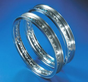

Crazy
I should thank you for promoting Spanish manufacturers! We do really need it, I can tell you that much hahaha!
Jokes aside, this last weekend in Madrid, we had the biggest Fair about old motorcycles and cars, with plenty of extremely interesting exhibits. (if you like Bultacos, Ossa's, Montesas and other spanish motorcycles, like the 50 Cc's Derbi bikes legend Angel Nieto rode throughout his world championships take a look at this PHOTO GALLERY or search for ''auto classic Madrid motos 2015'' on Google.
Thing is, it also houses the biggest Swap Meet around here, and I had the chance to have in my hands a selection of newly made Morad wheels. These come stamped as Morad-Akront rims (as you know, Spanish company Morad acquired all the tooling from the now defunct Akront, yadda yadda...) and as far as I could tell, they are quite a good choice:
-The outside of the rims was nicely finished, and the inside of the rim, had an ok finish and seemed to have pretty decent drilling and the weld seemed good. it was quite light as well.
Now, mind you, I don't know what rim model (tc, ts...) I was handed and it looked like a 19' rim, but I think they will be a solid choice for the Ace.

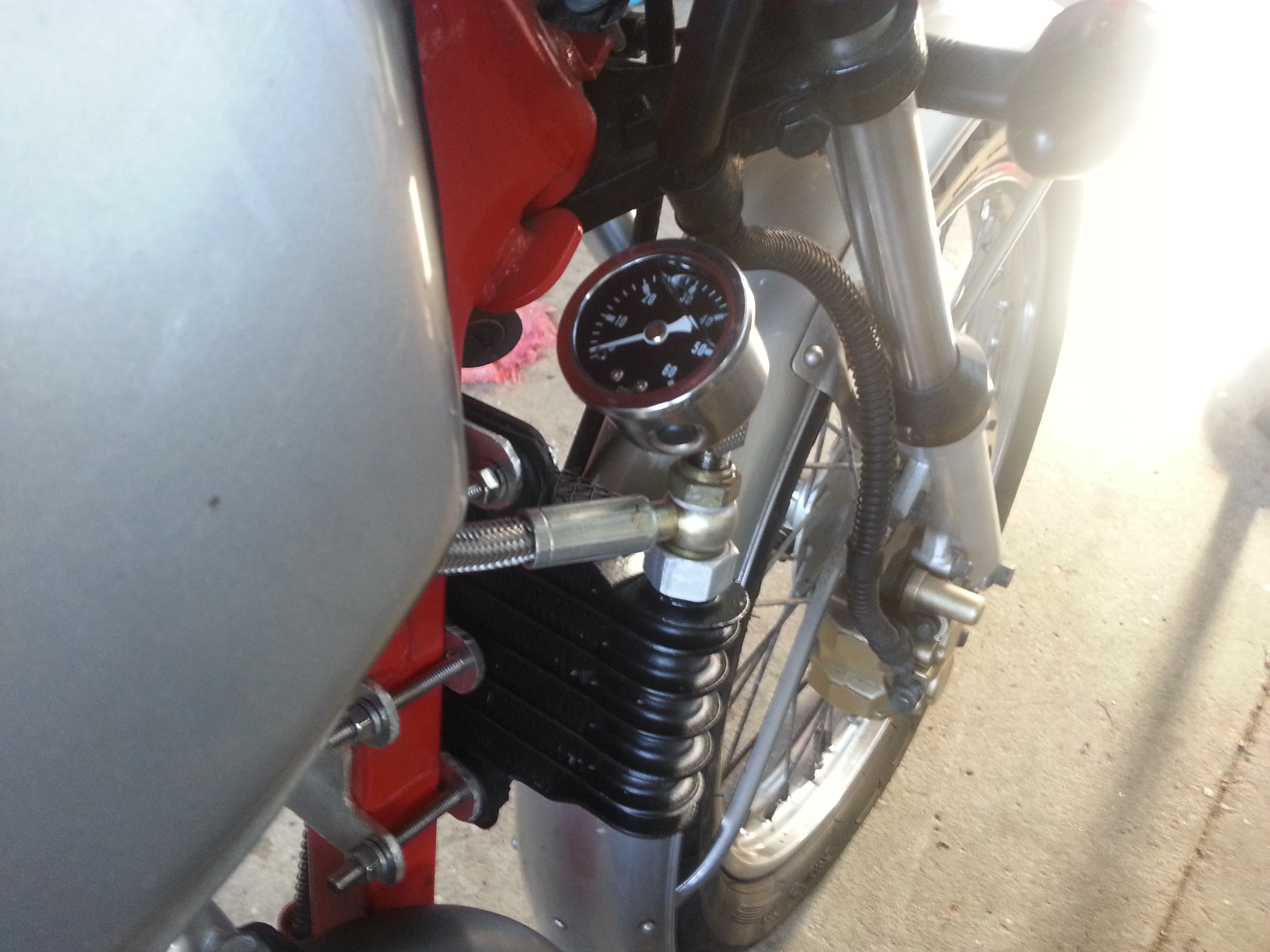

got my oil cooler and pressure gauge fitted just in time for the weekend.
had new hoses made up as i didnt trust the chinese rubber , now rated to 150 deg Celsius and 3000psi !
stroker crazy said:
3000 psi should handle it!
Looks great and the gauge is a good idea.
Crazy
thanks Crazy, the gauge was something i really wanted to put on the bike but the biggest issue was finding the adapter bolt i needed for the banjo. thank the gods for the fast fours rev heads and there upgrades :D
i managed to work out that a late model honda civic under hood fuel pressure gauge adaptor was what i needed :D
